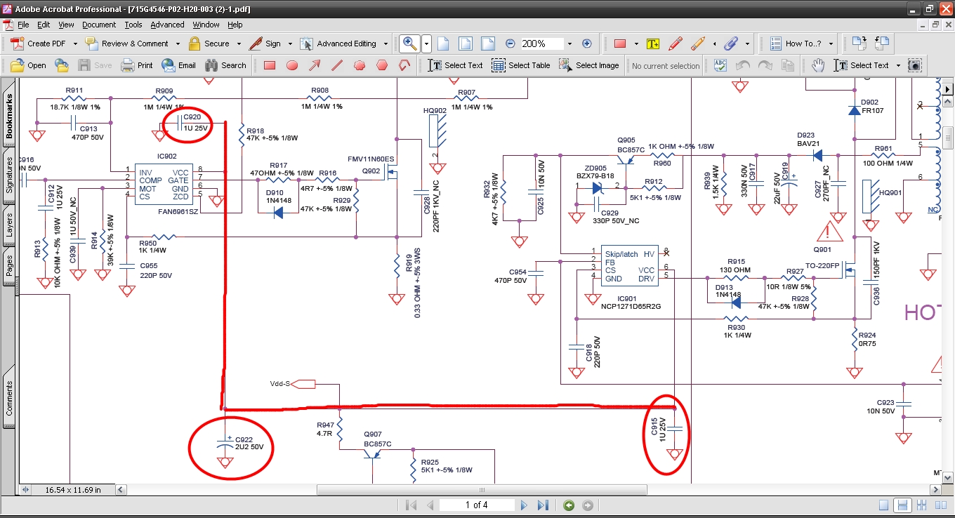

    Hello Budm
    Done al the steps you asked except remove R965 that one isnt on the board. and R866 is R966.
    But now i have 5,9volt @pin 3 of ic905 and 4,6v on the 5v
    So now you do get 4.6V Standby Voltage?
    It should jump up to 5V when using 1K to simulate turn on signal, verify that.
    BTW, My typo on R866, it should be R966.

      #62
      Re: Philips 47PFL4606 No Power Fuse Keeps Blowing
      Indeed when 1K in place iam getting the 5V
        #63
        Great!
        1) So leave those parts I had you removed out for now then check Q907 in diode mode and in resistance mode on all 3 legs combination.
        2) Check the resistance between two leg of cap C922.

          #64
          Hello
          On Q907 between C/B iam getting 1ohm in both ways..
          On caps C922 iam getting 266ohm
            #65
            Hello
            So Q907 is damaged when you had that blown up episode, the circuit is loading down the AUX Voltage (C946) so the TOP SMPS was in shutdown/restart mode, that is why you were only seeing about 2V on the 5V STBY output.
            Now we have to find out which circuit is causing 266 Ohms reading on C922, it can be the PFC IC902 of the 12v/24V SMPS IC901, MLCC C920, MLCC C915.
            I would try removing one MLCC cap at a time first, if the resistance still reading low on C922, if it still stay low then I would remove IC902, then IC901.
            BTW, check the resistance of C922 on the working board to see what you get.

              #66
              the resistance on the working board on C922 is 105Kohm
              Both caps C915 and C920 measure around the 260ohm on the defective board
              I removed C915/C920 and IC902 and now the short is gone

                  #68
                  Sorry.. C915 and C920 on the defective board measure around 260ohm,
                  Also i removed them and they measure OL
                    #69
                    OK, that means the caps on the bad board is good, so it can be bad PFC IC902 or the SMPS IC901 for the 12v/24V, remove one of them and see if the resistance will go up.
                    • trunks81
                      • May 2020
                      • 265
                      • Nederland
                      #70
                      removed ic902, and now the resistance on C922 is 104kohm.. the same as on the working board
                        #71
                        So the PFC IC902 is bad then.
                        Be sure to recheck PFC MOSFET Q902, R919, R917, R916.
                        Something caused the IC that you said you replace to go bad.
                        The original PFC IC is FAN6961 as shown in the schematic, correct?

                          #72
                          Hello
                          Orginal PFC is indeed FAN6961 !
                          Q902 = checked out good.. all high ohmages
                          R919 = is 0.33ohm
                          R917 = 9,90ohm on the good board 47.07ohm tested in circuit
                          R916 = OL and on the good board 133kohm tested in circuit
                            #73
                            Hello
                            R919 = is 0.33ohm
                            1) R917 is 47 Ohms as shown in the schematic, it is connected in parallel with the diode, so your reading shows 990 Ohms, that means it is bad and possible the Diode D910 may be damaged too, check that.
                            2) R916 is 4R7 (4.7 Ohms) as shown in the schematic, you need to recheck it again and both boards.
                            BTW, you must look at the schematic to see what the values are shown in the schematic then look at the value as printed on the body of the resistors so we do not have to go back and forth re-verify your readings.

                              #74
                              Hello
                              R917 soldered out of circuit and that resistor is 47ohms
                              D910 soldered out of circuit and tested very low in both ways
                              R916 soldered out of circuit and tested OL
                                #75
                                Hello
                                So you have more damaged parts.
                                "R916 = OL and on the good board 133kohm tested in circuit"
                                What does R916 of the good board show? It cannot be 133K as you reported, it is supposed to be 4R7 Ohms.
