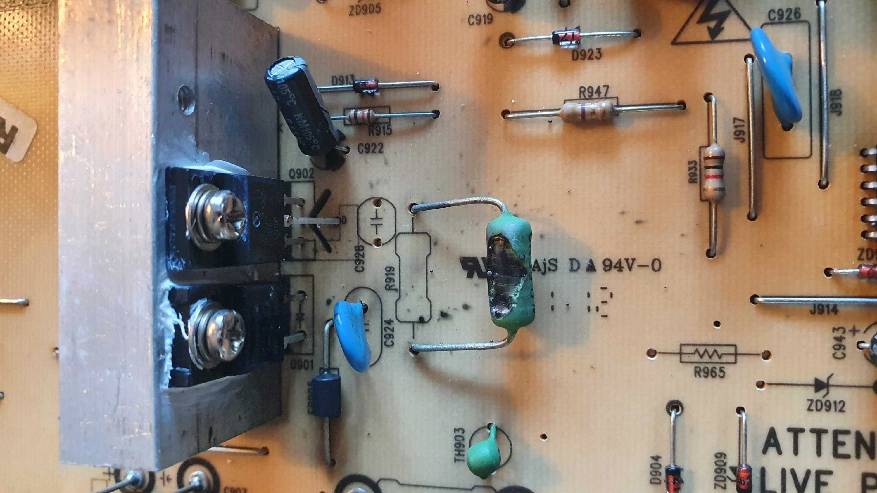

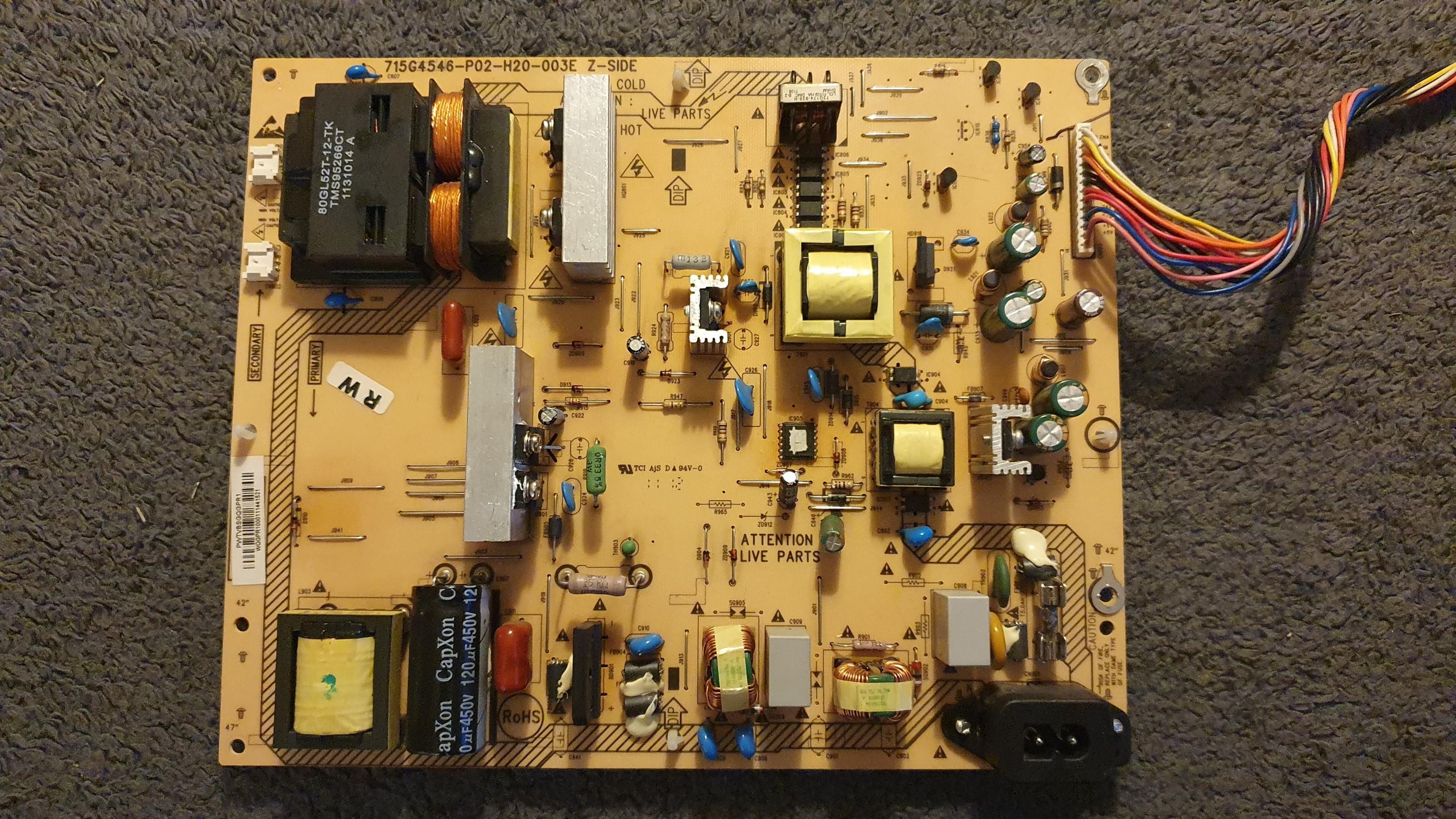

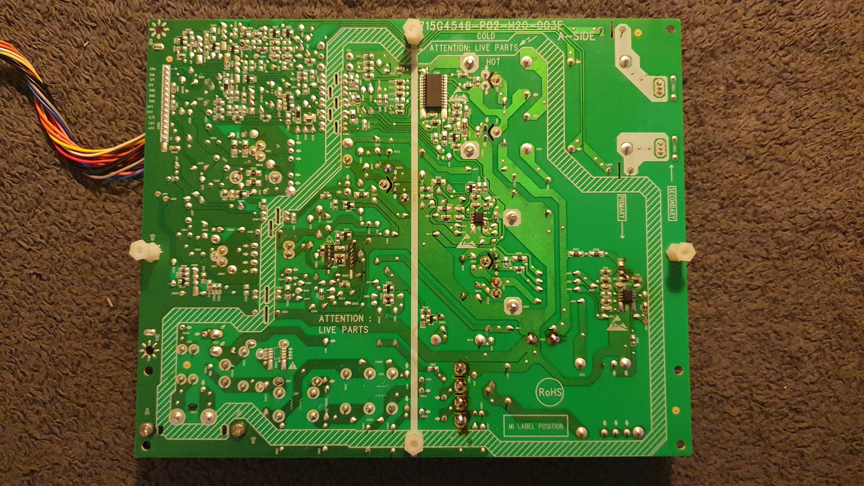

    Ive got one other 47PFL4606, only this one the fuse keeps blowing !
    I allready replaced the next parts
    BD901
    D901
    Q902
    Q901

    Same board as this one, right? No funny soldering going on?
    https://www.badcaps.net/forum/showpo...63&postcount=1

            After this R919 exploded and D901,Q902 measure very low ohms (these where replaced by me before !)

                    Resoldered the old parts back and replaced R919,D901,Q902
                    Now the smps doesnt explode or the fuse blows.

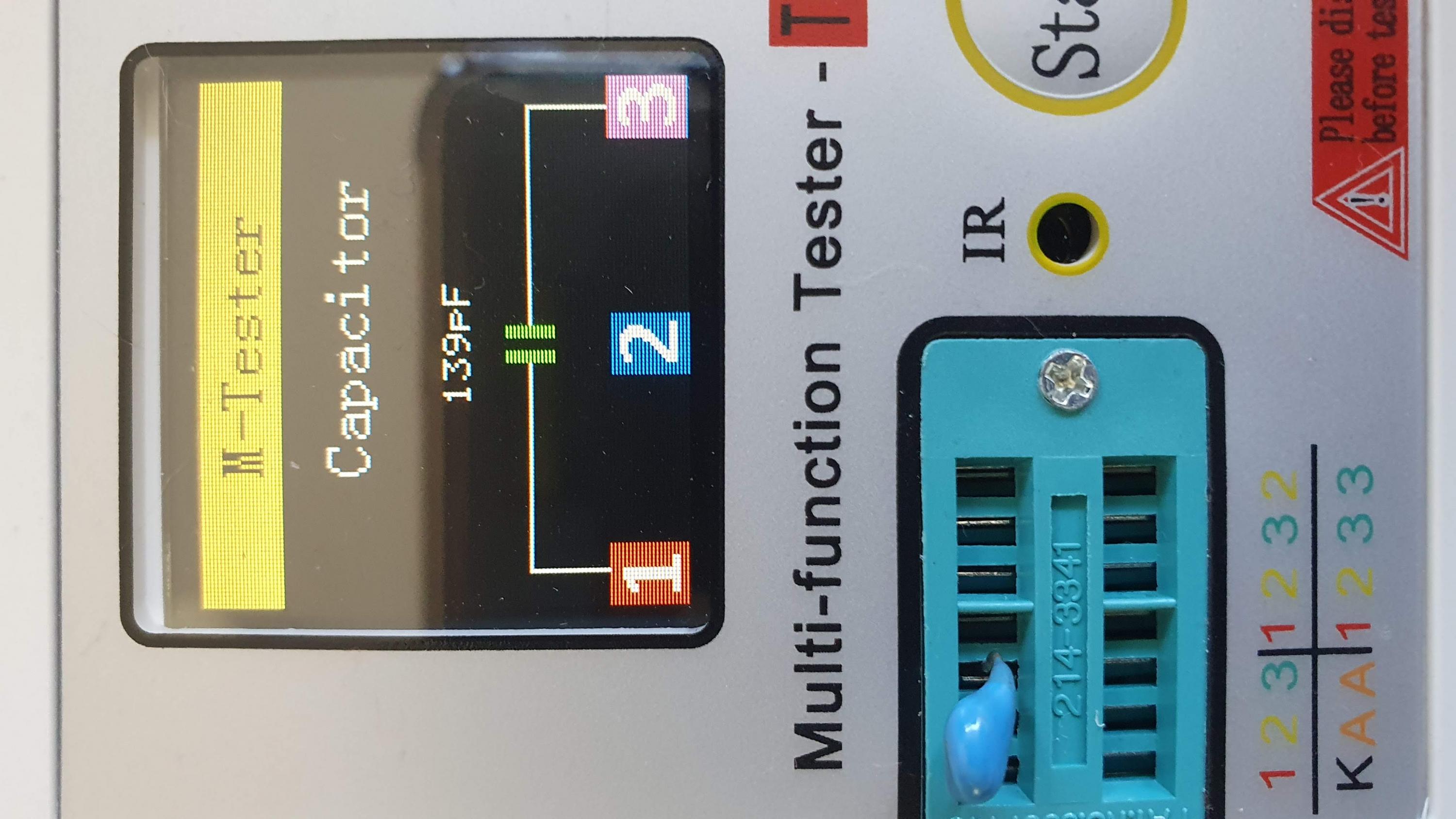

                    Edit when i pull out C936 the short is gone ! But when i measure C936 in ohm it is not low, and capcitance is 139pf
                      What resistance reading did you have?

                        Sorry i was wrong..
                        C936 my meter says its OL in ohms, last reading i touched something with my hands

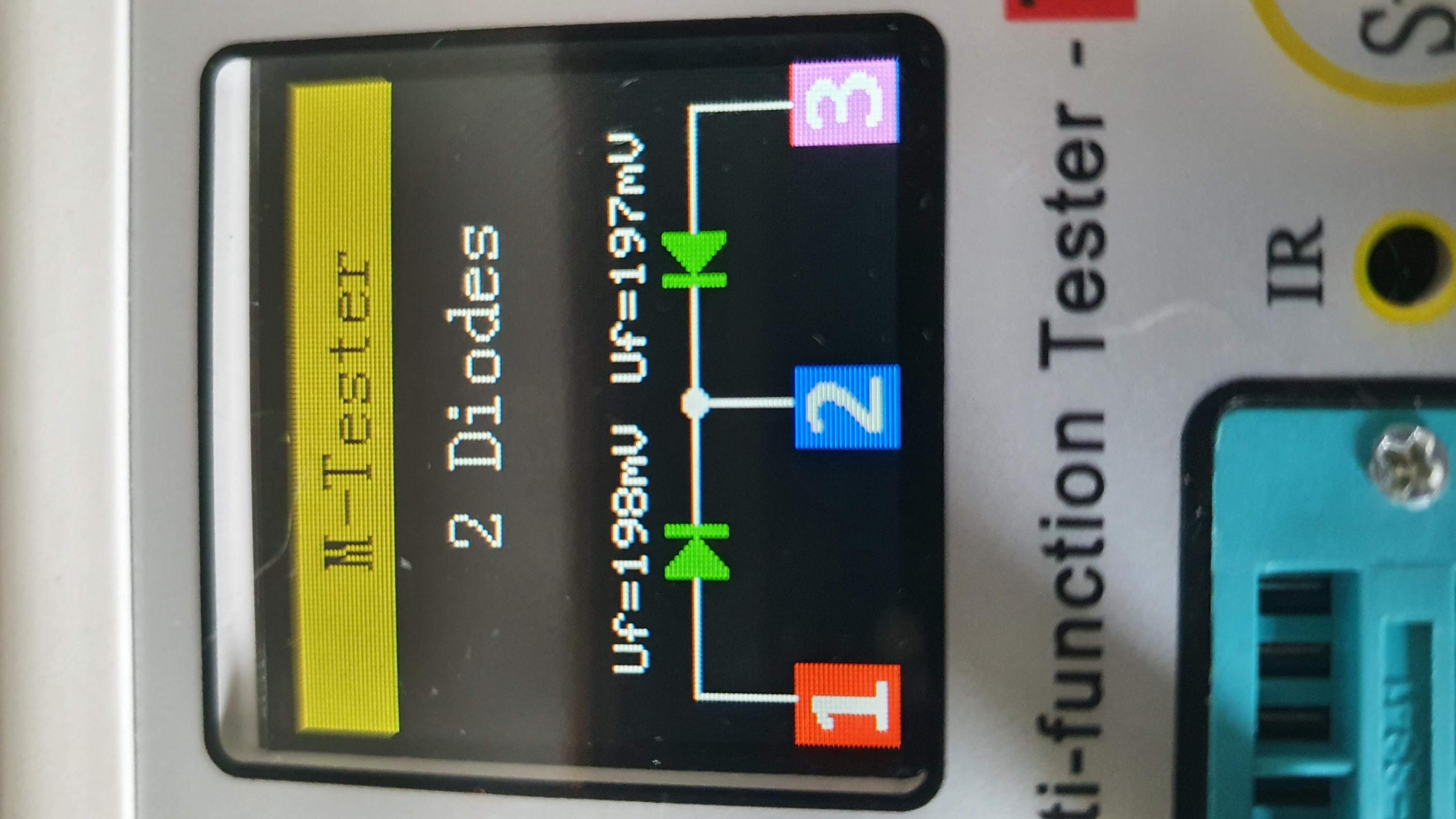

                            Tested D917.. for both diodes the forward Voltage is 200mV
                            Looks low to me ?

                              Your tester gives it the OK so I would be satisfied with the reading.

                                  The data sheet shows the reverse voltage for the SRF1060 as 0.750V so the results do seem low. Use you multimeter set to diode mode and see what results you have.

                                    OP component tester only puts out low milliamp so the Vf reading will be low, see the Vf graph on page 4 of the spec sheet in post 16.
                                    As you can see on page 2 of the spec sheet, Vf is 0.70V at test current of 5A.

                                      Hello got the next reading on those diodes tested with the multimeter (UT-181A)
                                      D917 = Both test 0.15V, And reverse OL
