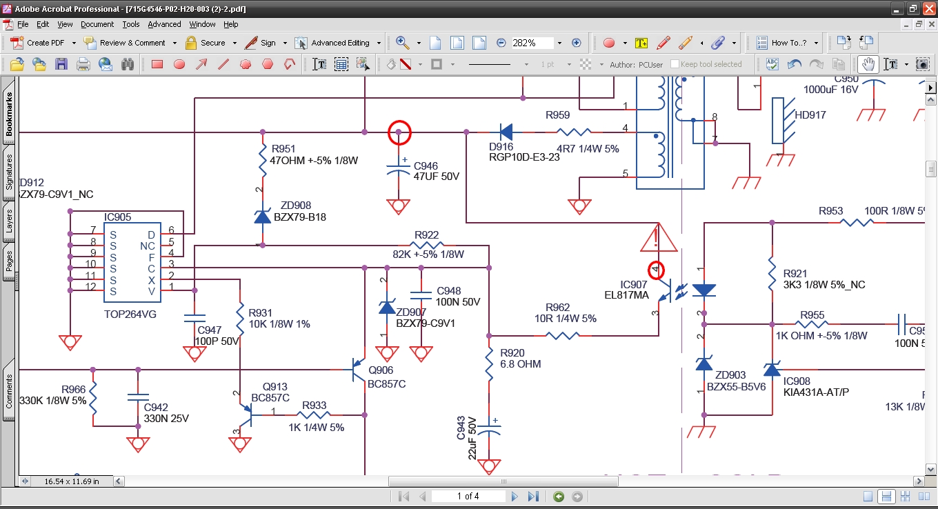

      Re: Philips 47PFL4606 No Power Fuse Keeps Blowing
      Originally posted by trunks81
      Hello
      Tested the two boards across. and came to the next result
      Color green is for working board and red for the not working
      All is tested without the 1K resistor
      IC905
      1= 2.85V 1.30V
      2= 1.3V 1.26V
      3= 5.92V 5.5V
      4= 0V 0V
      5= 317V 315V
      IC907
      1-2 = 1.10V 0.31V
      3-4 = 2.21V 4.80V
      C946 = 8.16V 0.70V
      D916 = 8.22V 0.70V
      What Voltage do you have on pin 3 and pin 4 of IC907 with ref to negative leg of C946?
        #43
        1) Check resistance of R965 (2M2 Ohms), it is located around IC 905.
        2) Check the Voltage between the Emitter and Collector of Q913, it is also located around IC 905.
        • trunks81
          • May 2020
          • 265
          • Nederland
          #44
          V on pin 3/4 to ground of C946 is 5.50V and 0V,
          V between C/E of Q913 is 0.54V
          on the good board this is
          V on pin 3/4 to ground of C946 is 5.88V and 0V,
          V between C/E of Q913 is 0.55V
          R965 and ZD912 are not on the board
            #45
            Your post #24 for C946 Voltage readings:
            C946 = 8.16V (good bd.) 0.70V (bad board)
            D916 = 8.22V 0.70V
            If you look at the schematic, the OPTO IC907 pin 4 (Collector) is connected to the positive leg of C946, so I cannot see how you can have 0V (on good and bad board) on pin 4 of the OPTO IC907. Does that make sense to you?
            Are you sure you are probing at the correct parts on the board?
            It seems to me we are having some kind of measurement error here that is throwing us off trying to troubleshoot the problem.

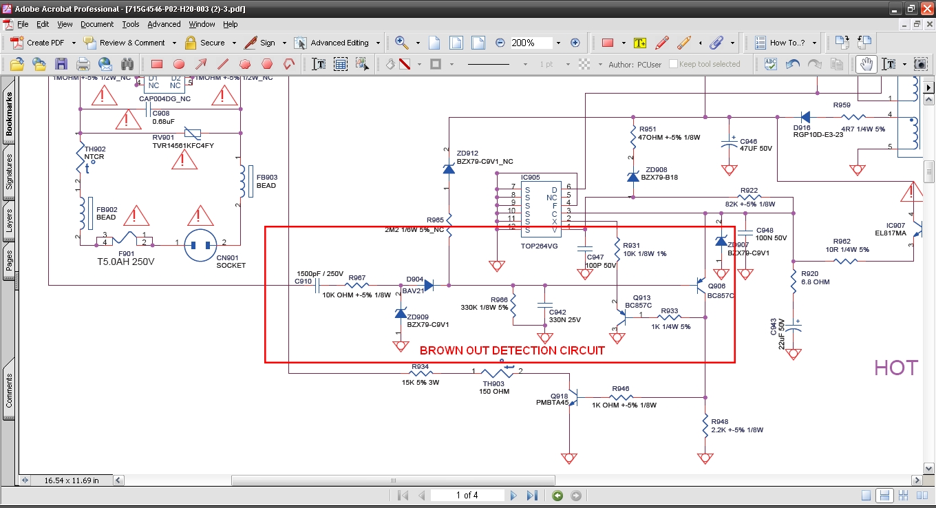

                Post 34:
                Ic905 good bd / bad bd
                1= 2.85v /1.30v
                2= 1.3v / 1.26v
                3 (C) = 5.92v / 5.5v
                4= 0v / 0v
                Your post 46 now makes sense.
                At this point, it seems to me that the Voltage on pin 3 (C) never reach 5.8V for SMSP TOP IC to start running.
                One thing that can load down pin 3 (C) is Q906 (PNP) turned on by the brown out detection circuit, or it has leakage between E and C.
                You can try removing R966 (330K) so the Q906 cannot be bias on, this will disable the brown out protection circuit to see if the TOP will run or not.
                But if Q906 is leaky, then you will have to remove it.
                You also need to check the Vdrops of ZD909 (9.1V Zener).
                For the the TOP to work, Q906 has to be off, Q913 has to be on, but if brown out occurs, the Q906 will be on which causes Q913 to be off and shut down the TOP SMPS.
                See attached picture regarding to Brown out detection circuit.

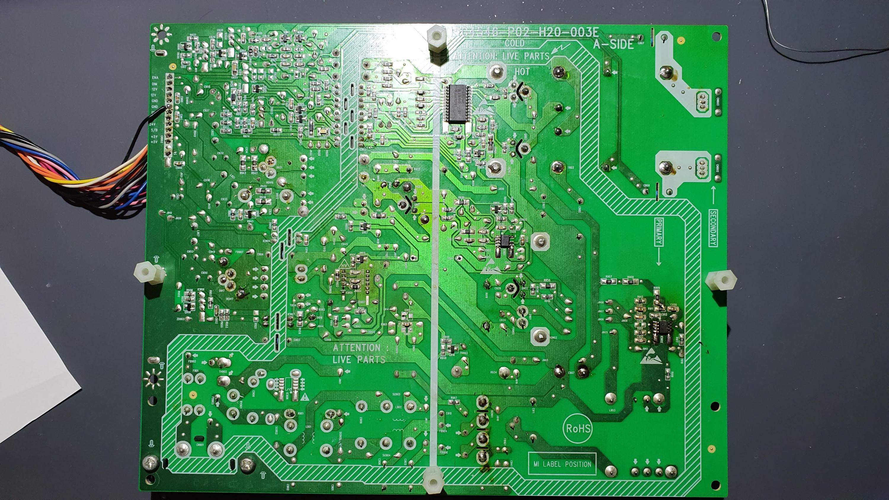

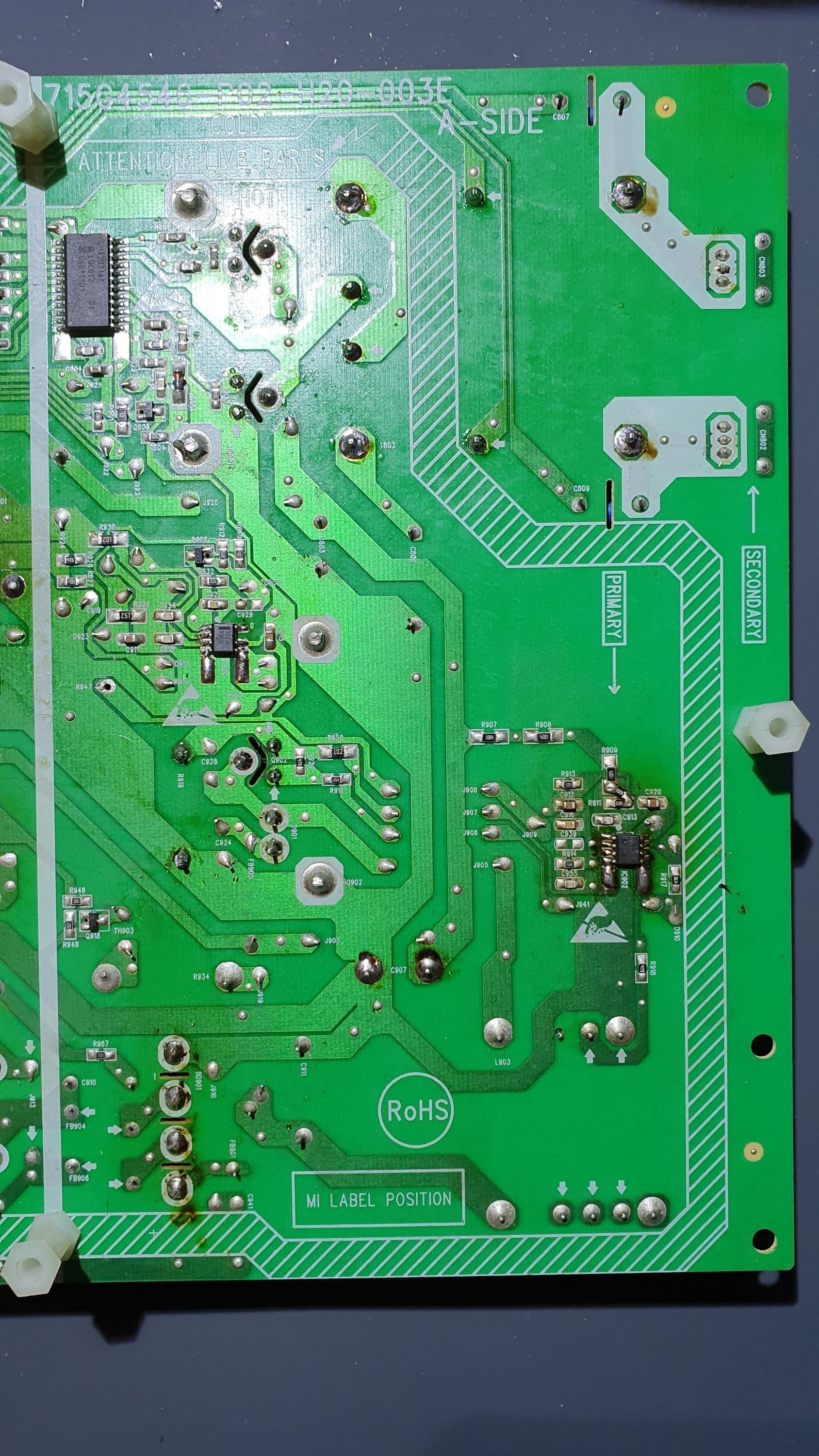

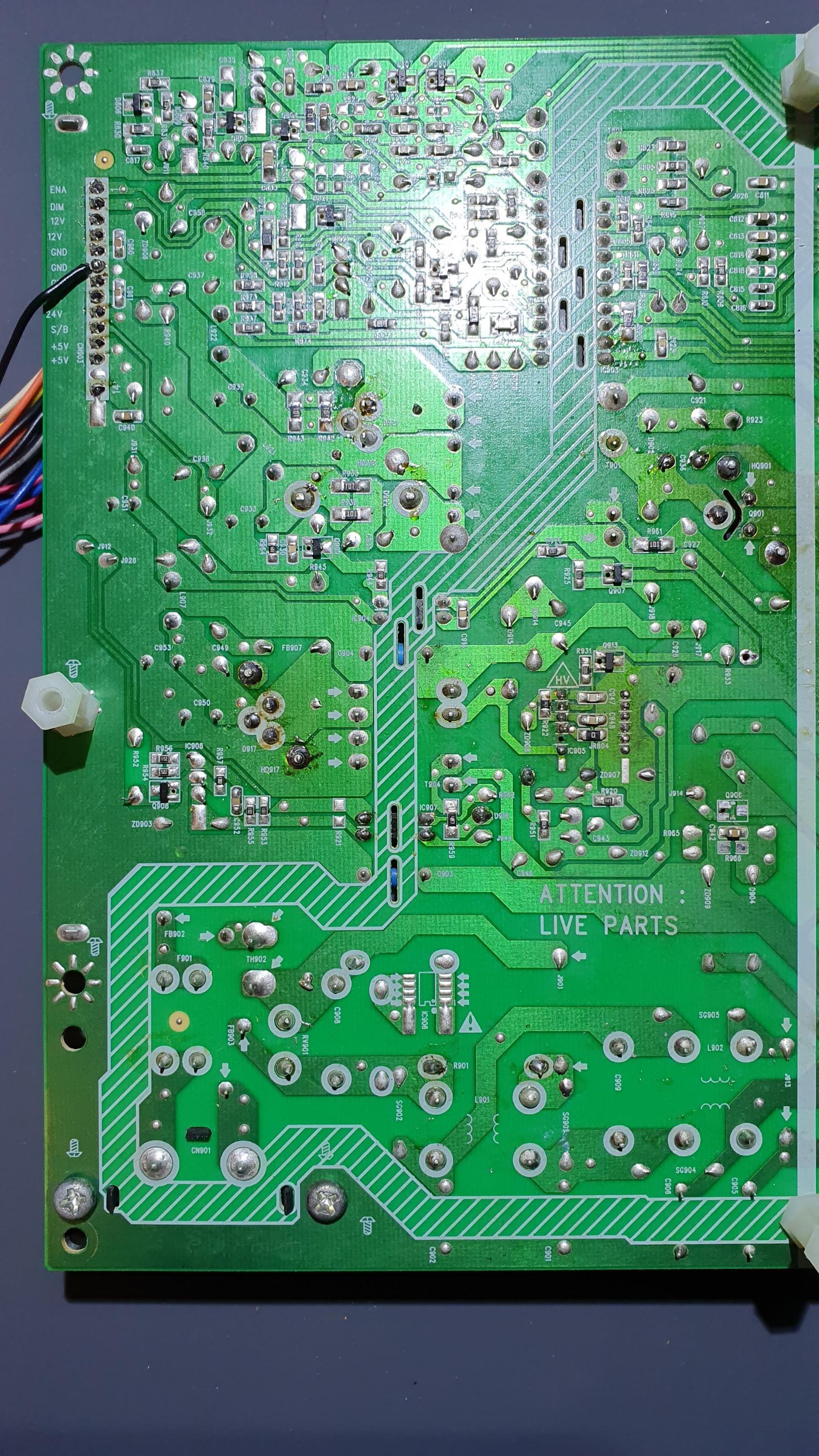

                                        #59
                                        1) Leave out R966 and Q906 of the brownout circuit, we do not need them right now for the circuit to function.
                                        2) Remove R947 (4.7R), R965 (2M2).
                                        3) "Still dont understand why D901 and Q902 and R919 exploded when i replaced IC901/902" Something was done wrong or bad parts, but we will deal with that later, right now we need to get the 5V standby working first.
                                        4) I also need high res pictures of the whole bottom side of the board you are working on so I can see the soldering works that were done to the board.
