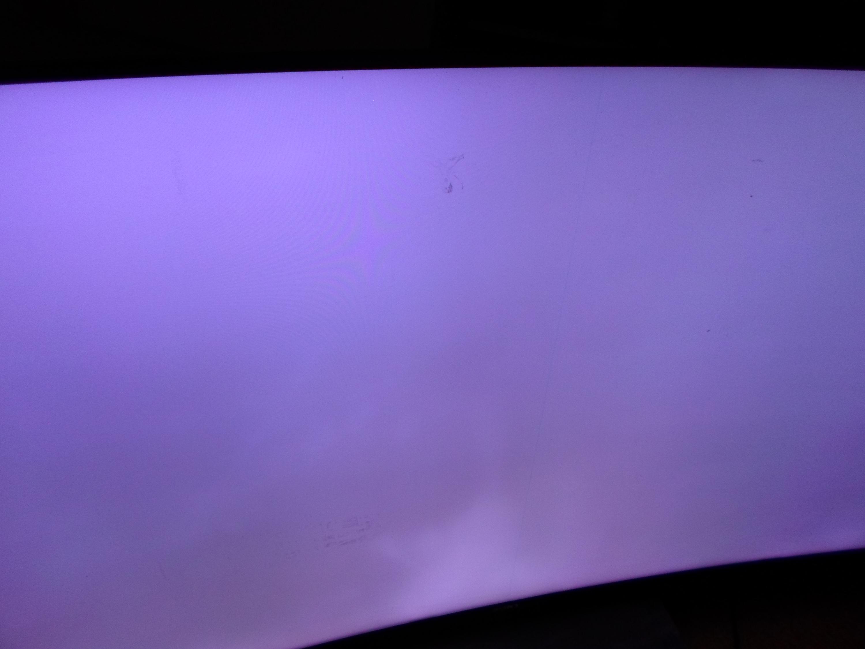

    Hi!My Sony Bravia Kd55Sd8505 2times red blinking!what is a problem?how i can repair that?
    After flash usb they turning on but only backlight, remote and sound works,no picture! only one vertical line by the center!Please help me somebody who knows what kind of problem!I will very appreciate!

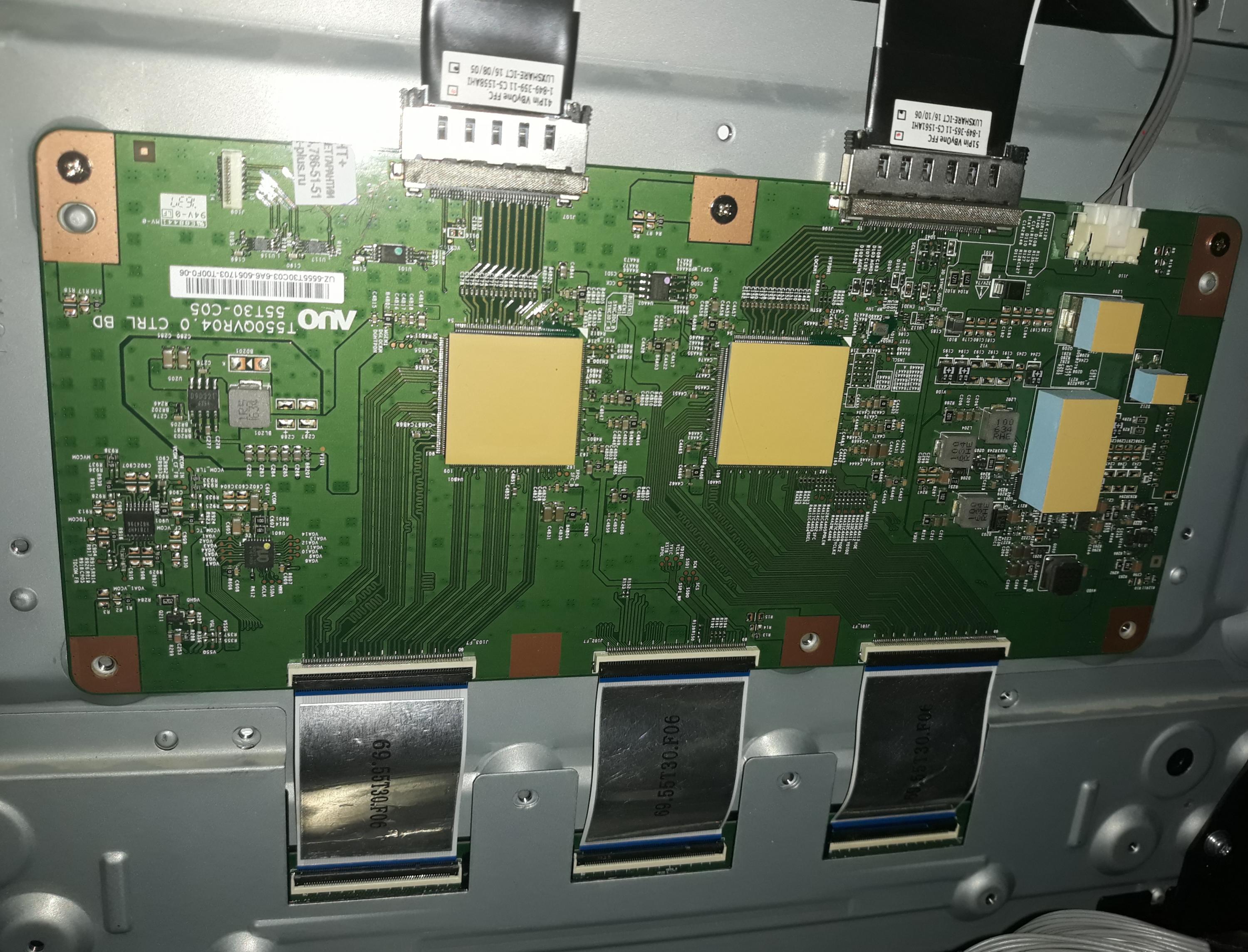

                        Can we see good clear hi-res straight shots of the whole T-CON board?

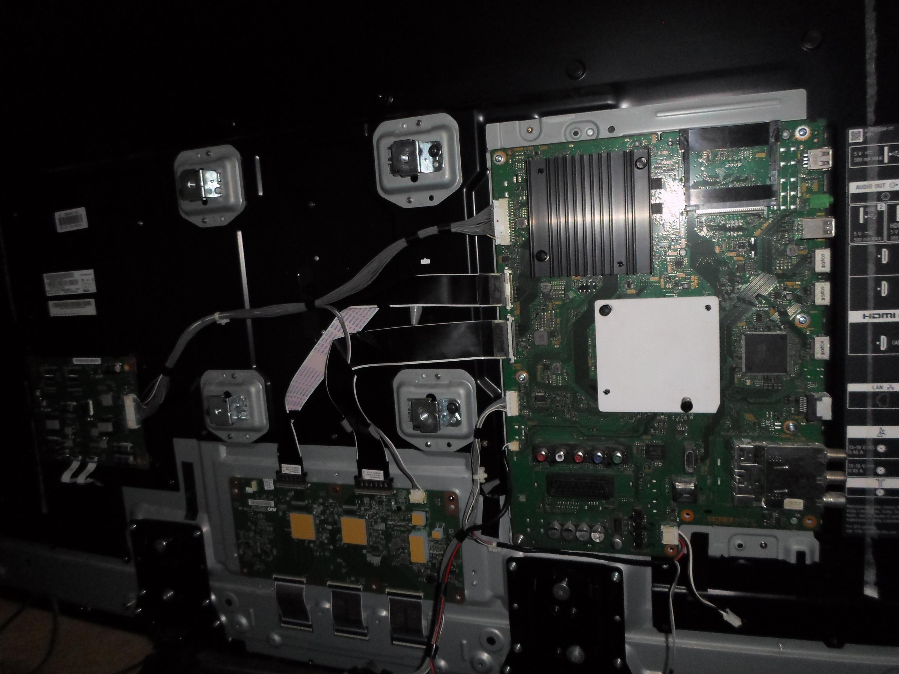

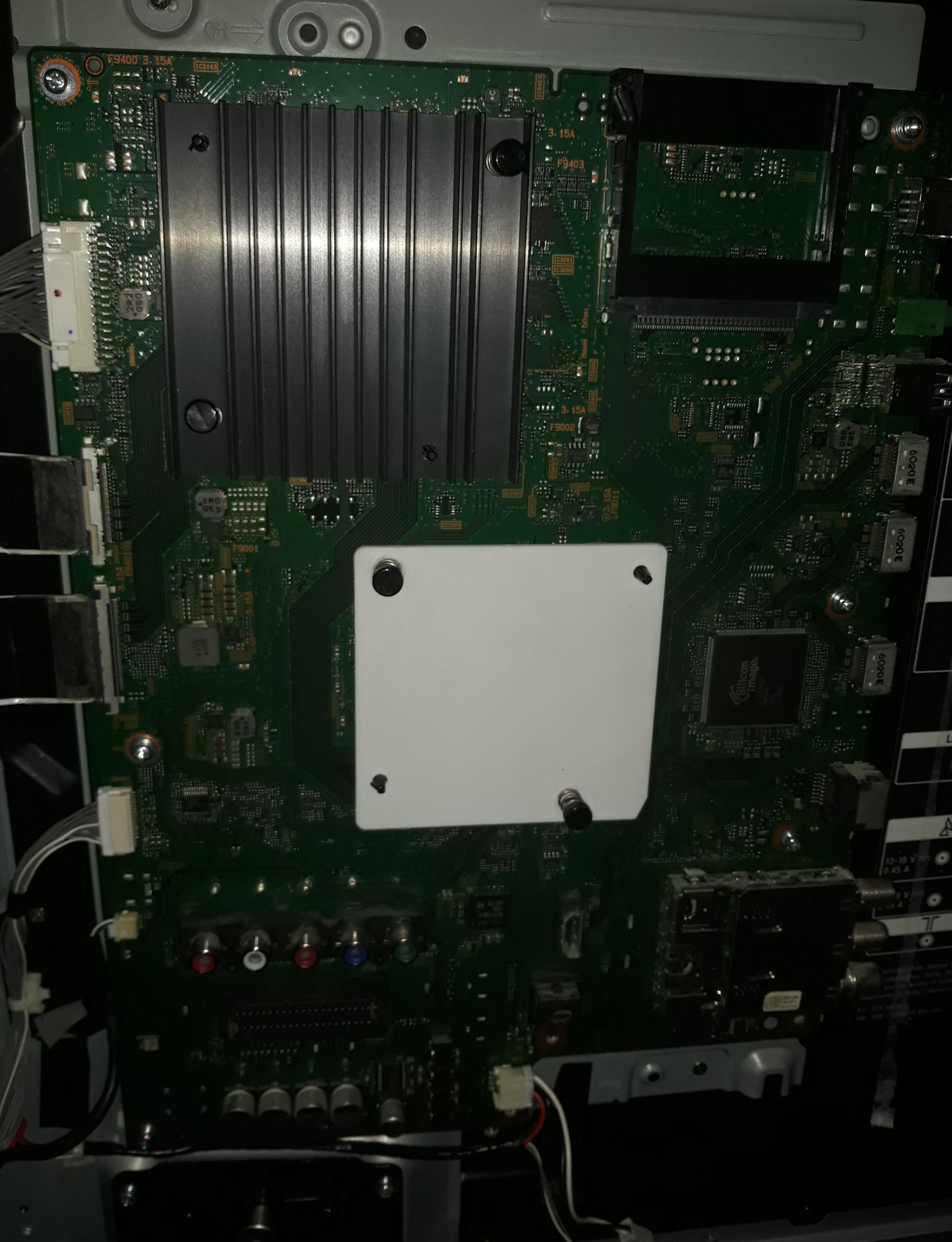

                            Re: SONY Bravia KD-55SD8505 Please HELP!
                            here they are
                            • goluins
                              • Jul 2020
                              • 46
                              • Russia

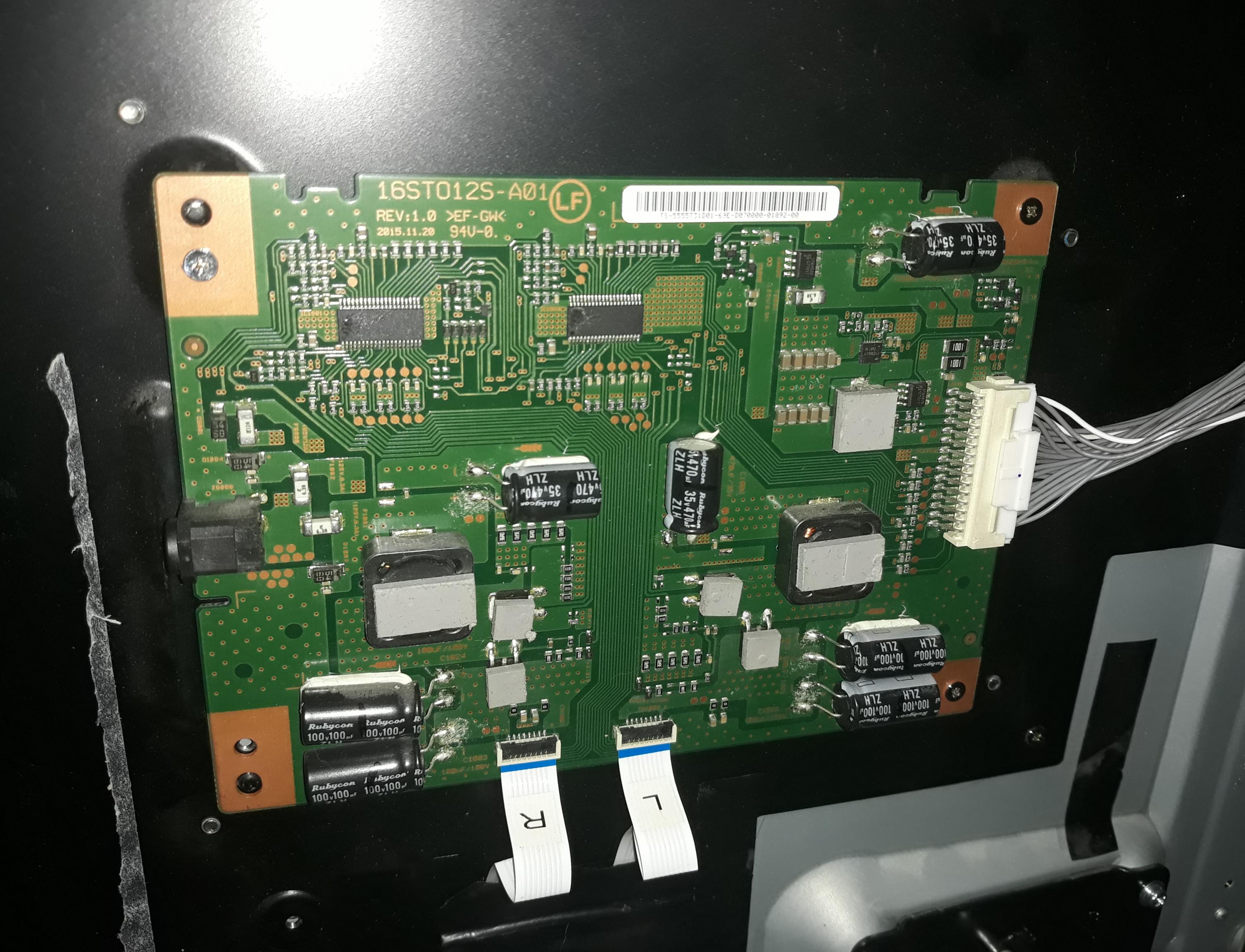

                              1-tcon 2-mainboard 3-power supply with led driver
                                19.8v and 2.2v from powersup. to the mainbord! 2times red blinked!
                                    1)Yes! the 19.8V is the Voltage from the AC adapter where DC jack is
                                    2)the Voltage from the AC adapter where DC jack is!!
                                    3)no 3.3v at all!!!old t-con is on short!!
                                    4)Yes! Its only on new Tcon board!!Old tcon shows white screen and the line
                                    5)Only if I flash usb port!but after unplug and restart, 2red blinks))
