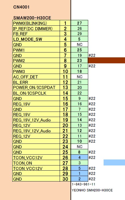

      What voltages do you have at each pin of the connector?
        Thanks! There are 19.7v on 16,18,19,21 pins and 2,2v on 12!

          you need to measure every pin listed and provide the measurement for the entire list, not just ones that have "V" beside them. The others are also voltage signals.
            On my Ld board CN4001 when 2x blinking red, there voltages signals are:
            1pin-0.0v
            2pin-0.0v
            3pin-0.0v
            4pin-0.0v
            5pin-0.0v
            6pin-0.0v
            7pin-0.0v
            8pin-0.0v
            9pin-0.0v
            10pin-0.0v
            11pin-0.0v
            12pin-2.2v
            13pin-0.0v
            14pin-0.0v
            15pin-0.0v
            16pin-19.7v
            17pin-0.0v
            18pin-19.7v
            19pin-19.7v
            20pin-0.0v
            21pin-19.7v
            22pin-0.0v
            23pin-0.0v
            24pin-0.0v
            25pin-0.0v
            26pin-0.0v
            27pin-0.0v
            28pin-0.0v
            29pin-0.0v
            30pin-0.0v

              can you post a picture of your power adapter showing the labeling?
              Further, the list of measurements that you just posted, is that with the set flashing the 2 led blinks? Earlier, you say that there is no 3.3v... where exactly are you checking for this... ie. which connector and board? One other check, at the usb connector, check / measure voltages at all pins and list result.
              Your pictures of the boards is very poorly lit... they don't have light bulbs in russia? :-)
              Can post a good lit picture of the led driver board... use some extra lighting and turn your flash on your phone off.
              The list of measurements appears to show a backlight error but the voltage seems a little off (2.2).

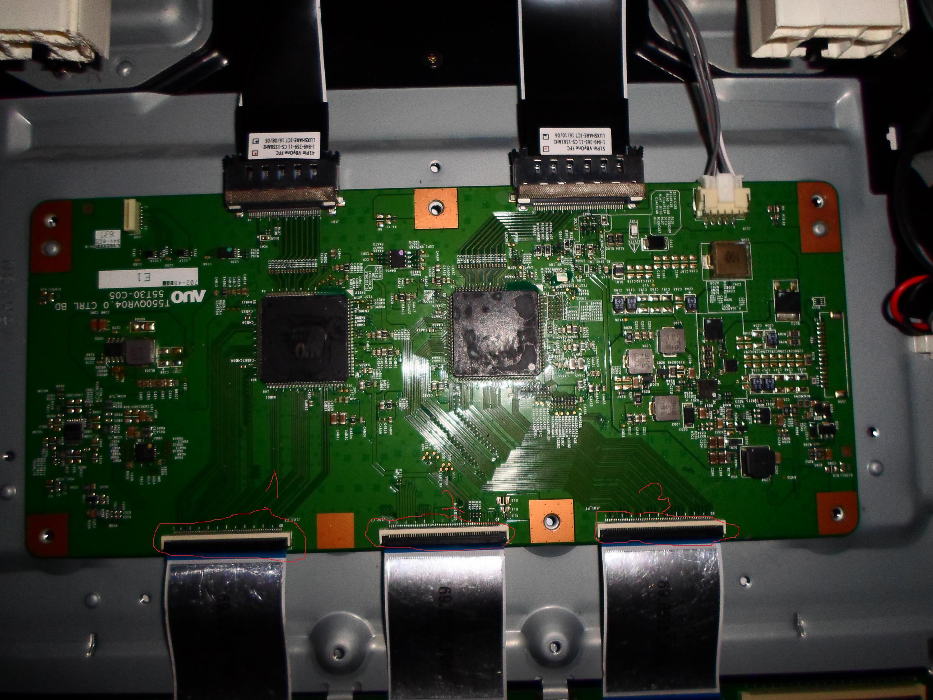

                          The problem is in lcd panel!CoF or CoG is bad!Anybody knows how can fix it?

                            not so fast.... now that I understand that you say you can get a picture for a short time when you use a usb to try to flash firmware, you need to do that again and go back to post #65.... measure pin 12 at the time when you power the set up with the usb install and watch that value until you get the 2 red flashes.
                            Why are you saying it is an lcd panel problem? which cof/cog are you seeing is bad?

                              Because the problem is in lcd panel AUO Optronics T550QVR05.0!When i got a picture for a short time when i use a usb to try to flash firmware,there is no picture!Only white screen with one vertical line and all CoF on panel is very hot!!

                                Have you got also gate CoFs? Which Cofs are hot , the source ones? In post 46 4th photo you see a testpoint named VSS1, check to which pin is connected of the tcon connector, then put a tiny piece of opaque adhesive tape on that pin to block it, do a tv test, if there is not picture then try the usb flash update, if the situation don't improves remove the stripe on that connector and put it on the same signal VSS1 on the opposite side.
