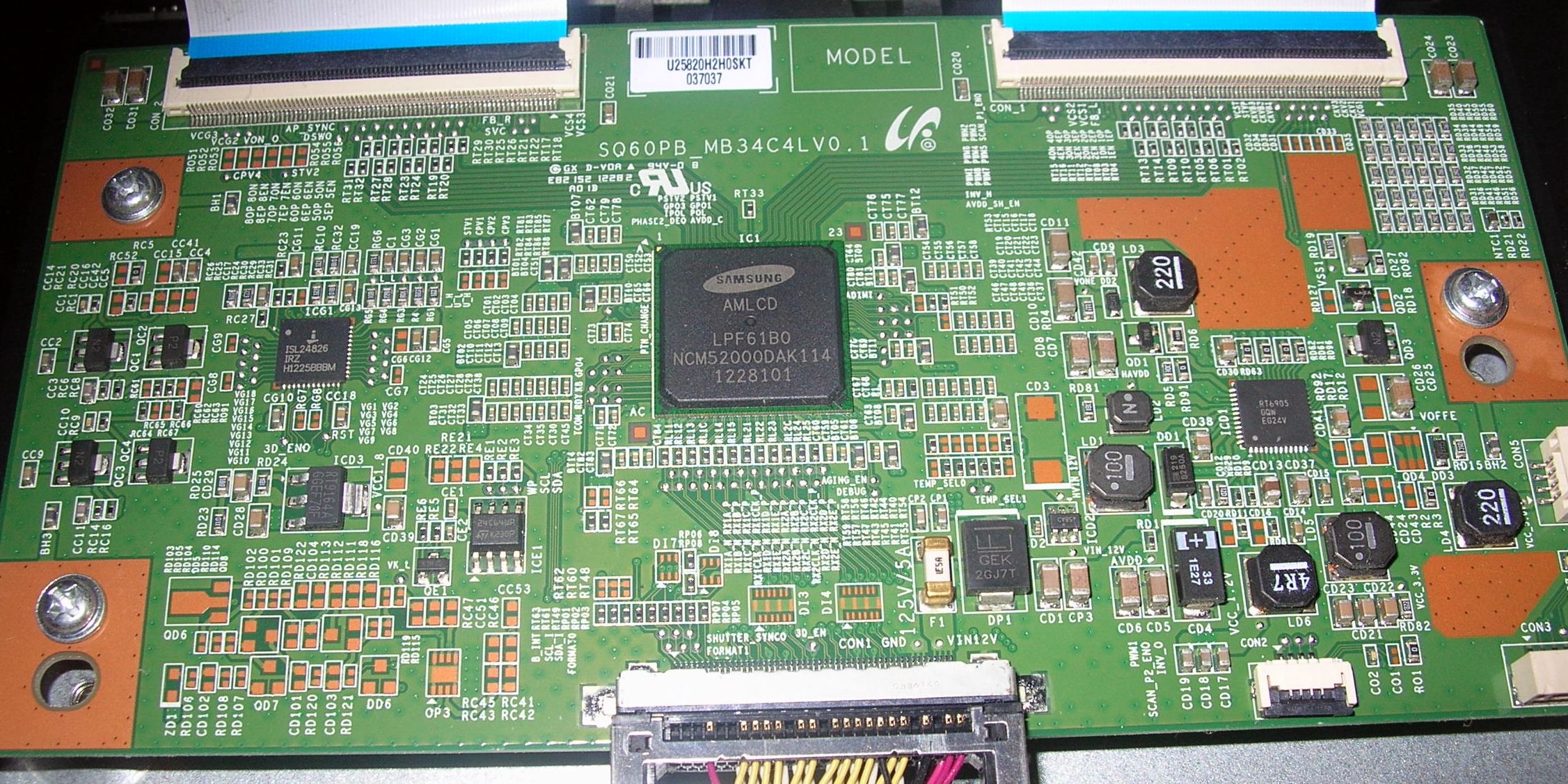

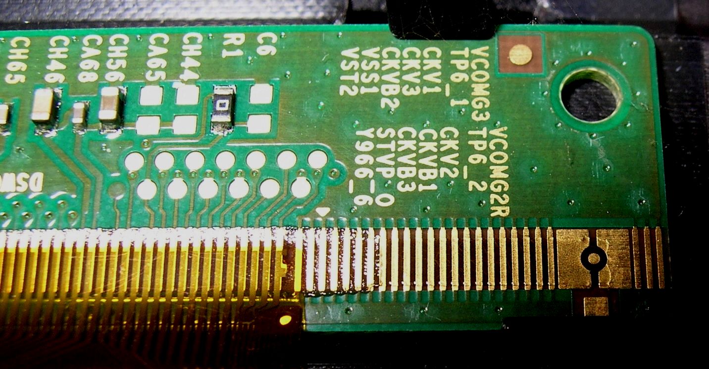

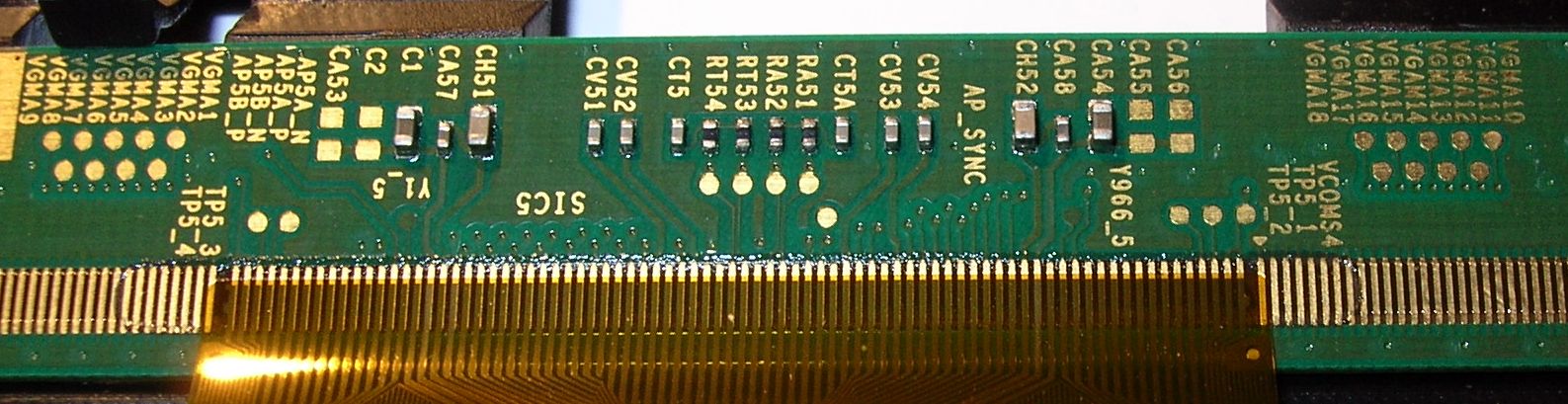

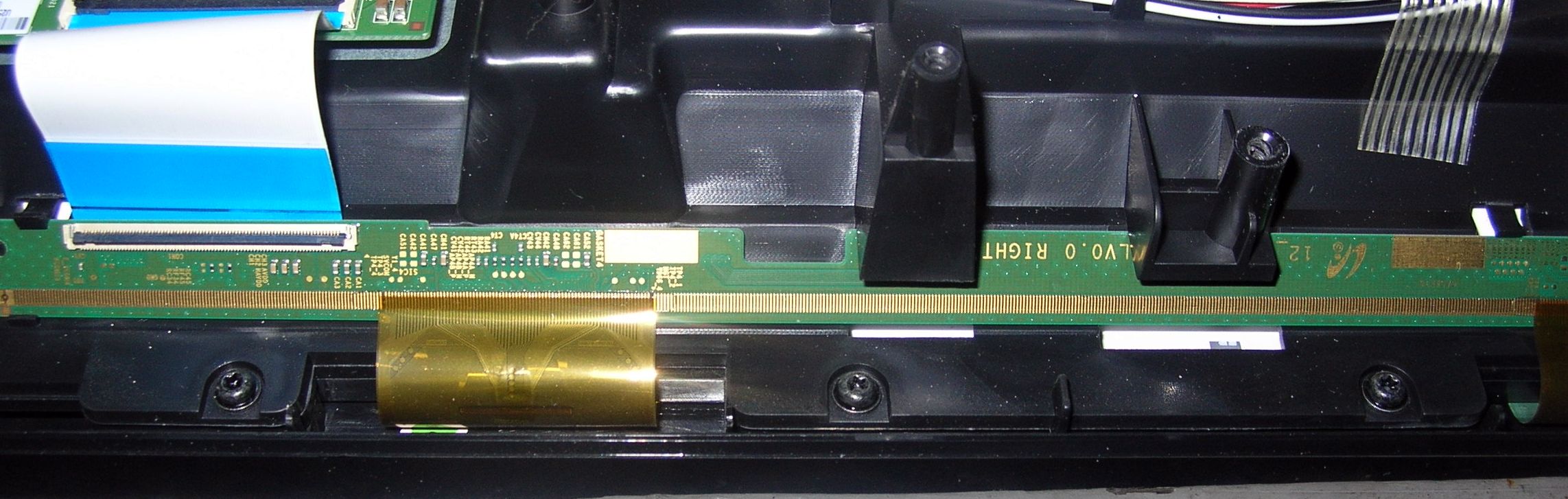

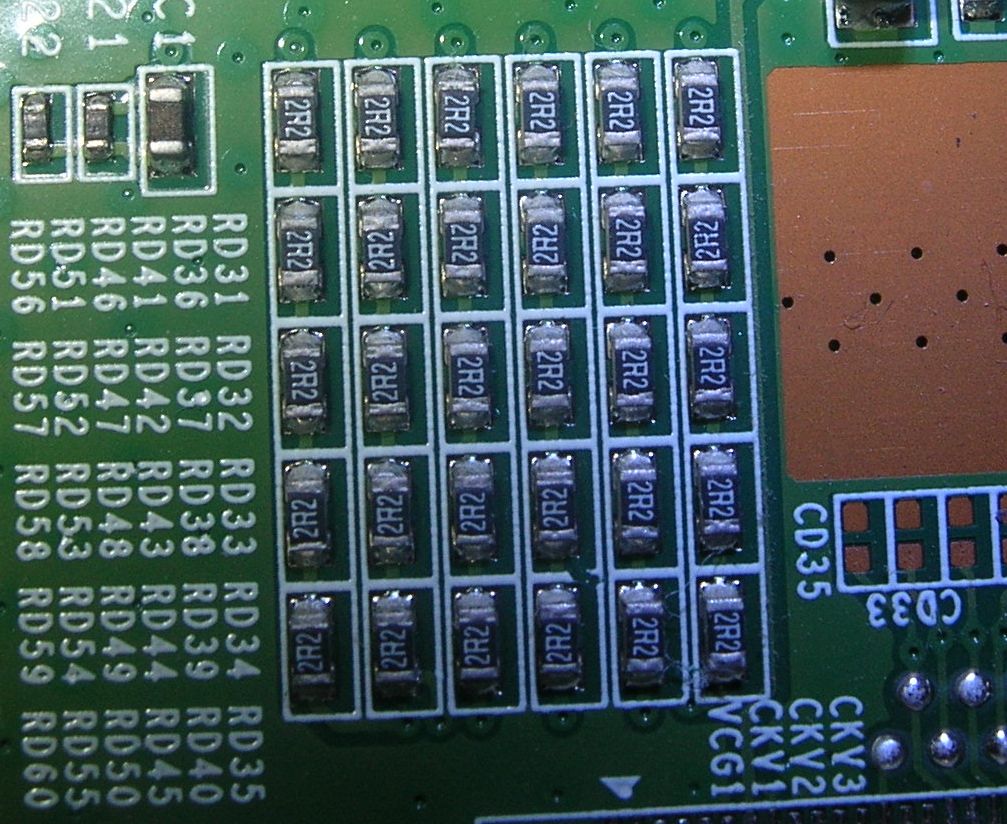

    Somebody gave me TV with bad screen, I want see if replacing t-con will fix it. I can get one from aliexpress pretty cheap - dont want invest too much in it since Im not sure if it will fix this TV. But for some reason most of Chinese sellers have this board without resistors, as it shown on this picture
    One listing I wanted to buy from (US seller) dont have resistors too (by time I opened TV to check board number it was gone ) https://www.ebay.com/itm/TCL-LE55FHD...-/333636600899
    Most of US sellers, also my TV have resistors on board, like this one https://www.ebay.com/itm/TCL-LE48FHD...1/392737451864
    But they cost 3 times more. Do I need buy one specifically with resistors, or it makes no difference? (I compared my board after I made pics and found few more missing components - some missing from my board, some from "Chinese" boards)
    Pics of my board attached, also picture of screen, one pic of full screen and t-con attached, pic with left ribbon cable removed, and pic with right cable removed.

    i will concede to others diagnosis since im still learning my self to pinpoint without a doubt....but for the guessing game...
    this is a panel failure i.m.o.

      Horizontal lines are panel failures. You can connect one side at a time to see if one side is good. If yes, you can try the tape cutoff method on the bad side.

          It is too much hurt to input a video source instead of a poor all blue image?
          Anyway its 100% panel failure. The half connected screen test may not work on theese panels, if not make a photograph of the out part of the screen internal pcb, the long thin one, one is enough, them are almost equal.

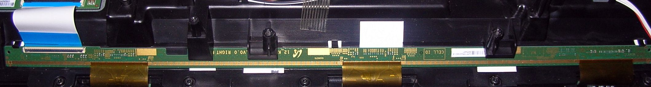

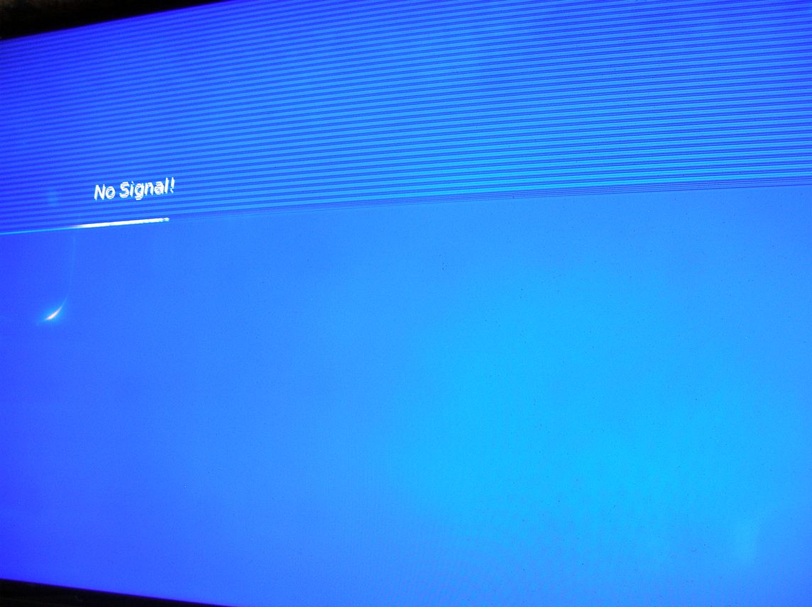

            Re: TLC LE48FHDF3300Z Horizontal lines - question about T-Con

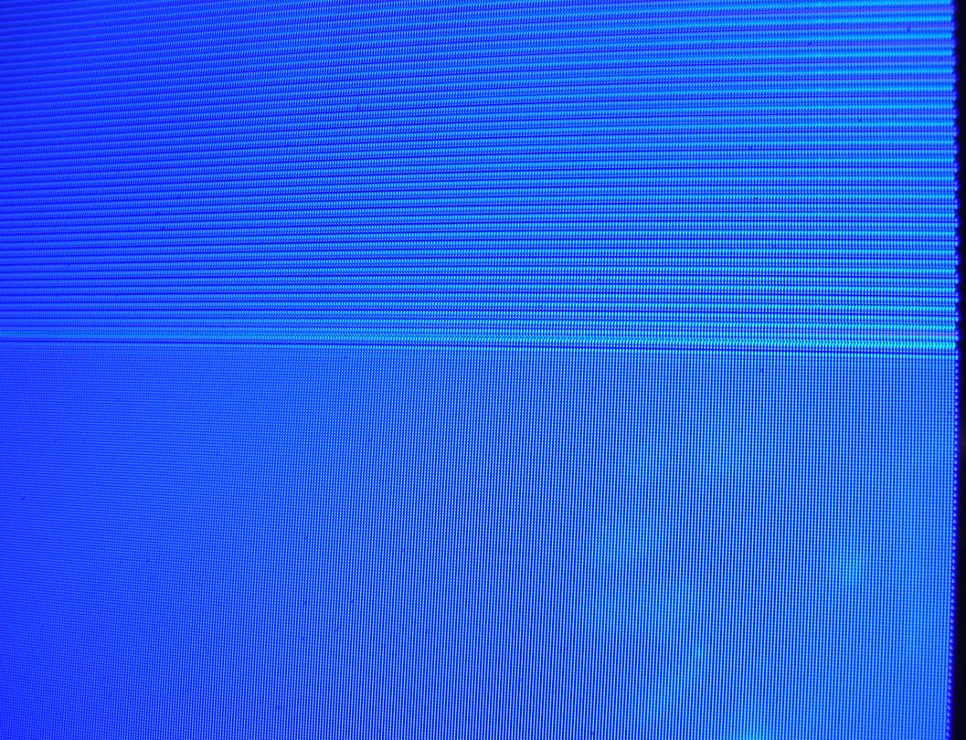

            I did, it shown on pictures 4 and 5. One side clears up, just one line on middle still there. What is "tape cutoff method"?
                With one side disconnected, you should only see half a screen.
                  I did, those halves on pics 4 and 5, I not made pics of full screen on those, just visible parts.

                    If you have lines from both sides, then the cutoff method probably won't work.

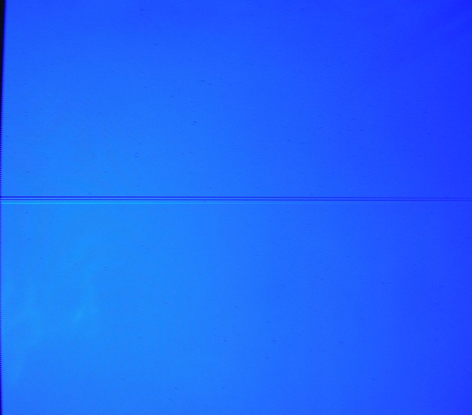

                      On pic #5 all lines are gone, just one single line on middle remains.

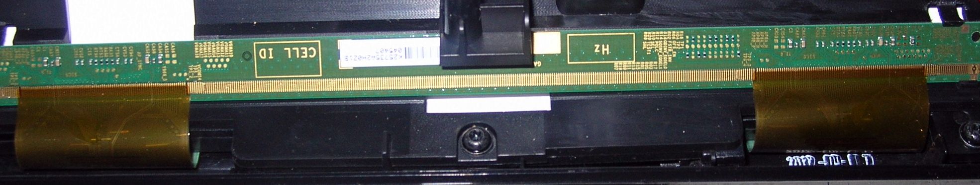

                        OK sorry it's a little hard to follow the forum on a telephone, now i'm on PC and i can see better, your last pictures reveals that you can't fix 100% the fault, but at least you can let the big part of the lines to go away. So make a photograph of the outer part of the screen's internal pcb, the long tight one, one of the two is enough, them are almost equal. Silkscreens are to be visible.

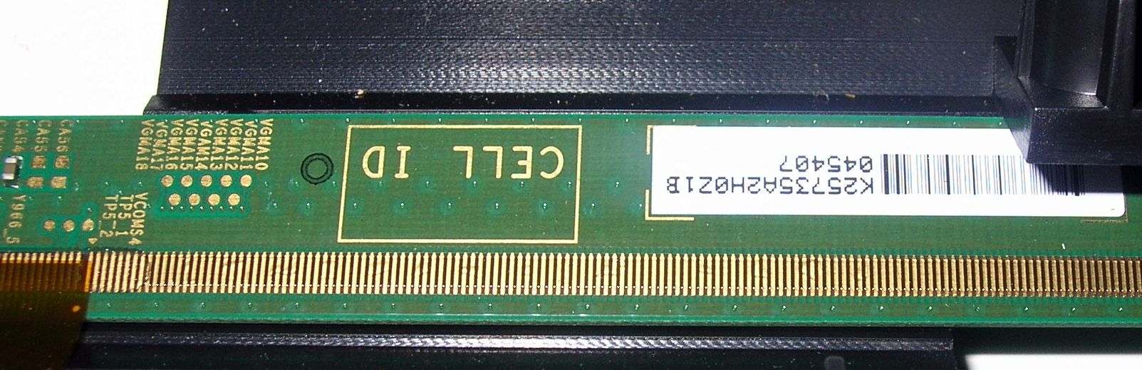

                        In photo 3 there is a curved line with backlight passign through, is it a scratch or a crack?

                          On pic 3 just reflection of chair with chrome legs that stands near it. It have no cracks. Attached pics are of one of those boards - full one and few close ups.

                            The blue connector there looks a little off kilter, make sure it's ok and not out of alignment.
                            • sansonet
                              • Nov 2013
                              • 245
                              • US
                              Its not connected, I never connected it back after making pics.

                                Ok, that explains it.

                                  you do need to post pictures of the entire screen when you do the "cable disconnect tests" so that the forum can see what is exactly happening to the screen.

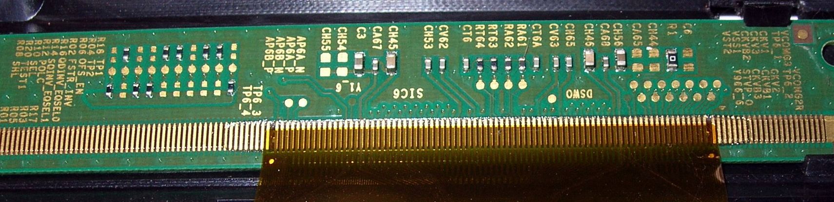

                                      OK, as you can see from pictures many silkscreens are not visible, are there no sunny days there where to make photos whitout flash? i need the outer half of the board, near the side.

                                        OK, tried it again... Location is near side flex cable (first two pics) and middle cable (pic #3)
