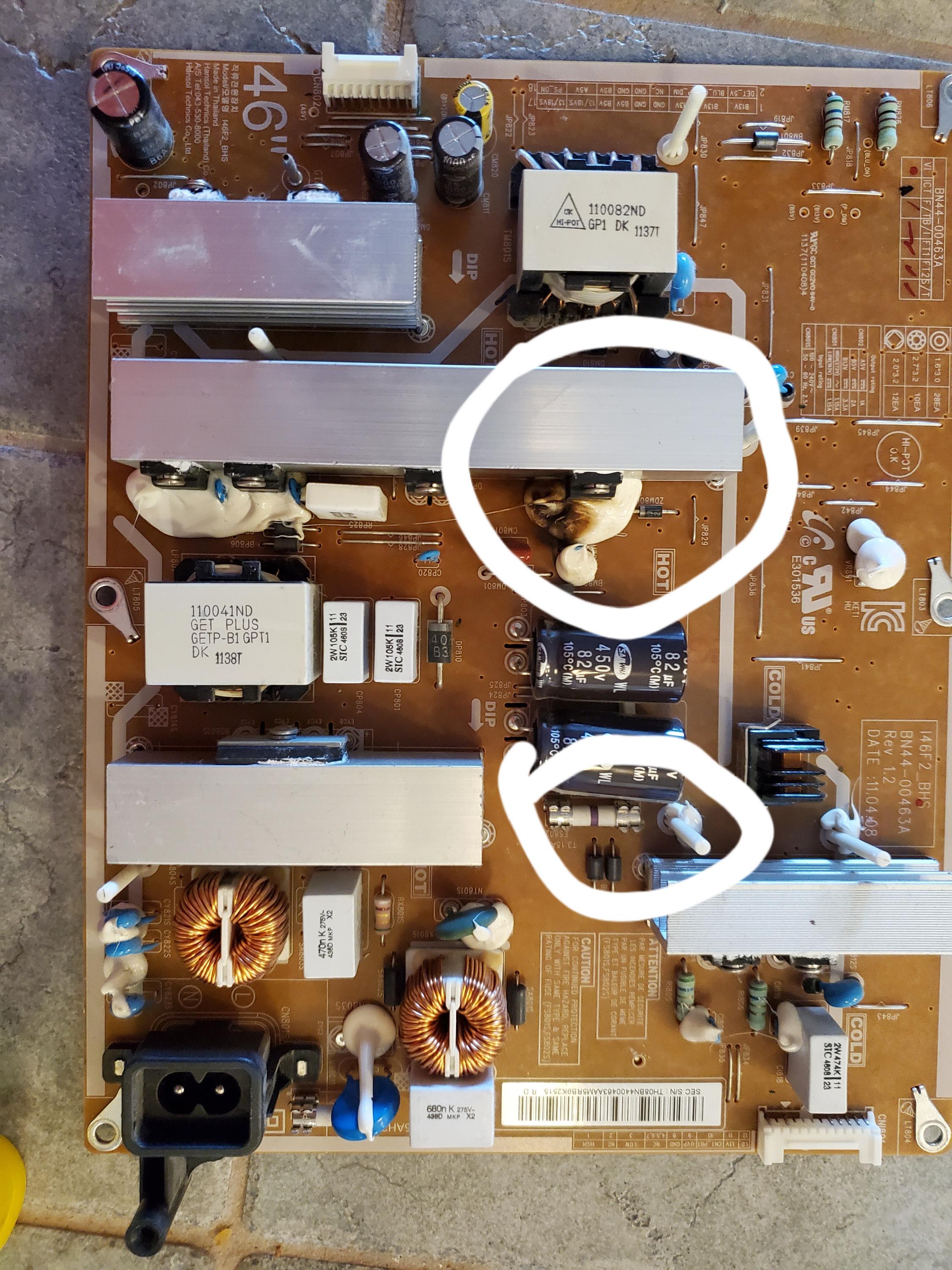

    samsung ln46d630 power supply fuse blown and burn mark
    picked up this curb alert TV. Looks like the fuse is blown, i don't have a fuse to replace is with, is it safe to short with something just to test it? There is also a burn mark in the white glue near a transistor so maybe the transistor is gone as well. Attached is a picture with the burn circled as well as the fuse that is blown.
    Board is labeled as: BN44-00463A
    What's my next best steps?
    Thanks.

    Re: samsung ln46d630 power supply fuse blown and burn mark
    Remove the glue around the burnt area to see what is damaged.
    Do not use something in place of the fuse just to test, it clearly blew for a reason and you're likely to do more damage.

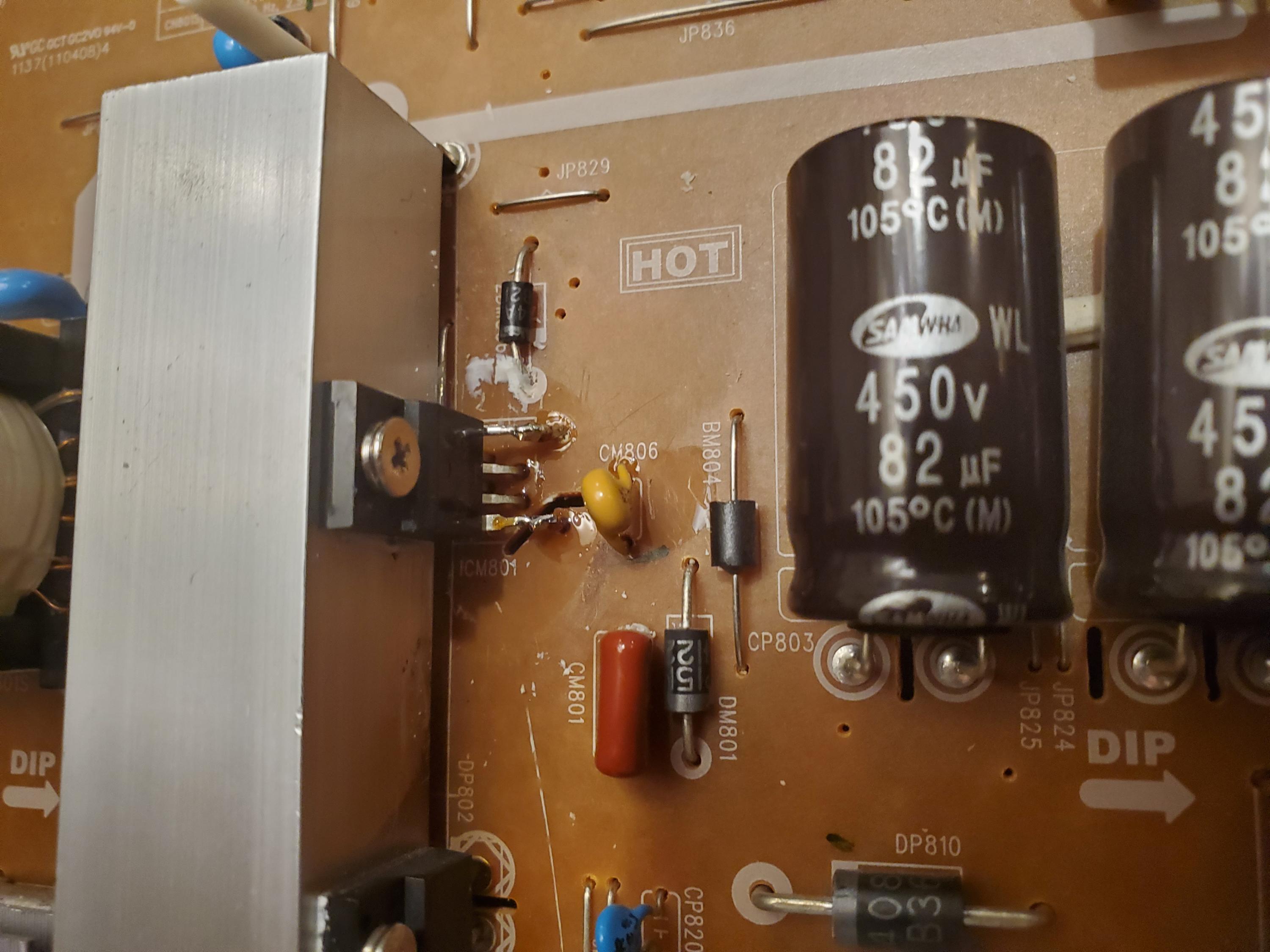

        Here is what's under the glue. It seems like the left pin on the transistor is shorted to ground. I'm not getting a zero reading but it's close. Also looks like the blue ceramic resistor has a chip taken out of it. Looks like it burn out the side of the transistor. What is that white glue for? Is it too prevent fires?
        Transistor looks like it says CM0465R
          Yes that transistor is shorted. The glue is to prevent dust that may accumulate between high voltage pins from igniting. I have seen it a few times usually from tvs with indoor smokers.
          If you bypassed that fuse, you could have tripped your circuit breaker in your house by plugging it in since you are shorting the AC. I use a plug in GFCI outlet for dodgy power supplies based on recommendations here.
            It looks like the blue disk snubber cap had shorted out, remove it and see if the shorts goes away.
            BTW, FSCM0465 is a SMPS IC not MOSFET. You need to check the internal MOSFET of that IC to see if it is shorted out or not

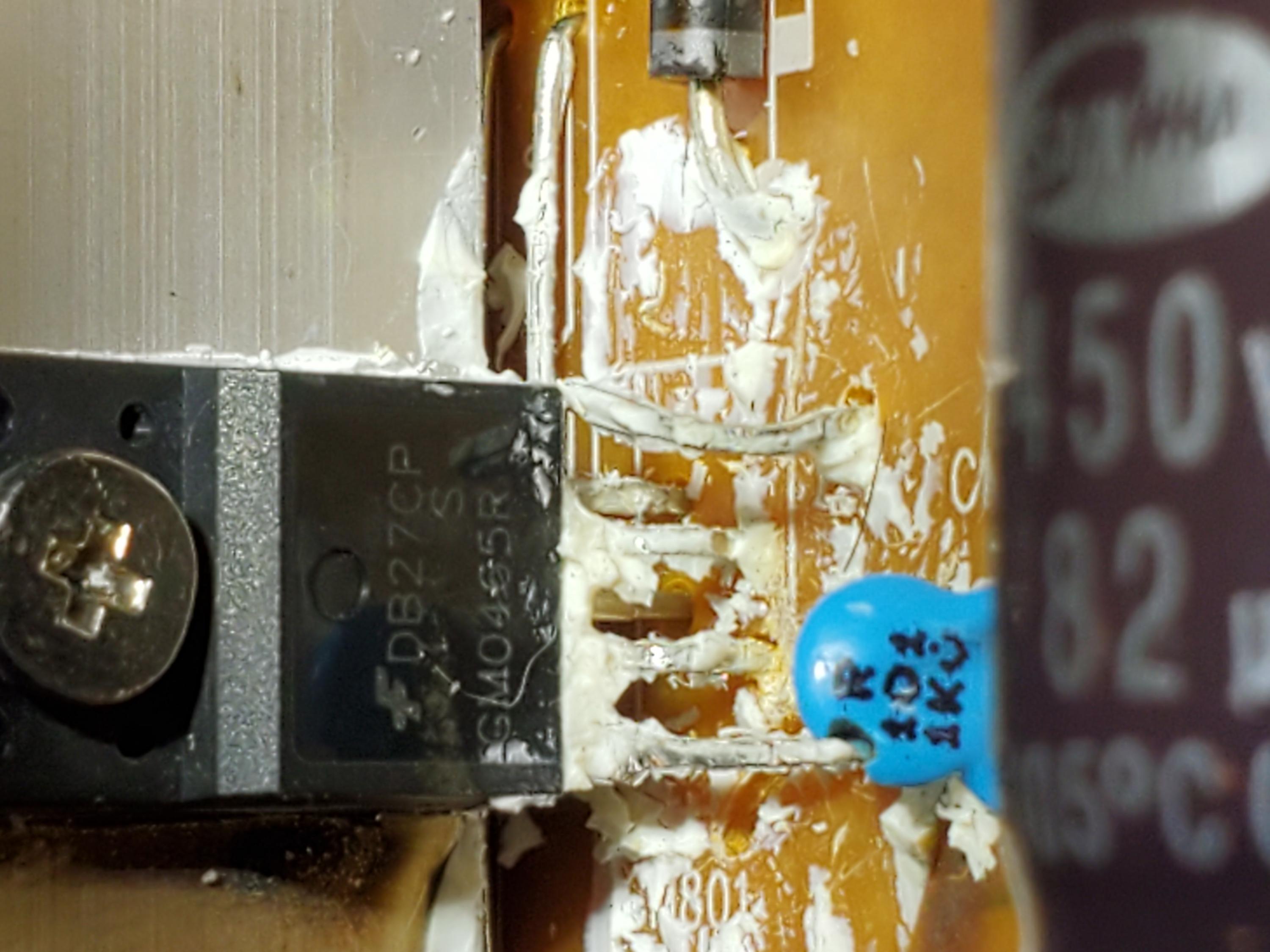

              Ok I'll remove the blue disk tomorrow and check for the short. How do I check the mosfet of the IC? The right pin on the IC broke when I was removing the glue.
              Here is a better picture. How do Find a compatible blue cap. It looks like it says 101 1K.

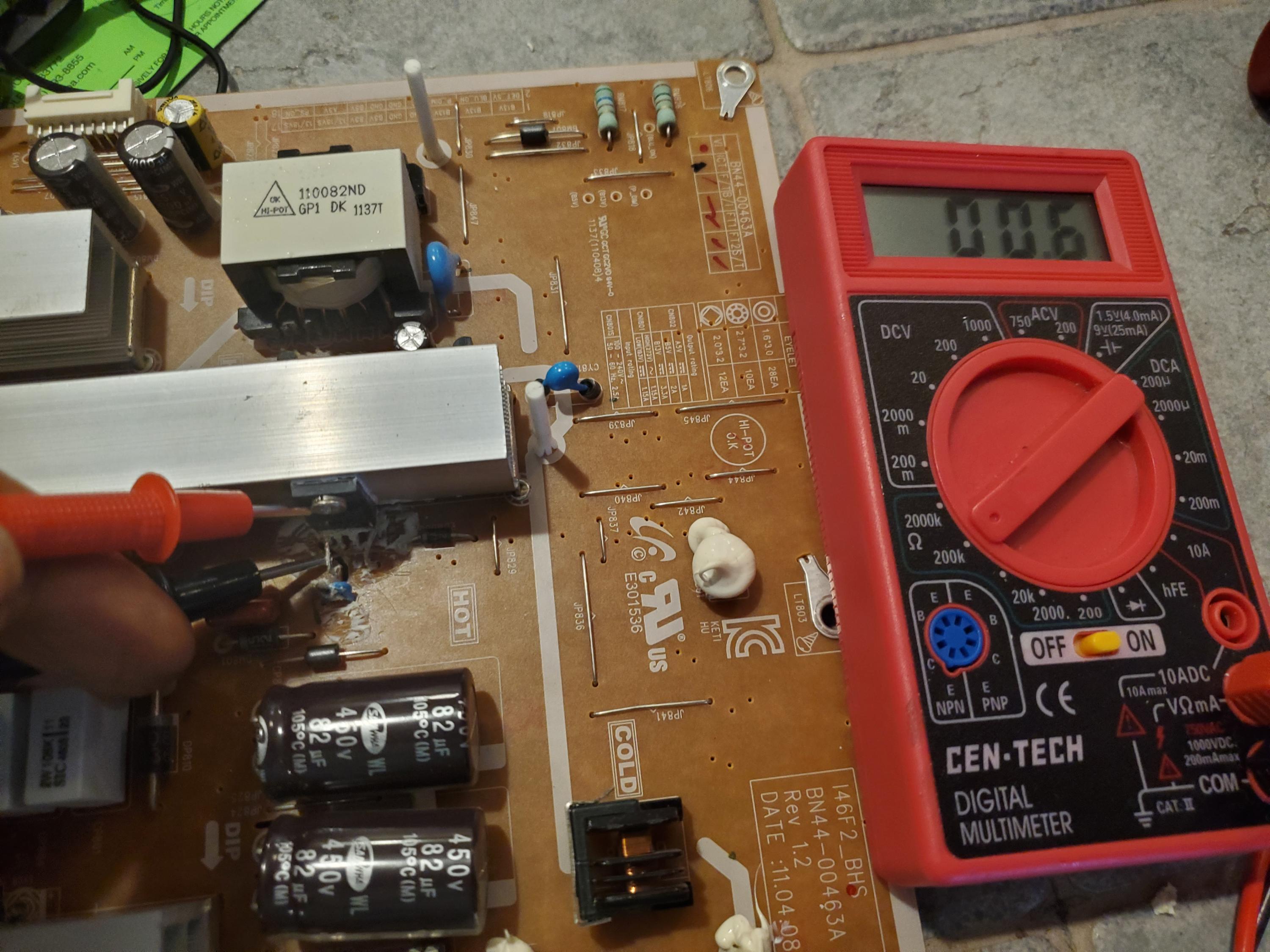

                1) So did you check the the resistance of that blue disk cap to see if it shows as shorts?
                2) The inetrnal MOSFET can be checked for shorts by measuring pin 1 and pin 2 of that IC, see the spec sheet I provide that shows the pinout of the IC. BTW, if you test it again without the blue cap in place as you did in your post #4, does it show as shorts?
                3) The blue high Voltage ceramic cap is 100pF 1000V, I would replace it with 2000V rating instead.
                  The blue cap is measuring around 2k ohms. I removed it from the board and the short is gone.
                  I measured between pins 1 & 2 on the IC and there is no short there. Unfortunatly since i broke off a pin when removing the glue i also removed the IC.
                  Also i misread the IC it's actually a GM0465R (GM not CM).

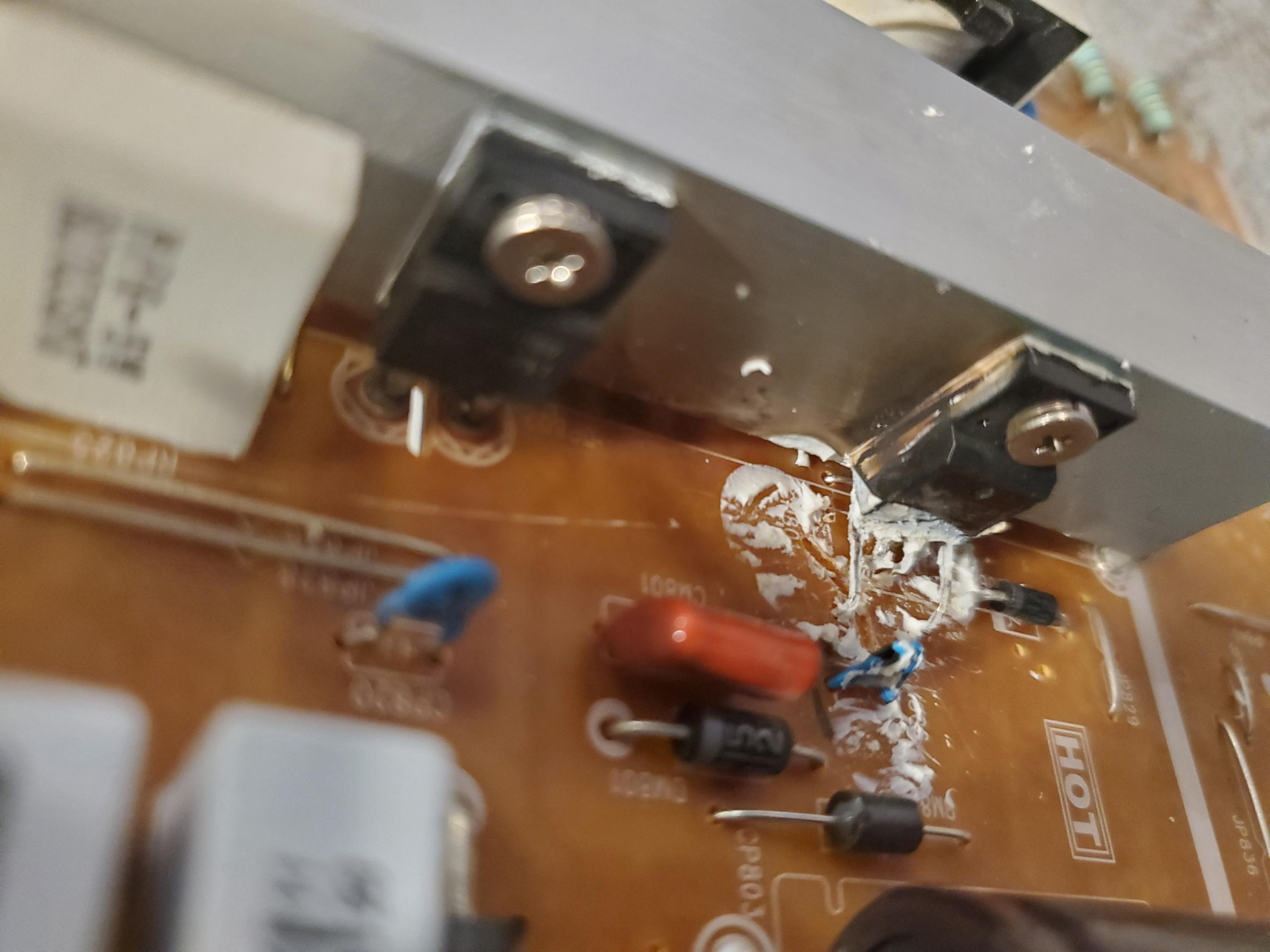

                                        Ok guys parts came today. two of the IC pins were a little bit short so I had to solder on some extensions made from the disk capacitor pins. I got everything soldered on and I checked for the short and it was gone. I got everything assembled back together and turned the TV on and it worked! I attached a pic of the extensions to the IC pins. I think they should be ok.
                                        Thanks for all the help guys. You are all awesome!
