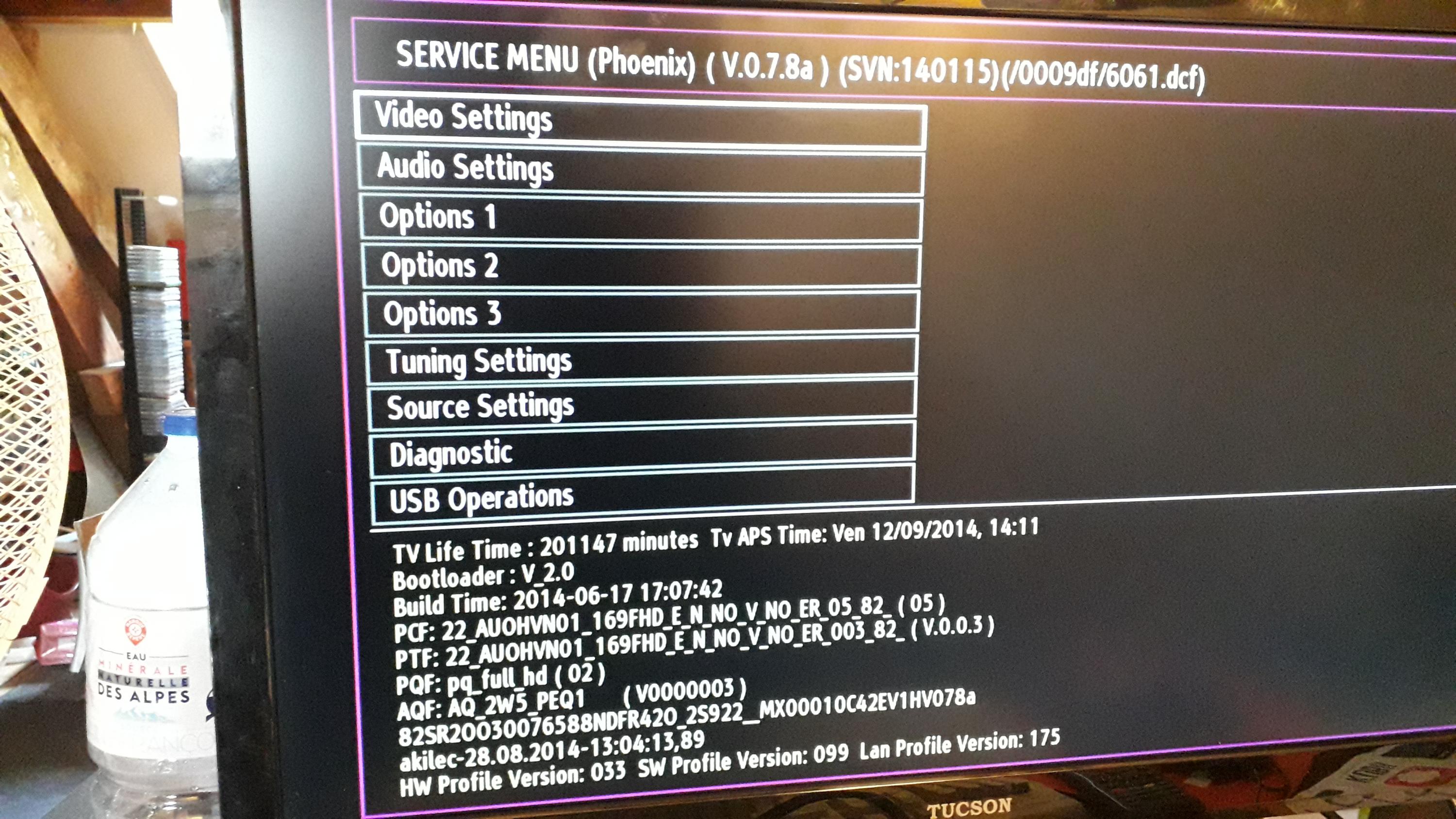

        • yokoono
          • Apr 2010
          • 475
          Re: 17MB82S : Detected but no signal
          Type MENU and 4725 and put a picture.
          • novak2
            • Jul 2020
            • 32
            • France
            I'm at work right now, but in 2h you will have it.
            What I remember if it can help :
            Version is 0.7.8
            Over 3000 hours of life time.
            But just wait for the picture thanks
            • novak2
              • Jul 2020
              • 32
              • France
              Here you have it, the service menu.
              • yokoono
                • Apr 2010
                • 475
                Latest software version: 1.3.7. Type MENU and 1505 and install.
