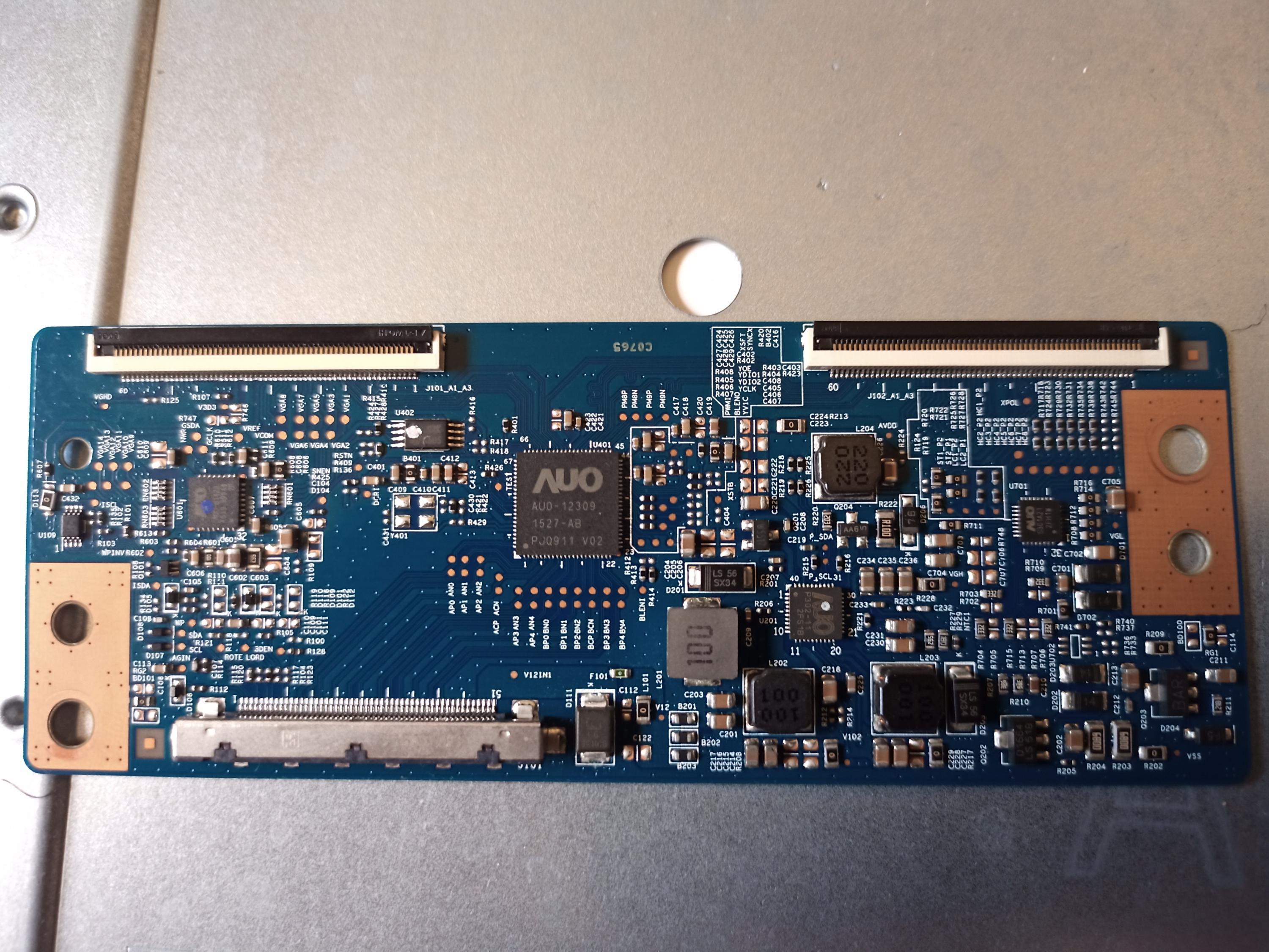

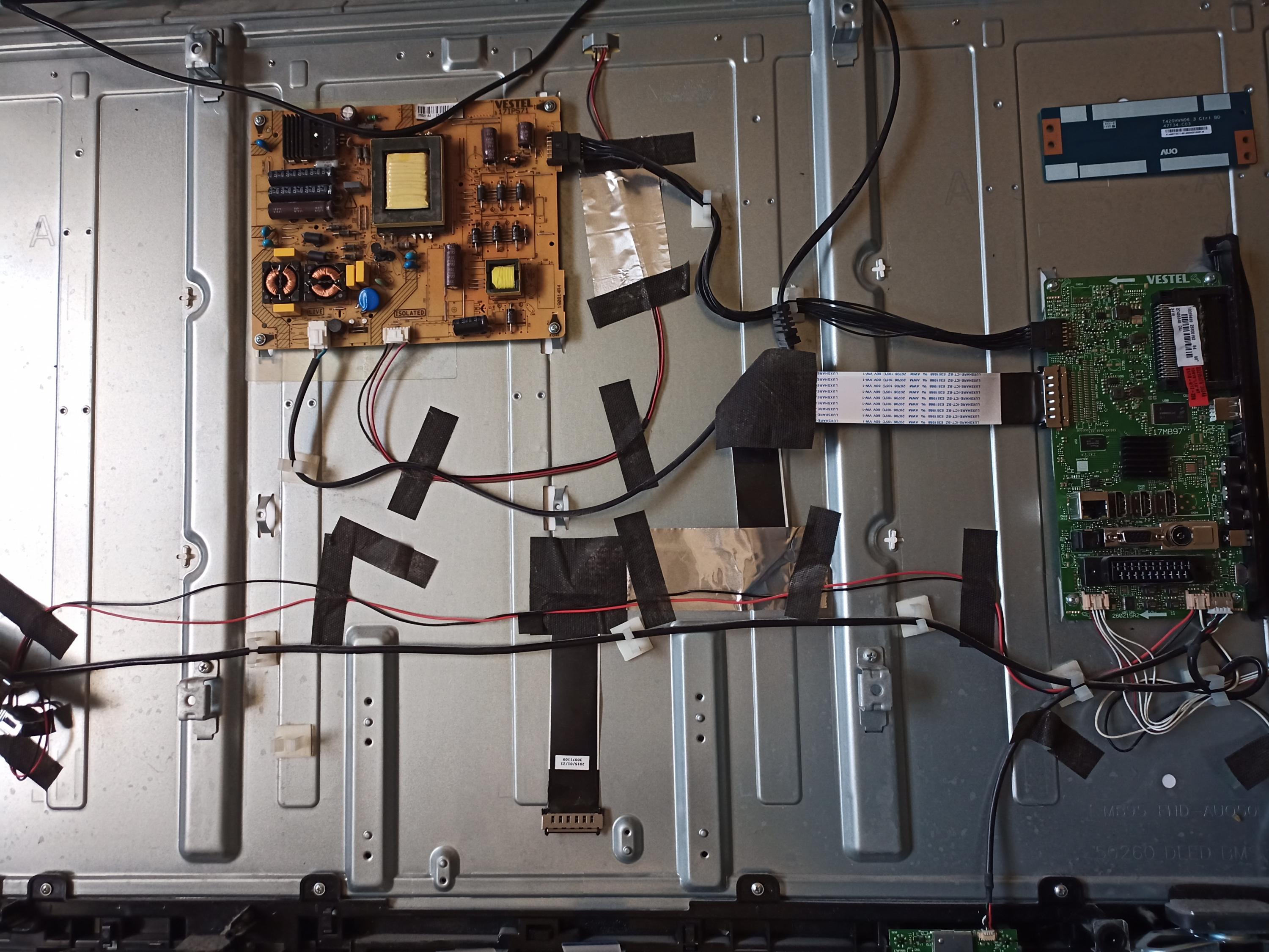

    Hello, I was recently given this tv by a family member.
    model LUXOR LUX0150004 01
    screen VES500UNDA 2D N03
    Power 17IPS71
    MB 17MB95

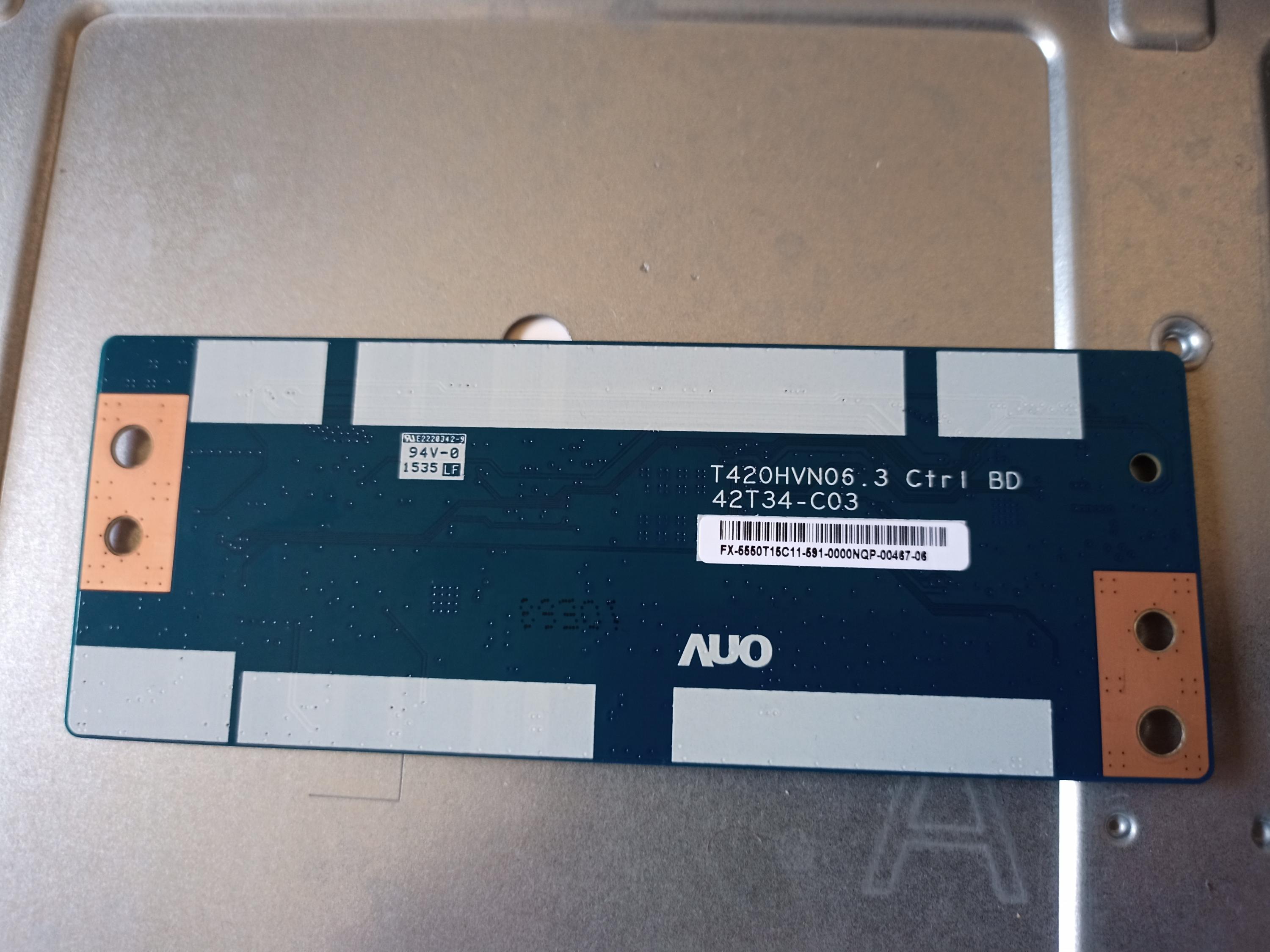

    TCON T420HVN06.3 CTRL BD 42T34-C03
    I have only carried out basic repairs to tvs in the past. Changing capacitors and LEDs ect. And have not yet come across this fault.
    The backlights light, the tv responds to the remote indicating the software is ok but no picture. Always a blank screen.
    As per the advice on other similar threads I removed and cleaned the contacts on the LVDS cable to no avail. I have also attempted to remove each of the 2 ribbon cables coming out of the TCON board to still have the same blank screen.
    I am thinking I have a panel fault or a faulty TCON board. I have no idea how to identify the small components on there or how to test / verify this.
    Please see attached pictures of the TCON board.
    Any advice is greatly appreciated, Thanks.

    Did you verify that you do have 12v dc at both ends of the SMD fuse of the T-CON board with ref to chassis gnd?
    If you do have 12V DC, then what do see on the screen if you have only one cable between the T-CON and the LCD panel connected one at at time?

        You can check you have 12 volts at the test points V12INI and V12

          Yes 12 volts at v12IN1 and V12
          If I unplug each of the ribbon cables there is no change to the blank screen

                    The Tcon has a number of test points where you can take a reading with your meter.
                    VGH by C704
                    VGL by C702
                    VSS by R202
                    AVDD by L204
                    AGIN by C113
                    Perhaps someone could interpret the results as to whether or not they look normal for the tcon.

                      Re: Vestel 50 inch LED backlight, Sound, No picture.
                      VGH 0.18v
                      VGL 0.16V
                      VSS 0.02V
                      AVDD 0.34V
                      AGIN 0.00V
                      The above voltages were taken with the tcon connected to the pannel
                      Below with the pannel disconnected.
                      VGH 1.25
                      VGL 0.05
                      VSS 0.00
                      AVDD 1.34
                      AGIN 0.00

                          Those voltage are really low and would be immediately suspecting the Tcon is at fault.
                          These are a typical Tcon voltage given by another member but obviously for his Tcon however the voltages I would expect to be within the range shown.
                          T-con voltages (typical)
                          1. Vin (Vcc): 12Vdc or 5Vdc
                          2. Vlogic,LCM, Vddd,VCC): 3.3Vdc
                          3. Vda (Vs, Vsource,VDD, Vdda,Avdd): 14Vdc~20Vdc
                          4. Vgh (Vgon,VGHR, Von, Vddg): 20Vdc~30Vdc
                          5. Vgl (Vgoff,VST,VGHF,VGHEVEN, Voff,Veeg): -5Vdc~-7Vdc
                          6. HVDD about 8v
                          7. DVDD,VDDC 3.3v, 1.2v
                          8. VCOM about 5~10vdc (about half of Avdd)

                            I will replace the TCON and let you know if it is successful. Luckily enough these are only about a fiver on ebay.
