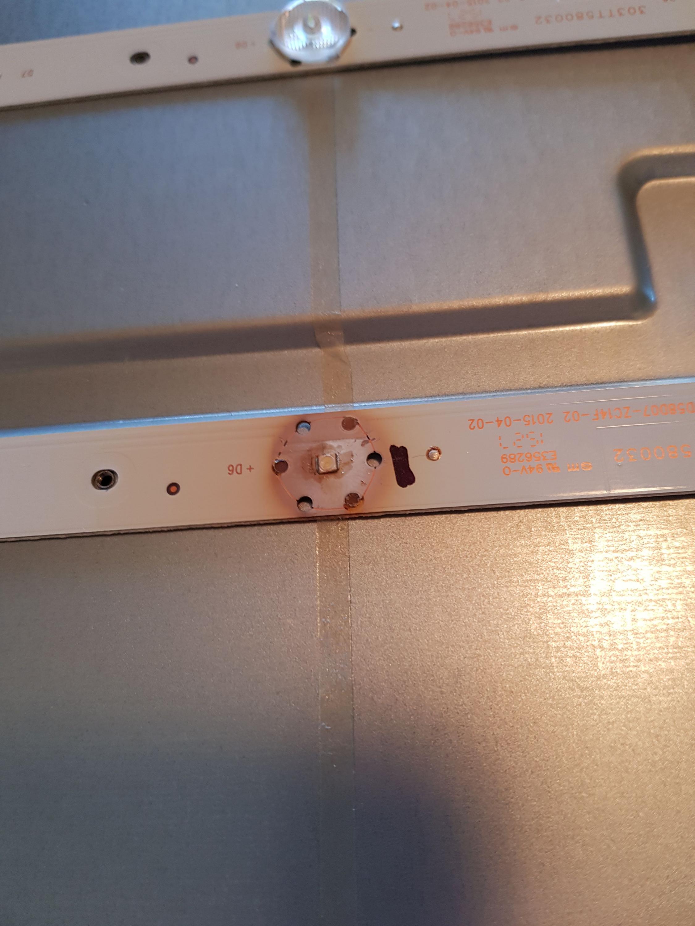

    I had 1 LED out on a Bauhn ATVS58-0516.
    I had some spares so I took one of an old strip (after making sure it worked) and took the bad one off the strip.
    I then put the replacement one on the strip.
    Now all the original lights light up (same as before) but the new one doesnt.
    I put the backlight tester on each side of the replacement and it lights up no problem.
    What am I doing wrong? This is the first time I have tried this procedure and I thought it went well.

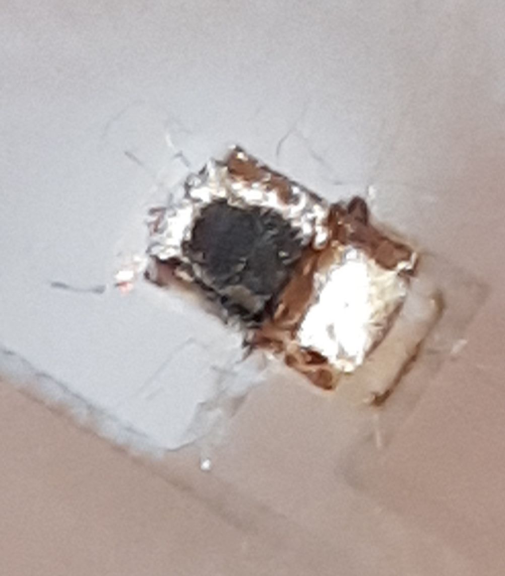

      I have tried it again and same result.
      Im thinking maybe the pad was damaged when the original led blew?
      The pic is the pad. Not sure how I would fix that?
      Or does it just need some solder on the bigger part of the pad? Looks like there isnt any on it

        I tried putting some solder on the pad but made no difference so I assume that the pad is damaged?
        But is it fixable. Thas the question.

          Added photo of led strip with new led on it (not working)

              Maybe use a resistor to bypass that led, hopefully one led off won't be too noticeable.

                1. The LEDs can be 3 or 6v
                2. The LEDs can be with + or - on the big pad
                3. The LEDs are replaced by heating the strip on the back, not on the LED.

                          Since the LEDs are connected in series so for the strip to light up but the replacement does not t hen the polarity of the replacement is back ward so the current flow through the protection Zener diode of the replacement LED instead
                          I have tried the LED in both orientations on the pad. In the first way the strip lights up but not the donor, in the other orientation, no led's light up.
                          if you shorted out the pad then the LED should not light up when tested with the tester.
                          I assume this is what I have done. Is there any fix for this or do I just order another strip?

                            Well if the other LEDs are lit up but not the replacement that means the replacement LED connection is bypassed somehow, otherwise the other LEDs will not be on, it is series connected circuit.

                                      Re: Replaced LED. Lights on its own but not in the strip
                                      When the LED goes open circuit, as per your original problem, the protection circuit will kick in, if too many LEDs are bypassed the protection will also kick in, but bypassing one LED may not trigger the protection circuit.
                                      It is beat to replace all the strips and the turn down the backlights level on all input mode and do not set them to other backlights mode, I.E. Dynamic, etc.
