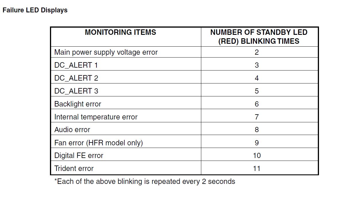

    Re: Sony KLV32U300A starts up then shuts down
    Are you certain it's KLV32U300A and not KLV-32V300A
    The led fault code for KLV-32V300A is attached
      Thanks Dick,it is definitely klv32u300a

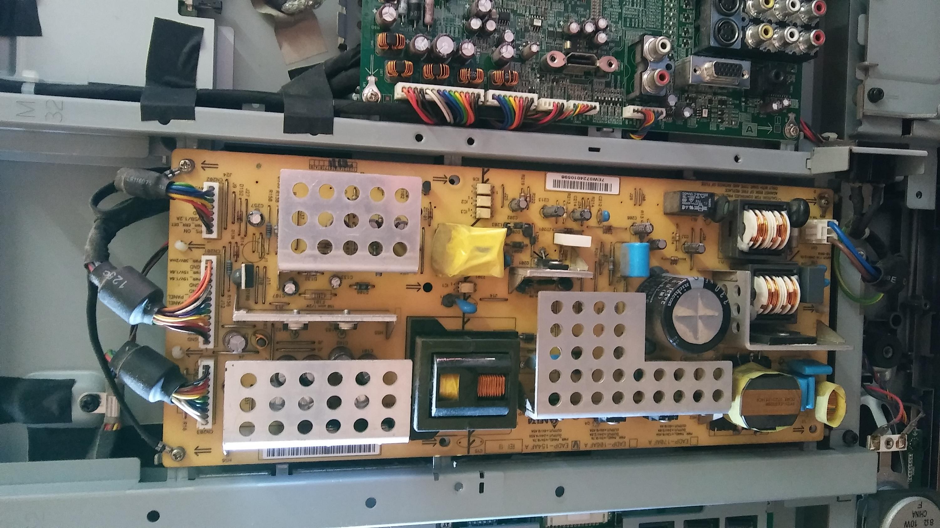

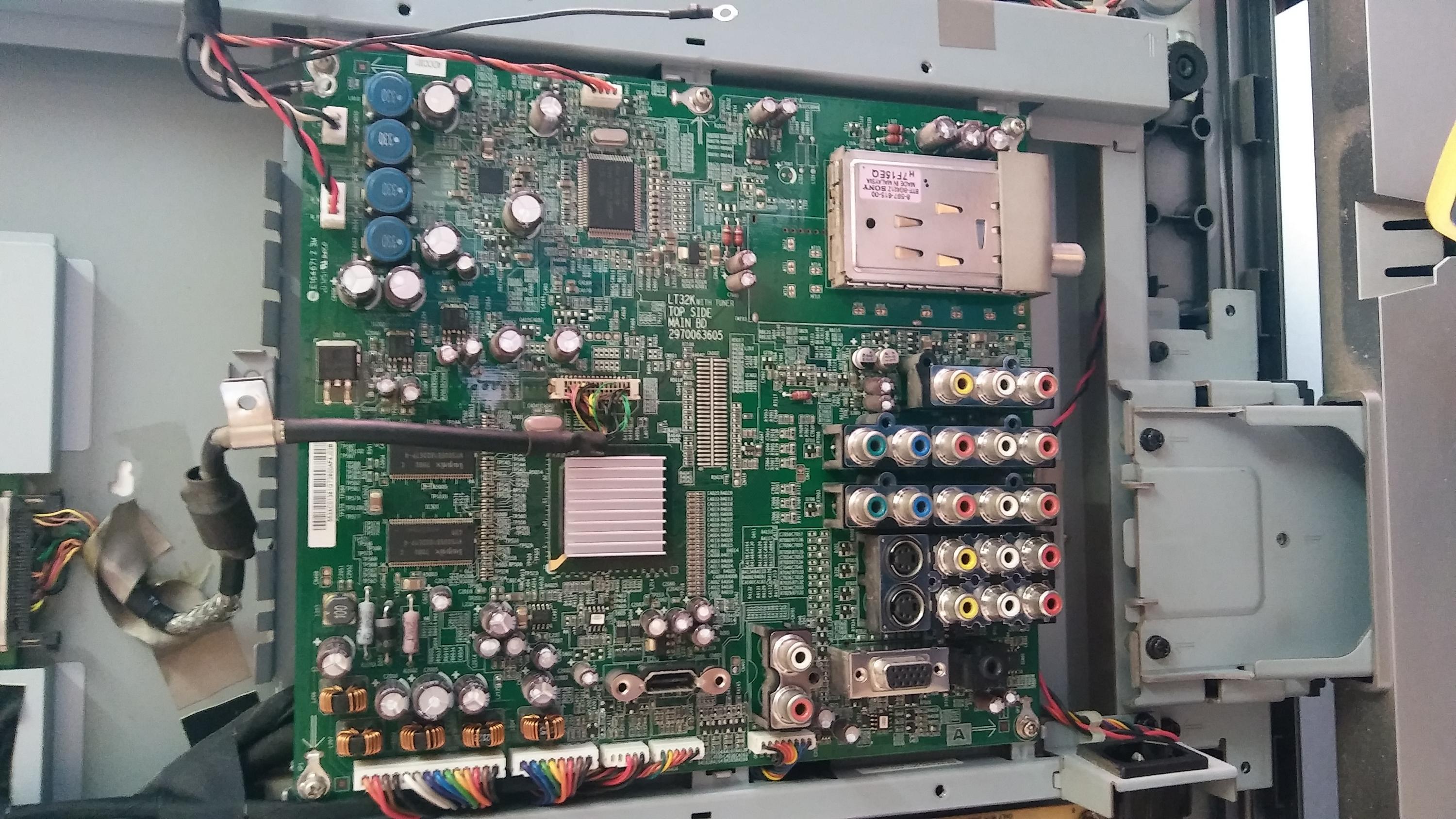

                                    Ok i finally managed to attach the psu and main board
                                    • dick_barton
                                      • Aug 2015
                                      • 6643
                                      • Wales
                                      Can you give the voltages read on CN201, CN202 & CN203
                                      eg
                                      CN201
                                      Pin 1 GND
                                      Pin 2 GND
                                      Pin 3 PWR_6V = xxV
                                      Pin 4 PWR_6V = xxV
                                      Pin 5 GND
                                      etc for all pins
                                      • Admirality
                                        • May 2020
                                        • 80
                                        • South Africa
                                        CN201 Pin 1=GND 2=GND 3=5.63V 4=5.83V 5=GND 6=GND 7=5V 8=5V 9=GND 10=GND 11=14.60V 12=14.60V 13=GND 14=32V
                                        CN202 Pin 1=0.2V 2=0V 3=4.1V 4=GND 5=GND 6=GND 7=4.1V 8=4.1V
                                        CN203 Pins 1-5=0V And 6-10=24V
