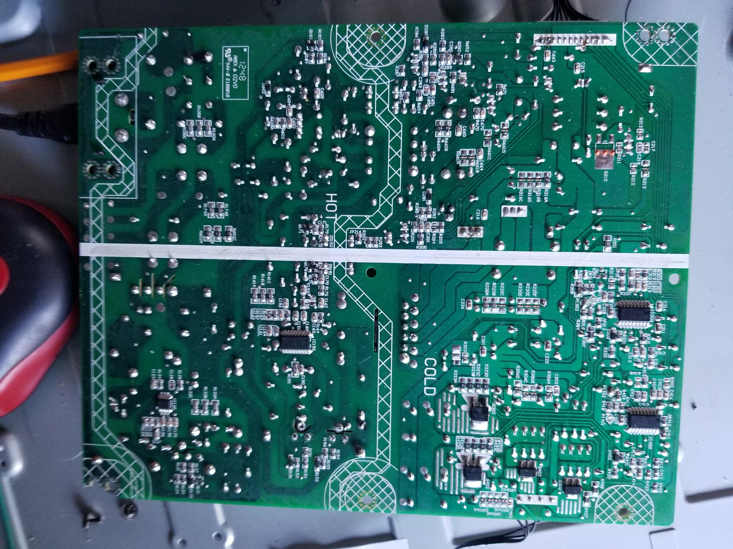

      C120 = 170v to 298v
      jp113 =14v
      jp116 = 16v to 20v then back to 16v
      I hope you didn't want me to do the pin read the outputs on the 2 ic120 & 150 --- my eye's are not as good as they used to be and a little dark in the garage.
      Maybe we should try fixing the on/off led problem so that I can get the same reading every time. It might fix the varied readings that I keep getting?
      Can I just permanently jumper with a 1kresistr 201 -pin 8 to pin 1? and would that stabilize the readings? for further testing?

        Re: Vizeo E500i AO dead with led on
        Yes you can use a 1k resistor between 5.2vsb and Remote on/off but you need to disconnect the cable going to the main board so you don't damage the main board.
        It could be that the voltage on jp116 is low/changing because C602 or C606 are weak. These are supplied by the standby circuit and should be steady.
        If the voltage on C120 increases when powered on, then ic120 (pfc) is working so no need to check it. but the voltage does seem about 100 volts low, This could be because of a shorted diode around L120, like D121B or the other two I can't make out the numbers.
        Also post the numbers on ic120 & ic150. It could be that ic150 (the main drive ic) is not turning on due to a low pfc voltage. ic150 does seem to monitor the pfc voltage via R161a~c

              What I found R_J :
              Also resistance tested OK on D120.
              all 3 diodes read 171 vdc on each cathodes -
              Will try checking the voltages on each one to be sure they are working - What is the voltage coming out of D120, D121A & B?
              Thanks for your help patience R_J. If nothing else I do appreciate your encouragement.
              C120 = 171 on and off.
              Decided to test the ac across c120 -340 ac off and 668 ac on. Removed c120 to retest with a few other meters, besides one of my ESRs. C120 =140.2uf ---should be 150. Seems close enough.
              Why does the AC voltage double and the DC doesn’t at that cap? I must be missing something???
                What ac voltage are you talking about that is doubling? The ac from the line is rectified to 160VDC, Then when the power supply is turnd on, the PFC circuit starts and using high frequency switching, boosts the 160v to about 385vdc. on C120
                What is the make and model of the meter you are using? It is very possible that C120 is bad.
                              OK, I am starting new---
                              I tried measuring ic120 and ic 150 -but I am having trouble with them. When I try to turn on the power led it only stays on for about 5 sec. and so by the time I get to the ic they are off - no power on pin 14, or what ever pins are the power. I really need to correct the intermittent power on/off problem - It has been the real pain in the neck besides using the defective vom.
                              I can not get any readings until I have consistent power. need the white led light to remain on - I really think that I am wasting you guy's time, with such false readings.
                              I we can fix the on/off problem - then I can get solid readings.
                              I hope this is a help.
                                  perhaps start over again.... provide a picture of the back with everything connected so the forum can see what you are up against. I know you have done a "bunch", but have you checked the backlights? Perhaps the "shutdown" is because of a back light issue and not so much a power supply issue which you seemed to have started at with some "questionable meter". Outside of the standby voltage, it is quite likely that others that are labelled for the connectors on the power board may not stay around very long so you need to be monitoring them (one at a time) during power button pushes with a reasonable meter that can potentially see any temporary voltage condition. Further, when you press the power button, you need to monitor the ps-on pin to see if it changes. Repeat looking at the other labeled pins on connector cn9101. Go from the results that you would post. That will give the forum a better idea of what the state of the board is.
                                      LOL, Budwich, about wrong board.
                                      Yes, I have checked the 12v with power on and off - I could do that with out any trouble. No 12 v at all.
                                      I just went out and rechecked pin 9 of cn201, get no change when led is on or off. I put my fluke 77 on hold and no real change on pin 9.
                                      Do you want me to take a picture on the back of the PS board ?
                                      Well if so here it is.
                                      Thanks for the help.
                                        OK... thanks.... sorry for the "side track".
                                        back to the "regular program".... a way back, you indicated a problem with trying to measure thigs at an IC but could not because of the time to take the measurement versus how fast it powered down was too short. OK... but it was indicated that you can force on the power supply via a "resistor jumpered" between pins. Have you retried that method again with your "new meter"? The jumpering will allow the ps to stay on for as long as the jumper is in place and let you do as many checks as you want.
                                        similarly along the lines of the jumper test, during one of those types of "power up", can you disconnect the led connector (cn301) to see if anyrhing changes with the 12v during power up there after.
