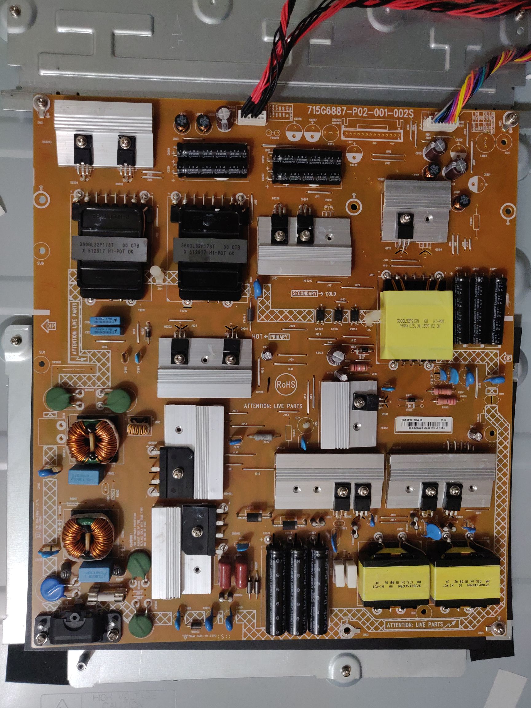

    Hey folks, please help to fix, got this TV broken, does not start, on first try just blink once on second blinking 15 times, no picture or sound, I tried to take off all eeproms, looks ok, without main eeprom gives 18 blinks.
    Looks like power board, since there is no 24v: checked all diodes on front side, looks ok.

    Fixed 24V, Same blinks, but 24V is back.

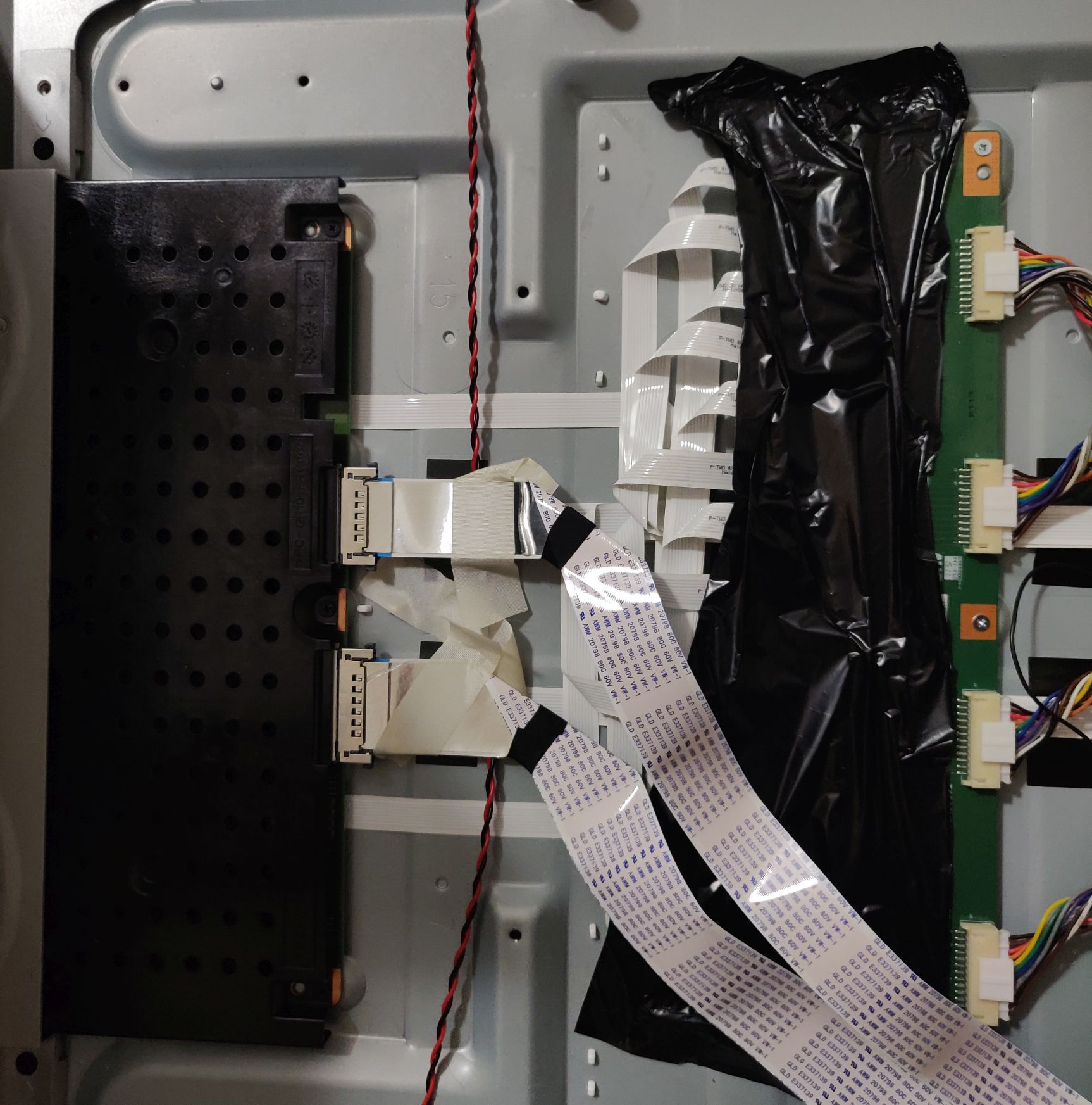

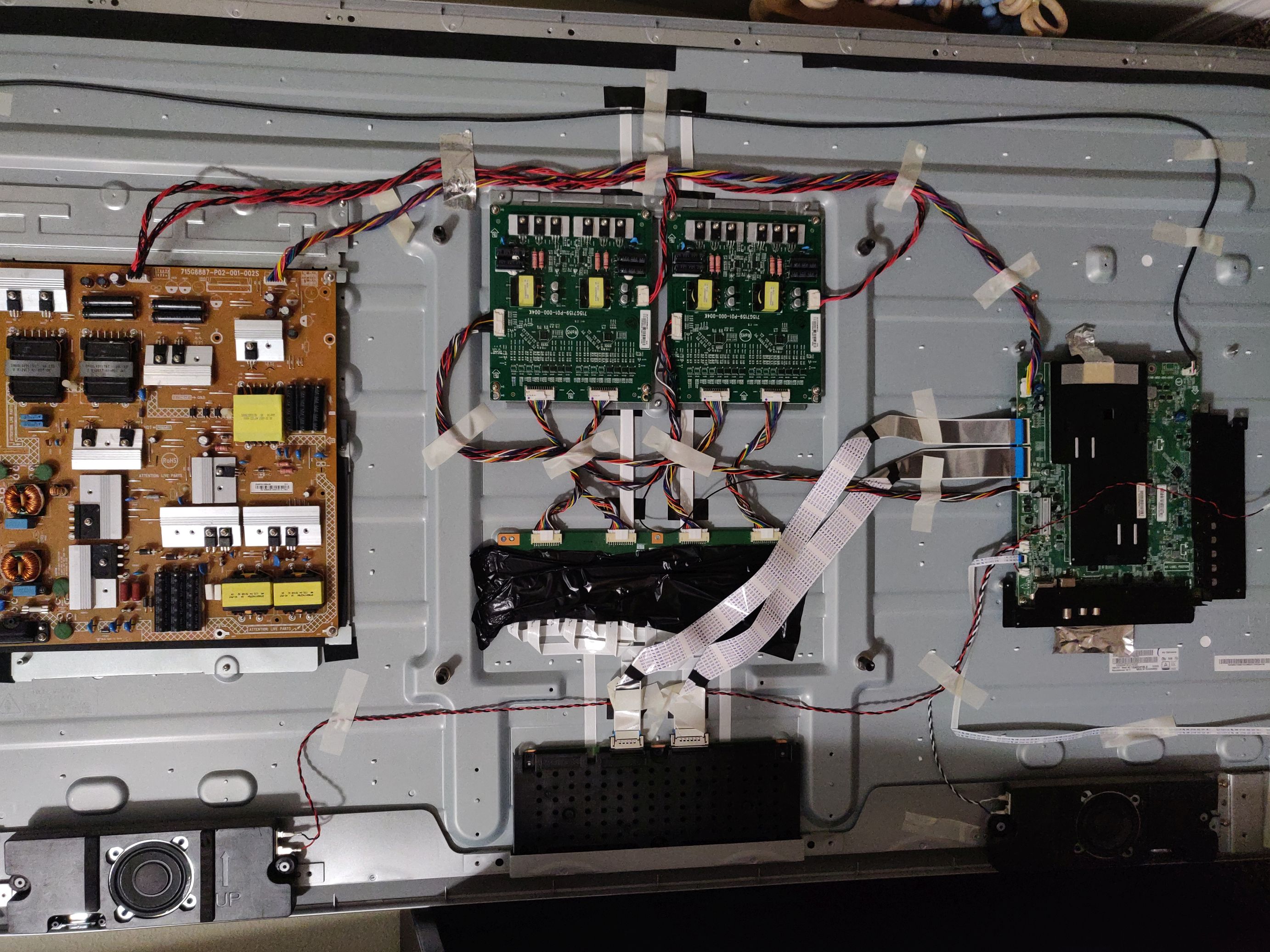

      Please also attached good clear pictures of the whole backside of the TV showing all the boards.

        There was a broken smd diode (looks like someone tried to fix TV )
        So after connecting power cord and turning on led lights up and in few sec turns off, then in some time led turns on again and start blinking (15 times), then off and retry... I soldered missing led on main board and it's on while power led is blinking, looks like tv is trying to boot

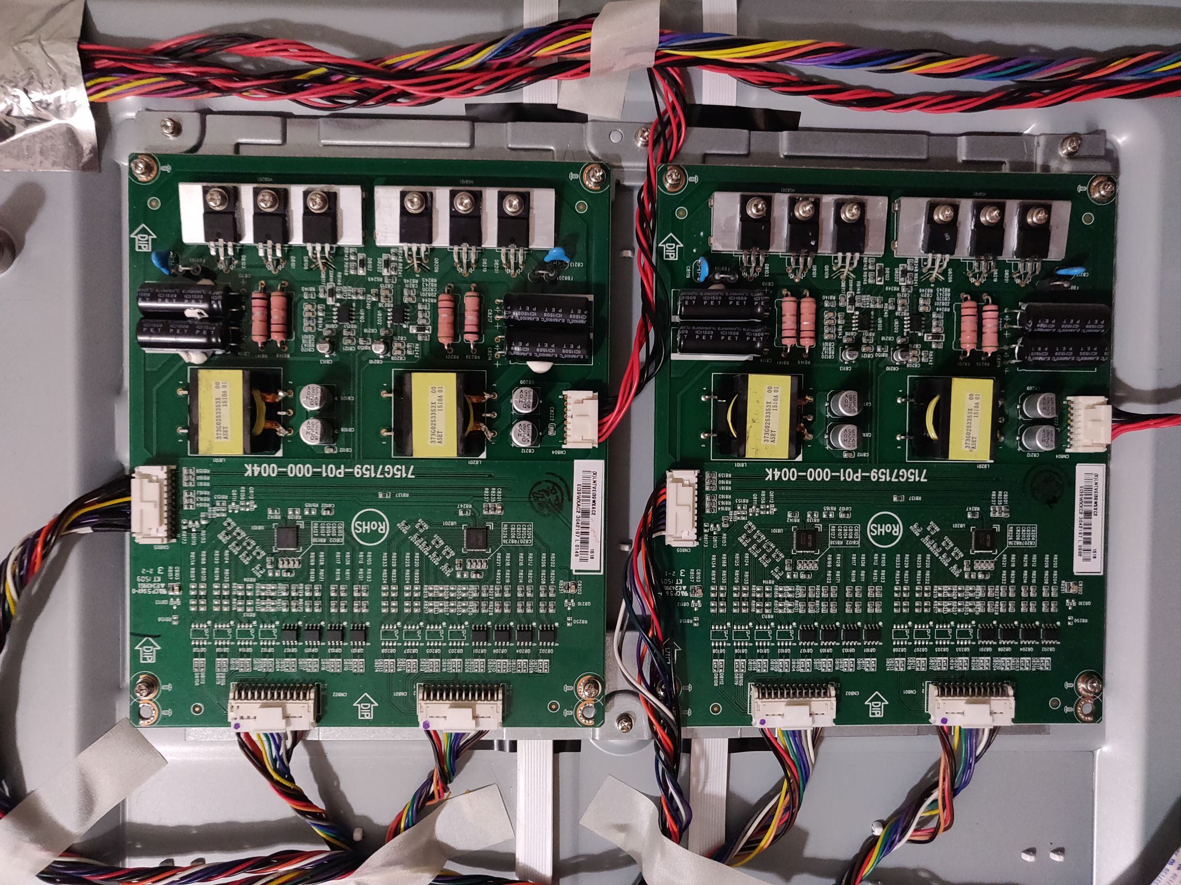

            Btw, I checked backlights with led tester, looks ok, all pins 6.7V each (16 connectors and 4 pairs each) so all 84 connections had 6.7v
            Is there any way to start backlights without mainboard?

                Looks like it's to hard to turn on backlights led drivers are spi based, so signal is sent from mainboard

                    After looking at your pictures, the BL-ON control is not routed through the power supply board, the backlights LED driver boards (CN805) are being done by main board (CN201) that is why there are no connection on connector CN9201 (9203) of the power supply board to the the LED driver board.

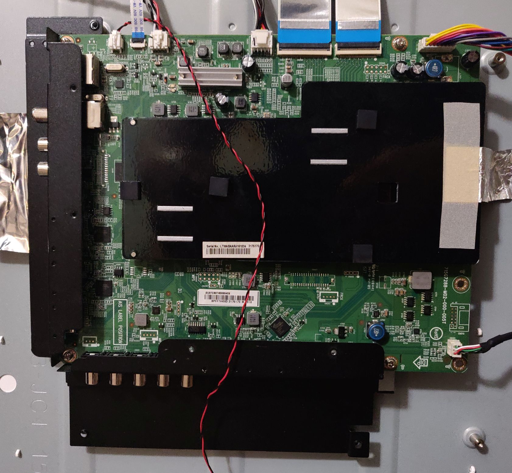

                        Ok, some updates, got main board from M50-C1, and tv started successfully, but I had to replace EEPROM, bad news, next start will fail since EEPROM will be overwritten, any idea how to change model number and tv serial number?
                        Probably can be done in service menu, but I cannot get there.

                          Was able to bypass eeprom overwrite, TV is back to life

                              eeprom lock did a trick
