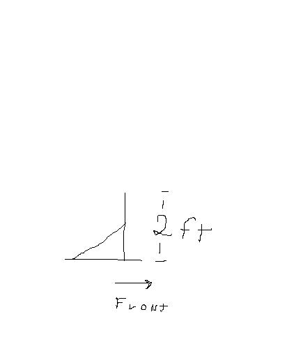

                                        I think I have a variant of this screen.
                                        Model: AKAI PDP4273M
                                        At first glance through the vent holes the capacitors look OK.
                                        Symptoms:
                                        When I first took this from the trash, it was a cold wet night. Luckily it was inside the Viega box from the new set that the owner had probably replaced this one with. Brought it home, turned on, picture is there but it's really grainy and odd. Next morning when it had come to room temperature, it would not turn on at all which leads me to believe it is cap failure.
                                        In any case, I'll deal with it when I have the will. The thing must have a thousand screws and weighs a ton.
                                        Oh yea and it was missing the stand. I wonder if I could build my own Plasma mount instead of paying $80 for a wall mount which I anyways don't want. And the generic stands cost $130.

                                          Do you want a stand / mount that looks good, or just something that works? I'm maybe facing a similar problem, the VERY CRUDE attached sketch is what I came up with. It's a braced inverted T.
                                          These sets have mounting holes on the back. It's a metric thread, so keep that in mind when shopping. I'd figure on using a pair of 2 x 4's. The verticals would come up at least 2" past the upper mounting holes. The horizontal pieces should extend at least 6" in front of the screen. Use 4" drywall screws to hold the wood together, and at least 8cm long metric bolts of the appropriate diameter to mount the TV to the frame. Predrill all holes so you don't split the wood. If you countersink the screws holding the base to the upright you can get by with putting a towel on whatever surface you're setting it on.
