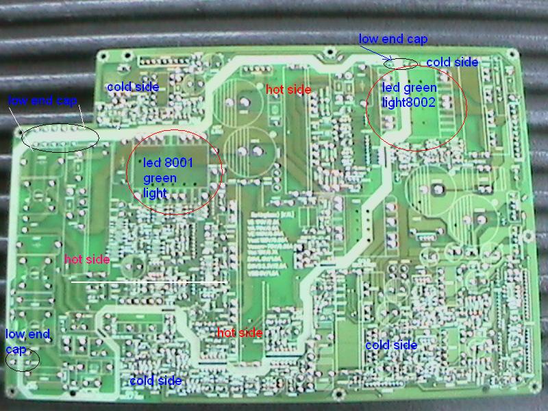

    Problem with these part numbers on board they are internal PCB part numbers not part numbers for complete assy (most website that resells used parts incorrectly refer to internal PCB part numbers) and is not in samsung catalog. And unfortunely I don't have the model number you gave to me as it does not exist in samsung's website because it is not a full model # or unique model made for extremely specific area. Or it was produced more than 5 years ago when samsung transitioned from paper to webpage and PDF service manuals.
    The pictures you showed us is X drive (on right side, rarely fail, check fuses). The left side is Y-drive/Y buffer (most common to fail), bottom row is Z-drive/buffer (extremely rare to fail).
    Cheers, Wizard

          ok guys i found it....check this out..i studyed this all day..and yes the mother board is toast...un less u know what to look for and the led codes...remember the first post..about the led lights..well thay had a number
          8001-8002...well i found out the thair curcuts...so thair more to them..so i would look around,what ever had 8001 next to it or the 8002section.and would look around thair.....that when i seen the hot side and cold side...hot side..is the power side....the cold side is the y and x boards.....now y wasent the cold side turning on when i hit the power...well i looked around the white boundry....and started to see...and tested them.......all but one is good...you can see them a little disfigerd.....thair usely run about low ressistence about 1 ohm....idident get nothing...but one...but im going to replace all...to be safe.and whats one more....to do it right.......look i drew a diegram..so you could see...and pdf file that i study...and explained and the scmatics...drawing..........i think thair about 8 or 10 caps ...that are bad..i tested everthing and around the transiter(led8001-2)......you see...with out the low end caps thairs no ground.......becouse all this has something to do with the screws down the board...bad ground was swing the meter up and down ....wouldent it...or amp up to 170 volts and hold or the safty operation
          well.....i have to order...than well see ..but im possative....the meter dont lie
          bad caps make me crazy

              ok guys ive been doing some home work and i found something real cool info
              so i can ask the right questions..
              but the info that is in red....y my meter is swinging up and down
              * Bad startup circuit - initial base (gate) drive is often provided by
              a high value, high power resistor or resistors from the rectified
              AC voltage. These can simply open for no good reason.
              Symptoms: In this case the supply will appear totally dead but all
              the semiconductors will check out and no fuses will blow. Check the
              startup resistors with an ohmmeter - power resistors in the AC line
              input section. Warning: there will be full voltage on the main filter
              capacitor(s) - 1X or 2X peak or around 160 or 320 VDC depending on design.
              Discharge before probing.
              * Dried up capacitors - either input or output side.
              Symptoms: The main filter capacitor may dry up or open and cause the
              output to be pulsing at 60 (50) or 120 (100) Hz and all kinds of
              regulation problems. Measure voltage across main filter capacitor(s).
              If the reading is low and drops to a much lower value or 0 instantly
              upon pulling the plug, then one of these capacitors may be open or dried
              up. If you have an oscilloscope, monitor for ripple (use an isolation
              transformer!!). Excess ripple under moderate load is an indication of
              a dried up or open capacitor.
              In extreme cases, a main filter capacitor with greatly reduce capacity
              or that is totally open may result in failure of the switchmode transistor
              and a dead supply that blows fuses or fusable resistors. Therefore, it is
              always a good idea to test the electrolytic capacitors whenever repairing
              a SMPS that has blown its switchmode transistor.
              Capacitors in the low voltage section may fail causing regulation problems.
              Sometimes there are slew rate limiting capacitors which feed from the
              primary output to the regulator controller to limit initial in-rush and
              overshoot. A failure of one of these may mess up regulation at the very
              least. For example, excess leakage may reduce the output of the main
              output (and as a consequence, all the others as well).
              Where a controller like a UC3842 is used, a failure of the capacitor on
              its Vcc pin may result in a aborted startup or cycling behavior as it is
              starved for juice each time it pulses the switchmode power transistor:
              i would like yall take on this i think this is a good question to ask..please
              wher is the filter cap.....left side i think.and over a little ot the right...am i right ?
