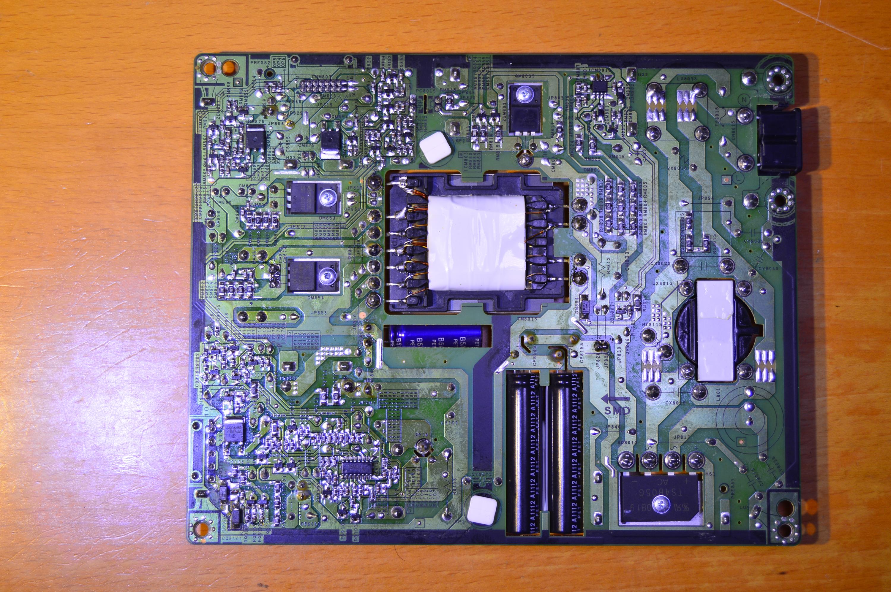

    Got this nice monitor for a while now, I struggle to make it work again, and I read that here might be some very nice people that could point me in the right direction to repair it.
    Under power the backlight won't come on, a buzzing sound starts and then fades away after a few seconds, then it starts again. Can't tell exactly from where, but I think it's the transformer in the middle of the power supply board, or around it.
    The red LED in the front of the tv flashes five times, then 2-3secs off. Probably this is an error code, cant find a service manual to look it up. Are some samsungs simillar in opration, ones error code will be the same as other model's error code?
    I am suspecting that the power board is faulty, but I might be worng.
    If the mainboard is disconected from the power board the intermittent buzzing sound turns into a more finer continueos buzzing. The cable between the LED board and power supply board still connected at this point. Voltages at CNM803 are 12.83V(13V) and 5.32V(5V). There are two main capacitors on this power board voltages are 347V is this high enough?
    any help would be apreciated,

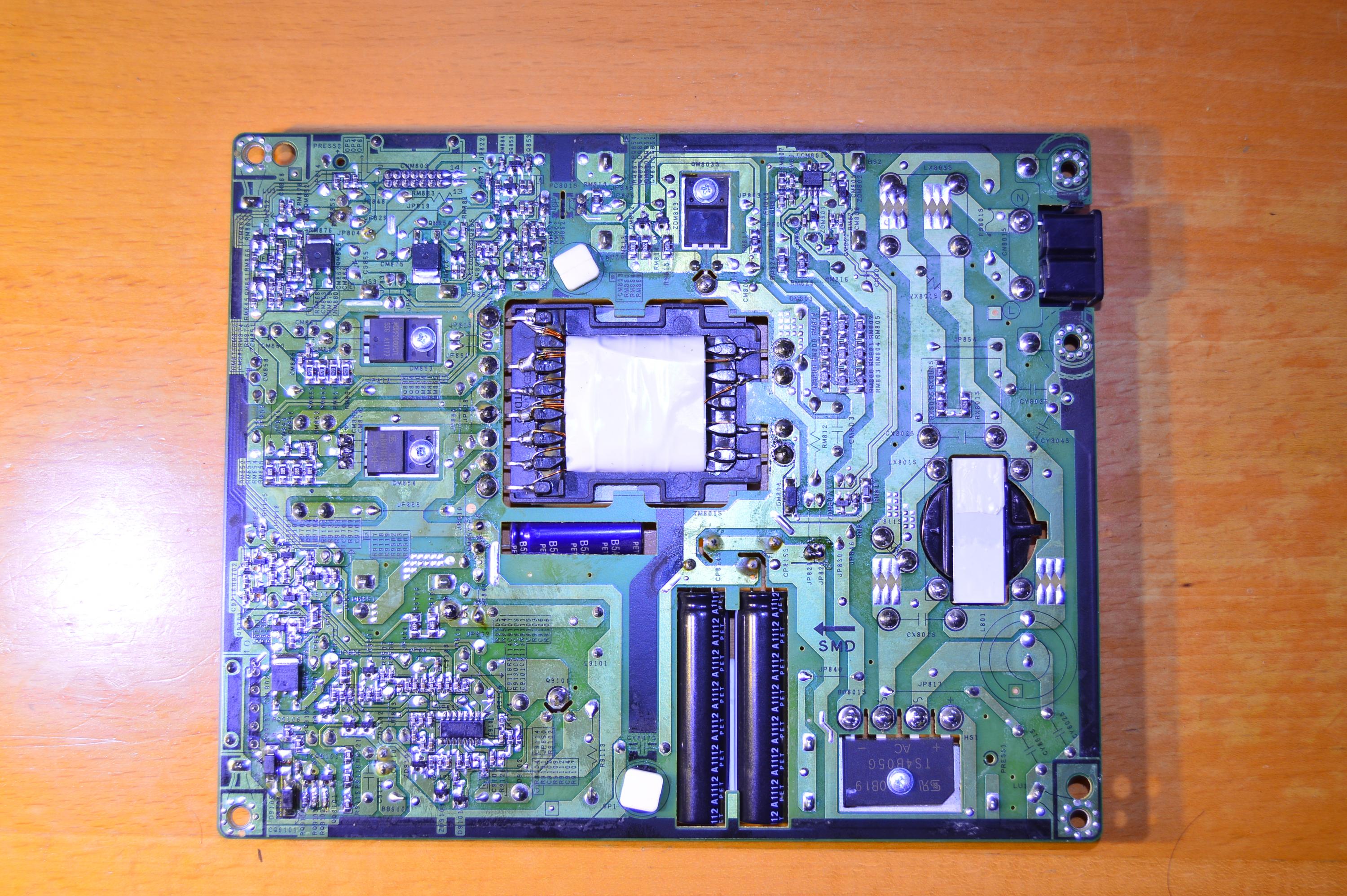

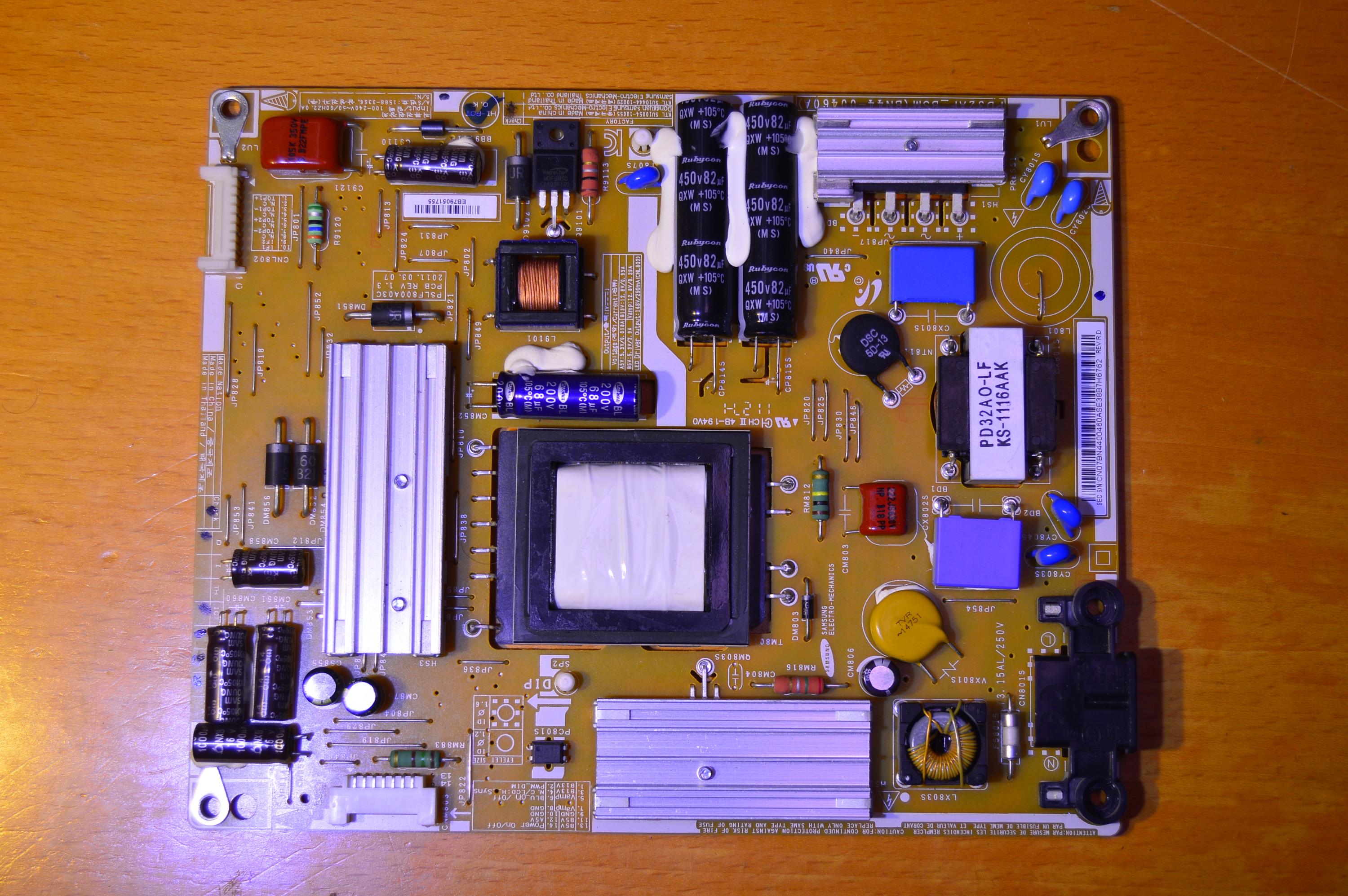

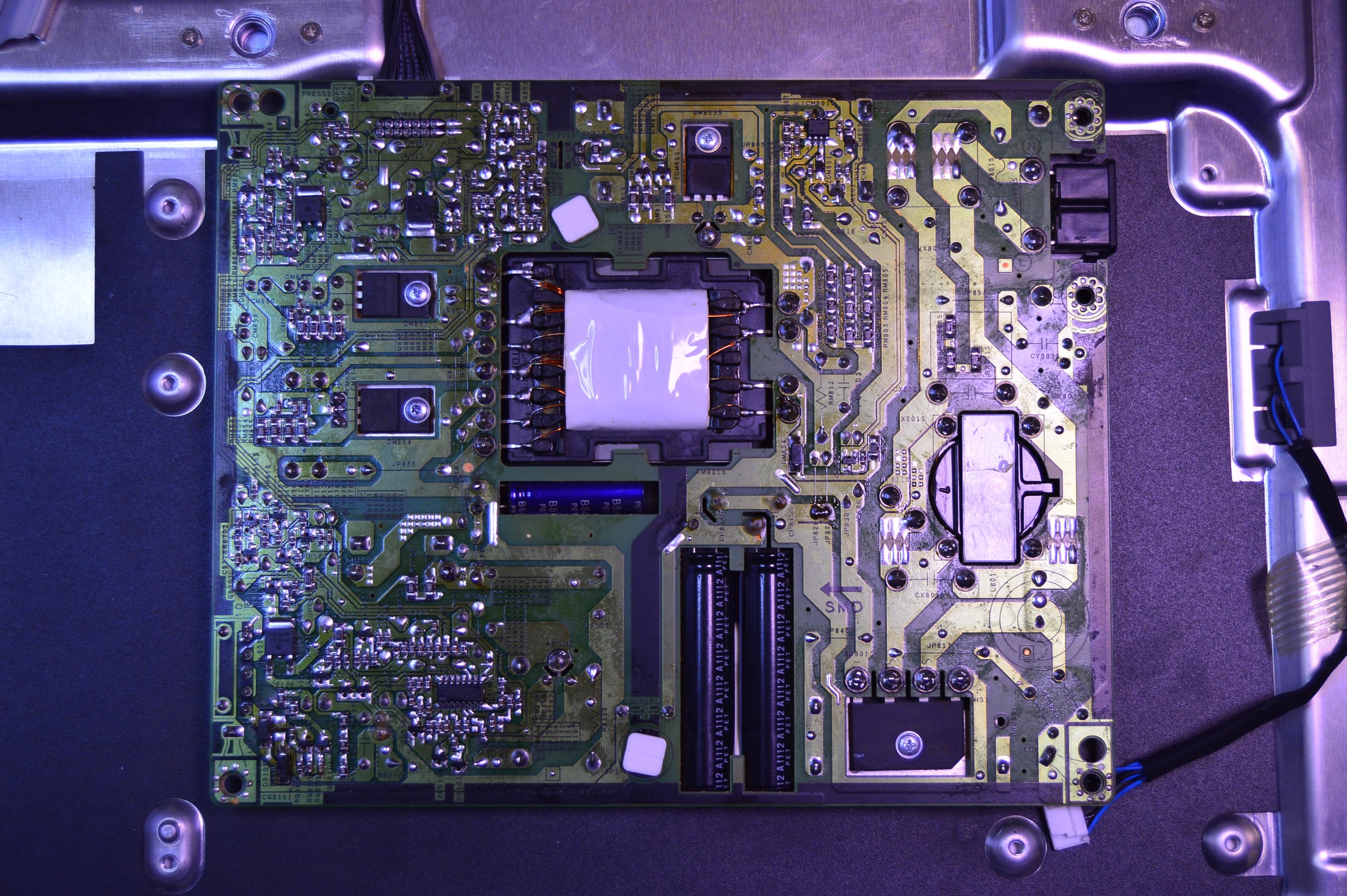

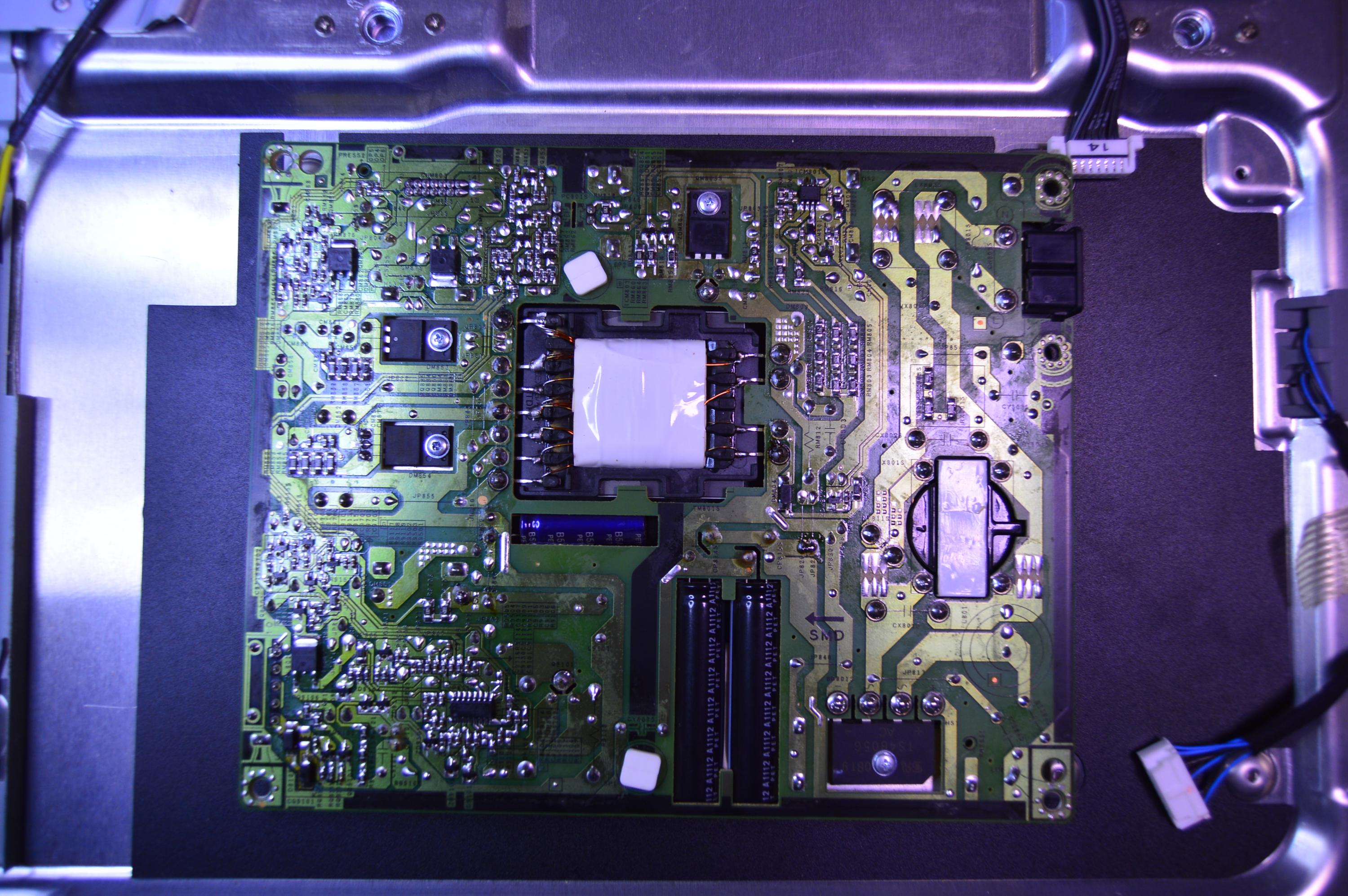

    Pictures are too dark for me to read anything on the board.
    Please provide straight shots pictures of the whole top and bottom side of the power supply board.
    What is the P/N of the power supply board? BN44-?????

      Re: Samsung UE32D5520 buzzing PSU, no picture
      Board is BN44-00460A
      These are the best pictures I can take with maximum light that I have.

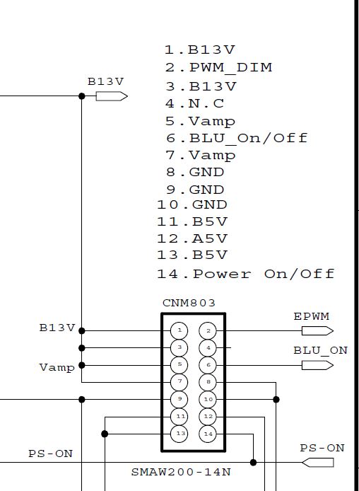

                                The 13.1V feed to Pin 1 of IC9101 is fed from Q9104 which is switched on/off by BLU_ON
                                Can you check the voltages at the connector as in post #12
                                        Disconnect the mainboard from the power supply and connect the 5V to PS_ON which is Pin 14 of CNM803 using a 1Kohm resistor. That should bring up all the supplies and the backlights should also come on.
                                        Can you confirm Vamp, A5V, B5V, B13V are all correct and that you have 12V on Pin 1 of IC9101
