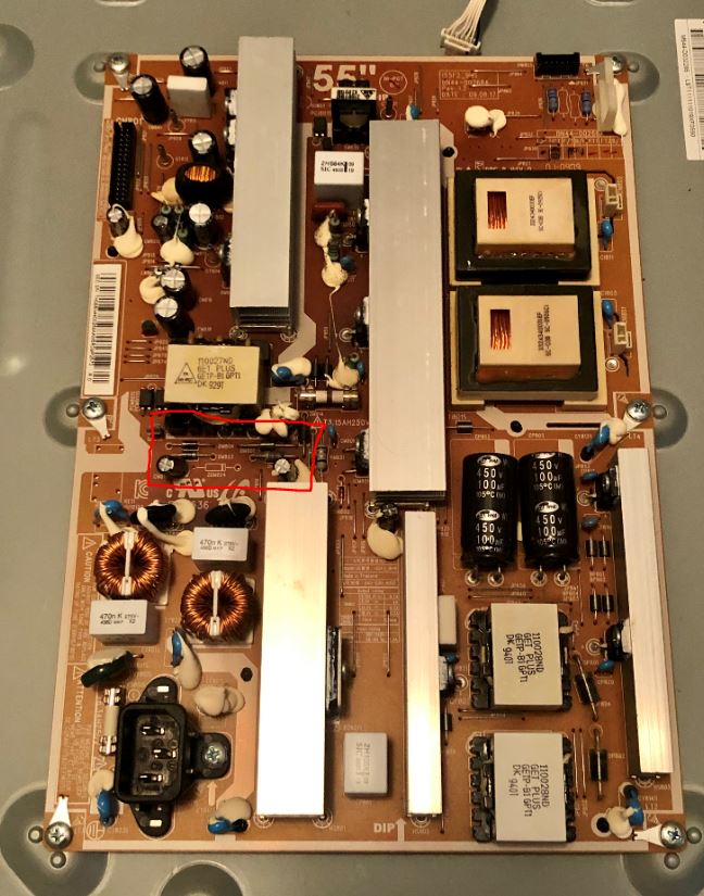

      Interesting... can you check the four rectifying diodes on that power board? Wait until the big caps discharge first. If you can, either remove the diode from the circuit, or just lift one leg off first.
      -Thomas

              Re: Samsung Ln55b650t1f Part Identification
              Are these the four you are referencing? Thank you for your patience!
