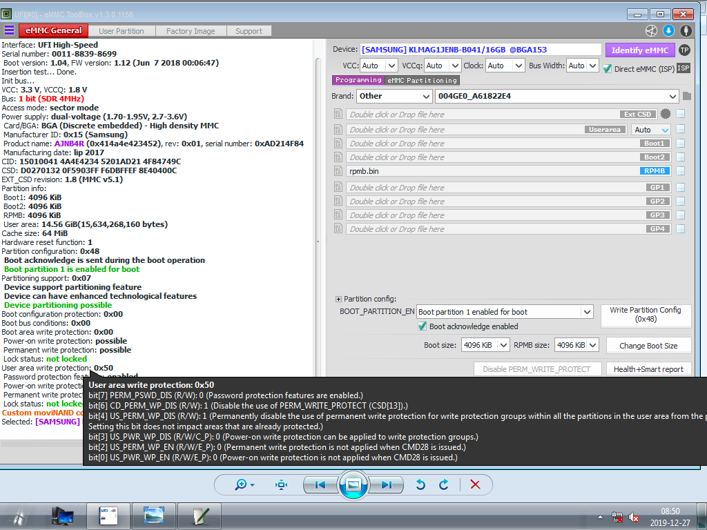

    Hi friends .I have this set absolutely death .Power is ok .I have not acces to boot1,boot2 and user via emmc programmer.Programmer logs said - user area protection -0x50 ,I don't know , how disable it.I can read emmc , erase , but can't write.EMMC is KLMAG1ENB B041.Can I disable this protection or I need change emmc?

    I can tell you as long as you can see and read the emmc, you should be able to write on it. At least I was always able to do so with my RT809H. What programmer are you using?

        Re: Sony KD-65XE9005 emmc .
        did you take the emmc off the board, or did you use wires soldered to the main board?
        Permanent Write Protect– Once the Permanent Write Protect is set, the protected memory region becomes read-only.
        https://cdn.badcaps-static.com/pdfs/...b5e44f9744.pdf
        so, you do need a new emmc
          Connect via wires - direct emmc .
            apparently I didn't into run this problem yet. Nothing you can do about it, besides copying the old emmc to a new emmc and put that chip back on the main board.
            You have to get the emmc very carefully off. You also need to reball the new emmc to put back on the main board, which is a pain in the butt.
                Thanks for help .I need replace ic , I think.
                  you just need the dump and flash it nothing else
                    You will loose netflix when u do it, just be aware.
