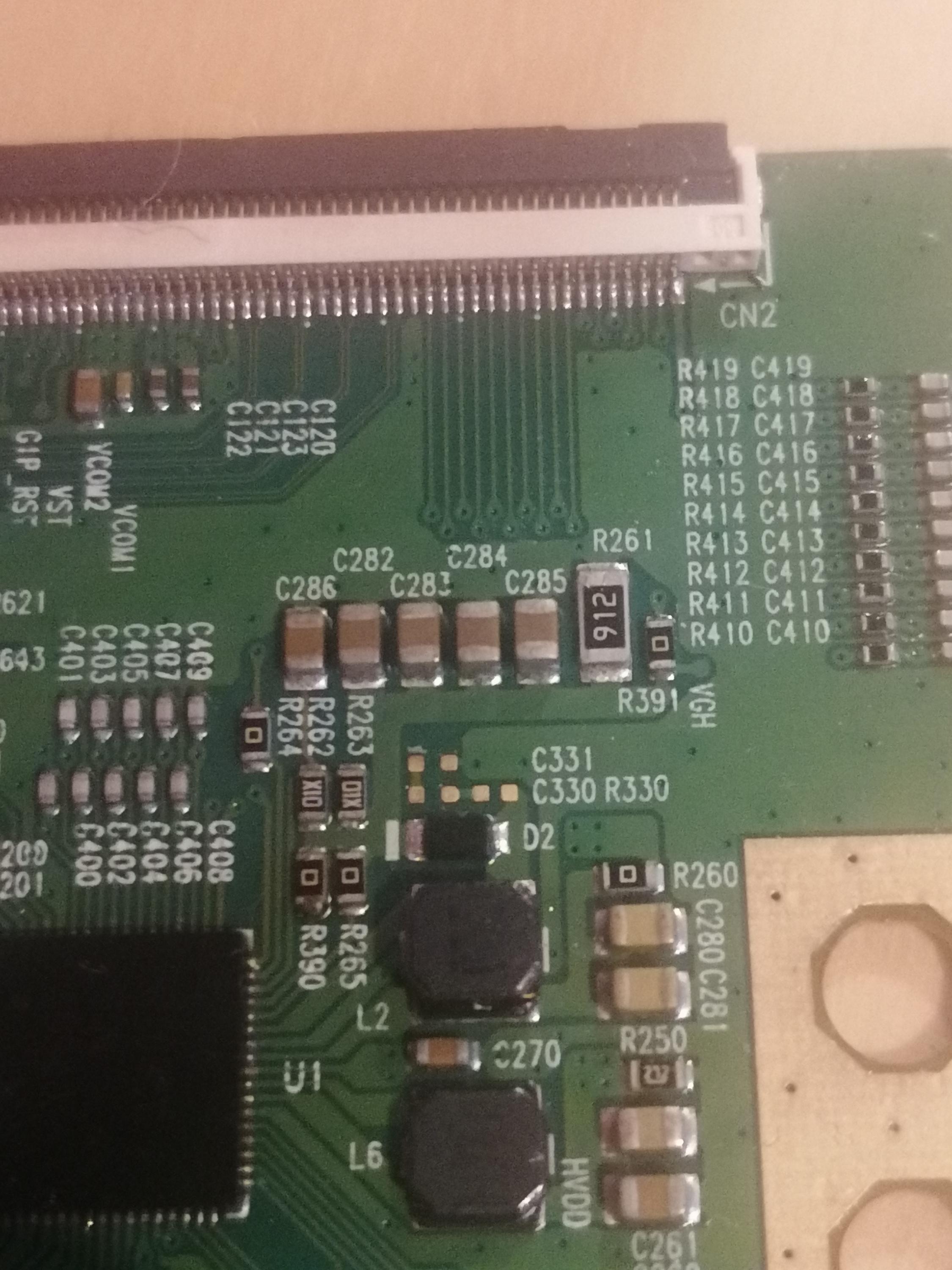

    Bought the TV about a month ago faulty as it would take about an hour to turn on turns out it was the tcon board as with a reflow has been working great for a month but now the problem is returning upon looking for a replacement there are none on the Internet looked everywhere the only board I can find close is for a 55fx700b which has the same sub model which is a 6870C-0757A but a different main part number mine is a 6871L-5491A and the one for the 55fx700b is a 6871l-5478h anyone had any joy in swapping theses or repaired the original board any help would be appreciated

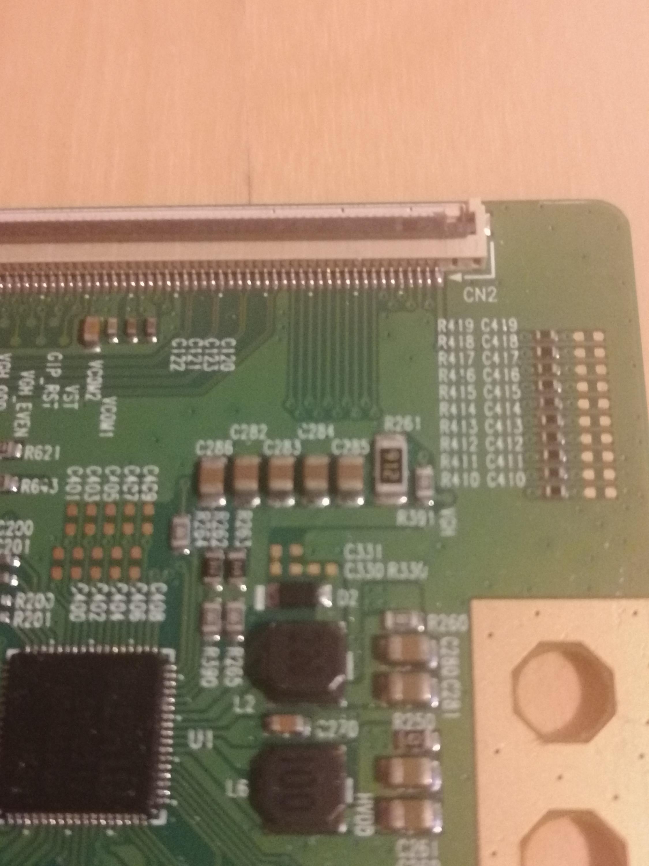

        Finally managed to sort this if anyone has the same problem you order a tcon for the 55fx700b 6871l-5478a and your remove 2 sets of caps from the board will put the numbers up tomorrow then use a ch341 programmer to read the epprom of the previous 5491a board and flash it to the new board or just do a chip swap with 24a32 epprom on the board. Now the TV runs great known issues with this model of TV and the tcons are near impossible to get hold of

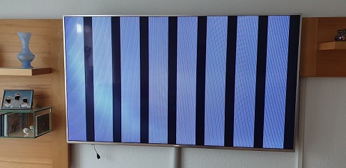

          Heres a picture on what it would do after the TV would warm up you then turned it off and on and then it would work this will fix this problem models also effected are 65fxw724

                                Can confirm the problem was with the dc-dc ic part number sw50212 but couldn't source one it would only work when heated so was failing not the solder so to fix I got a working board off a 55inch and did an epprom swap and removed some capacitors hope this helps people with the same problem
                                • Michaelrobbo
                                  • Mar 2020
                                  • 12
                                  • United kingdom
                                  Re: Panasonic 65fx700b intermittent tcon problem
                                  Caps to removes are c410 to c419 and c400 to c409

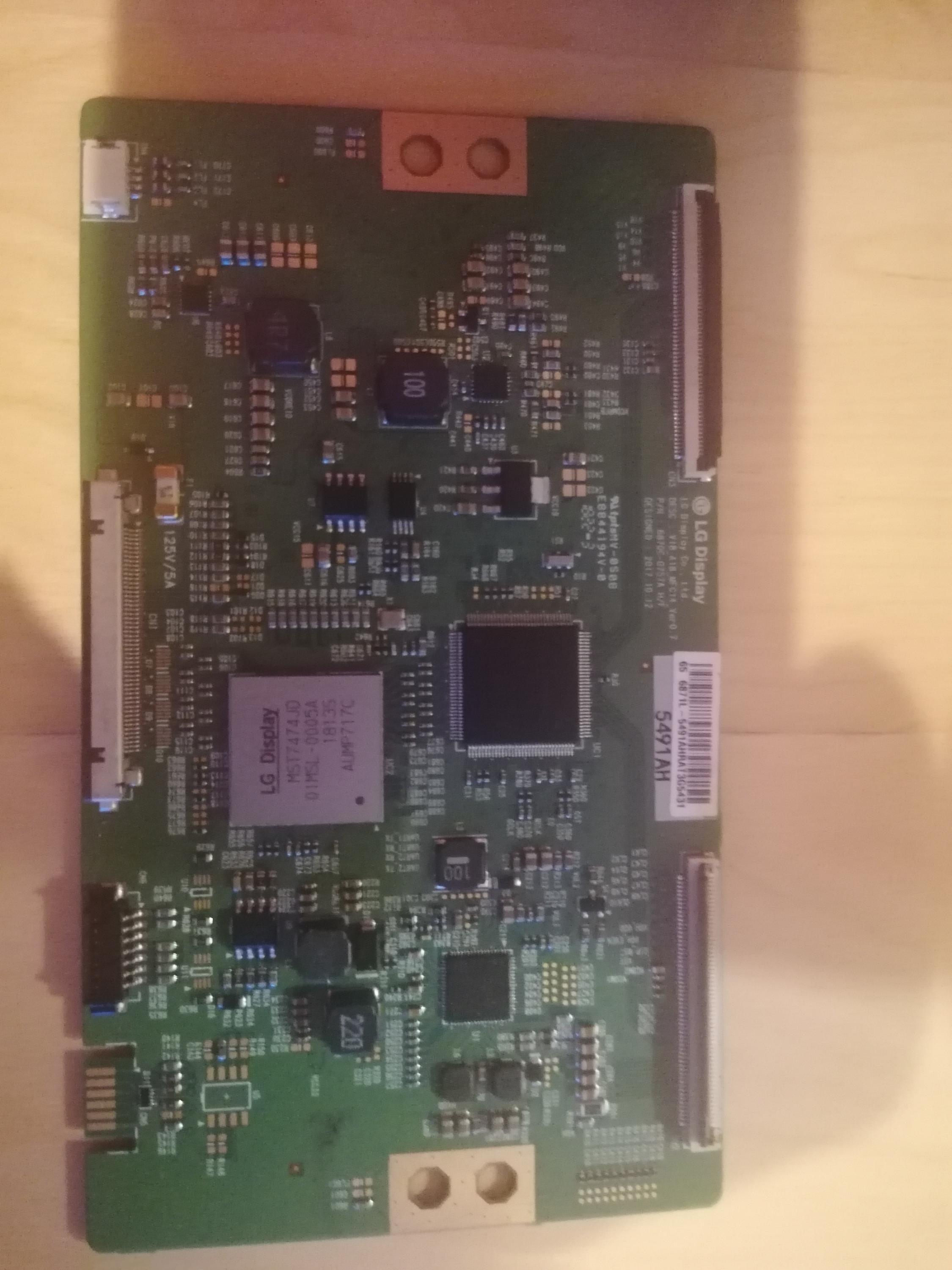

                                    Got a copy of the 65inch tcon epprom if any one needs it

                                        I'm looking for the Panasonic Tcon board 6871l-5491a.
                                        I would be glad if you could help me with one .
