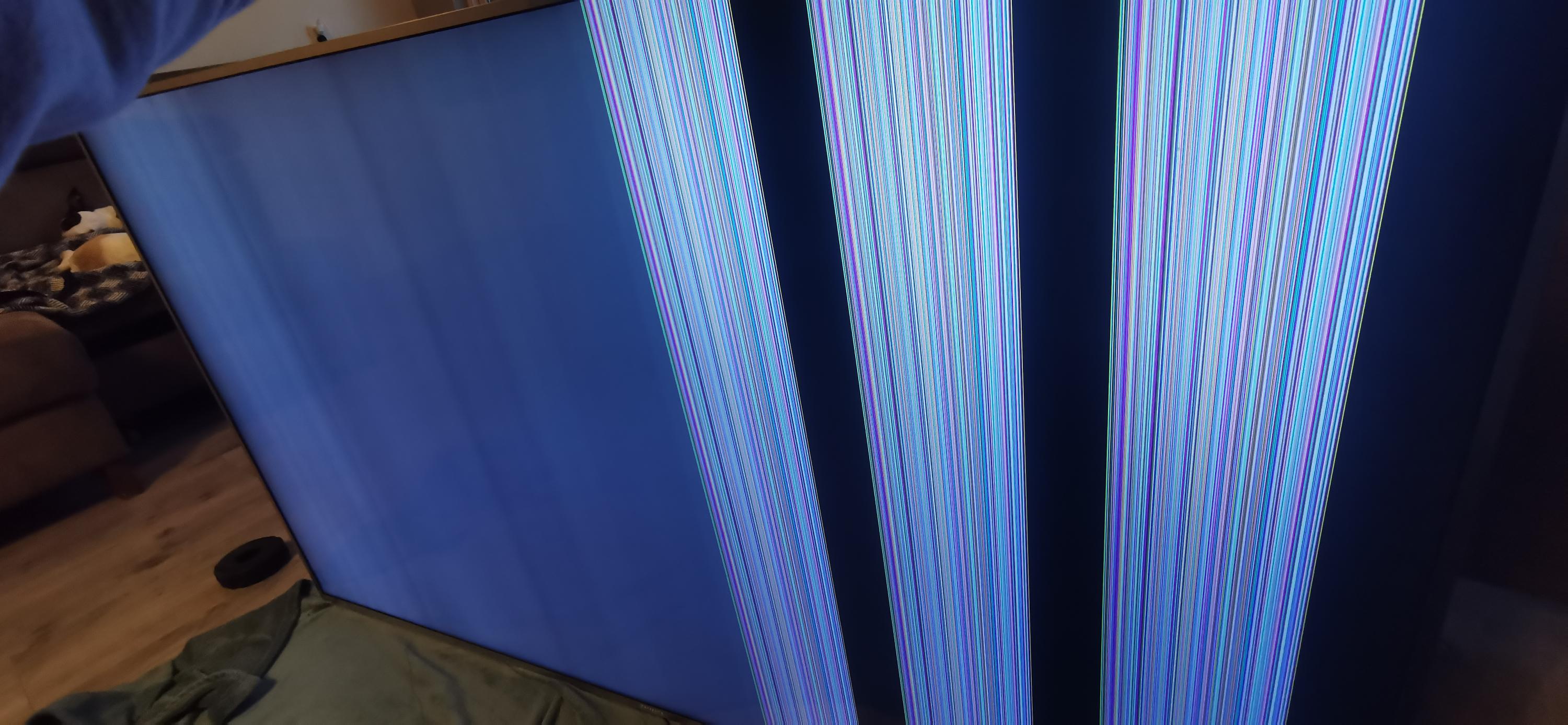

        I have the same problem with T-CON board for 65FX700.
        I think I go to buy a TC-Con for 55 inch.
        Michaelrobbo, why you removed 4 caps?

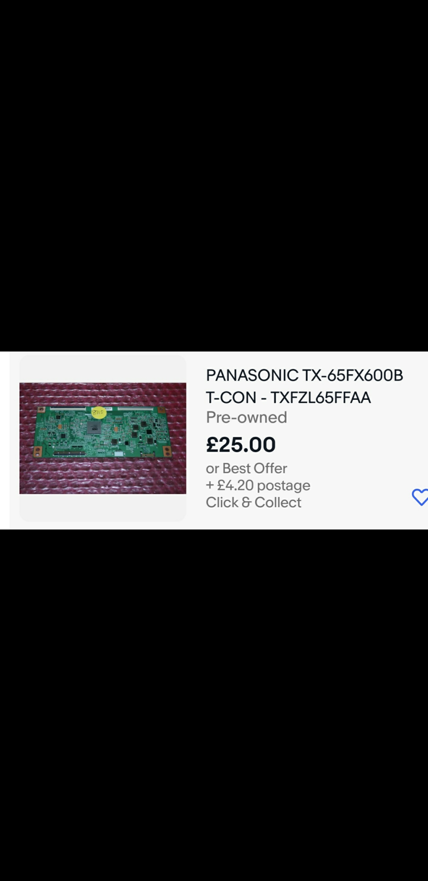

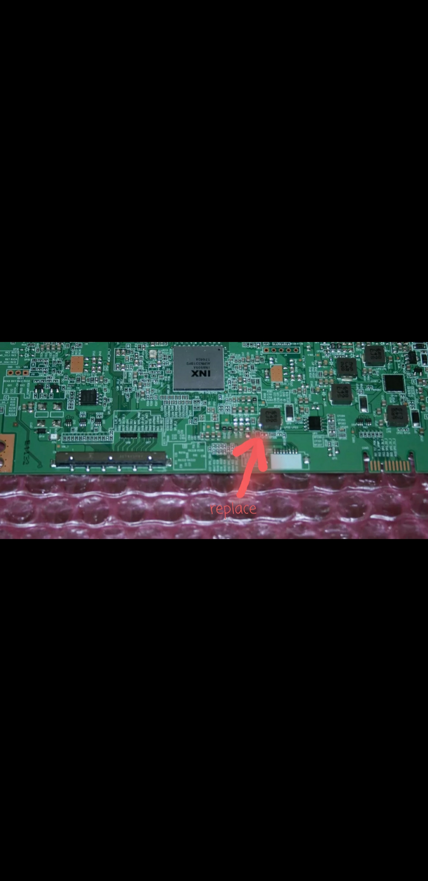

            Re: Panasonic 65fx700b intermittent tcon problem
            I fixed one of these t-cons on the same model.
            There's a single S.M cap at the very top middle of t-con.
            Replaced it and fixed.
            I found out by applying 3 seconds of hot air on the t-con just before you turn on the tv, panel will come on and stay on. Until you turn it off, then reheat repeat.
            Or just Replace cap mentioned
            Also 55" tcon won't work, been there
            • Ben198585
              • May 2018
              • 7
              • Uk
              It was actually a t-con from a TX-65FX600B
              • evde
                • Jan 2022
                • Deutschland
                was ist eine SM Kappe?
                kannst du ein Foto reinstellen wo man es sieht.
                Danke
                what is a SM cap?
                Can you post a photo where you can see it.
                thank you
                  Danke
                  what is a SM cap? Can you post a photo where you can see it. thank you
                  • nomoresonys
                    • Jan 2013
                    • 12331
                    • U.S.
                    #29
                    Surface mounted?
                    • vinceroger69
                      • Mar 2012
                      • 6714
                      • uk
                      #30
                      Surface mounted?
                      yes that what i thought, i just google translated evde post to make it easier too understand.
                      (i see hes edited his post now)

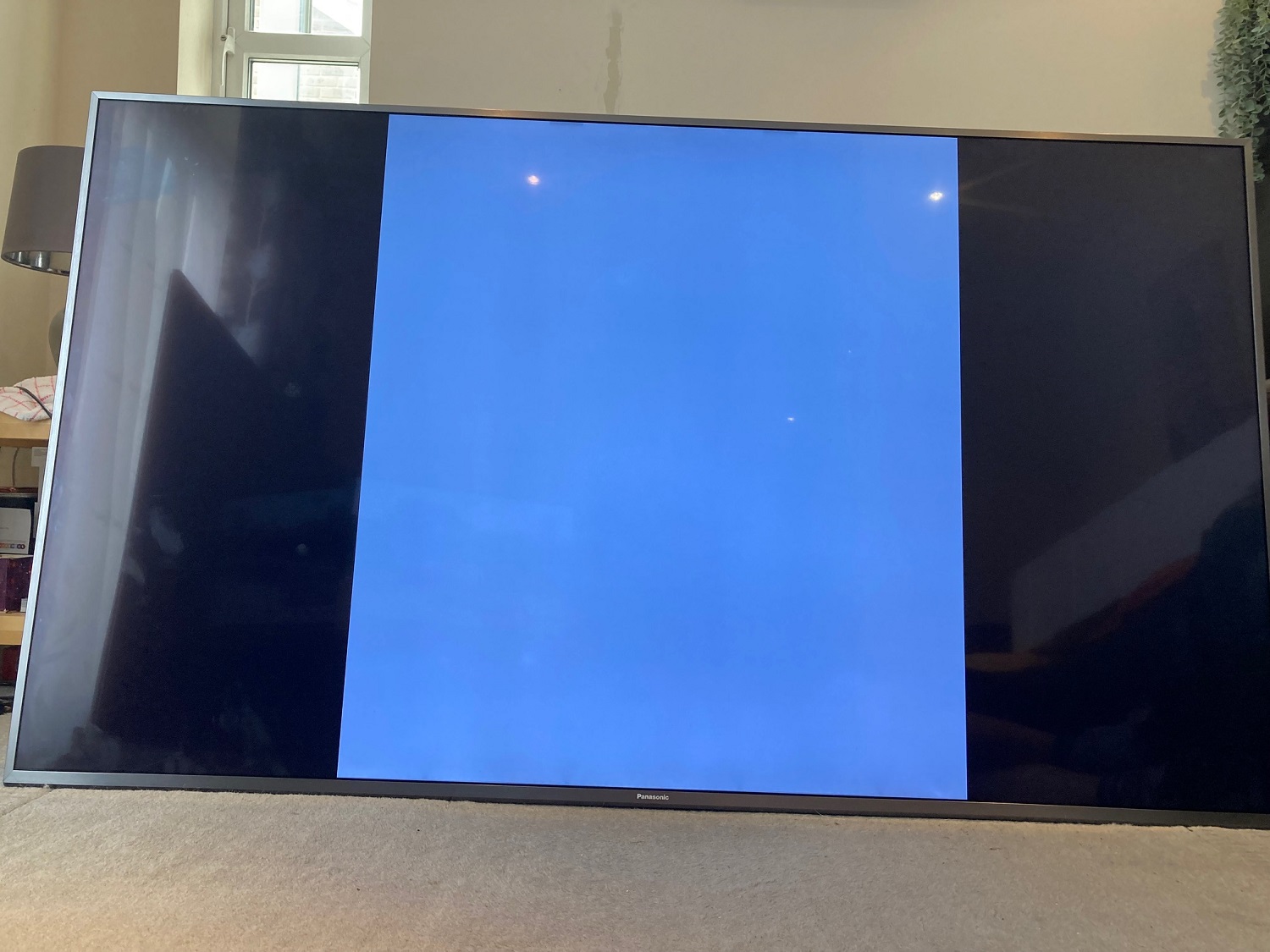

                        Originally posted by Michaelrobbo
                        Got a copy of the 65inch tcon epprom if any one needs it
                        Hi Michael,
                        May I please have it?
                        Also, after I changed the boards, now the tv lights up but the image looks like this. Is it normal before flashing the eeprom or did I mess it up while remving the caps?
                        Thank you for taking your time to post a solution.
                        • john@pchire.com
                          • Jul 2022
                          • England
                          #32
                          Heres a picture on what it would do after the TV would warm up you then turned it off and on and then it would work this will fix this problem models also effected are 65fxw724
                          i've had the same problem i replaced the t-conn board that i know works from another TV but now i'm getting this picture can any help or point me in the direction where i'm going wrong
