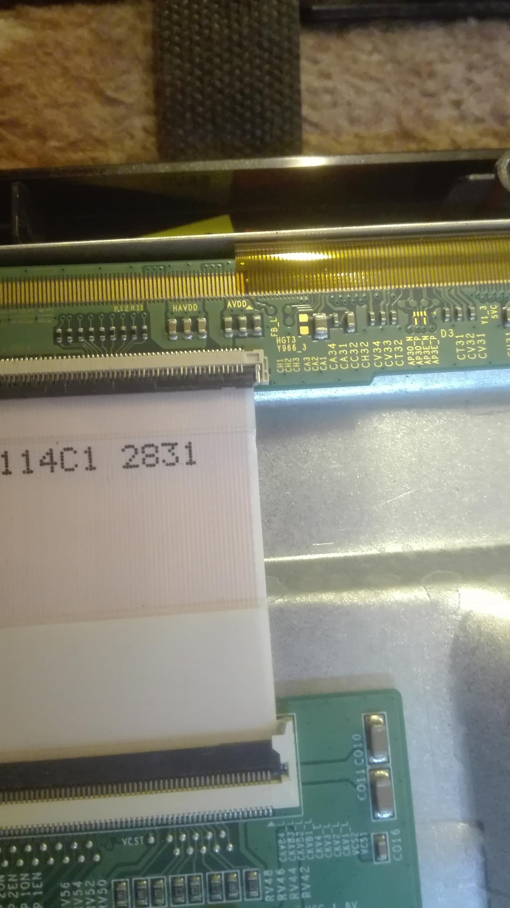

                            Re: Toshiba 48L5463DN no picture, backlight on
                            Start removing the suspected caps one a time since some of them may be connected in parallel and see if the low resistance reading goes away when the suspect cap/s is removed.
                            Also show us the pictures of the tab bonding (panel board).
                              Oh that picture, i did attatch it yesterday but here i try again
                                Is the suspected caps those in the picture from last post?
                                Hmm just googled tabs bonding! U mean the three flat cables from panelboard to screen?
                                  Tab bonding boards are the long green circuit boards that the LCD's flexible circuit boards are bonded to, as you can see lots of SMD MLCC (Multi Layer Ceramic Capacitor) are on that board in your picture.
                                  So which is/are the caps for the suspected bad caps that show low Ohm readings, the 3 MLCC connected in parallel to the AVDD? If they are then you need to remove one at a time to find out which one is bad.
                                  The designaotrs for those 3 MLCC for the AVDD are CA3, CA2, and CA1
                                    I desoldered this thre components (look at picture), none of them had a resistance near 24 ohms, its more like 1 megaohm and incrising to 20 mohm. And measuring at the Avdd testpoint on the t-con board, there is.still 24 ohms even when the componts is removed from the board.
                                    Now what?
                                        It seems that the defect is in the panel and is irreparable for you. It would be a chance if the panel has side drivers (some "ears" on the edge of the screen).
                                        And if the short is not in the top driver.
