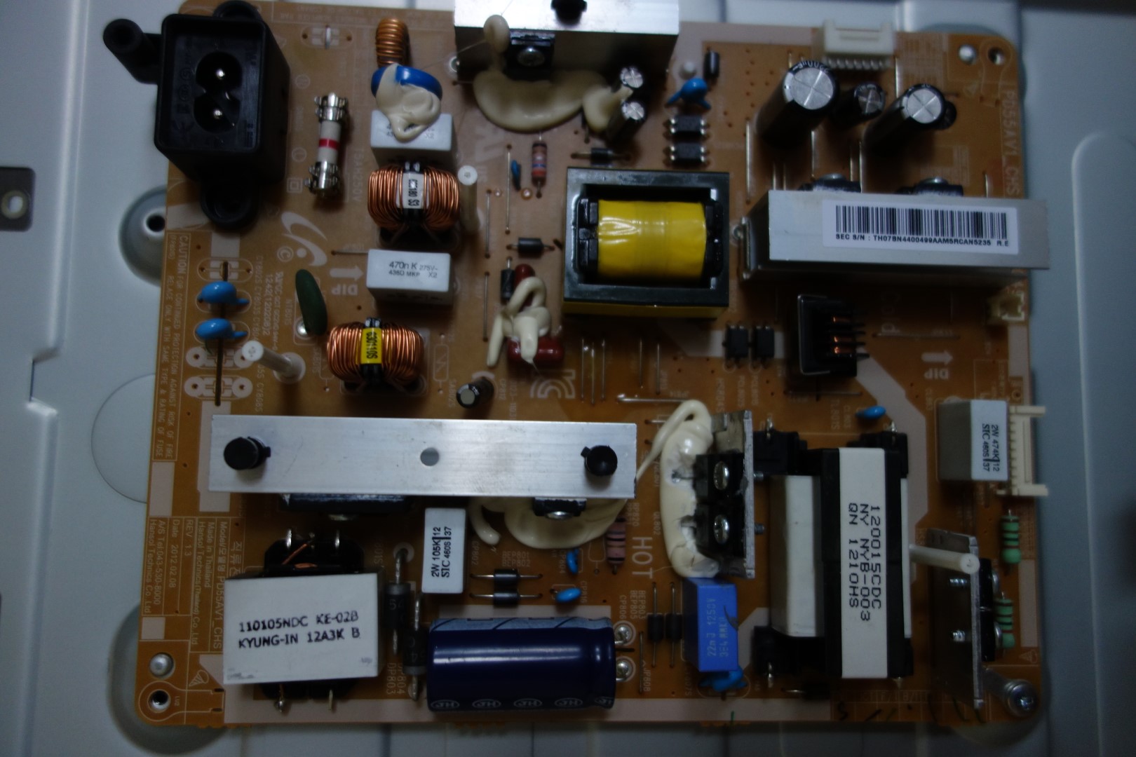

    This TV was originally dead. I found the main fuse blown and a dead short across the main filter cap. Eventually traced the short to QL801 and QL802 which I replaced both (NCH, 500V, 4.5A). Now standby voltages are not stable. PFC voltage drifts 389-392V and both 13V and 5V have a slow oscillation (enough to turn on the TV for a few seconds and to read the peak voltage on my DMM). Don't have a scope. Closest schematic I can find online is for BN44-00498A.

    unhook the main board from the psu and plug the tv in. See if the back lights come on and measure what the 12V and 5 V rails do.

      When I first plugged in the board, I did the backlight test and they came on momentarily. I opened up the the panel and confirmed all the backlights are working. I did check a few caps near the shorted FETs and they tested good. I also powered the backlight from the led tester and the tv was showing the logo and rebooting but likely from the oscillating supply voltage. The voltages are being measured with the main board and backlights disconnected.

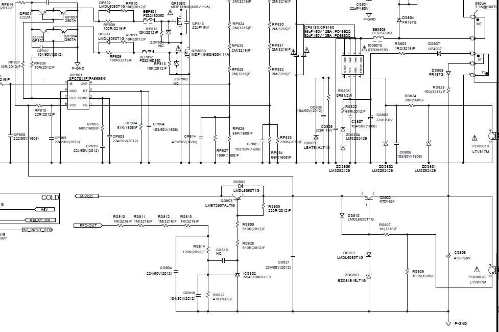

                      Thats the VCC for the pfc circuit, The source for that voltage is from the standby circuit, CS807 supplies the feedback VCC voltage for the standby ic, The elec. cap next to it, CS821 is the filter prior to the QS802 which is the VCC switch.
                      Check the voltage on CS821.
                      This schematic is similar, CS803(schematic)=CS807(on bn44-00499), CS821=CP812, CS808=CS821, QS802 is the same

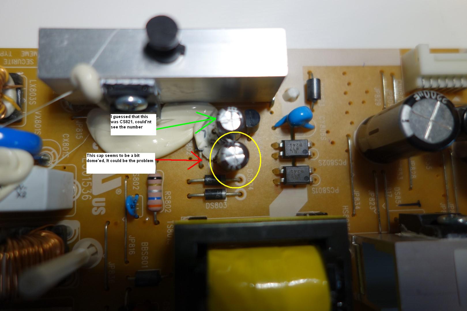

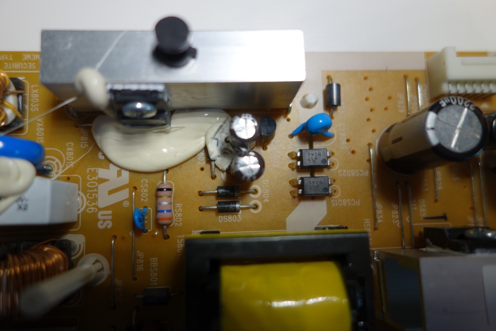

                            Here is a closeup of that section. CS821 has pads for a chip cap but isn't populated.

                              Re: Samsung UN50EH5300F BN44-00499A Power Supply Problem
                              It might just be the picture but that one cap looks a bit dome'ed I had to guess I thought it was CS821, must be something else

                                  Cap does look a little domed, you probably checked those 2 diodes there.
