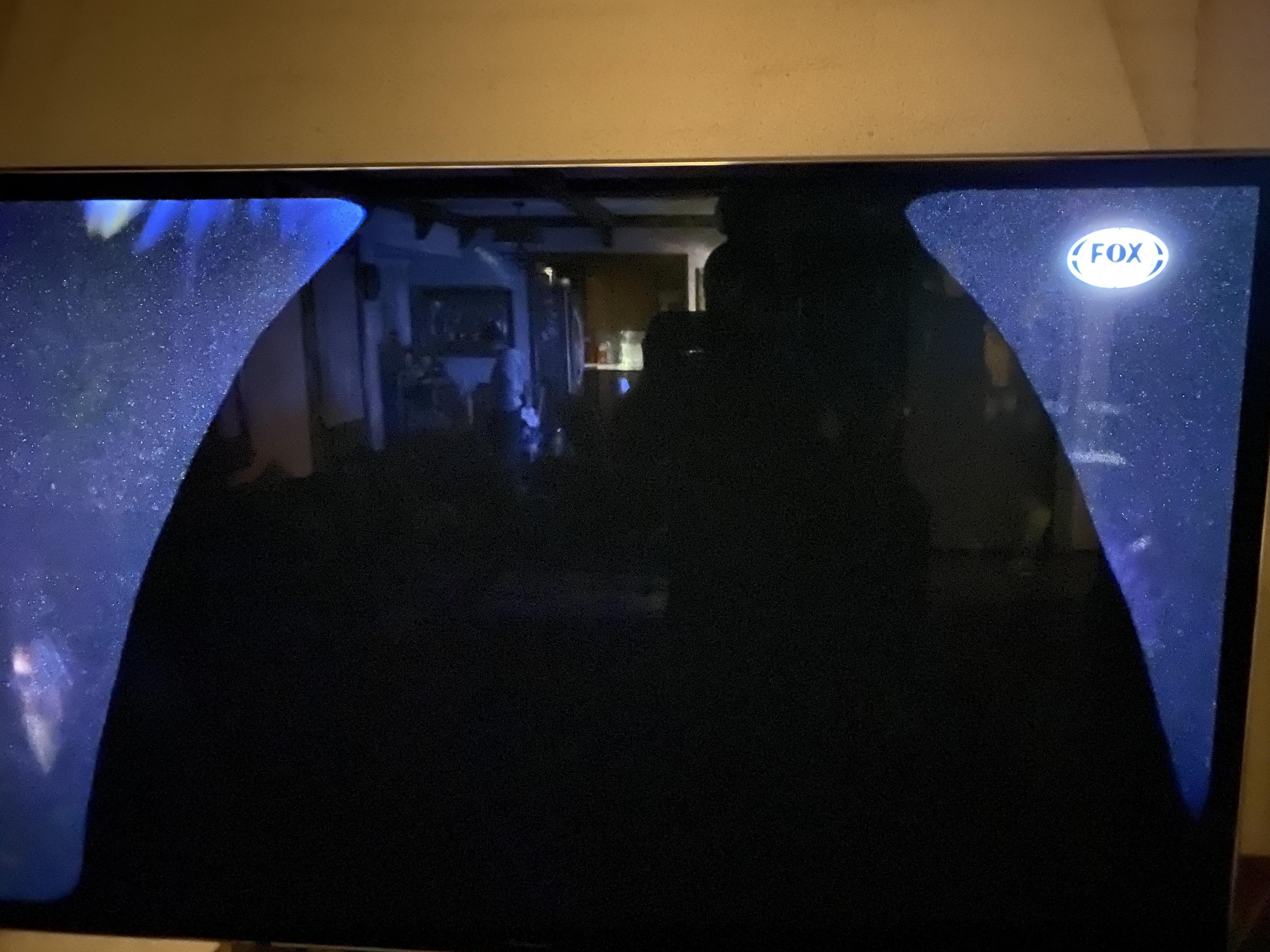

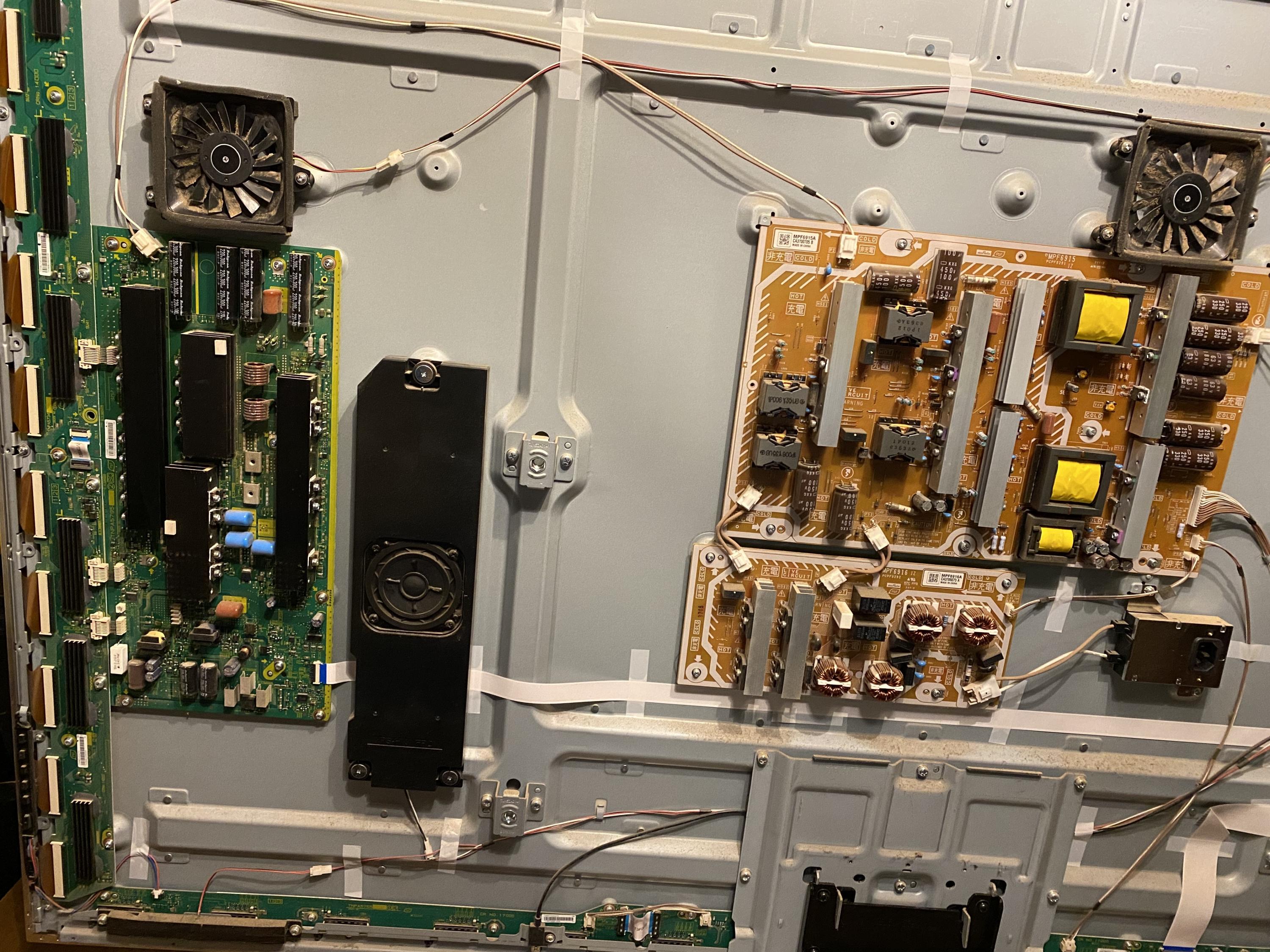

    I'm needing some help. I have had my TV for over 6 years and lot of hours, like so many hours I would be scared to check lol. When I went to turn it on last night, it had a huge black spot on it, it reminds me of a cracked screen. Yesterday I did have a house full of kids so it is possible something/someone hit it. I could tell with the TV on for 30mins or so the spot was growing. This morning around 8hrs later the TV is 100% black, with the TV on or off brightness does not change, it looks as if it has no power.
    What I do know
    1- When it is off or on I see no cracks (I also don't see any leaking like you would on a LCD cracked screen, but I'm not even sure if a Plasma would do that.)
    2-It is growing, the black spot is getting bigger, I think if i would leave the TV on for a hour or so the whole screen would be black.
    3-All inputs have the issue.
    4- Where I can see a picture at, it is really snowy.
    5- I do see pixel jumping around the outer edge of the black spot, and in the center of it every now and then I do see pixels jumping around.
    (8hr later update )
    1-TV is now 100% black, no change in brightens when off or on.
    2-I see no pixels jumping around.
    Please tell me this is not my panel, and one of the boards.

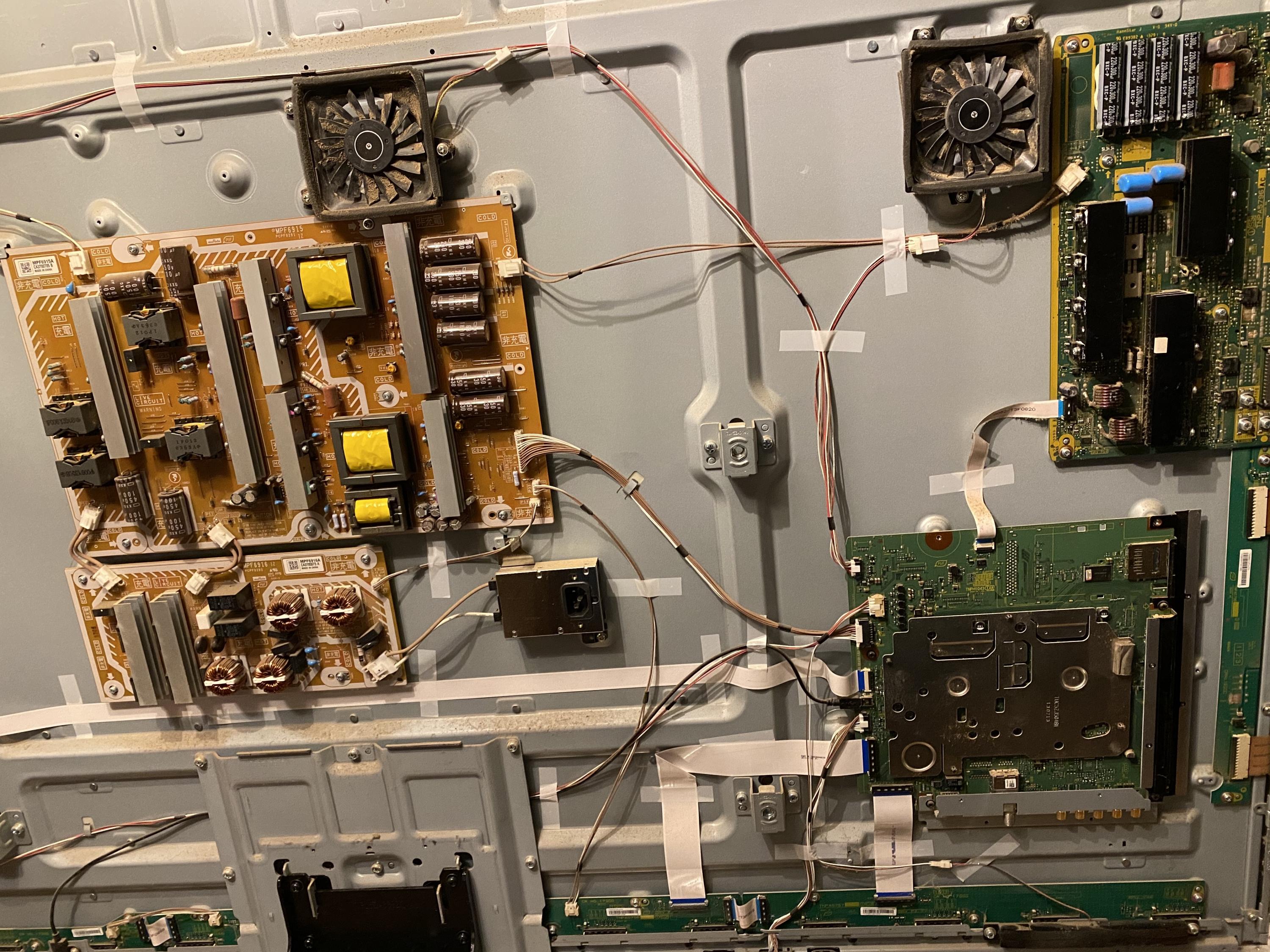

        On some of the threads people ask for pictures of the boards. So I went ahead and got some.
          Re: Please help, is my Panasonic plasma ZT65 dead?
          Probably the zsus or whatever Panny calls it. Board on the right - check if there are any fuses on it and see if they're blown.
          And blow that thing out it's filthy. And don't forget to clean the fans.

            Thats 6 years of hanging on the dust lol.
            I did look at all the boards on the right, none of them have any fuses. only boards I see that do are the two center ones, and all of them are good.
                I would be leaning toward a panel problem, SS, SC, buffer boards would likely cause a line or bar from left to right (edge to edge) also a fault with the C1,C2 boards (at the bottom of the panel) would cause a line or bar going top to bottom. This looks like the panel has a leak (center bottom) and there is very little gas left in the panel.
                It does'nt need to be a crack but the panel seal is leaking in that area. Stand the tv on its side or upside down and I suspect the black area will change.

                  I would of never thought about that. The next morning I went to turn it on and it's 100% black now, so I would be unable to perform your test.
                  Is there a way to test if the panel is indeed getting the correct voltage? Cause if the panel is getting the correct voltage, and it's not lighting up at all just staying black, and with it not blinking any error codes, the would rule out anything but the panel itself correct?
                  I just don't want to give up on it till I'm just about 100% sure it is the panel.

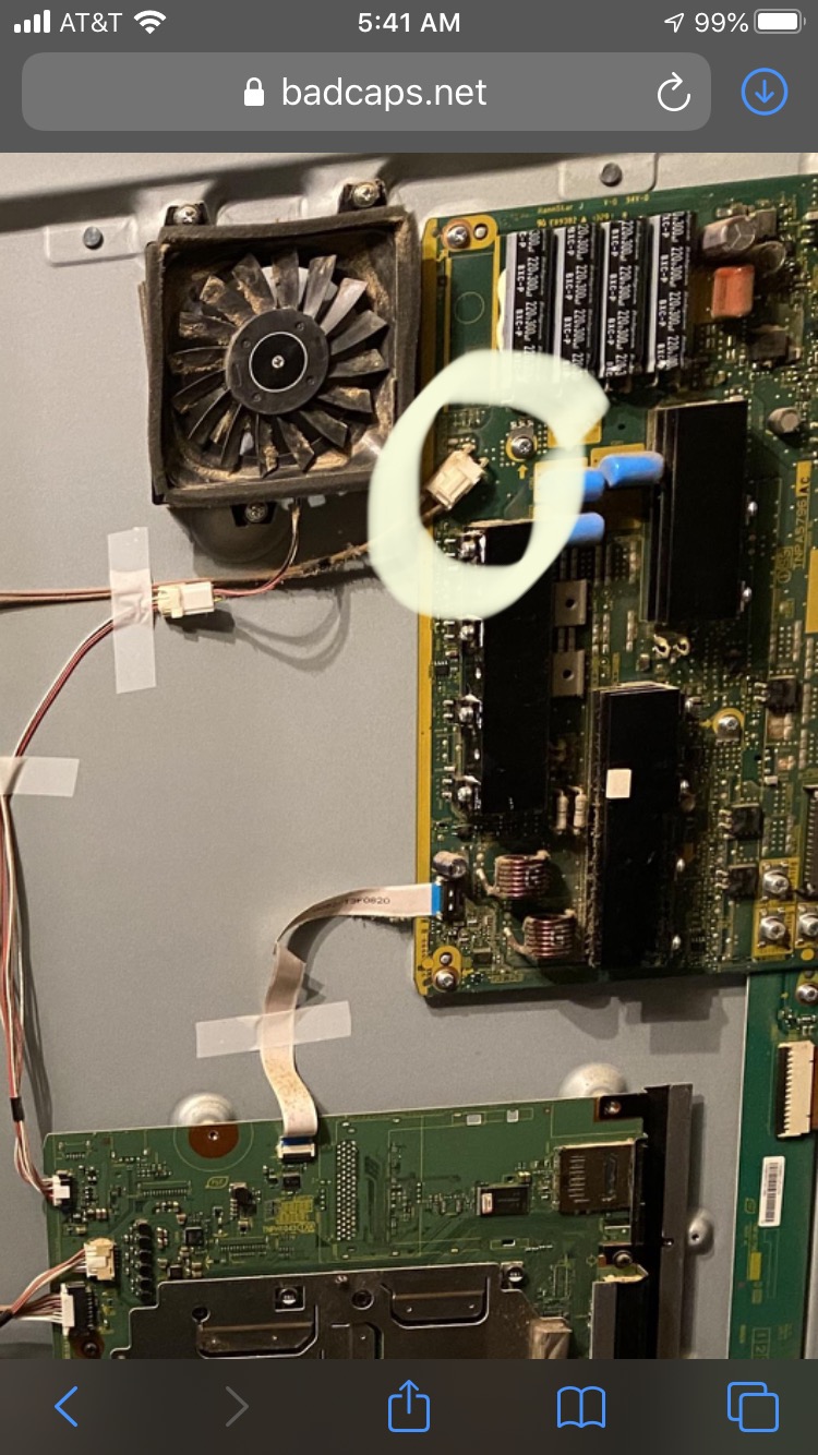

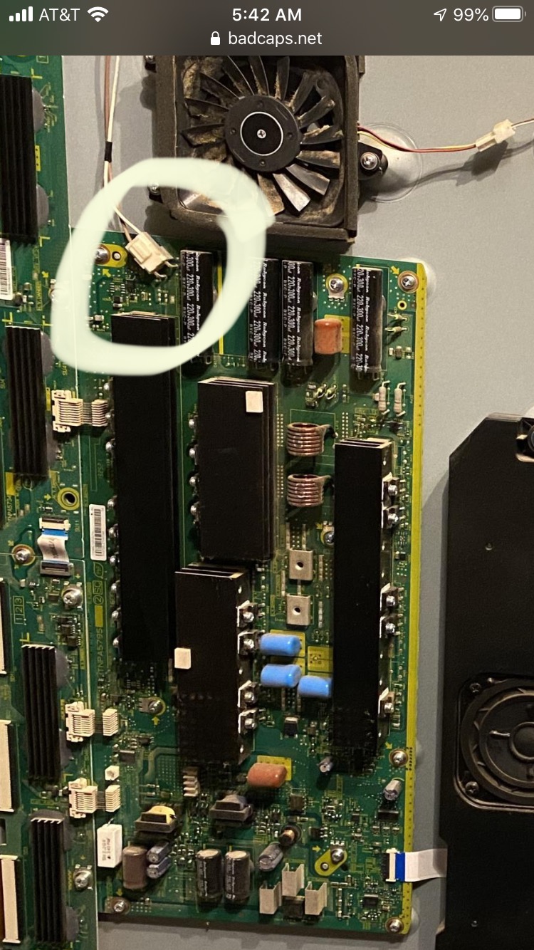

                        Make sure the tv is unplugged and has been powered off for at least 10 minutes. With a meter check the resistance both directions between the two pins that are circled white in the pictures with the plug unplugged from the board and report back on your findings. If you don't have a multimeter you can get a cheap one for around 10 dollars at Walmart or a hardware store that will work. Don't give up yet!

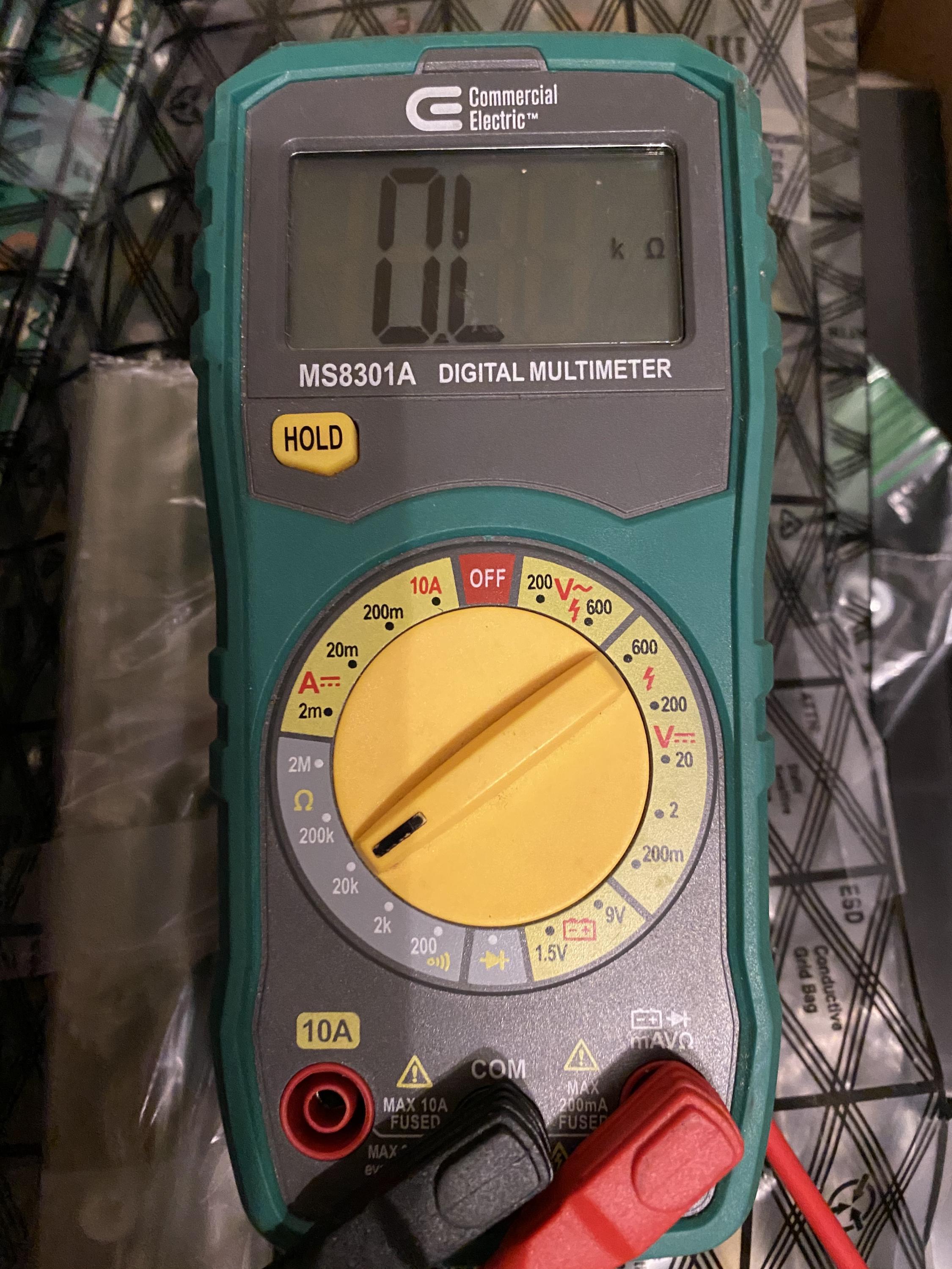

                            I did already pull everything off/out, but it can always go back together. Thanks for giving me something else to check out, any help is always appreciated especially before I recycle the panel. My multimeter has a few settings for ohms, I'm not for sure what setting I need it to be on, but I'm going to give this a shot.
                            board on the left side
                            Continuity- NO (No sound is made)
                            resistance on 2k -.958 (I only get that reading one way, if I swap the probes around on the prongs on the board I get nothing)
                            Center top board
                            resistance on 20k - 15.09 (I only get that reading one way, if I swap the probes around on the prongs on the board I get nothing)
                                    Looks like your SC board or the board on the left is bad. 900 ohms is way too low. You’ll probably find some of the ICs mounted to the heatsinks shorted. You can also check the SD and SU boards for shorted buffer ICs. Those are the boards that are mounted between the flat ribbons that go to the panel and the left board. Here’s a link to a video on how to do that.

                                      There is no way a bad SC board, SS board or buffer board would cause the image in post #1
