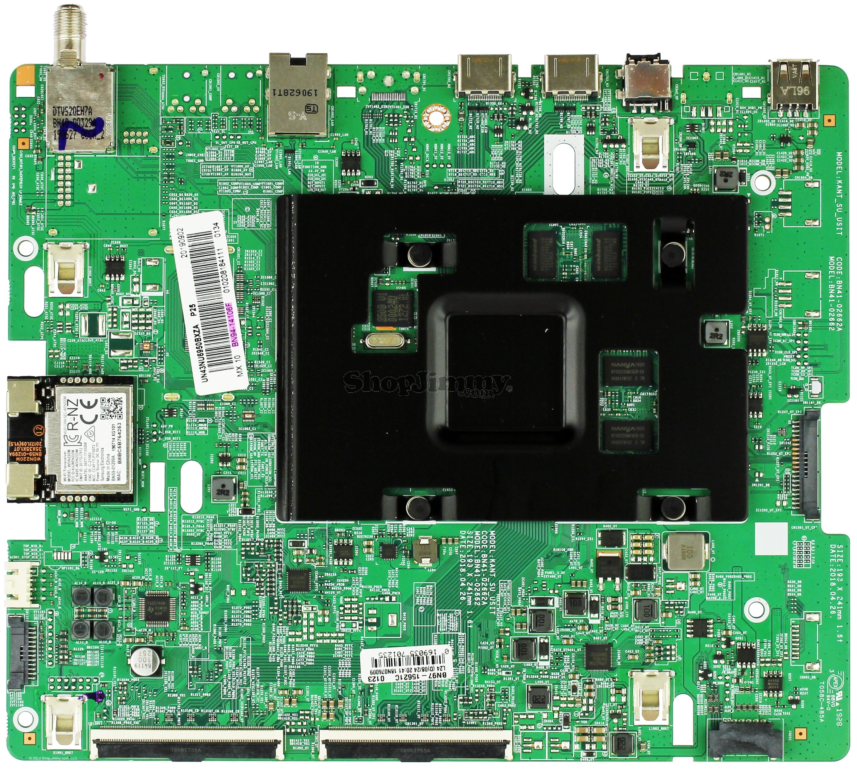

    Samsung UN43NU6950BXZA no sound, no picture nor backlight.
    Disconnecting the cable that link the mainboard and power supply brings on the backlights. With PS and mainboard connected, when I press the power button the power_on/off 3.3V goes to power supply, The PS voltage goes up to 12.9V from 11.5V when that happens. Backlight does not come on. After about 10-15 seconds Power_on 3.3V drop to zero, power supply goes back into standby. I disconnect the panel same problem. The mainboard numbers are BN94-14106F
    BN94-14106F, BN97-15621C, BN41-02662A. Any suggestions, any service information?

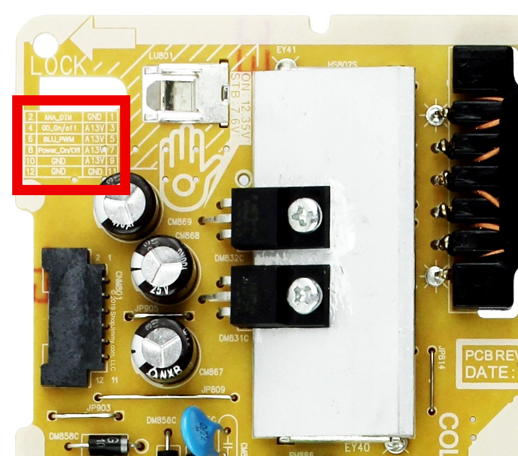

    How about the control Voltages on pins 2, 4, and 6 when main board is connected and not connected?
    Seems to be main board issue since the power board self test is OK.

      Re: Samsung UN43NU6950BXZA no sound, no picture nor backlight.
      With PS disconnected from mainboard:
      Pin 2 =3.06V
      Pin 4 =0V
      Pin 6 =3.61V
      With PS and mainboard connected and TV in on state
      Pin 2 =0V
      Pin 4 =3.38V
      Pin 6 =0V
      Voltages were measured on PS connector. NB that pin 4 on the PS is NC (not connected) to the rest of the circuit.

        As Bud suggested, looking like a mainboard issue.
          A closer look at the PS above show that the STB should be 7.6V and the ON= 12.35V. I measured STB=11.5V and ON=12.9V. Are those normal or it because the PS is not under full load because the TV is not coming on 100%?
