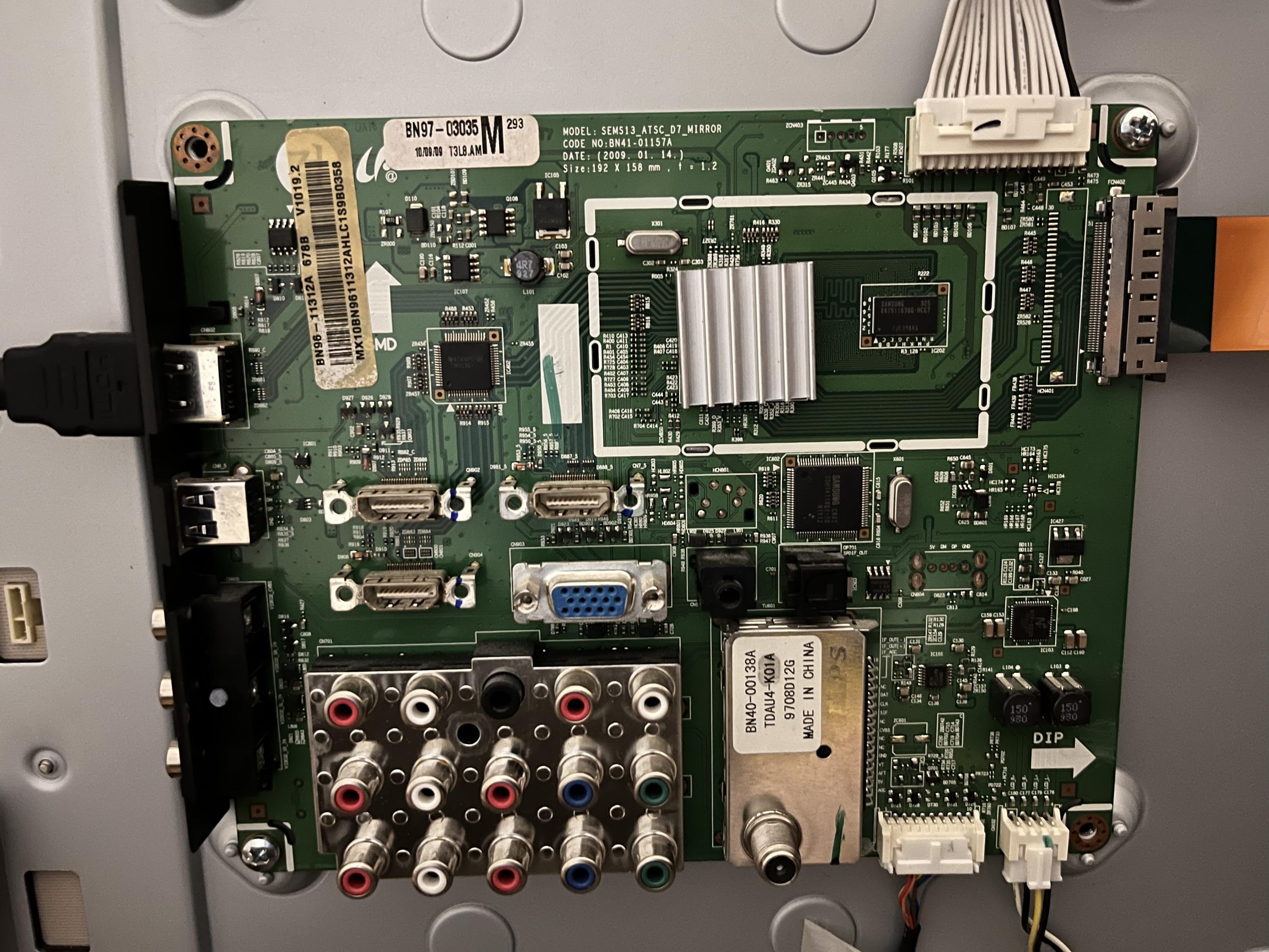

    With my laptop connected to HDMI4 port, I tested the voltages of the connectors:
    Power board (BN44-00267B) to main board (BN97-03035M) connector (CN801):
    5V_DET 0.1V
    E-PWM 2.77
    I-PWM 0
    INV-ON 0.05
    13V 12.81
    5.1V 5.15
    SB 5.2V
    PS 1.22
    SYNC 1.74

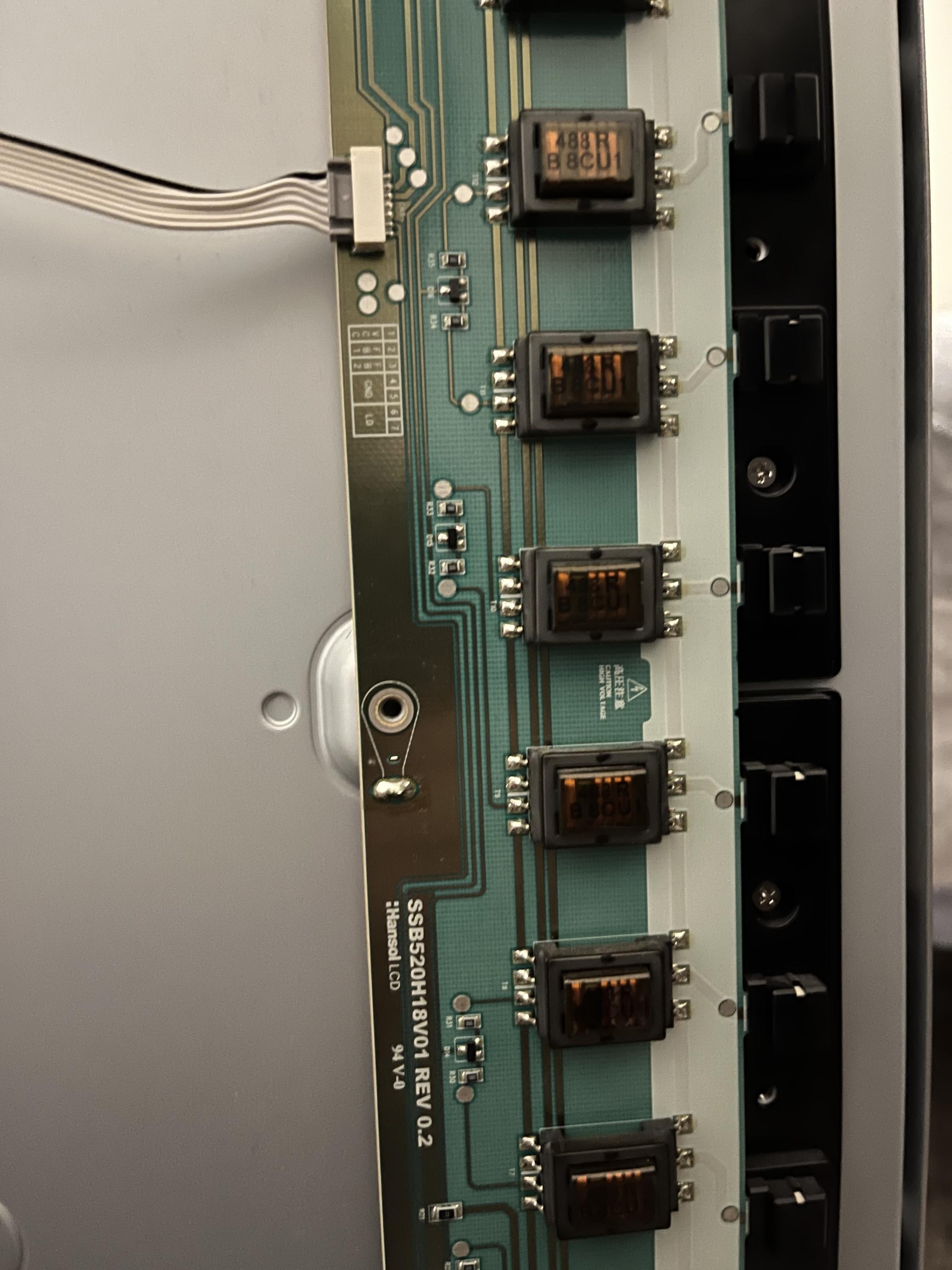

    Power board to LED driver board (SSB520H18V01):
    VCC 12.81
    FB1 0
    FB20
    GND0
    LD9.3

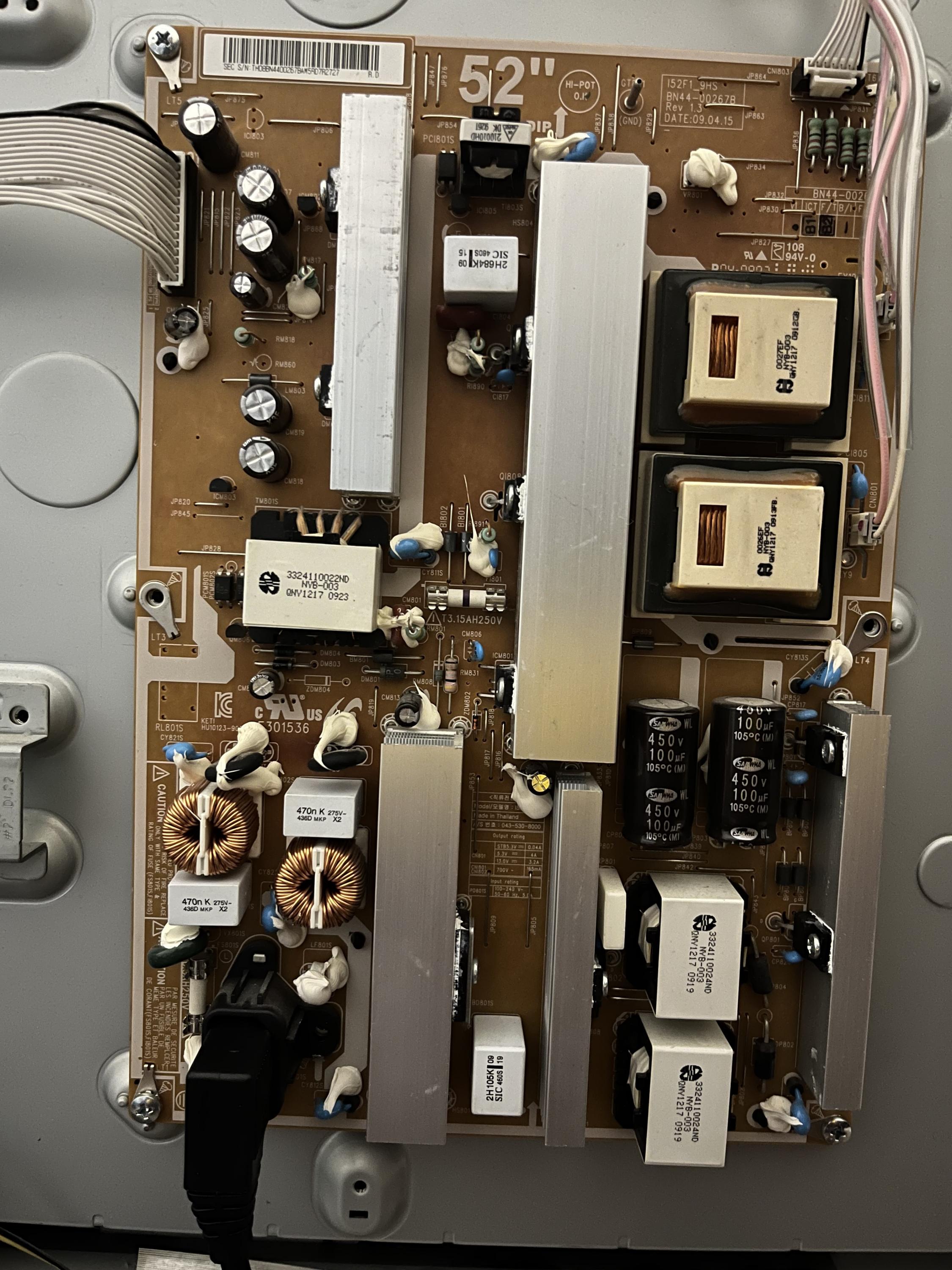

    Power board main capacitor: 60-64V~
    Unwelded caps:
    2H684k: 650n
    470nk: 450n
    Voltage of T-con fuse: 12.8V

            It helps when I read the whole post, lol, so the main caps have 64 volts and you can see an image with a flashlight? what voltage do you get on main caps with inverter unhooked from powerboard?

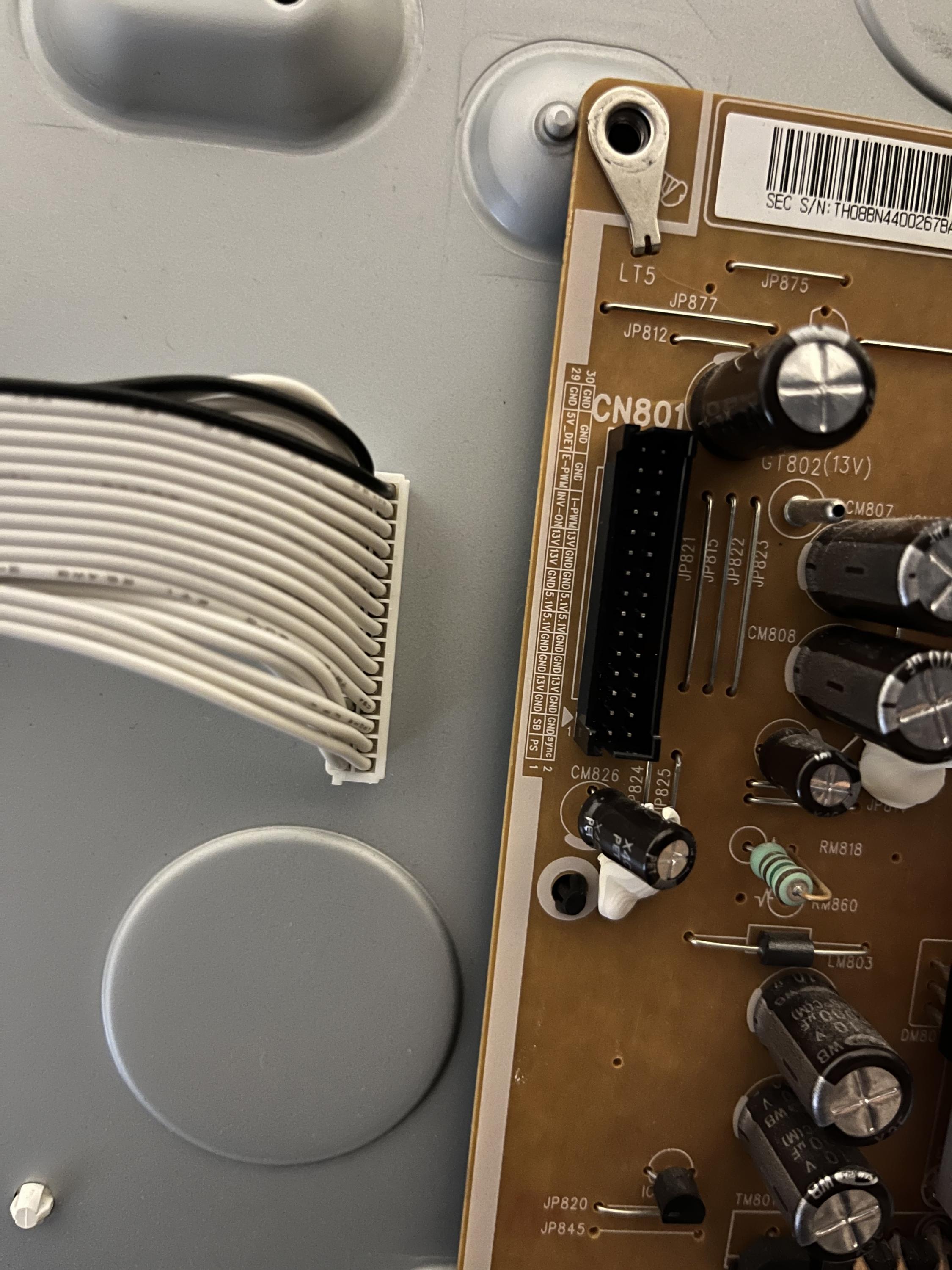

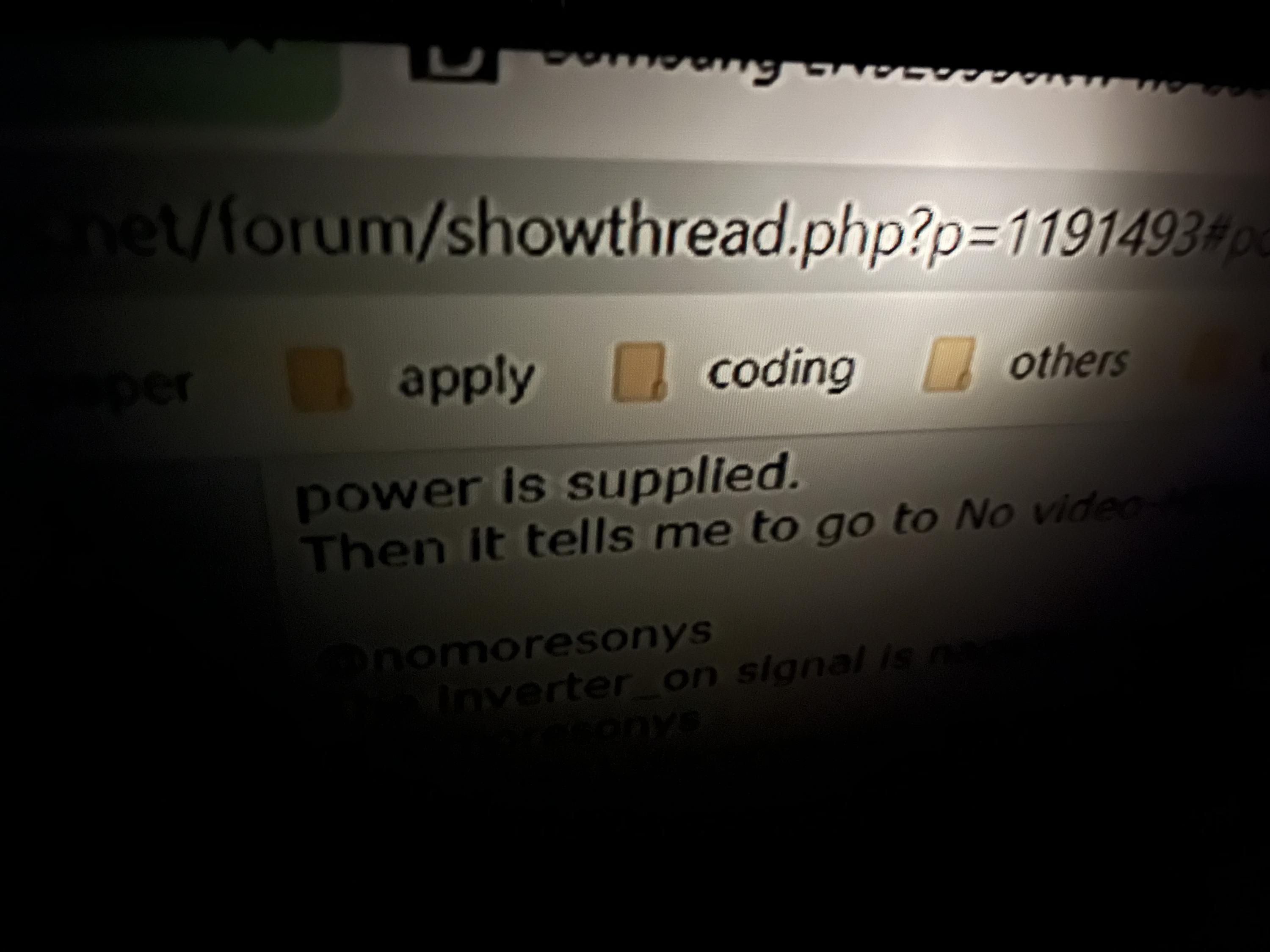

                      • henry21347
                        • Dec 2022
                        • 5
                        Re: Samsung LN52B550K1F no backlight has picture has sound
                        I would check the voltage at ps-on and inv-on, check it just like this, tv off but plugged in[standby] put neg. probe on metal chassis ground, pos. probe on the top of connector contacting the metal part of wire terminal, make note of voltage, leave it in place power up tv, make note of voltage, do the same to both ps-on and inv-on, both should change from 0 to 5 volts or 5 volts to 0, and hold steady in properly working tv.
                        Both main caps read 60-64V~ with inverter unhooked from power board. But there is a surge of volts at the begining exceeding the multimeter (>750~).
                        I can see an image like this with a flashlight put in the holes from the back.
                        All little transformers on the inverter board read about the same ohm (output 17 ohm between pin2 and pin1/3, input 0 ohm between pin1 and pin4, 0ohm between pin2 and pin3, open between pin 1/4 and pin 2/3). The little transformers model is 488R B8CU1.
                        I don't know which one is power_on actually, but I suppose 'PS' is power_on. In stand_by mode (power connected but shutdown), all pins of CN801 is 0V. After I turned it on and heard the start up music, I measured CN801 on the POWER BOARD:
                        PS 1.02V
                        SYNC 1.6V
                        SB 5.1V
                        INV_on 0.02V
                        Can anyone tells me what the pins mean? I uploaded an image of the CN801 connector.
                          is that capacitor right next to the connector domed/bulged on top at all? looks like it.

                                maybe test the main cap/s on the good tv if you have easy access like this one, should be around 400 volts dc when powered on, something seems quite off with the readings.

                                  Both main caps read 64-64V AC and 319/-55 V DC against ground and 0V AC and 390 V DC from themselves. This is about the same as the good TV.

                                    ok, I kinda thought you were measuring in ac instead of dc, the 390 is all we needed, so thats good, means the powerboard is working ok, at least up to that point.
