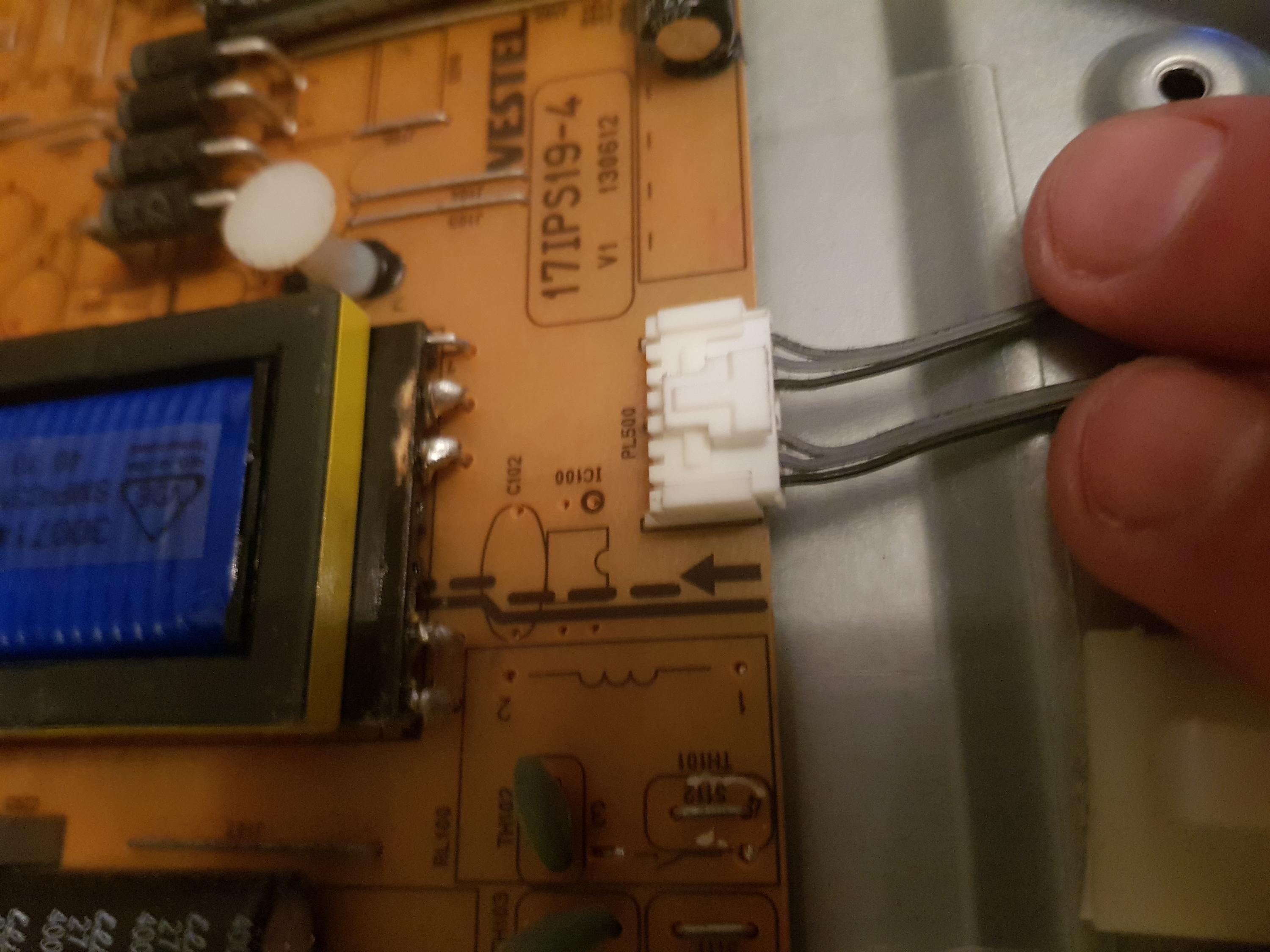

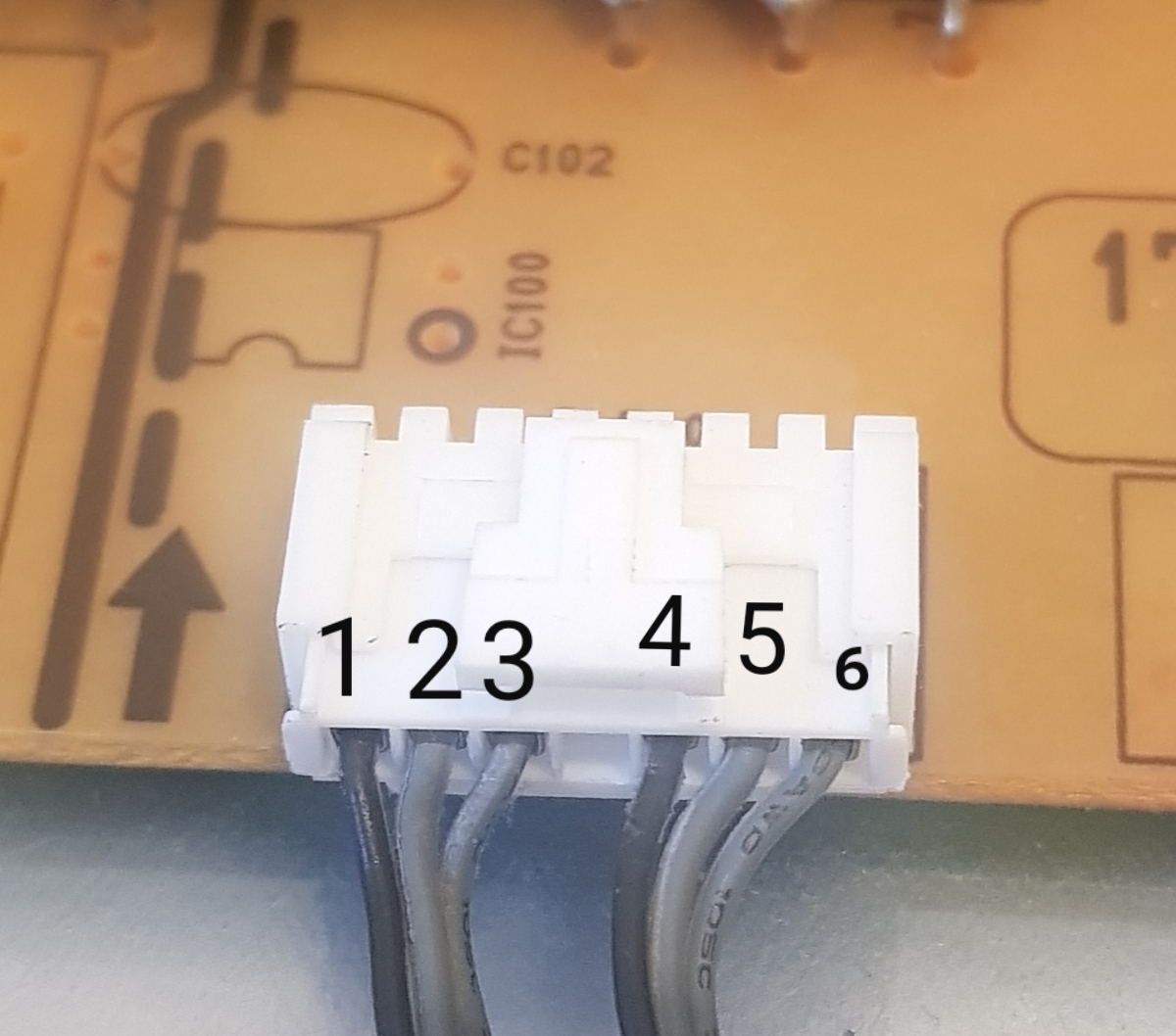

              How would I go about testing using this plug with being 6 wires?

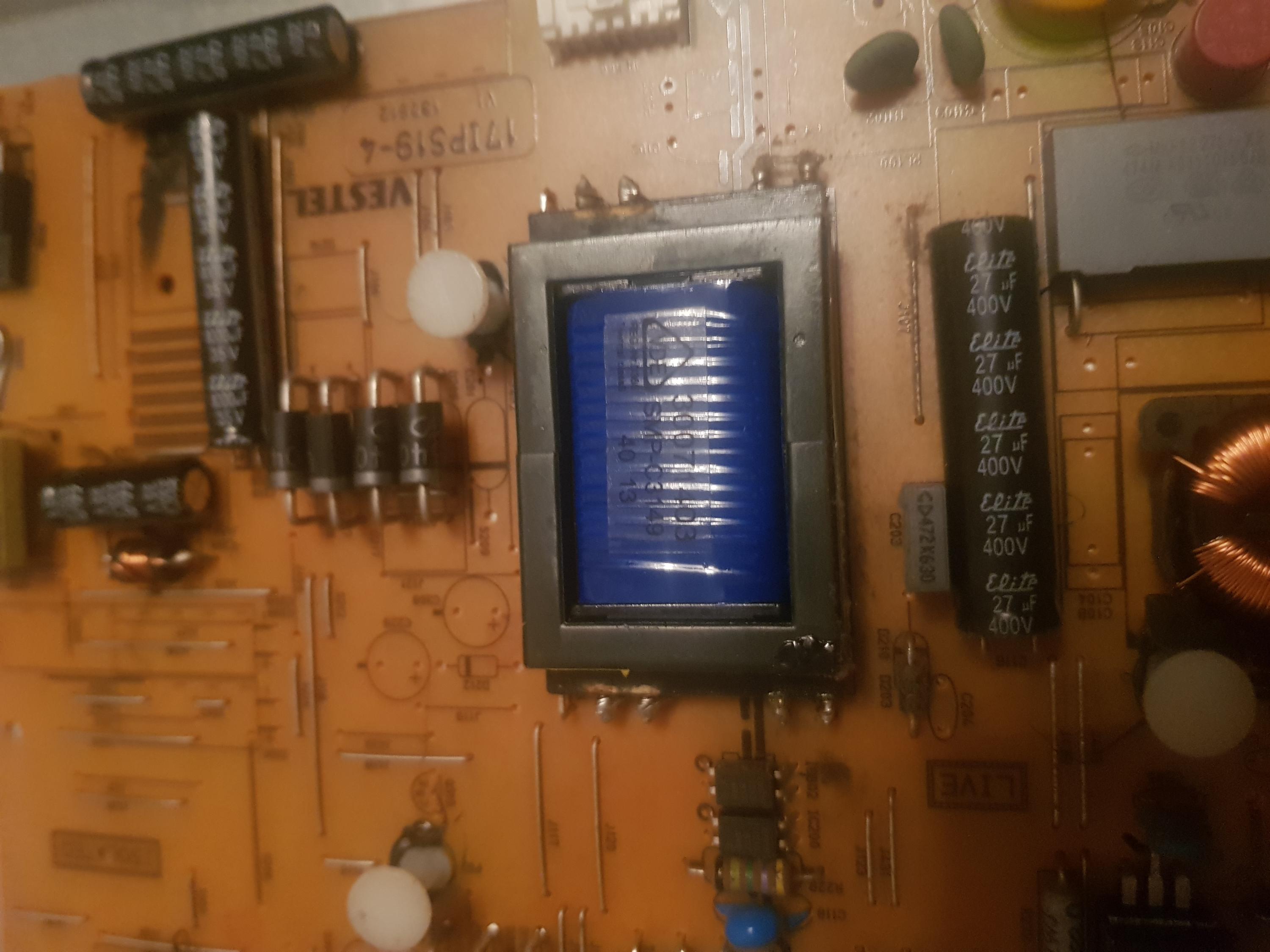

                  Dont know if its relevant, but there is what I would describe as a fluttering noise coming from the blue one on powerboard, I would say in sync with the flashing backlights

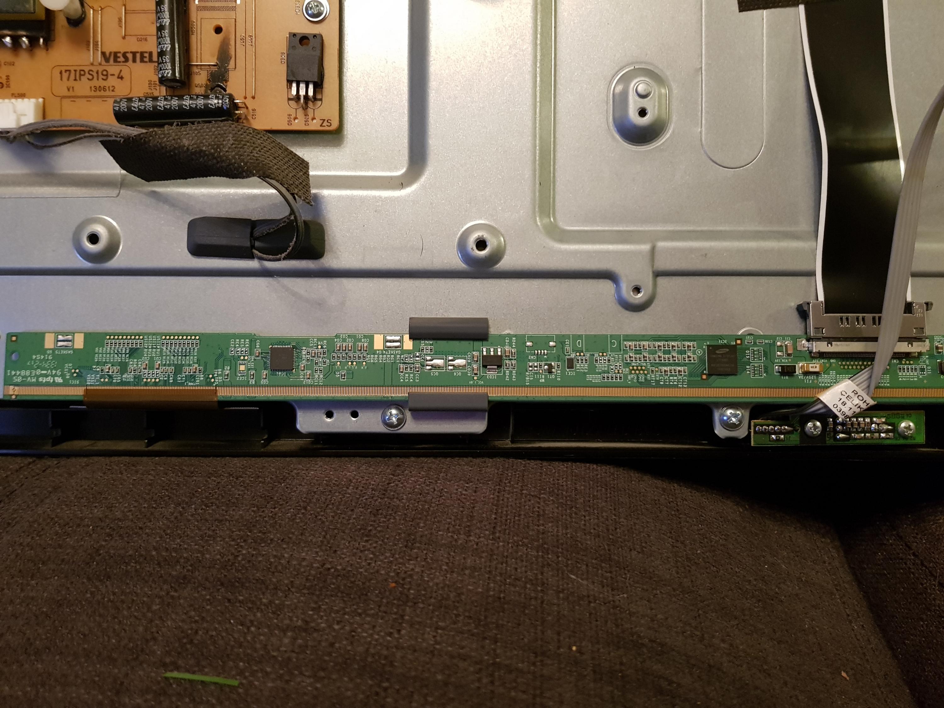

                    Re: Bush LED40127FHDCNTD No Picture

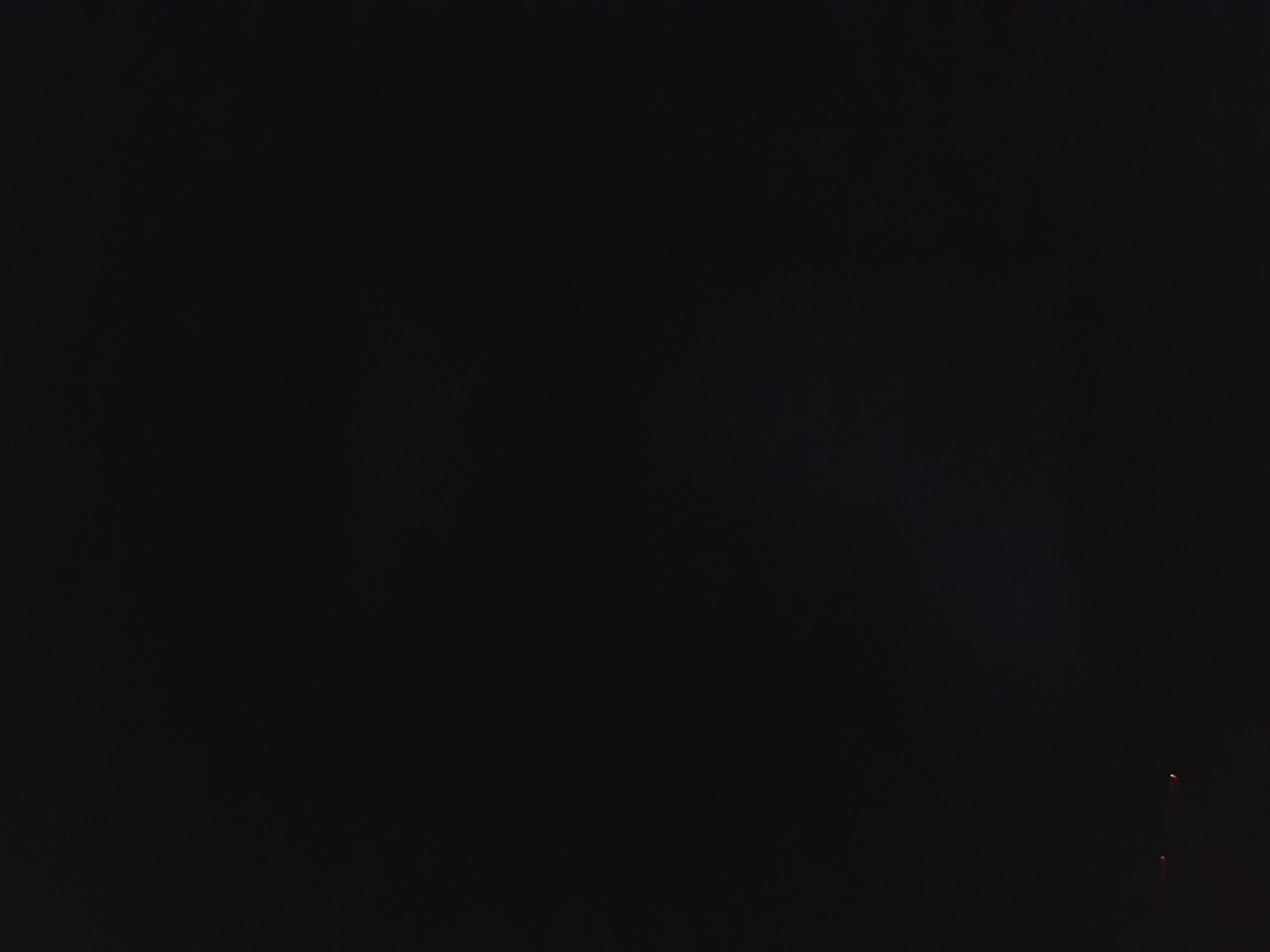

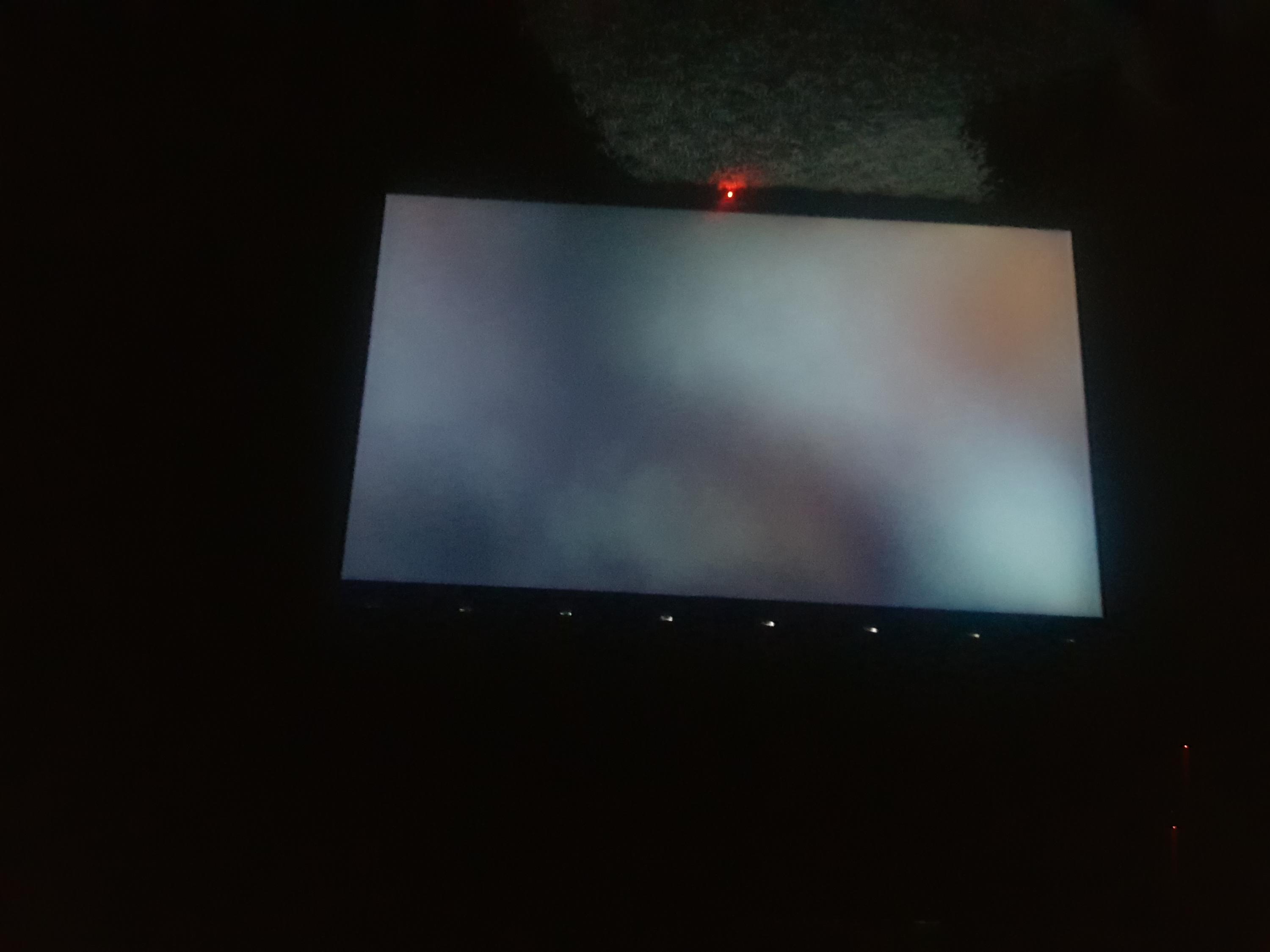

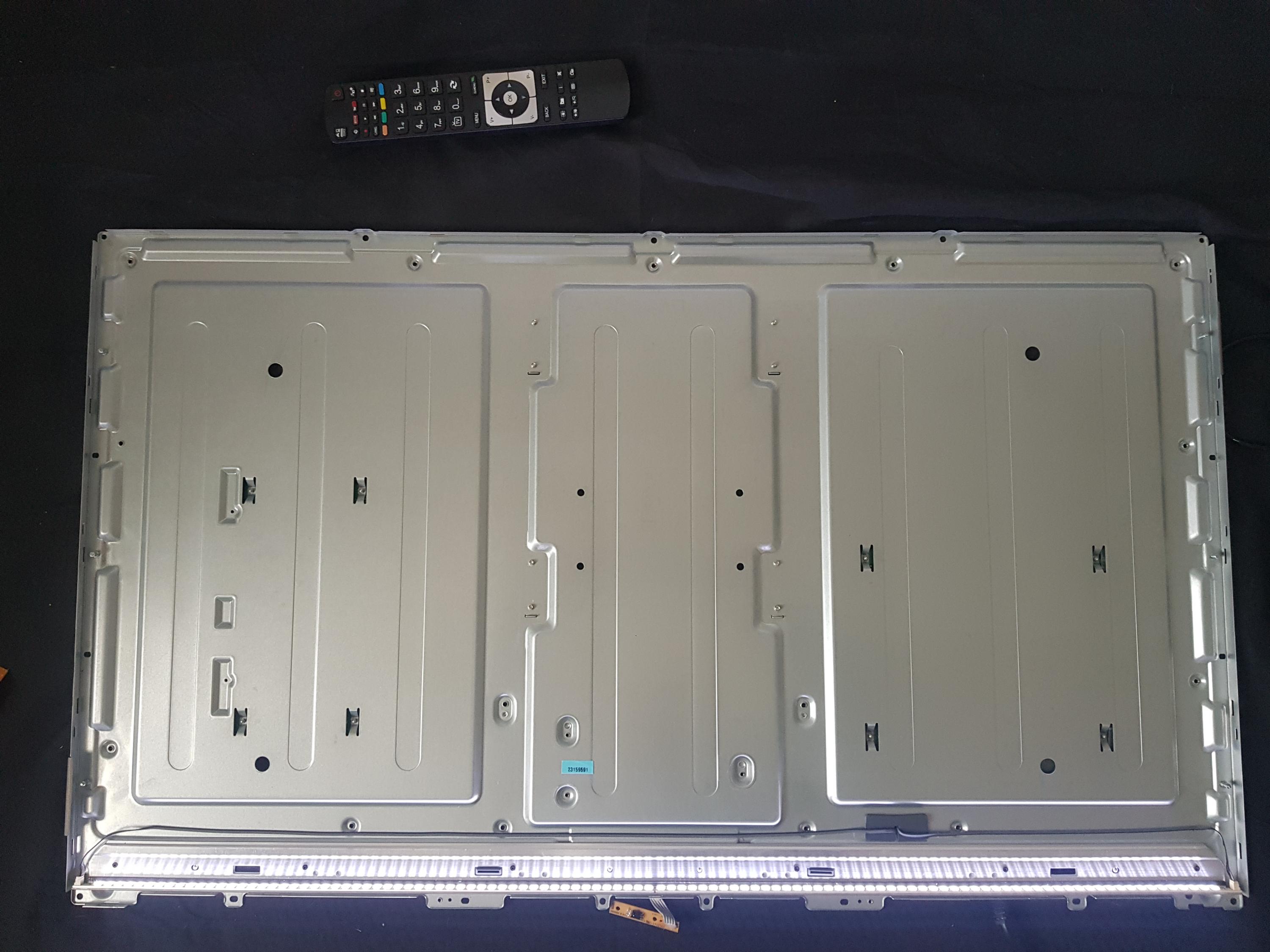

                    Again, not sure if this is relevant but when TV firsts starts up, the screen illuminates brighter as you would expect and lights are steady, but no image, then after a few secomds dims down, and you get the pulsating/strobing backlights, which, the strobing tbh isnt so visable looking at the screen, its more noticable as I have the back cover removed and can be seen through the holes in the chassis from the rear.
                    I have tried to capture it in a dark room in the following attached pictures. Please note the 1st pic, when the screen is bright and steady, its not multicoloured, its just the usual grey you would expect as normal, but for some reason my camera shows colours lol

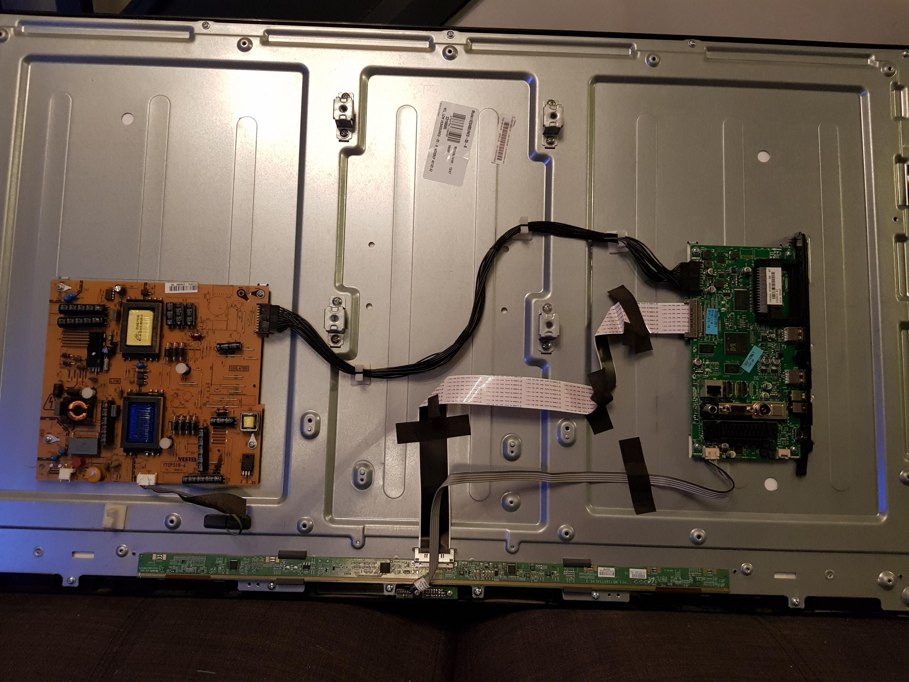

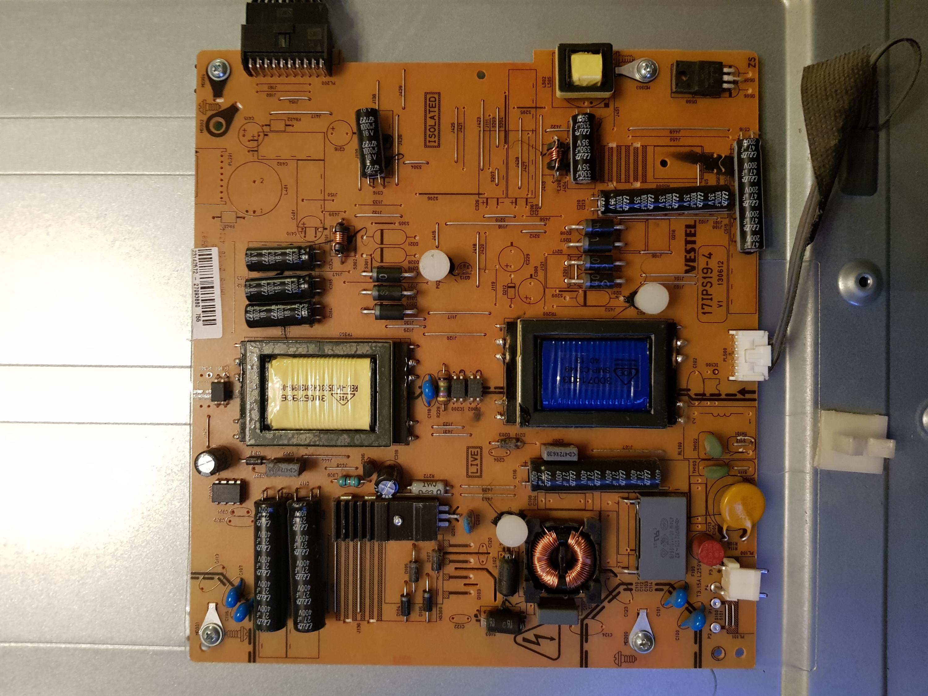

                      I have stripped this down today, this is the first time I have came across a TV with backlight set up like this.
                      So all the backlights are lit, just with a strobe light effect. Have checked all the plugs and connections, no change.
                      What is the best way to go about testing these in the correct manor?

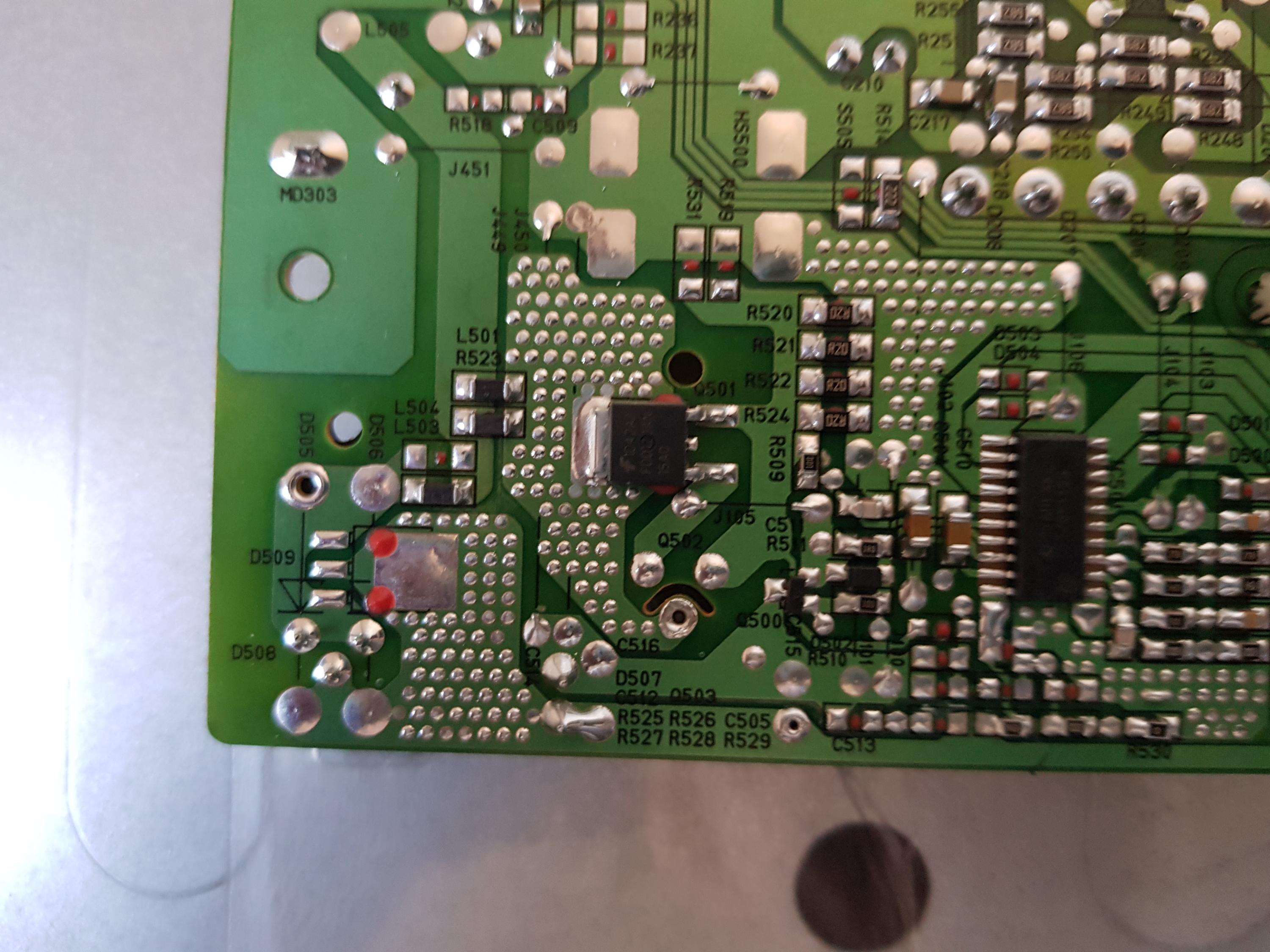

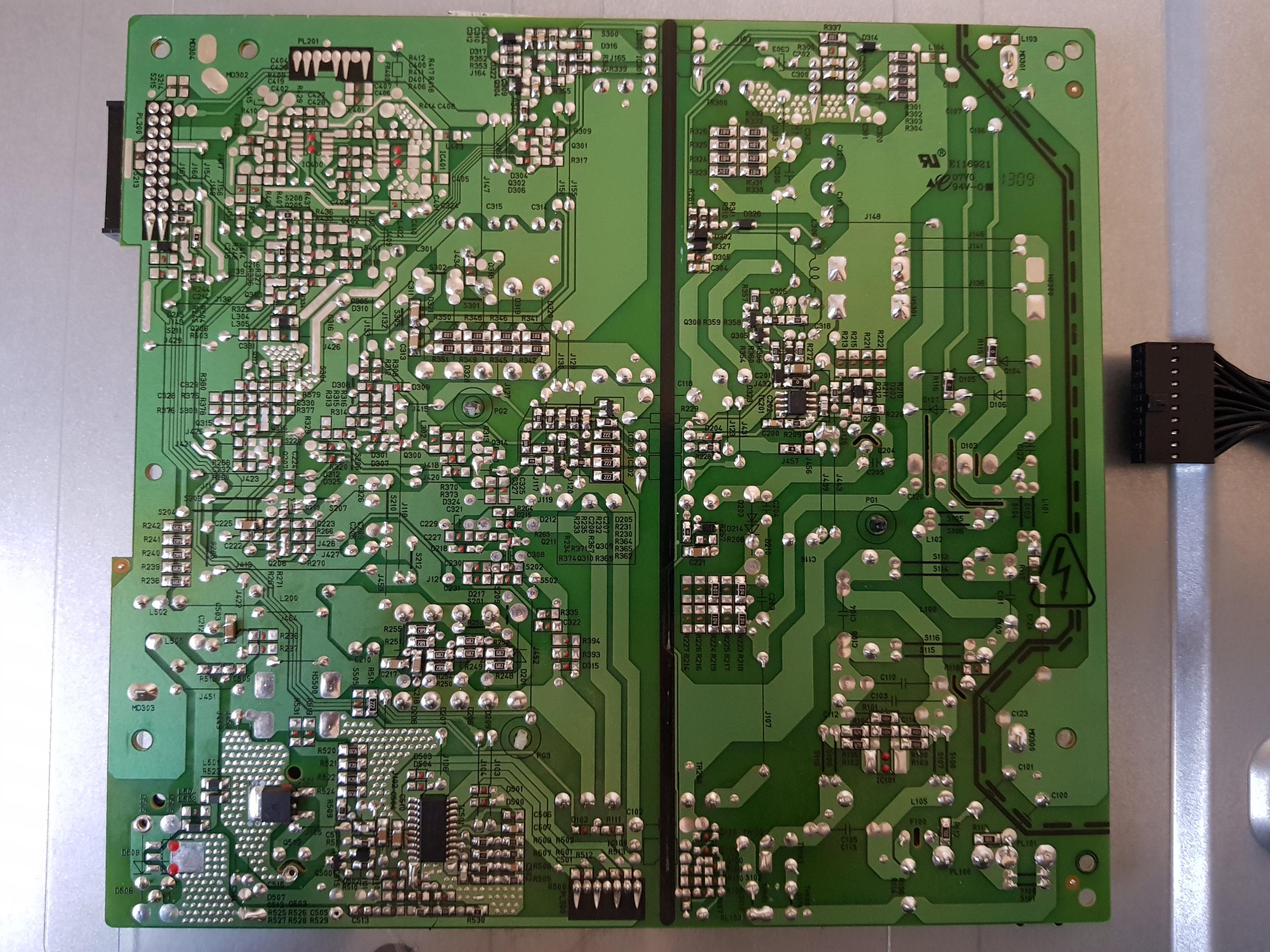

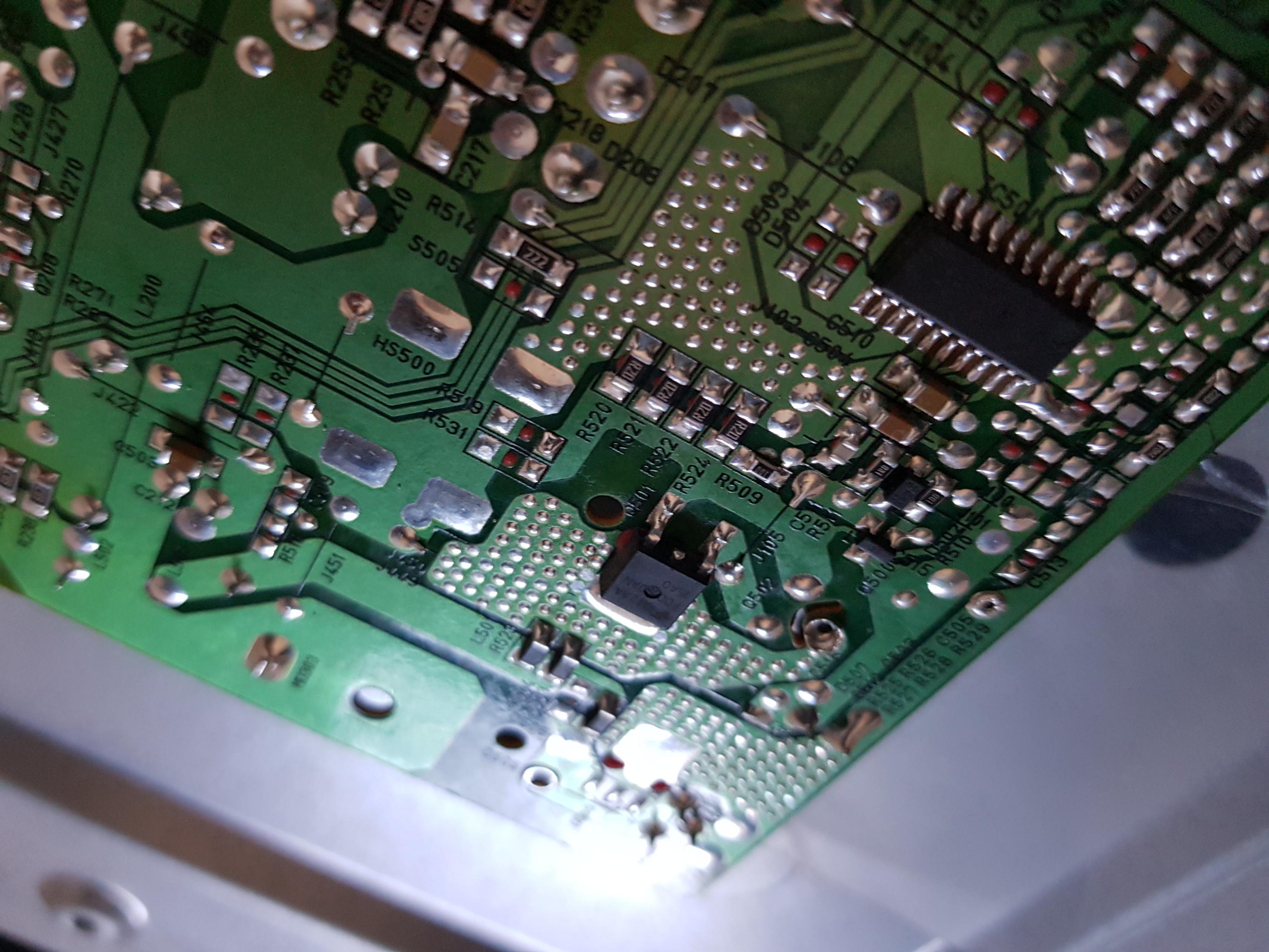

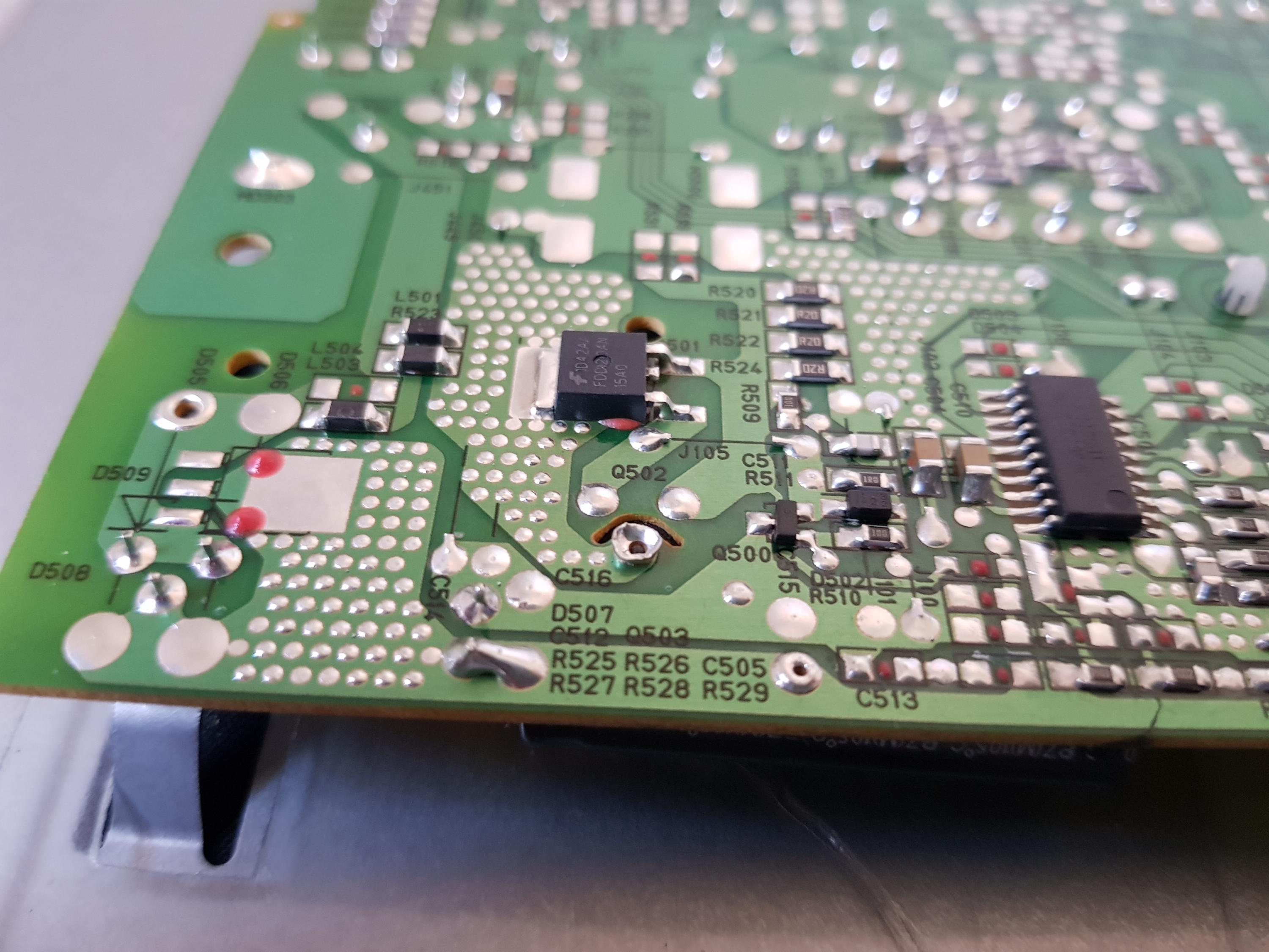

                        Also, just having a look on the underside of the powerboard, and came across this bit, does that look strange to anyone? Or would that be normal???

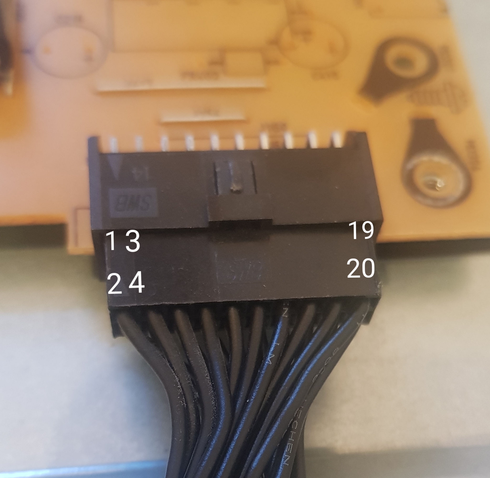

                          Do these readings look ok?? Readings taken with TV turned on and backlights strobing
                          Backlight Plug
                          1. 86.1v fluctuates up to 88.2v and down to 80.7v
                          2. 17.1v
                          3. 16.7v
                          4. 80.7v fluctuates 80.9v
                          5. 23.8v fluctuates 24.0v
                          6. 16.7v fluctuates 16.8v
                          Plug to Mainboard
                          1. 24.9v
                          2. 0v
                          3. 0v
                          4. 0v
                          5. 03.01v
                          6. 0v
                          7. 00.6v
                          8. 0v
                          9. 05.5v
                          10. 12.4v
                          11. 05.5v
                          12. 05.3v
                          13. 12.8v
                          14. 12.4v
                          15. 25.1v
                          16. 03.3v
                          17. 03.4v
                          18. 03.3v
                          19. 0v
                          20. 0v

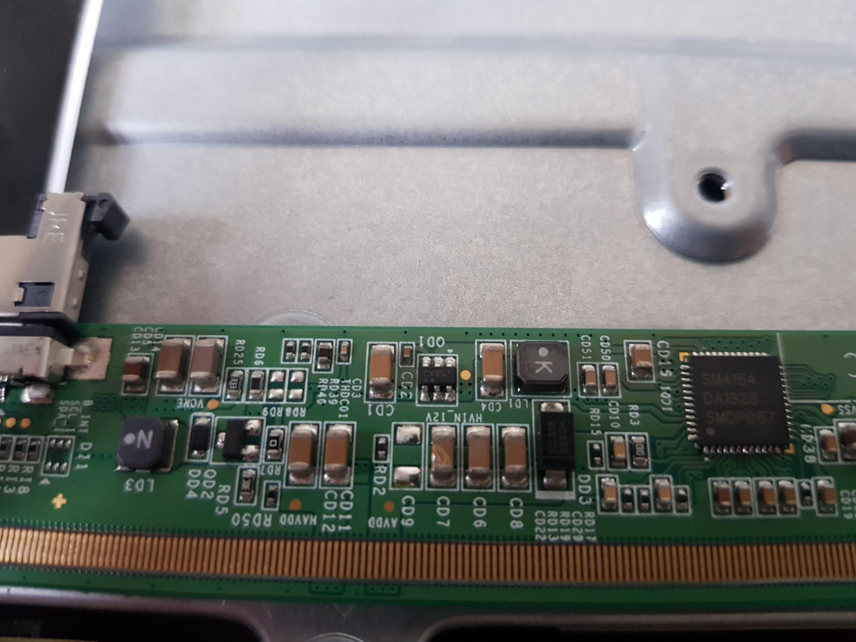

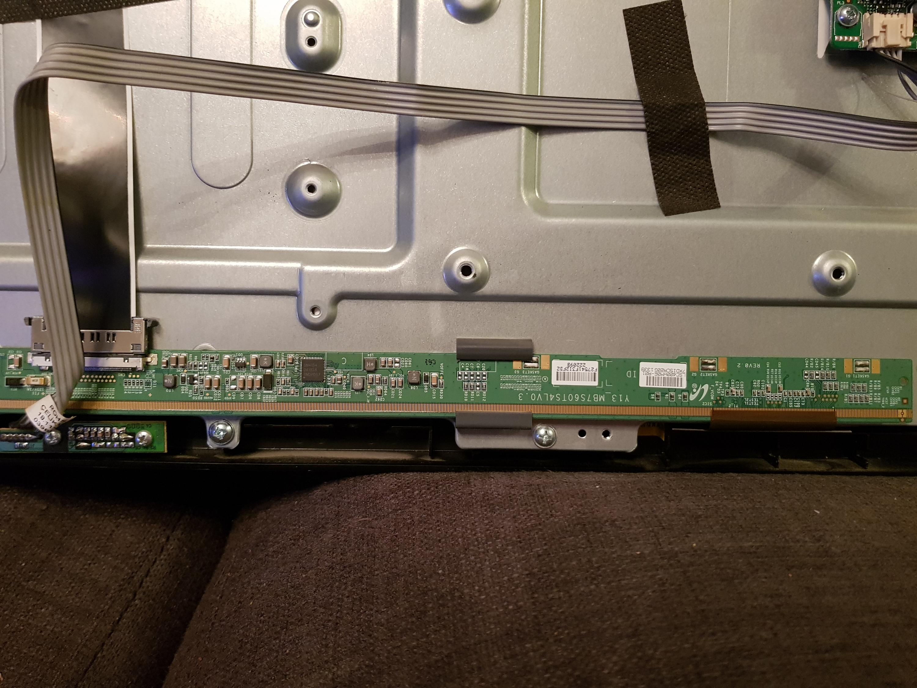

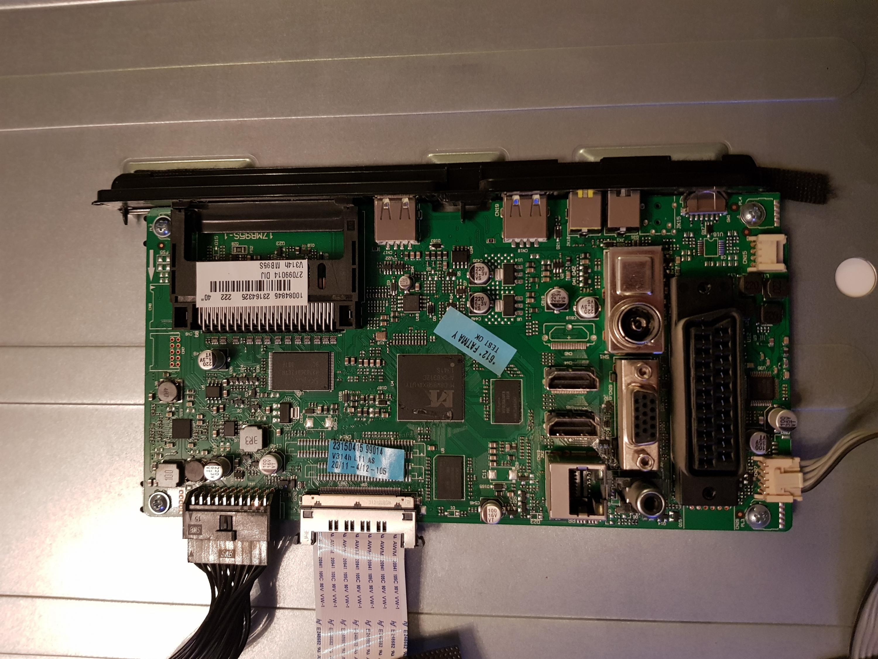

                              Also, when inspecting the tcon/driver board, this capacitor cd7 looks a bit dodgy
