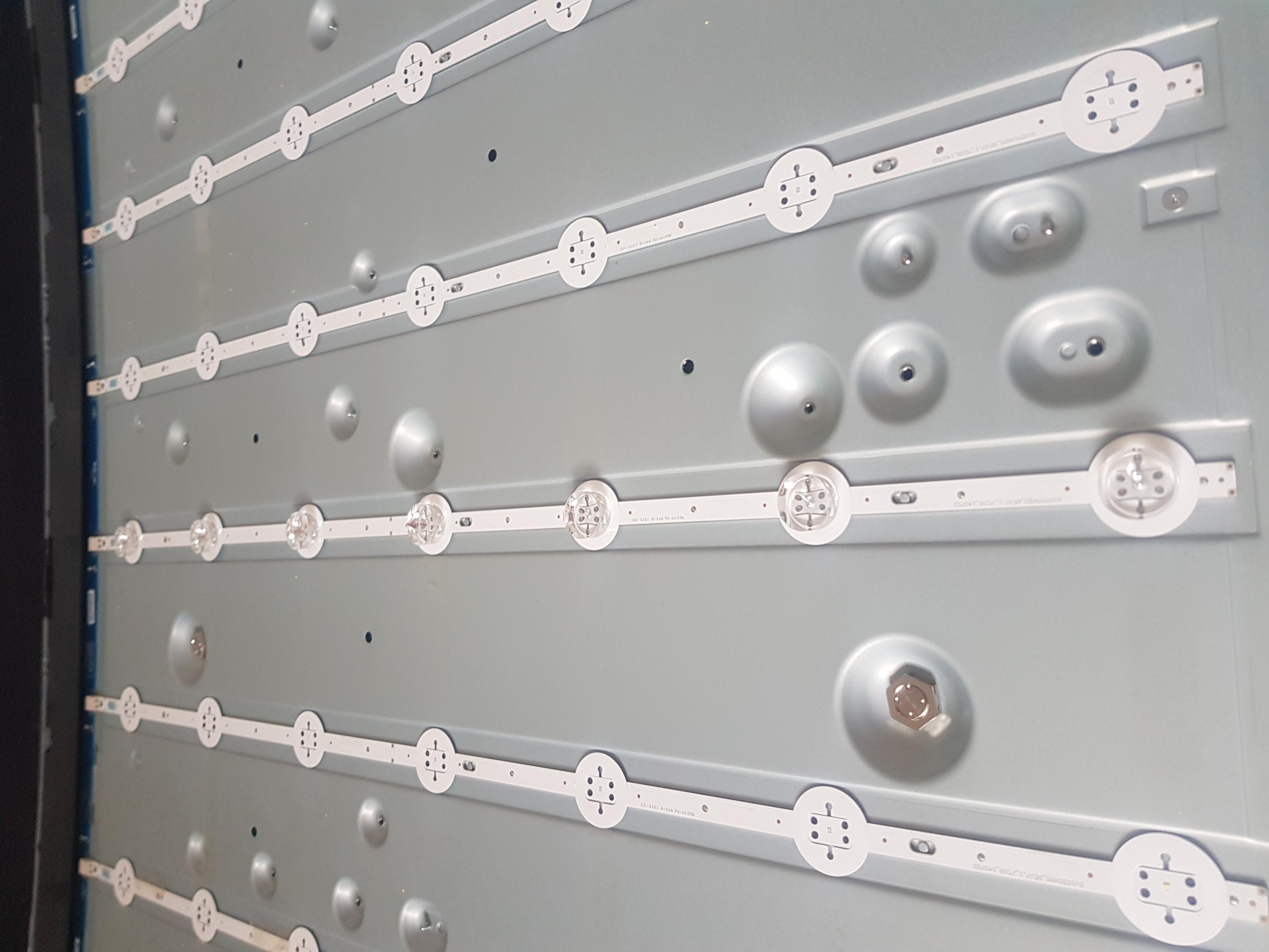

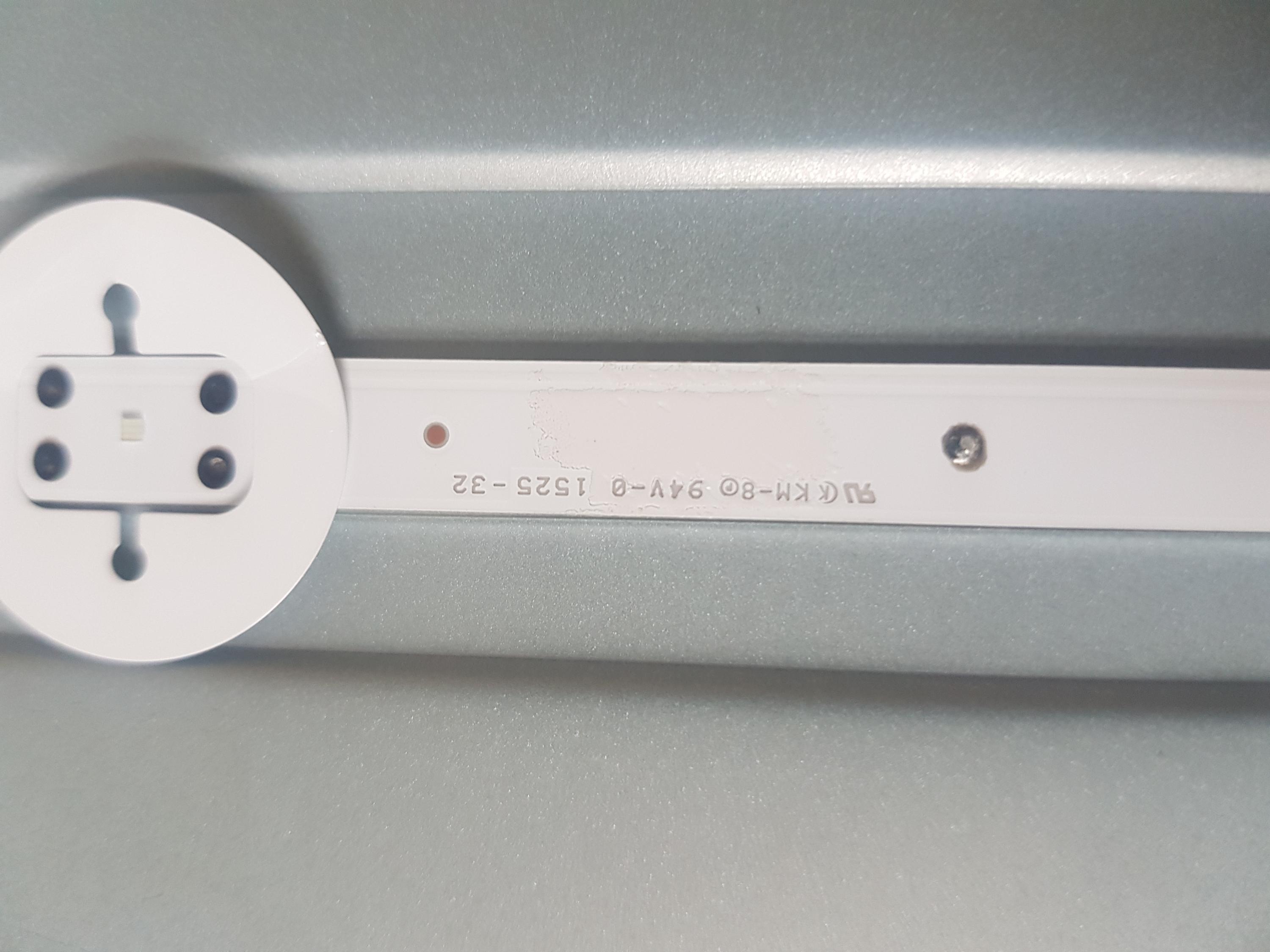

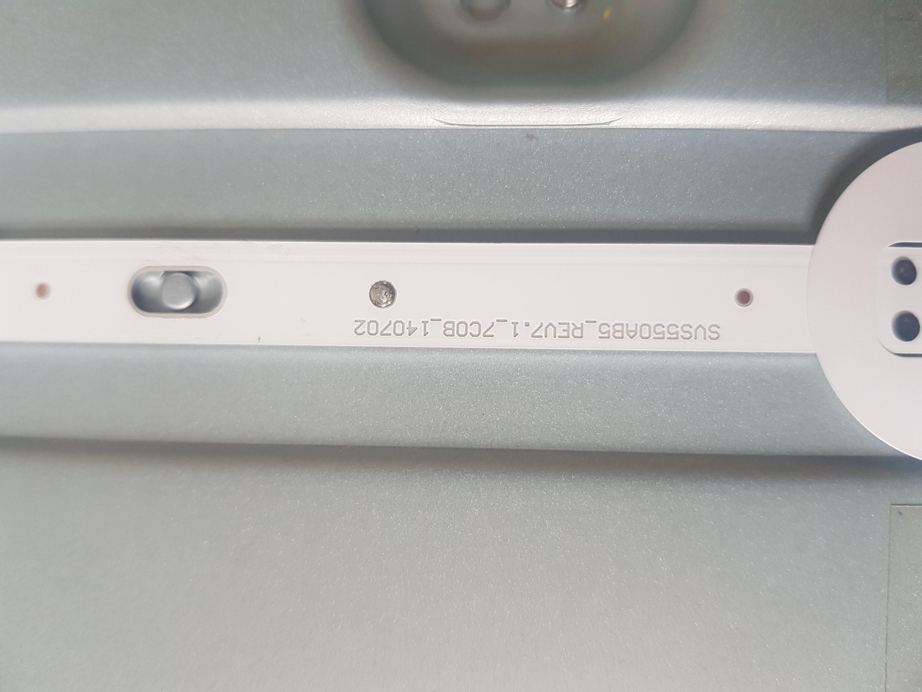

    Have this TV, came with the LEDs gone blue problem, that I have seen many times but only on LG. Stripped the TV down, most of the lens covers had fallen off too.
    Got the part number for the strips
    SVS550AB5 _REV7.1_7COB_140702
    But nothing showing for that number or TV model number on Ali, or anywhere for that matter, anyone any idea where I can source these, or if perhaps they come under any other id?
    Re: Laurus PH55CURVEUHD Backlight Array
    What is the LCD panel model number?
    Did you search using "SVS550AB5 _REV7.1"?
      https://picclick.co.uk/Panasonic-Tx-...138783511.html
      Im not at home atm to get the panel number, but yes they are the ones in you picture, i have tried searching on aliexpress with the number you said, and all the compatible model numbers I found here as pictured
        Post some pictures here. Number of led and number of strips. This is a vestel set right?

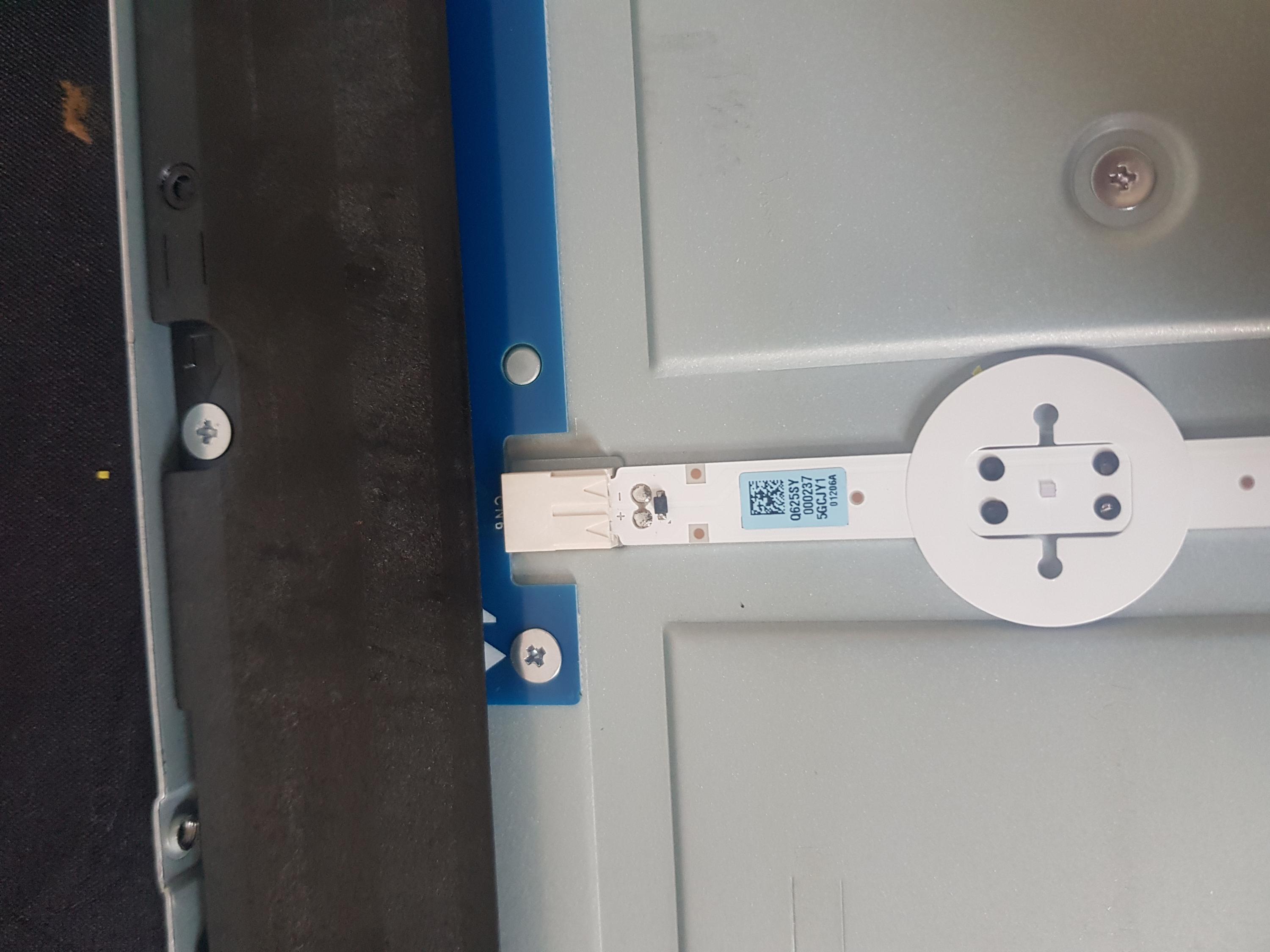

            • United Kingdom
            Yes its a vestel set, I have contacted sellers in china, and turkey, everyone is saying out of stock and to yey again in 2 -3 months
            I spoke to a uk supplier, and he said they were never made as a service part, hense why no1 has them :/
            There are 12 strips in total, 7 LEDs per strip

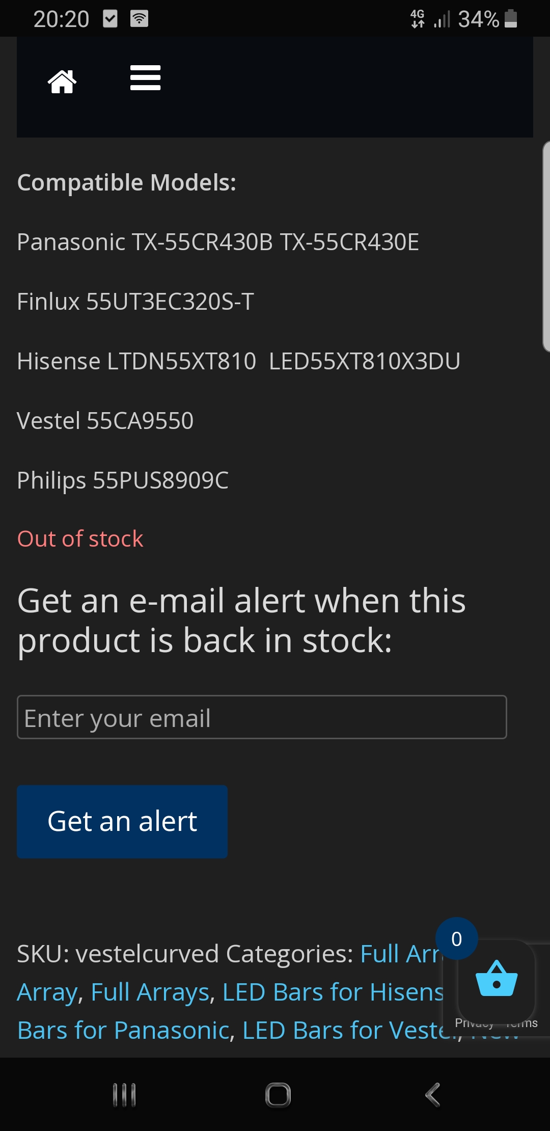

              This might fit your tv. https://tvledbars.com/product/origin...-01201c-12pcs/
              https://tvledbars.com/product/origin...96-01201c-1pc/
              https://www.ebay.com/itm/PANASONIC-T...YAAOSwGWtdfwol
                    They are out of stock, and the last 1 on eBay is just 1 single strip
                    • ducky29
                      • Dec 2015
                      • 369
                      • Europe
                      The link is for single strip on tvledbars but 10 are on stock.
                      • Bloopeta
                        • Jun 2018
                        • 526
                        • United Kingdom
                        I need 12
