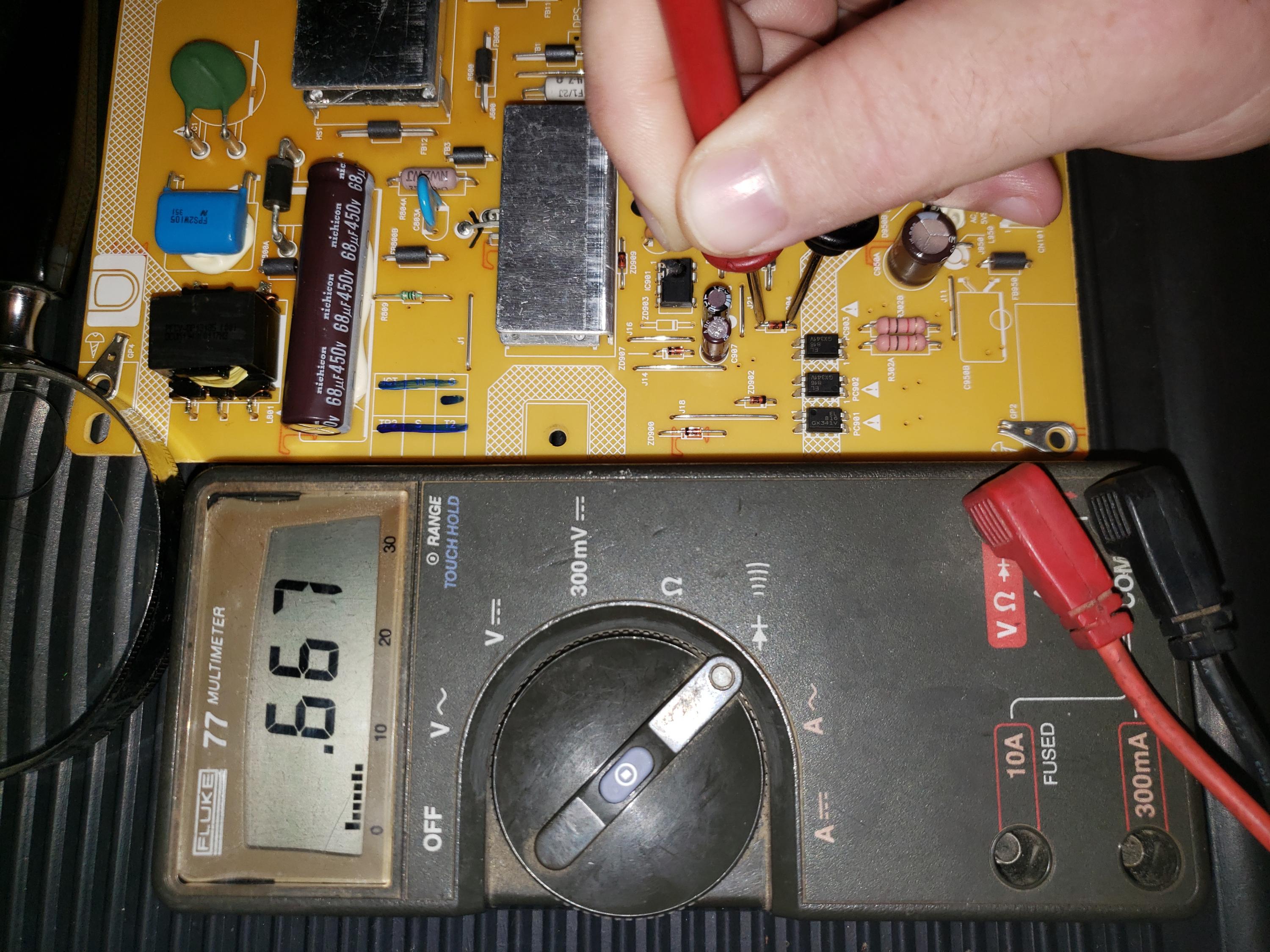

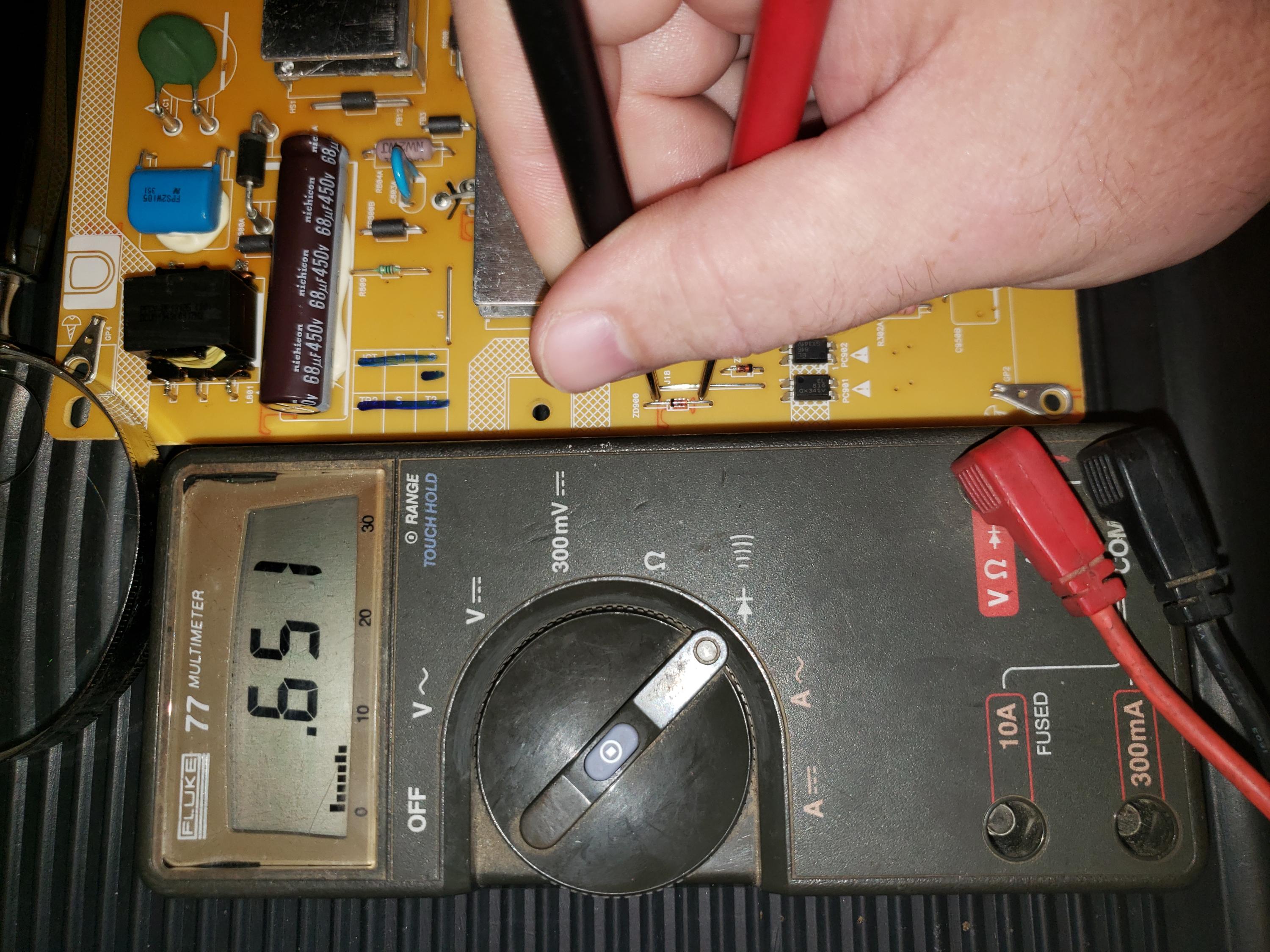

Vizio E480i-B2 Won't Turn On DPS-167DP IC901
    replied
    Re: Vizio E480i-B2 Won't Turn On DPS-167DP IC901
    Originally posted by Digital_Dad
    No I haven't, I thought it may have read that way on the meter due to R907A&B being between it on the underside of the board.
    Both R907A&B test 00.5 Ohms.
    I have been hesitant to desolder anything just yet because if it comes down to it and I have to send the board out to be repaired they have a rule about not sending in boards with previous repairs.
    Well, if you are not willing to remove the parts to verify if the the parts are bad or not, then it is a waste of time to keep to troubleshooting the board. You know you already have blown part for sure already.
    Leave a comment:
  • Digital_Dad
    replied
    Re: Vizio E480i-B2 Won't Turn On DPS-167DP IC901
    Originally posted by R_J
    It is possible that the number after the 056.04146 could be a revision number and a 001 could replace a 000
    EDIT: I just read that note? where did you find that note at?
    Possible, but I don't have that information. I did call and ask but the person I spoke with's knowledge was limited and could only say that if the board had a compatible part it would list the part number on that page. I even asked about the fact that on the page of the wrong board(001) it shows a compatible part number ending in 0001, which is how my board ends? but she said it doesn't work that way. I also used an online photo comparison site where you can overlay two photos and see the differences between them and the two boards are identical front and back. I asked her about this and she said the "L's" were not the same on both boards.
    So are we saying I can't or shouldn't repair this board and should look into either getting a used/refurbished board or having mine repaired?
    Last edited by Digital_Dad; 12-31-2019, 06:26 PM.
    Leave a comment:
  • R_J
    replied
    Re: Vizio E480i-B2 Won't Turn On DPS-167DP IC901
    It is possible that the number after the 056.04146 could be a revision number and a 001 could replace a 000
    From shopjimmy:
    PLEASE NOTE: You will receive either power supply 056.04146.002 or 056.04146.001 or 056.04146.000. These two boards are interchangeable
    Last edited by R_J; 12-31-2019, 06:19 PM.
    Leave a comment:
  • Digital_Dad
    replied
    Re: Vizio E480i-B2 Won't Turn On DPS-167DP IC901
    Originally posted by R_J
    Shopjimmy has the board for $64.95
    I wish they had my board, that one is the board ending in 001(056.04146.001), my board is the one ending in 000(056.04146.000).
    Leave a comment:
  • R_J
    replied
    Re: Vizio E480i-B2 Won't Turn On DPS-167DP IC901
    Check with shopjimmy, it is quite possible one of the other boards they have would work
    Last edited by R_J; 12-31-2019, 06:05 PM.
    Leave a comment:
  • Digital_Dad
    replied
    Re: Vizio E480i-B2 Won't Turn On DPS-167DP IC901
    Originally posted by budm
    Did you re-test this one off the board?
    No I haven't, I thought it may have read that way on the meter due to R907A&B being between it on the underside of the board.
    Both R907A&B test 00.5 Ohms.
    I have been hesitant to desolder anything just yet because if it comes down to it and I have to send the board out to be repaired they have a rule about not sending in boards with previous repairs.
    Leave a comment:
  • R_J
    replied
    Re: Vizio E480i-B2 Won't Turn On DPS-167DP IC901
    ZD909 is across the two current sense resistors, R907A,R907B so one end od ZD909 will need to be removed to check it, It is possible it is shorted, if it checks ok out of circuit it is likely ok.
    Leave a comment:
    replied
    Re: Vizio E480i-B2 Won't Turn On DPS-167DP IC901
    "ZD909=.000 & beeps(I know you said it didn't matter but I just wanted to throw it out there for reference)" Did you re-test this one off the board?
    Leave a comment:
  • Digital_Dad
    replied
    Re: Vizio E480i-B2 Won't Turn On DPS-167DP IC901
    Originally posted by R_J
    IC901 is the standby ic, it does not drive any mosfets, It could be that it just failed and replacing it will restore the standby voltage, D950b is a schottky diode and will have a lower voltage drop in diode test. .5xx ~.3xx is normal in diode test. BEEPS don't mean anything when checking components.
    There are a few zener diodes (ZD90x) around ic901, check that they are not shorted
    Thank you R_J
    So replace the IC901, the schottky diode should be ok.
    All these were tested with the board removed and the neg lead on the black banded side of the diode with the meter set to diode mode.
    ZD900=.651
    ZD902=.584
    ZD904=.667
    ZD907=.637
    ZD909=.000 & beeps(I know you said it didn't matter but I just wanted to throw it out there for reference)
    Is it possible that only the IC901 is bad?
    Also while browsing You Tube videos I found Vizio power supply boards like these have a bad solder joint(CN202) issue where the two boards attach to one another.
    So I looked at mine and sure enough when I move the black plug back an forth I can see a couple of the soldered pins on the bottom of the board underneath move.
    Could that have caused IC901 to "blow"?
    Not like it really matters, I just need to know what to fix to get my TV up and running again.
    Leave a comment:
  • R_J
    replied
    Re: Vizio E480i-B2 Won't Turn On DPS-167DP IC901
    IC901 is the standby ic, it does not drive any mosfets, It could be that it just failed and replacing it will restore the standby voltage, D950b is a schottky diode and will have a lower voltage drop in diode test. .5xx ~.3xx is normal in diode test. BEEPS don't mean anything when checking components.
    There are a few zener diodes (ZD90x) around ic901, check that they are not shorted
    Last edited by R_J; 12-31-2019, 12:37 PM.
    Leave a comment:
  • jetadm123
    replied
    Re: Vizio E480i-B2 Won't Turn On DPS-167DP IC901
    suggest you check the mosfet transistor connected to ic901 for shorts. it might be under the heatsink above ic901.
    Leave a comment:
  • Digital_Dad
    replied
    Re: Vizio E480i-B2 Won't Turn On DPS-167DP IC901
    Diodes don't beep, lift a leg and see if it still beeps and .5 ohms is way too low, it's no good.
    TY, so I need to replace the diode at D950b too, I believe it is a "Schottky Diode 100V 3A"
    What else should I be looking for that would have either caused the IC901 chip to explode or caused damage to when it did?
    Leave a comment:
  • nomoresonys
    replied
    Re: Vizio E480i-B2 Won't Turn On DPS-167DP IC901
    Diodes don't beep, lift a leg and see if it still beeps and .5 ohms is way too low, it's no good.
    Last edited by nomoresonys; 12-30-2019, 11:24 PM.
    Leave a comment:
  • Digital_Dad
    started a topic Vizio E480i-B2 Won't Turn On DPS-167DP IC901
    Vizio E480i-B2 Won't Turn On DPS-167DP IC901
    Working on a Vizio E480i-B2 that won't turn on, no lights, nothing. I took the back cover off and found a broken component on the power supply board.
    (I did create a new thread, to help others with this exact TV & issue)
    The board is a Delta DPS-167DP 056.04146.000 and IC901 on the board has a large chunk of it missing. I believe IC901 = part #LD7913JGM6. I read the other two threads on here that had information about this issue to try and begin looking for other possible bad components.
    It seems I have three options:
    1. Buy a replacement board for $45+/-. I have not found any 056.04146.000 boards for sale, but I have found 056.04146.001's for sale. The two look identical, is there any reason I couldn't use the 001?
    2. Send the board in to be repaired $52+/-.
    3. Repair the board myself $12+/- plus whatever other parts someone could help me locate.
    So far I have tested R915 and it read 4.7 Ohms, R907A & B read 00.5 Ohms. D950b read 00.5 Ohms & .000 and beeped on Diode test setting when tested in either direction.
    I would like to know where else to look and what else to test.
  • TJM2005
    DSP-167DP LOW VCC at IC901
    by TJM2005
    I am trying to repair a power supply for a Vizio M492i-B2.
    Before I started:
    Fusible Resistor R915 was open.
    ZD909 was shorted.
    D950B was shorted.
    I have replaced the above parts along with a new IC901 / LD7913J
    I now have:
    165V on the main cap
    IC901 Drain pins: 165V
    IC901 VCC: 1.1V
    IC901 COMP: 1.1V
    IC901 BNO: 0.3V
    I pulled the Q800 Mosfet and it checked good.
    I also tested the two smaller caps C907 and C904B, they both tested close to the rated value.
    Does anyone know of anything...
    10-12-2025, 12:04 PM
  • SS454
    vizio e650i-a2 backlight flashes then turns off
    by SS454
    vizio e650i-a2 (LWJAOZBP Serial) led backlight flashes then turns off, has video (via flashlight) and audio.
    panel: au optronics T650HVN05.4
    72 led total on 12 strips, 6 led per strip wired in three groups of 24 (led driver board has three anode and three cathode pins)
    link to datasheet: https://datasheetspdf.com/pdf-file/8.../T650HVN05.4/1
    Vizio 56.04219.641G (liteon PA-3231-01WN-LF) Power Supply Unit
    https://www.shopjimmy.com/vizio-56-0...-power-supply/
    Vizio 55.75J01.001G (91.75J10.004G) Main Board...
    08-20-2020, 03:57 PM
  • narf
    Epson EB-U42 projector / Caps with 0.7 ohms ?!
    by narf
    hi all,
    first of all: i'm a (motivated) newbie, so please forgive me any stupid question i may or may not ask
    i'm currently repairing a projector: Epson EB-U42 that doesn't start (no lights, nothing).
    what i've found so far:
    - the PSU does its job and supplies 12V to the mainboard via the connector.
    - shortly thereafter, there is a mosfet (TS420-600B) where i can test 12V on the one side (in the data sheet this side is called Anode), Gate 0V, Kathode shorted to ground
    - not far away, there's the first cap with a resistance of 0.7 ohms....
    07-02-2024, 03:53 PM
  • howardc64
    Vizio M65Q7-H1 Red Vertical Strips fixed by tape blocking LC1 signal to half of the panel
    by howardc64
    Failure Symptom
    No picture, just red vertical stripes. Google search shows quite common problem for these recent Vizio M series although red vertical stripe pattern may differ. Some call it "Netflix" boot screen haha.
    Where is the short?
    Panel has 4x buffer boards. Quickly found the 1/4 panel buffer board with the problem by selectively disconnecting buffer board flex cables.
    Having recently fixed another Vizio with similar symptoms that was a shorted ESD diode array ( link ) Probed the ESD diode array but...
    05-27-2025, 02:56 PM
