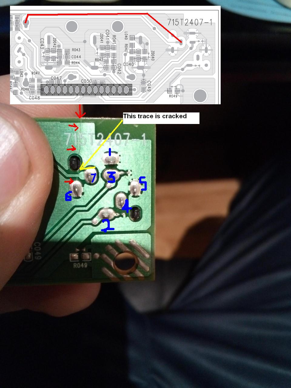

phillips 42PFL5432d/37 TV no sound

    Look at the picture in post 19, I labeled the pins, If you look closely at the pc board, you will see what looks like a crack, it goes from the edge of the board, through the hole for the jack alignment pin, and ends at pin 6. the trace from pin 7 is likely cracked and the crack will need to be repaired.

      Re: phillips 42PFL5432d/37 TV no sound
      damnn..
      I will try to soother a bridge between 6 and 7 right there on the board.
      and see if it works.. if crack interferes I would get a new board.
      damn you got eyes holy shit
        Did some one work on this board before? There must have been impacted some how to crack the board like that.
        • R_J
          • Jun 2012
          • 9623
          If the crack is where I pointed it out, simply shorting pins 6 & 7 AT the jack will not fix it, you need to run a wire like I suggested
          Soldering across 6 & 7 will not have an effect because the crack is between the headphone jack pin7 and the 14 pin plug.
          • dsm482
            • Dec 2019
            • 39
            ITs fixed..
            Thank for your information.. crack was not bad, but I still put wire across it .. it worked both ways. Got sound and works great. I never used headphone jack since new.
