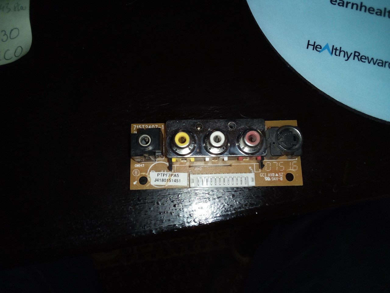

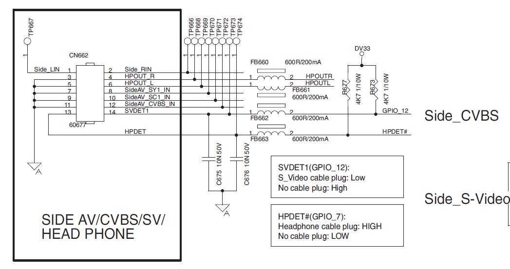

                Ther should be a connector CN662) on the side av/cvbs/sv/head phone board, check the voltage on pin 13 with the headphones pluged in and when they are removed. I believe it should change from 3.3v to 0
                Do you have both the +24 volts coming from the power supply?
                What is the chassis number of the tv? is it TPM2.0U

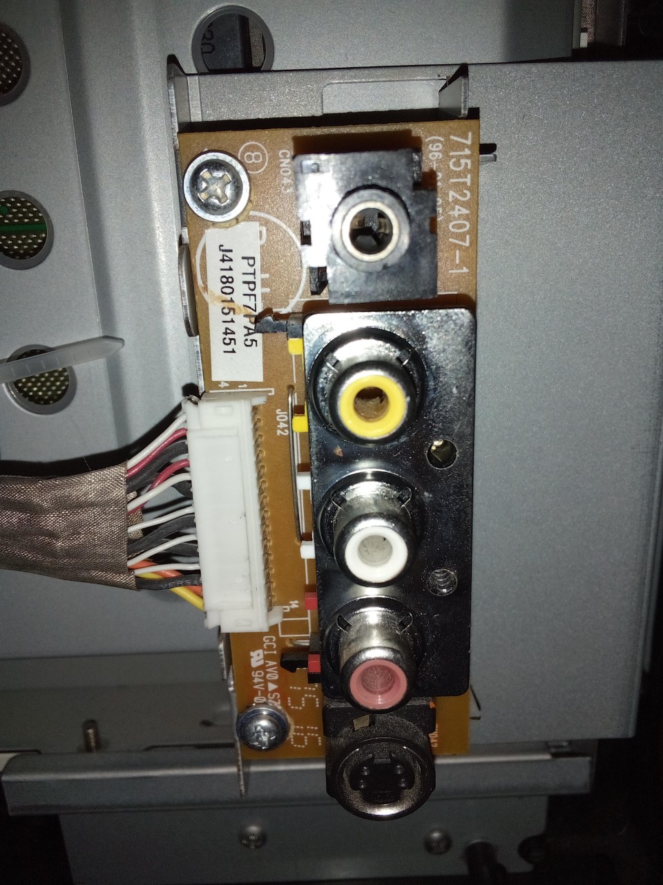

                  the 13th pin on the connector going to the av board where its the hadphone jack is orange wire in color.
                  you can technically count both sides being 13th depending which way you count.
                  I checked both the bottom orange color is 13th pin has 3.27V all the time.
                  Headphones jacked in or taken out.
                  if thats the one you are tallking about that will confirm the hadphone jack has continous connection, and that will explain the missing sound.
                  its bad headphone jack ..
                  that will all make sense.
                  Can I bypass it anyway?
                  to test it. before I buy a small board.

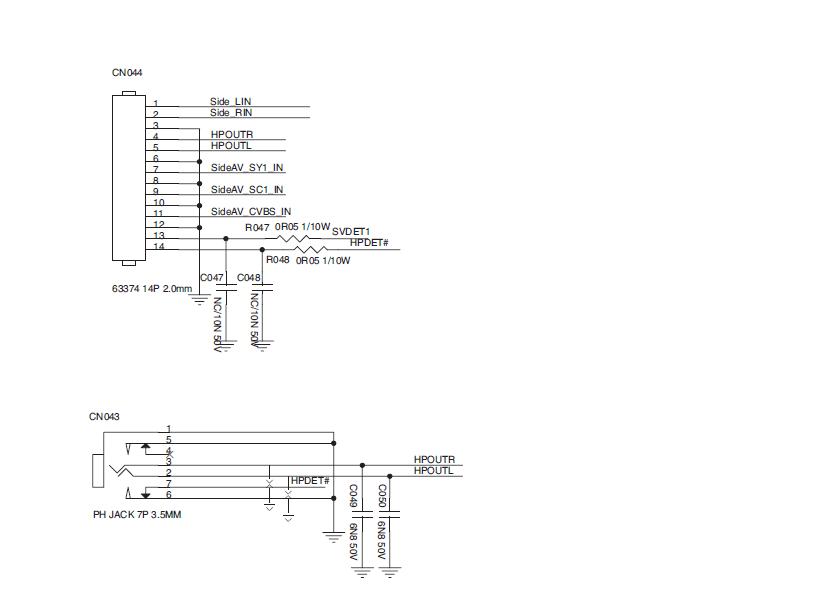

                    Re: phillips 42PFL5432d/37 TV no sound
                    After a closer look it could be pin#14 on the CN044 plug on the av board that is the HPDET line.
                    Pin 13 is on the other end that connects to the main board and looks like it is the Yellow wire
                    This should be the board, You should be able to ground the HPDET line to see if you get audio
                              Did you try plug/unplug the headphone plug like 10 times, that may clean the switch contact for headphone detect switch?
                              You can also solder bridge the normally closed switch pin 6 and 7 of the headphone jack.

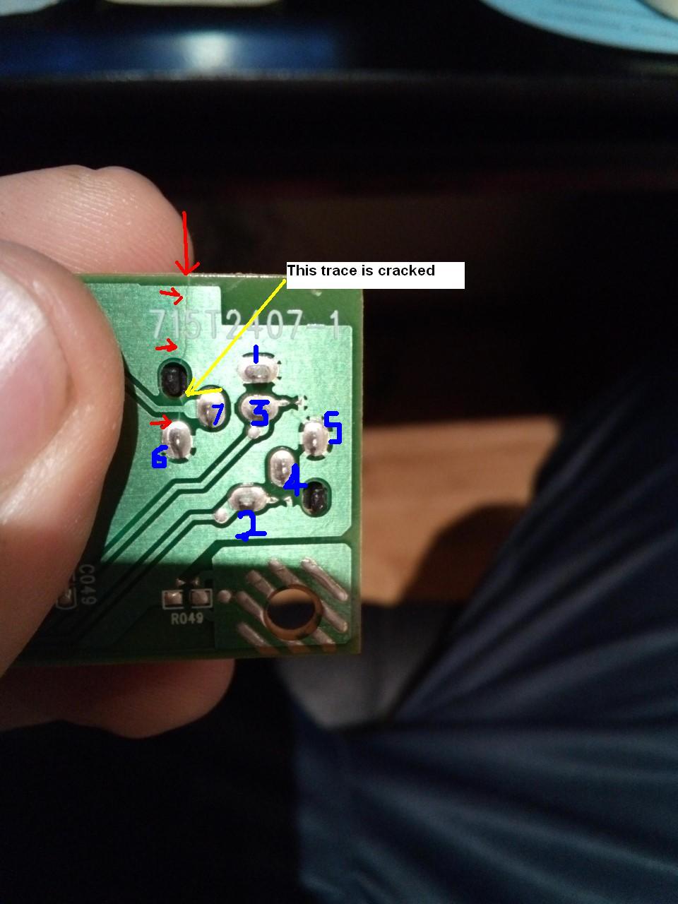

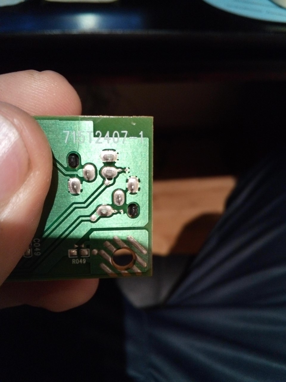

                                  After looking closer at the av board, you have a CRACKED TRACE
                                  Bridge pins 6 & 7 on the jack, If that gives you audio, either leave it bridged or replace the jack.
                                  I'm not 100% but it does look like a PJ31010-B
                                  • dsm482
                                    • Dec 2019
                                    • 39
                                    how do i know which is 6 or 7 on the jack?
                                    I got it apart i don't see numbers..
                                    where do i get a jack so i can sother this to the board.
                                    they sell these..? it will be functional and profesional .. they are loose..
                                    I got good station at work for electronics..
                                    Who sells these?
                                    • R_J
                                      • Jun 2012
                                      • 9588
                                      The trace is cracked, The jack is likely ok. Solder a wire between the jack pin7 and then follow the trace and solder the other end of the wire to that point
