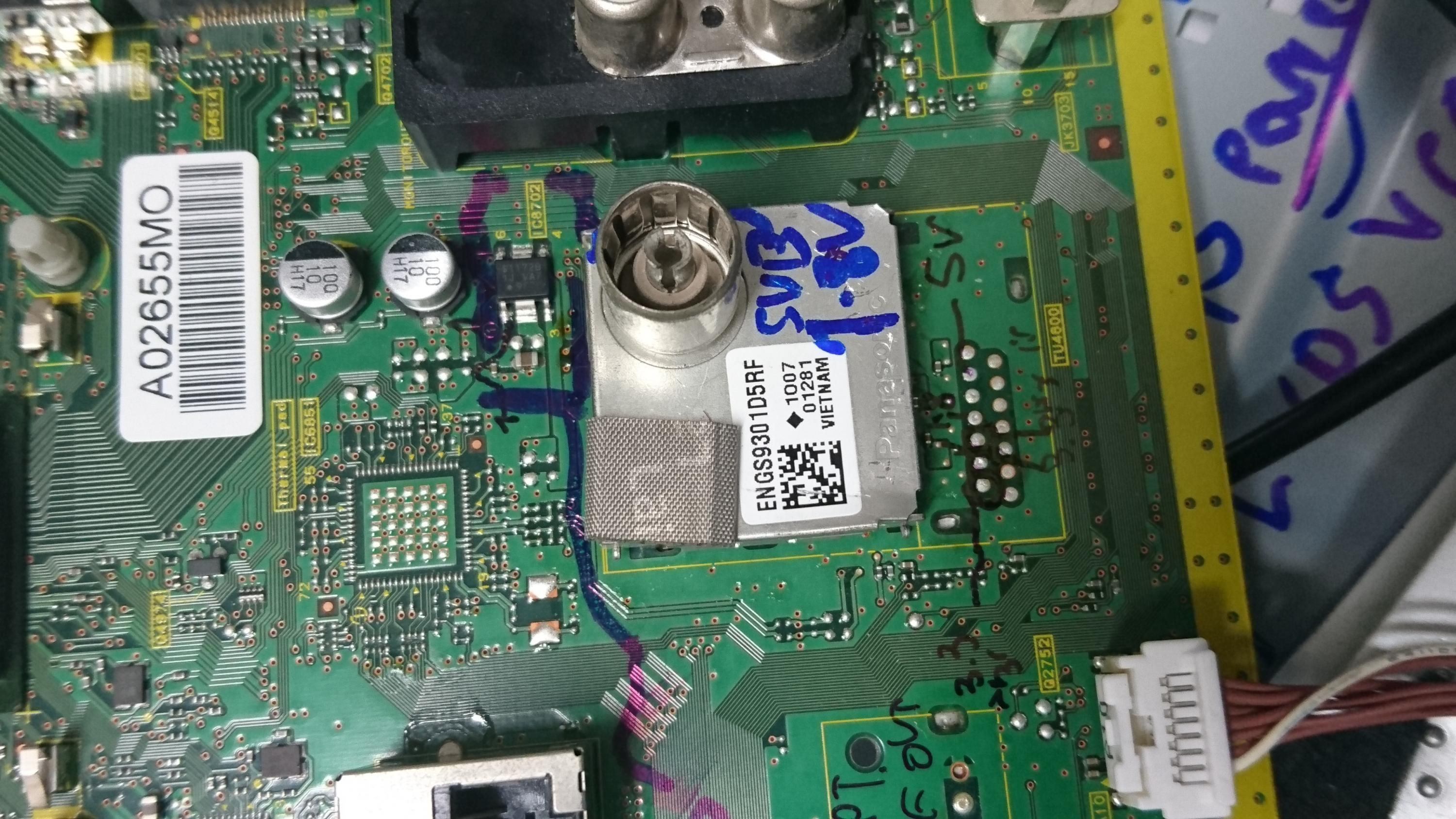

Panasonic led tv, 3 red blinks error, TH-L32X30M
Re: Panasonic led tv, 3 red blinks error, TH-L32X30M

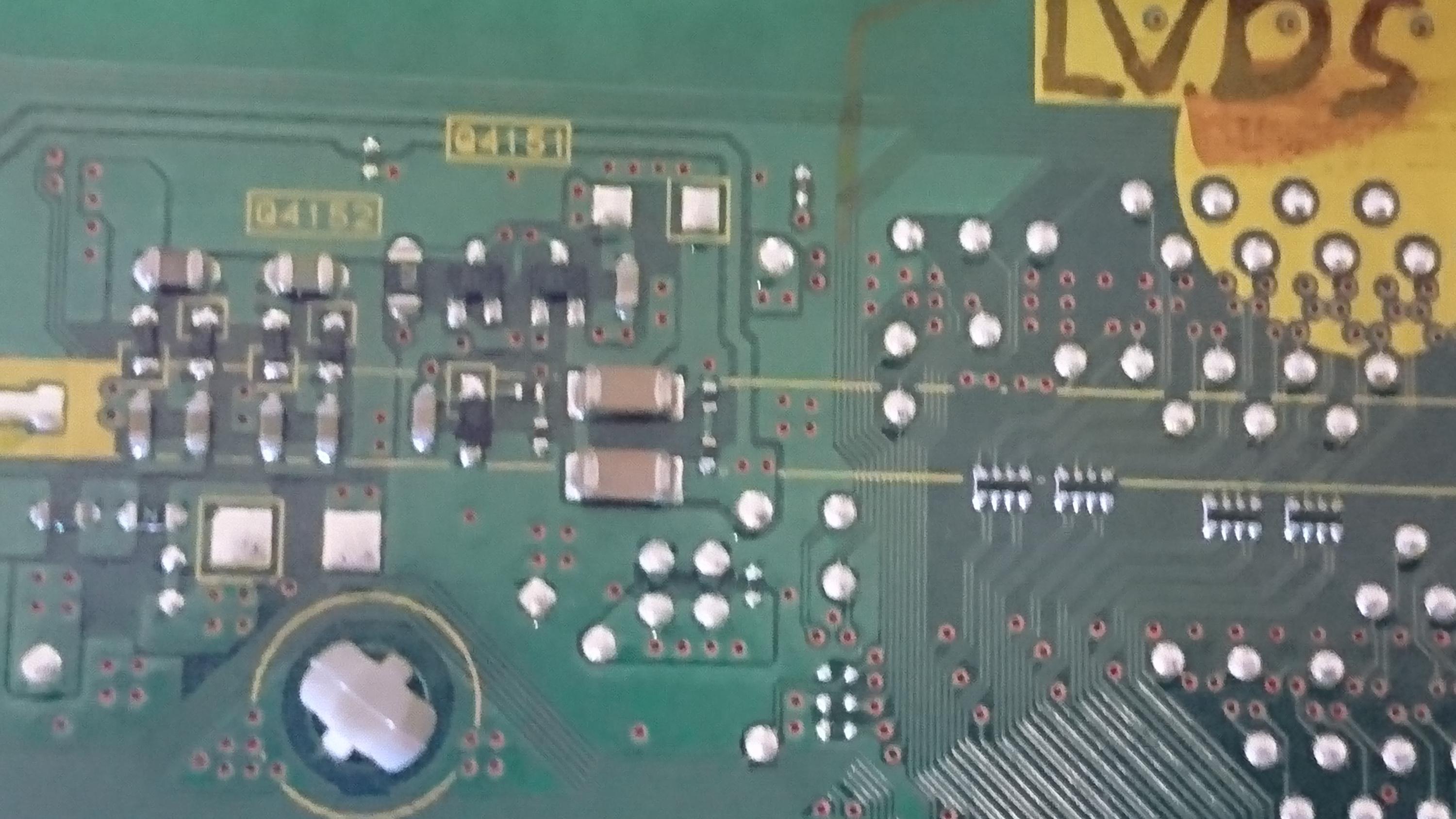

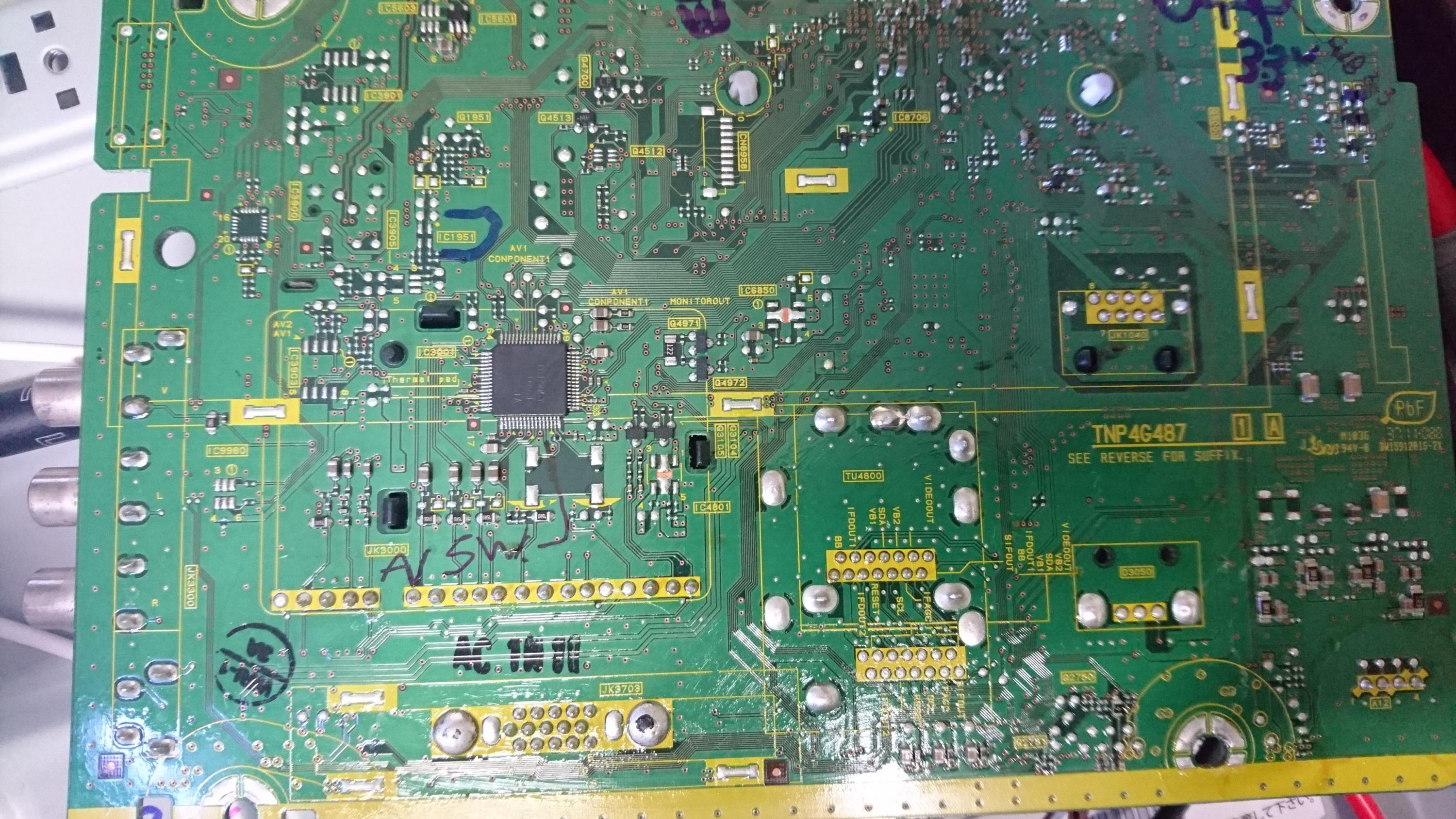

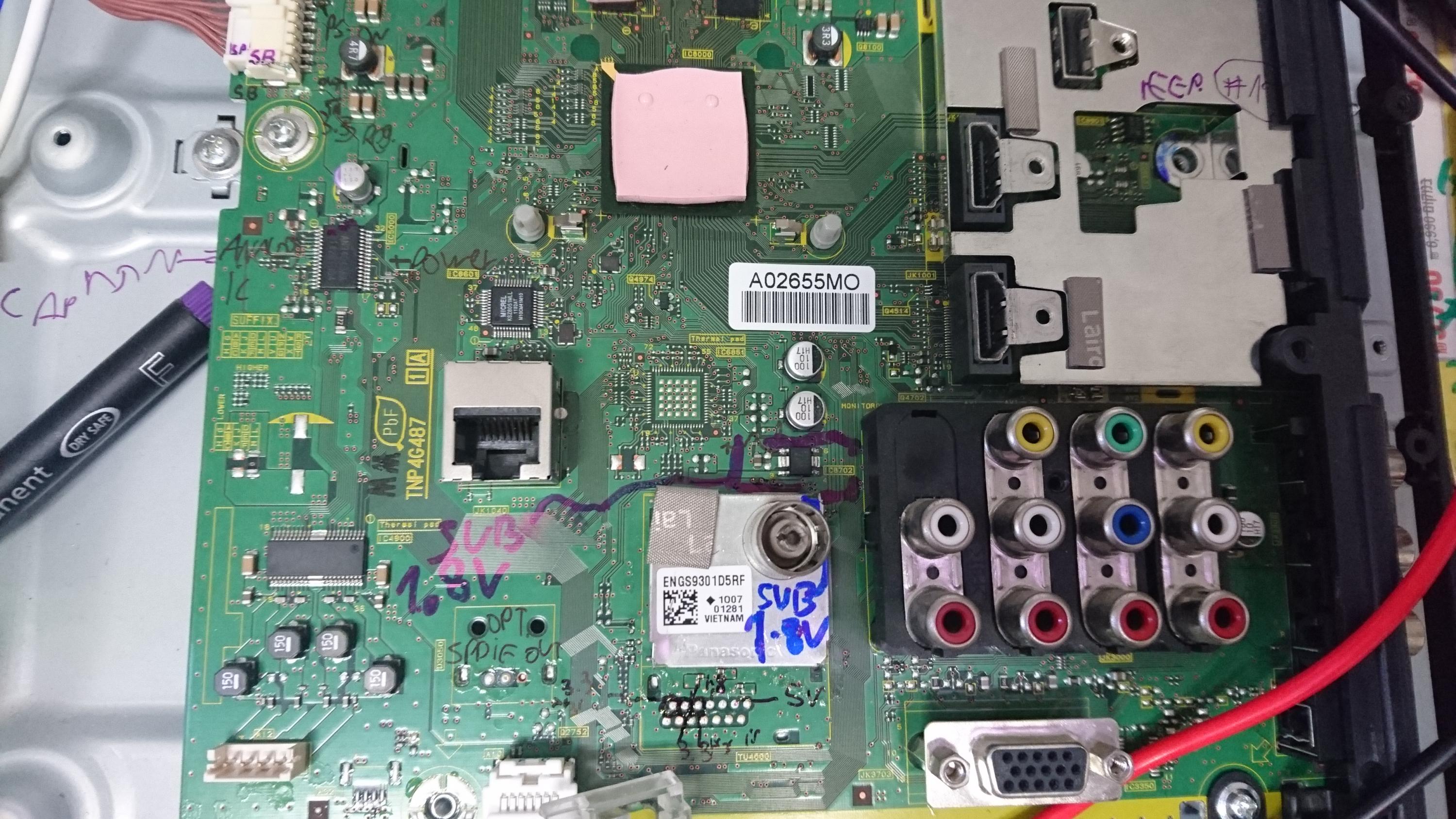

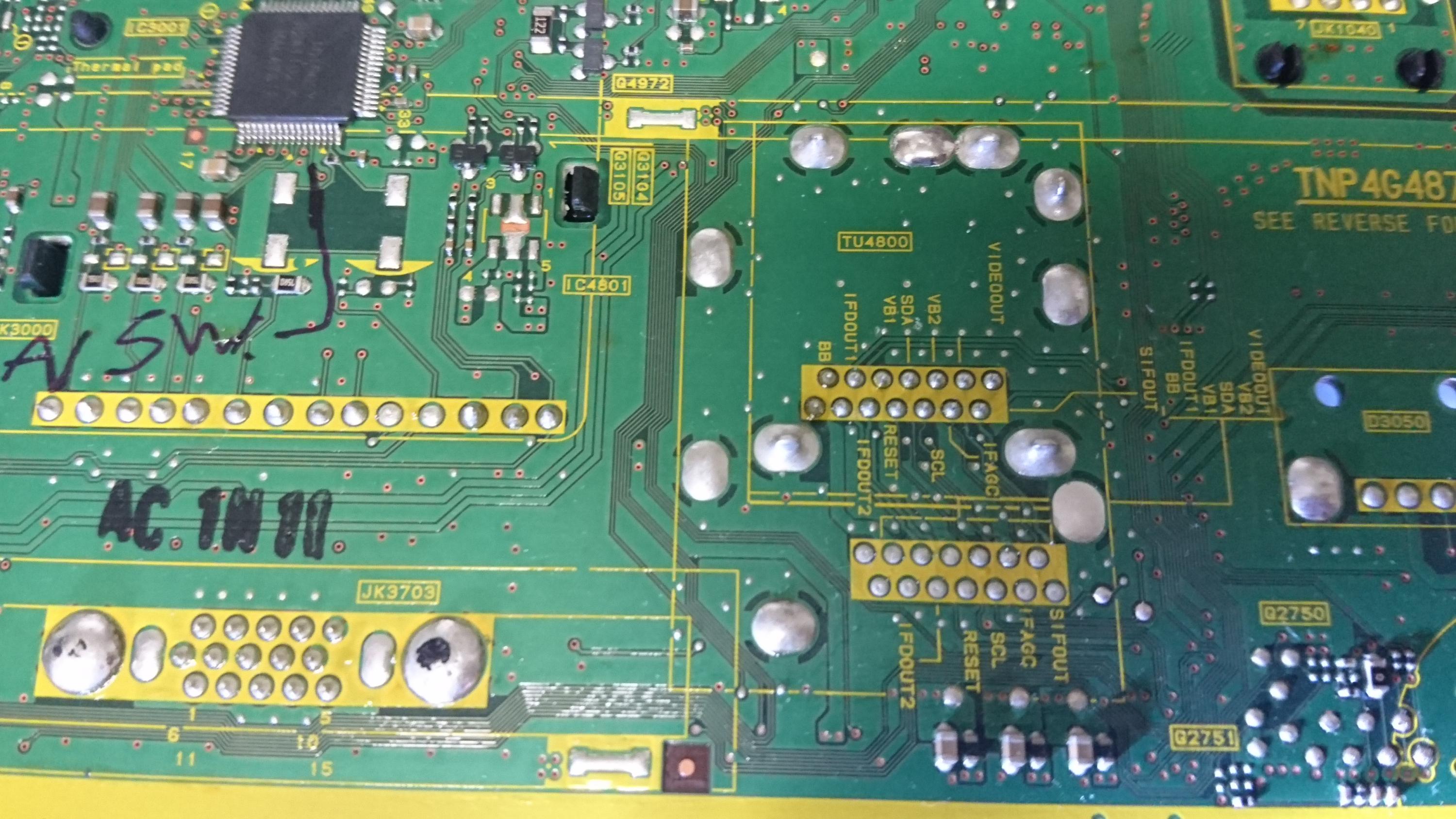

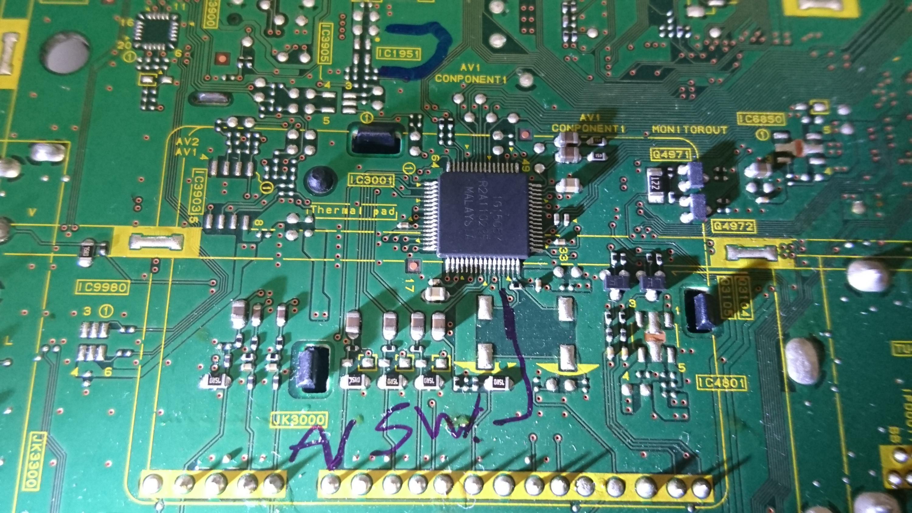

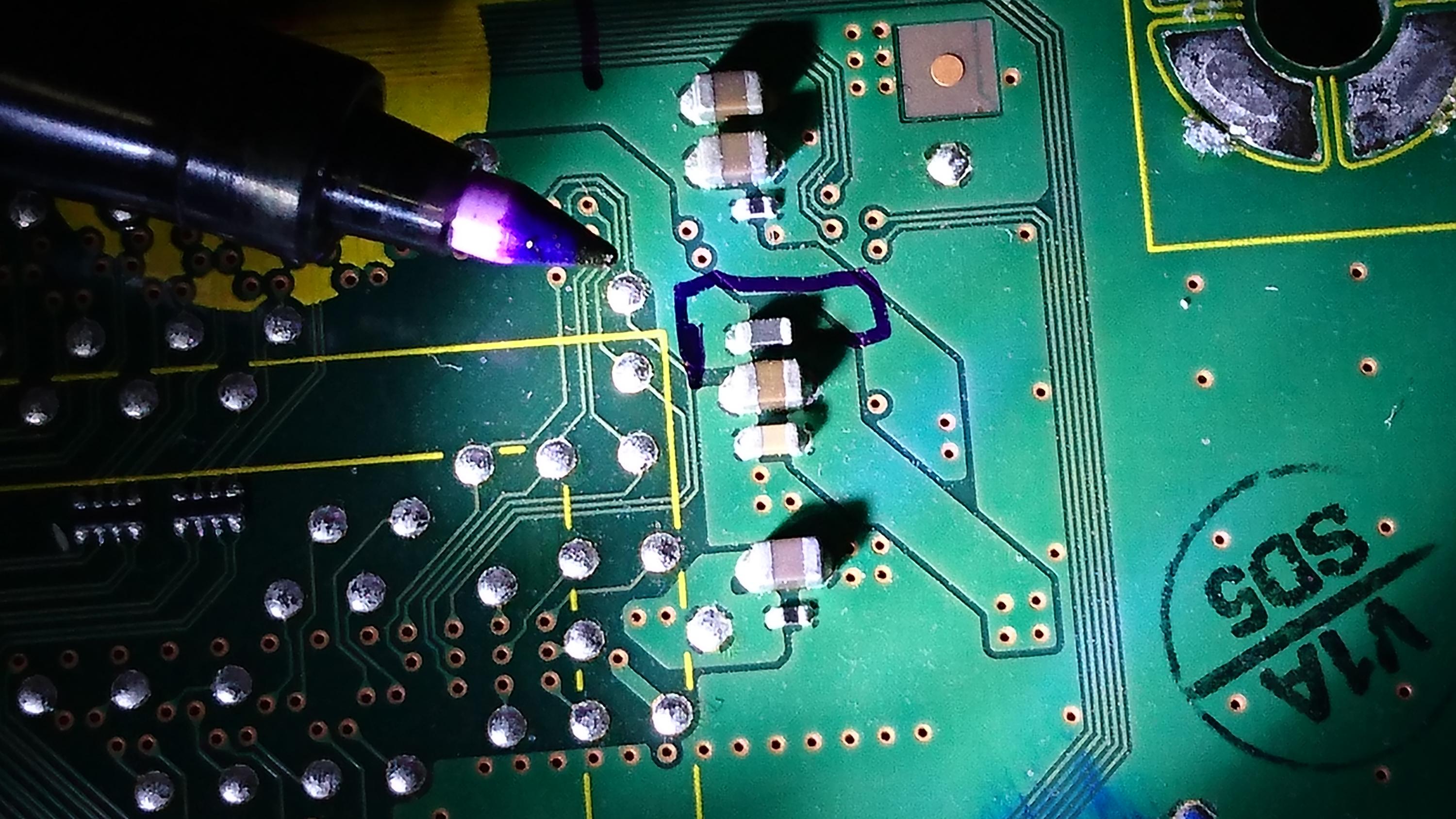

Is the Av switch could be the issue? ( looks like many ic's shares power within the same step downs

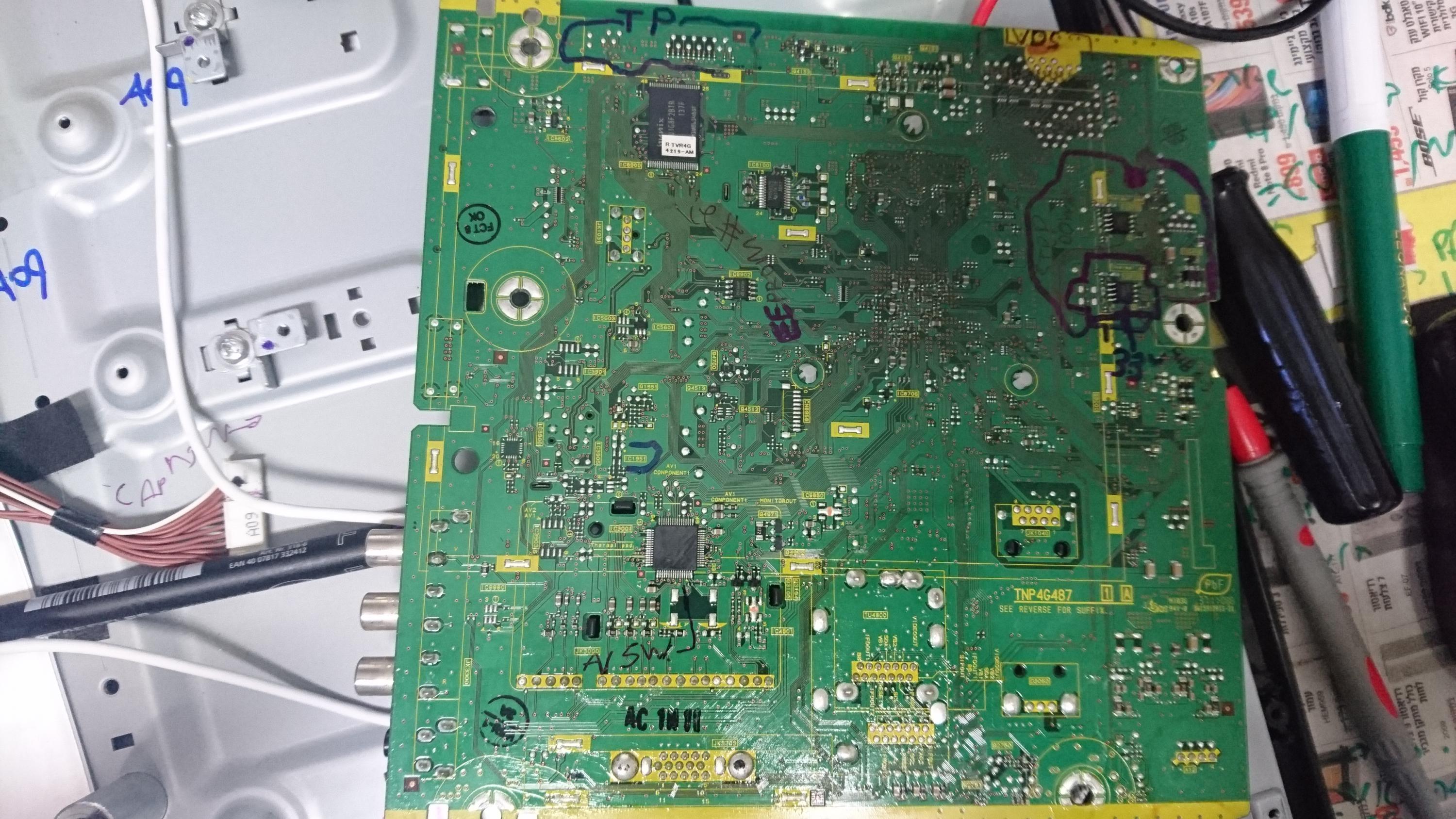

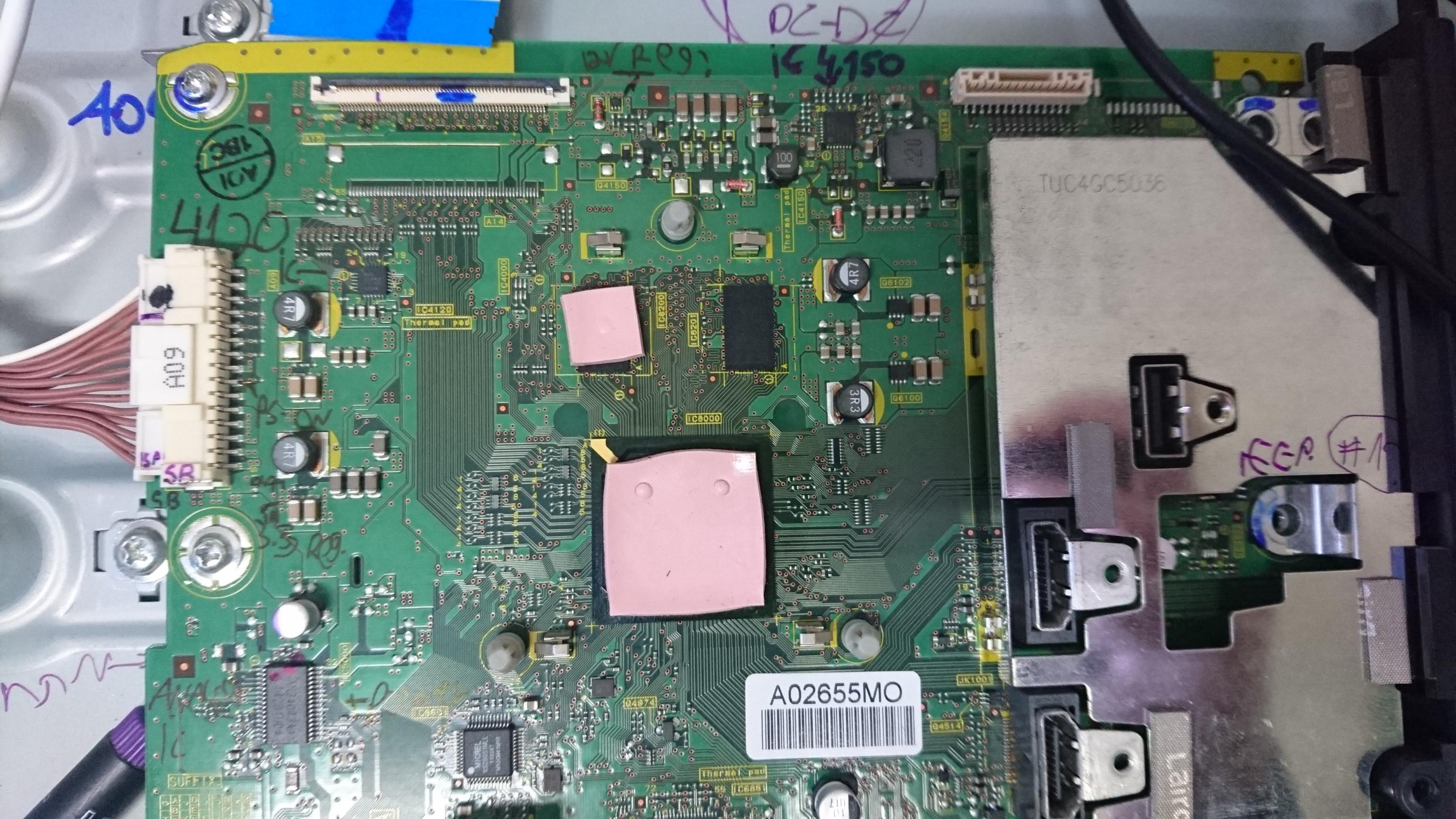

Here are pictures of ( all?) the step downs that I've found & around the tuner...Attached Filesif you find these attachements useful please consider making a small donation to the site

That looks to be inductor, it should show <1 Ohm resistance reading.
Boy! they only put the desigantors for the IC's and transistors but not for other passive components.Last edited by budm; 12-29-2019, 07:47 PM.Never stop learning

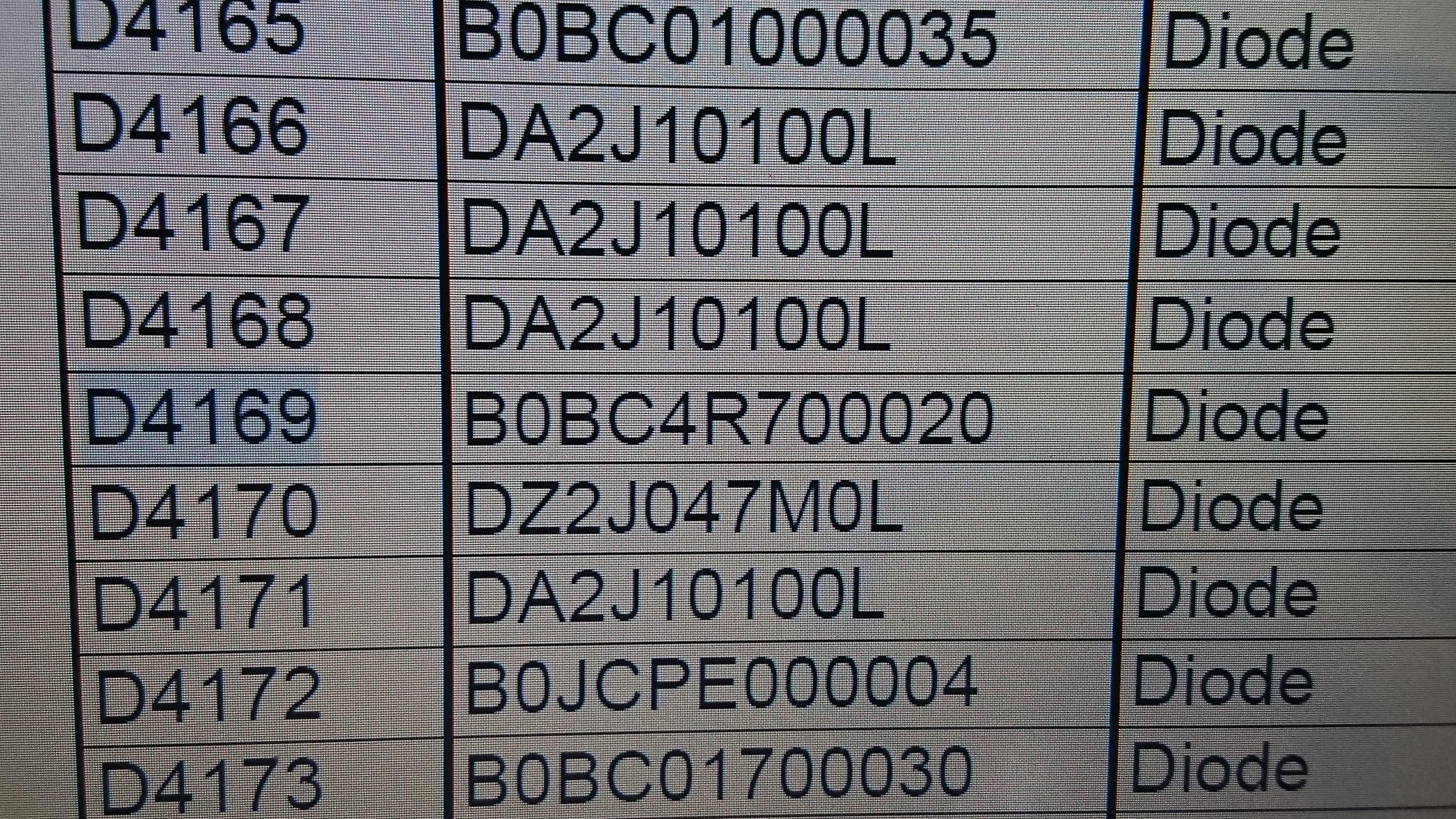

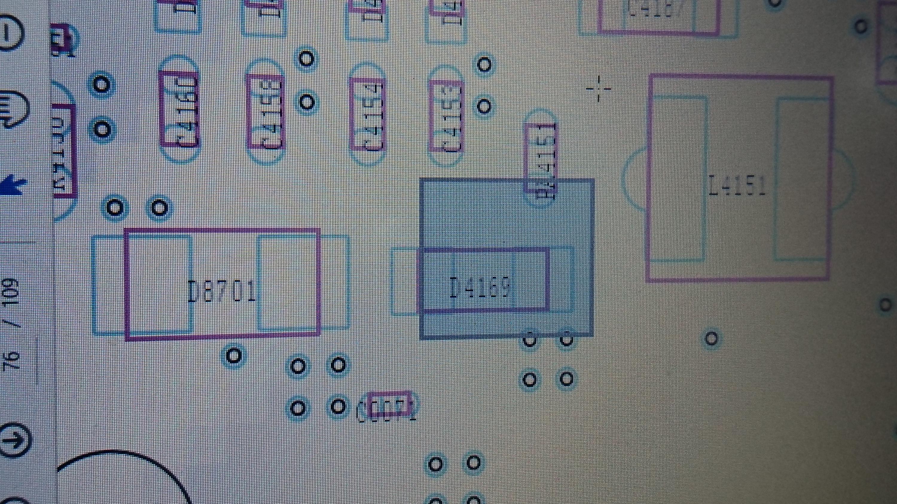

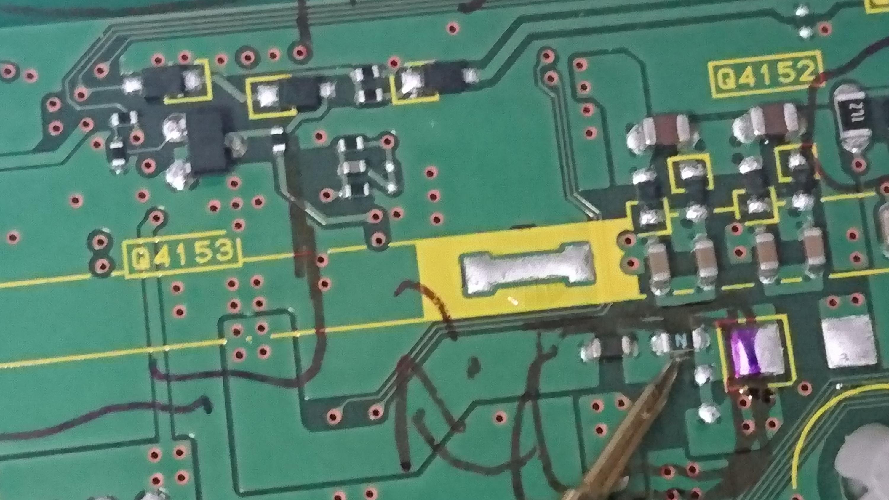

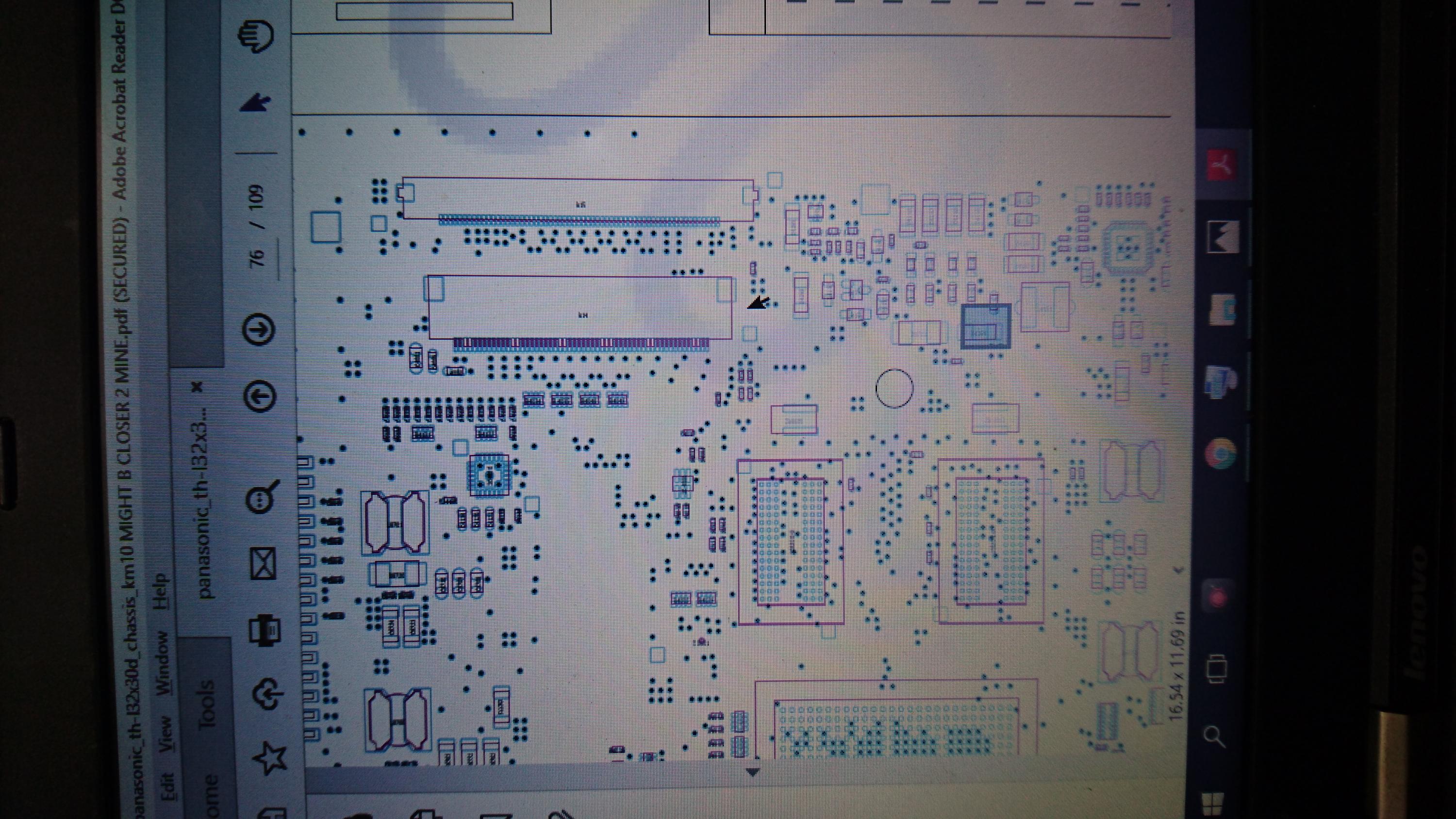

BUT TODAY It looks like I've tested IN CIRCUIT few diodes, using diode mode, and found a bad diode ( or a bad components that connects to it)
Thats D4169,( it shows on p76&91) but ive attached pictures of the page
Anyway, on Diode mode test I've got ;
0.904v and when ive reverse the probes ive got 0.452 v
AND when ive tried to read real time voltage by turn the tv on, ive got 2.429Vdc ( for a half of a second, I've used the Max function again)Attached Filesif you find these attachements useful please consider making a small donation to the site

When in doubt lift a leg and retest out of circuit.Comment
hi
ive tried that and the diode looks ok [reads 0.453V]- when im test the pad on the board- im gettinfg the 0.904v
is that ok?is there a way to identify the fuse of the tcon?Comment

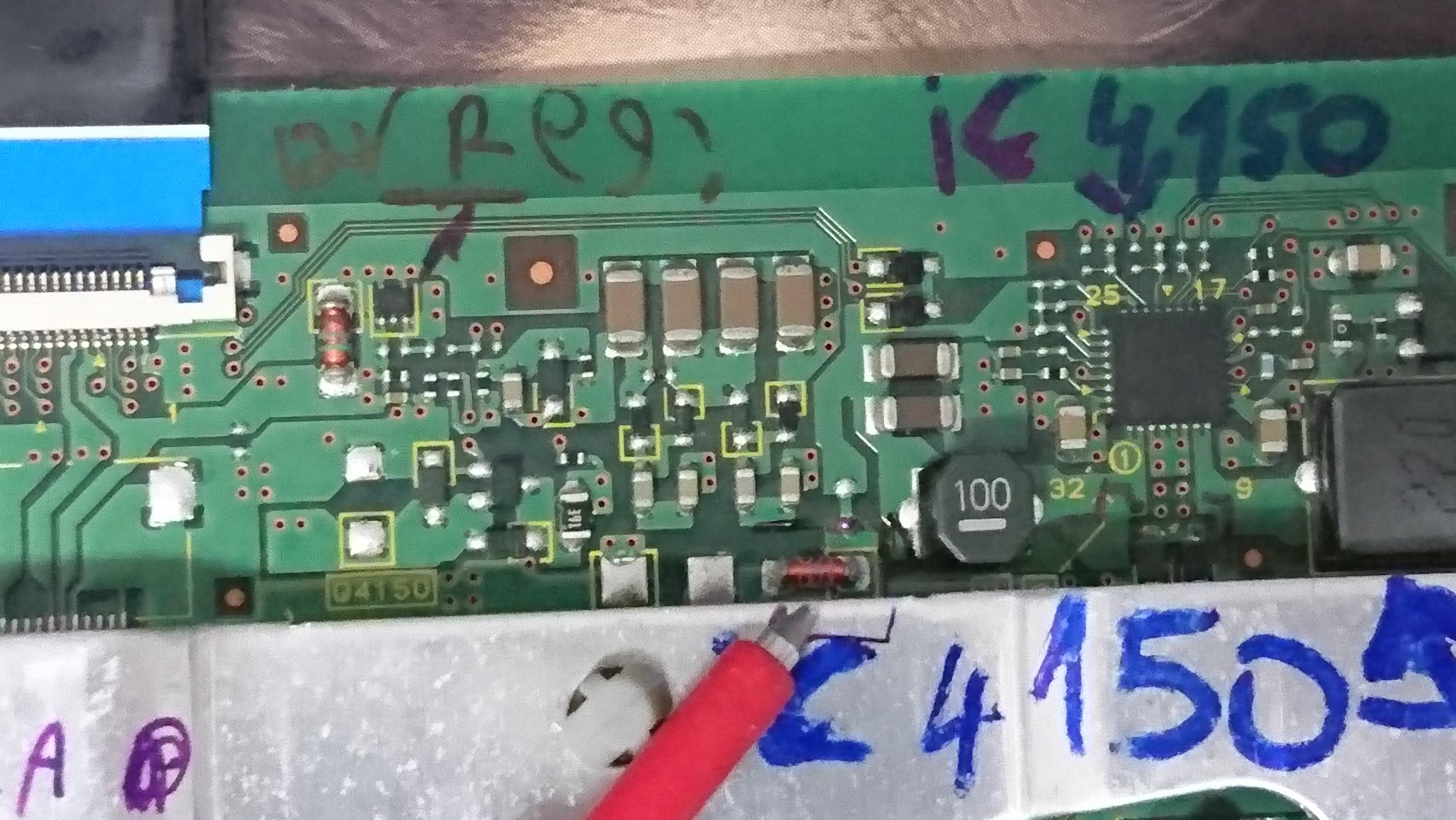

Is that could be the Tcon chip fuse? I'm getting steady 16.15v TILL PROTECTION.. On both sides even on the end of the MB trace till the chip...
If it is, then i think that ive already tested everything we've ever thought of ..
could it be an EEPROM issue althugh the tv is kinda responding ?
Do you have more ideas to troubleshoot? I'm very passionate to got it work it's challenging me
Happy new year!Attached Filesif you find these attachements useful please consider making a small donation to the site
'N', that is s FUSE! you found 1 at least, great job.Never stop learning

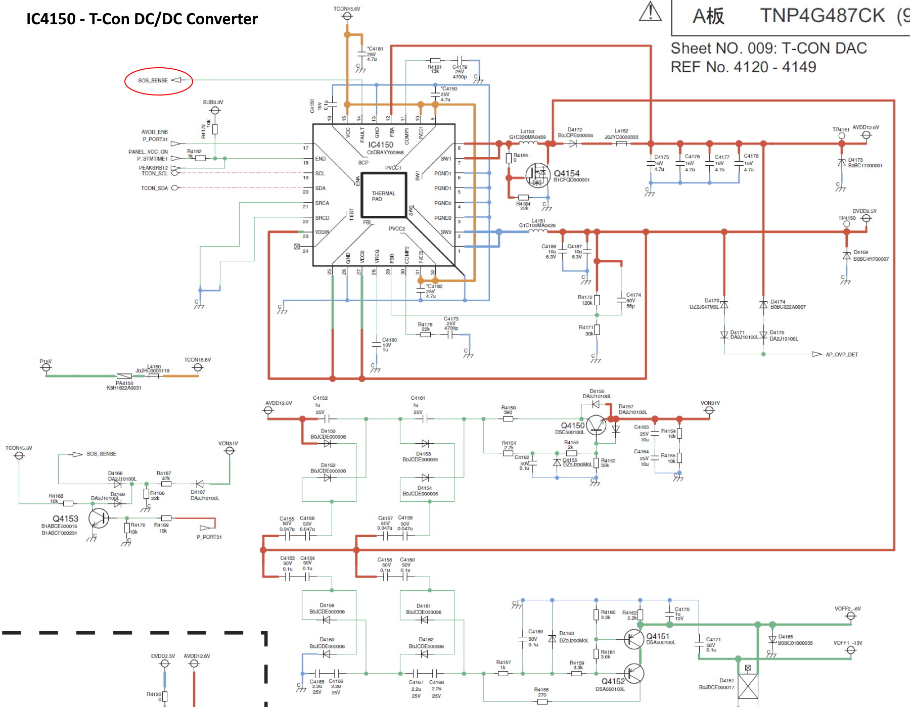

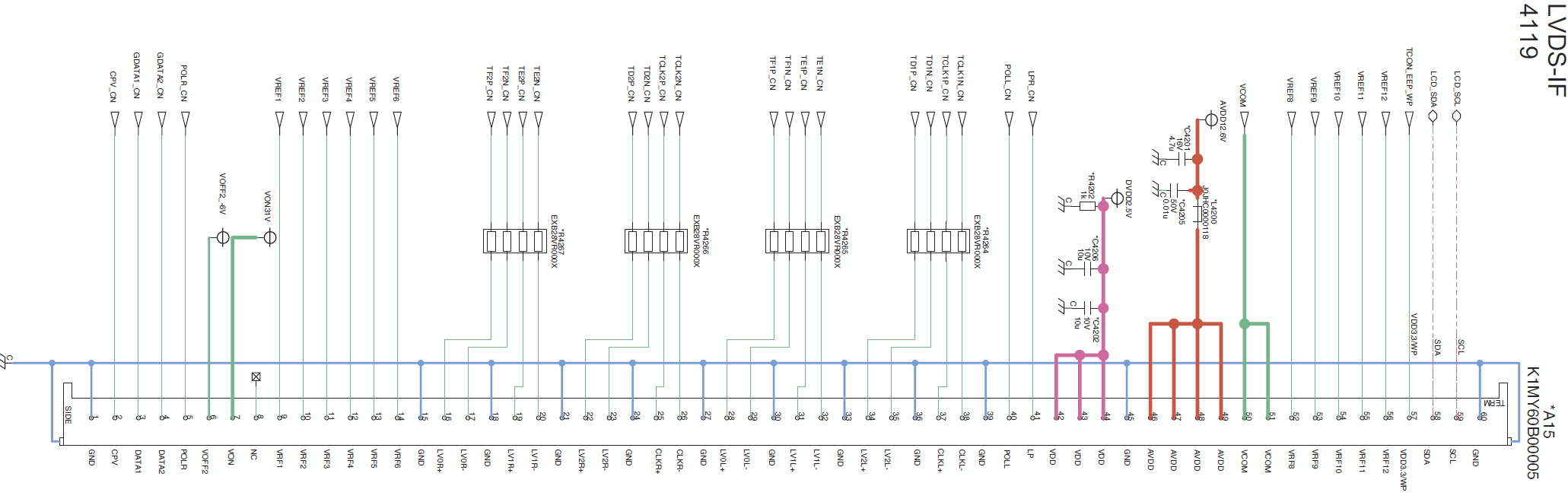

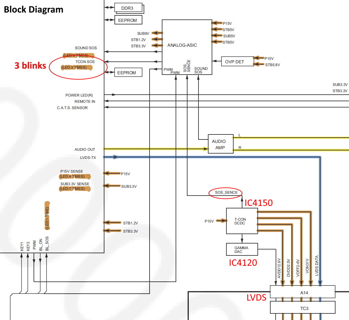

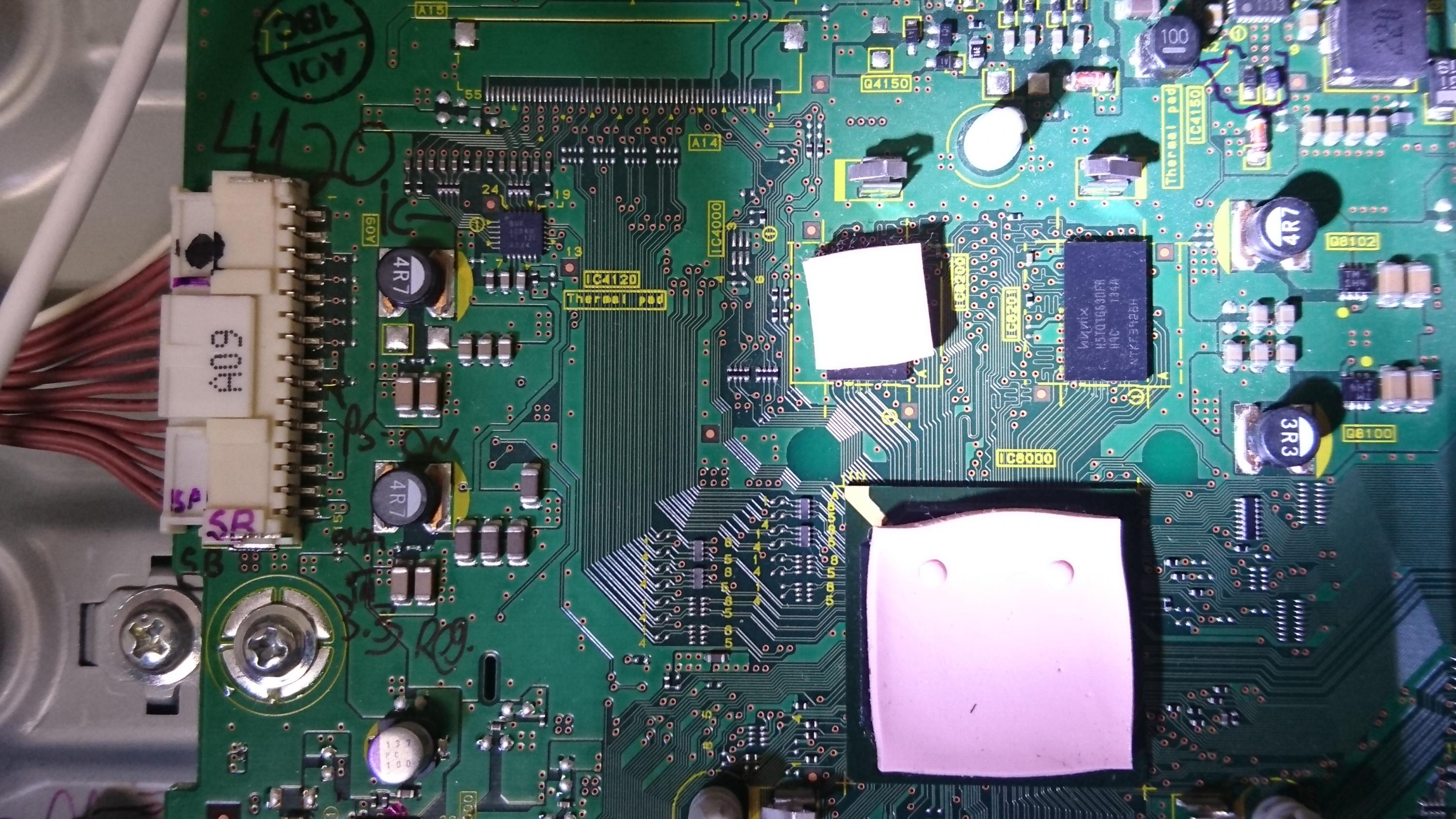

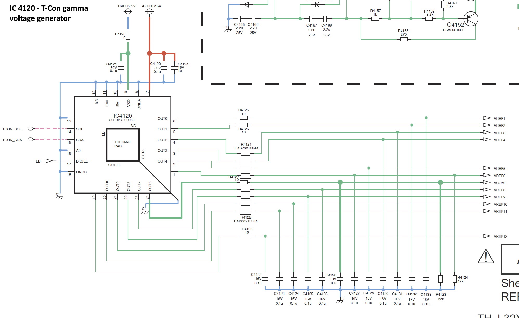

In the SM that budm linked, I saw where it said that 3 led blinks indicates a
Tuner_SOS. In the next column under remark, it also mentions Panel_15V. If
you look at the block diagram however, it shows 3 led blinks is a T-Con_SOS.
If you don't narrow down anything on the tuner, I would check out the T-Con
voltage supply (see attached diagrams). Also, monitor what is happening on
the fault pin of IC4150 when you turn the power on.Attached Filesif you find these attachements useful please consider making a small donation to the site

HIIn the SM that budm linked, I saw where it said that 3 led blinks indicates a
due to my lack of luckyness .. while ive tried to test it - the tv came back to life for few secs[ ive hold the probe very careully- either it short to GND or just completed a broken trace
then ive turn it on- off to see if it still work and it was- when ive tried on the hird time- it died again but now i think it got worst
looks like the pa4150 fuse got blown and probably many other components-
