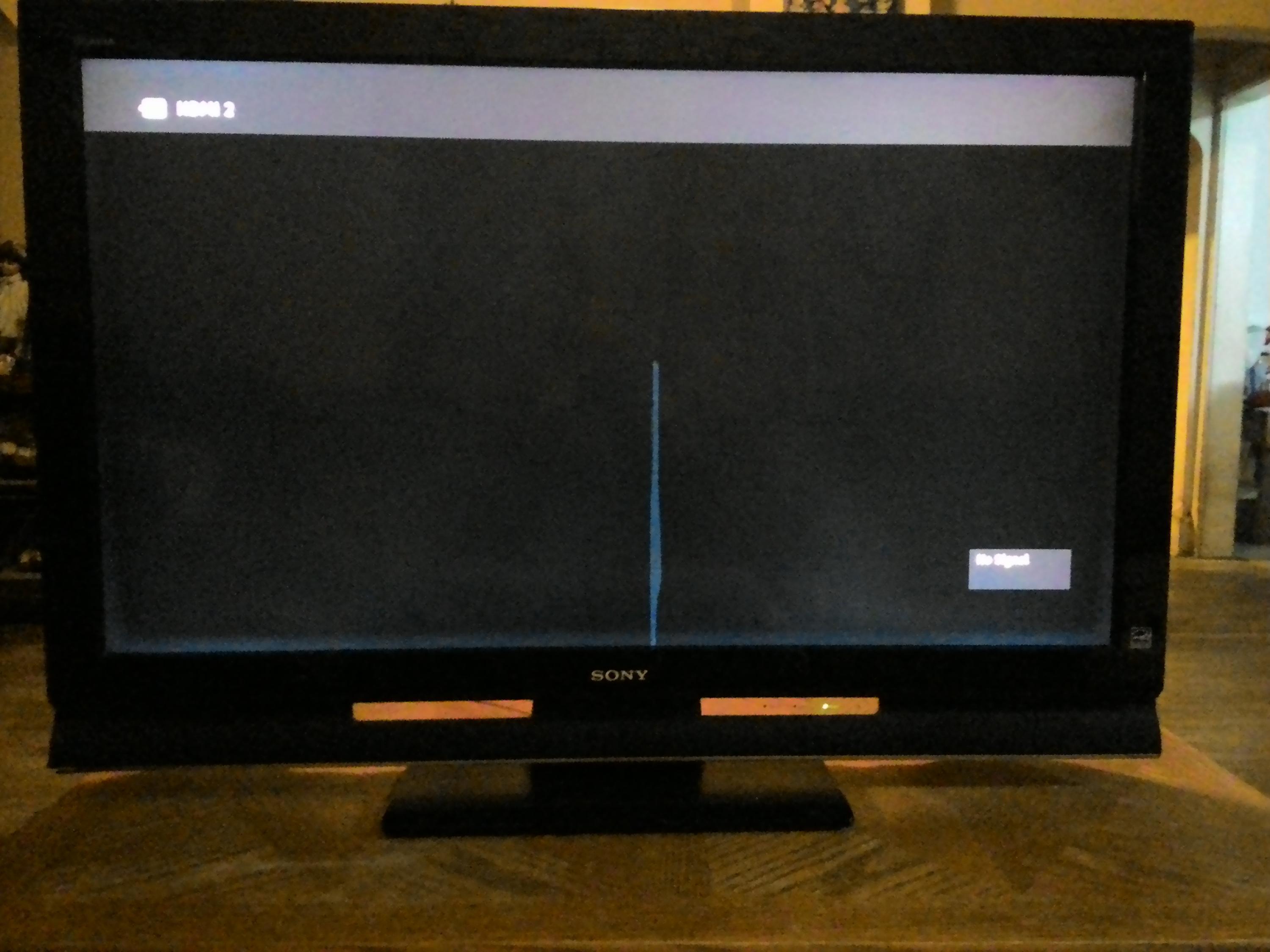

    Hello all,
    I found a free working Sony KDL-46S4100 46" TV.
    The problem is it has a vertical black line that starts at the bottom of the screen and runs up about to the middle of the screen.
    The line is even noticeable when the TV is powered off, so I'm guessing this is some kind of not fixable screen issue. Maybe a coating coming off from cleaning the TV with a fluid? or something delaminating?
    Whatever it is it's not on the outer part of the screen it's like its on the inside or between some layers.
    Before I harvest the boards and recycle the rest is there any hope of repair and if not what do you all think caused the issue?

    Yes, this looks like a broken panel. If it were tab bond issues, the vertical line would run the entire vertical height of the screen. Gut it and sell the parts

      Look hard at the panel use a flashlight and magnifying glass if needed, if it's damaged it should be obvious if you can't tell take the panel off and look at the other side and the diffuser sheets and backlights since you will be in there, keep sheets in order and be VERY careful with the flimsy panel, sometimes they break if you even sneeze, It can be hard to tell without looking deeper.

        Maybe some caustic liquid has drop inside degrading the internal polarization film, i dont know but the internal one usually has a gloss finish so it's not a foil but a coating, you can try maybe to stick a piece of external one took from a cracked screen and rotated with the right direction. Before doing this ensure it is not only simple removeable dirt.

          I finally got around to tearing the TV apart today. It was surprisingly easy to get the LCD panel out.well done Sony.
          The backside of the panel was a bit hazy (TV came from a smokers home) so I cleaned it thoroughly with eye glass cleaning wipes.
          Looking at the backside of the panel I could not see the line at all, but looking at the front side I could see the line clearly. It looks like whatever is causing the line is a layer below the outer panel.
          I didn't see any sign of physical damage from a impact or crack of any kind.
          While I had the panel out I tried heating where the line is with a hot air gun and rubbing it with a soft cloth and it made no difference.
          I ended up putting the TV back together and will probably stick it out in the garage and use it for watching sports or youtube vids when I'm repairing something.

              One question, if you watch at the front side of the glass matrix and see against the light reflection, could you see some surface opacity where there is the line? I had a monitor with similar defect, the damaged areas was in a shapes of liquid bloches with the liquid path to the bezel.. Maybe the front polarizer is the one ruined. I know there are polarizers on the market.

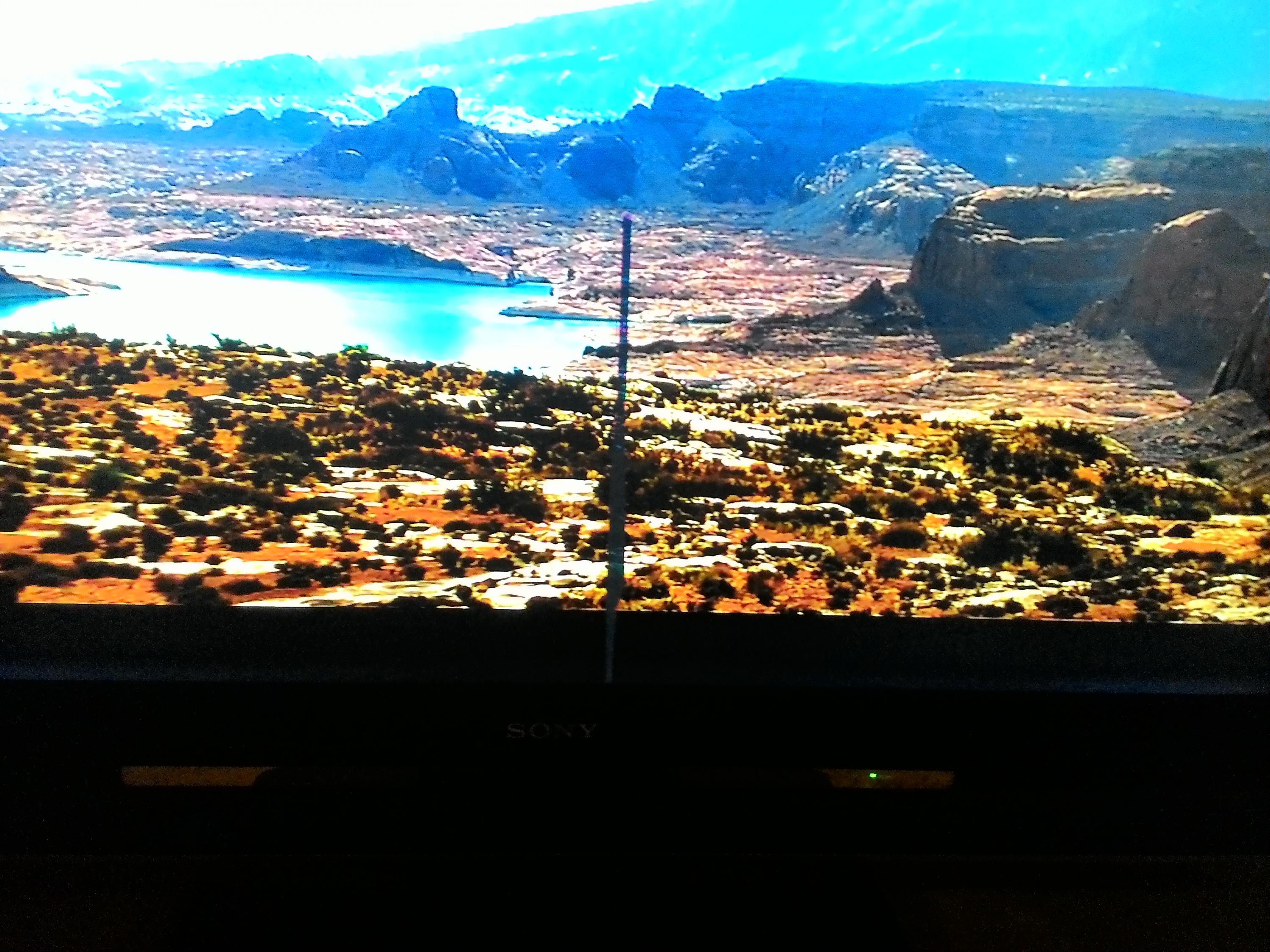

                anyways when I look at the line on the TV (powered on playing a movie) up close it kind of looks like smeared pixels around the outer edge of the line.
                Also after a bit of google research it seems that sony , atleast on some older models, had quite a few problems with the polarizer lifting in certain spots.
                I would try to replace the polarizer, but from the videos I've seen it can be quite the task to remove the old polarizer and leftover adhesive.
                Plus on ebay the listings for TV polarizers ask what pitch you want when ordering..How would I find out the pitch of my TV?
