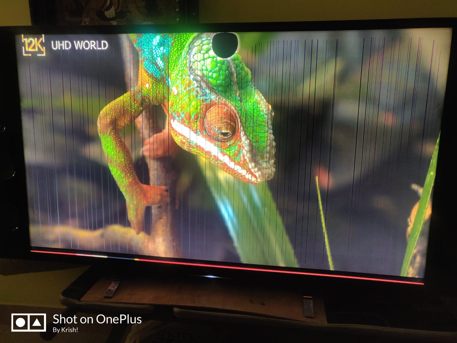

    Can experts please share their opinion on this issue where i have a black spot and vertical lines all over the screen.
    Is this fixable or needs a new panel?

    Yes, new panel required.

      Any specific reason to why the panel cof bonding will not fix the issue.

        The black spot indicates the panel is damaged.

          Did something happen to that part of the screen?

            not fixable, sell the boards, or... if the device is less than 2 years old you can hope for a warranty substitution

              No impact at all, just normal usage
