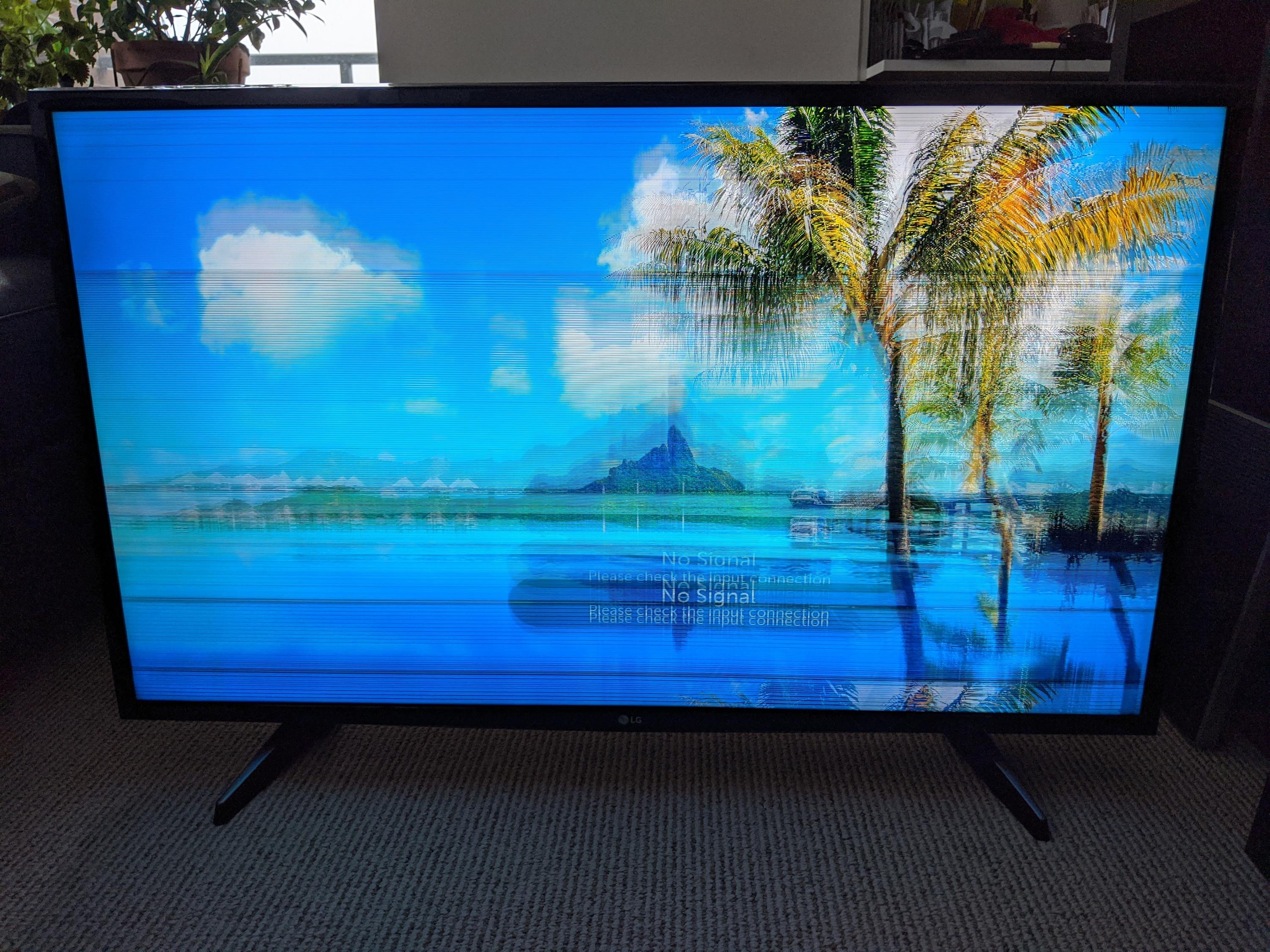

    I have a LG 43UH6100-UH LCD TV that is flickering and distorting the picture.
    From my limited research I have found the cause to be either the TCON board, loose ground or loose/bad cable.
    Here is a link to photos and video of the issue. https://photos.app.goo.gl/tvsm5Qpz7KLd8Aa16
    Has any one else seen this before. Thanks

    Looks like it could be a bad gate driver, try the "cut tape" method, sometime you have to play with the tape placement: https://www.youtube.com/watch?v=j7vl7-vZEL8

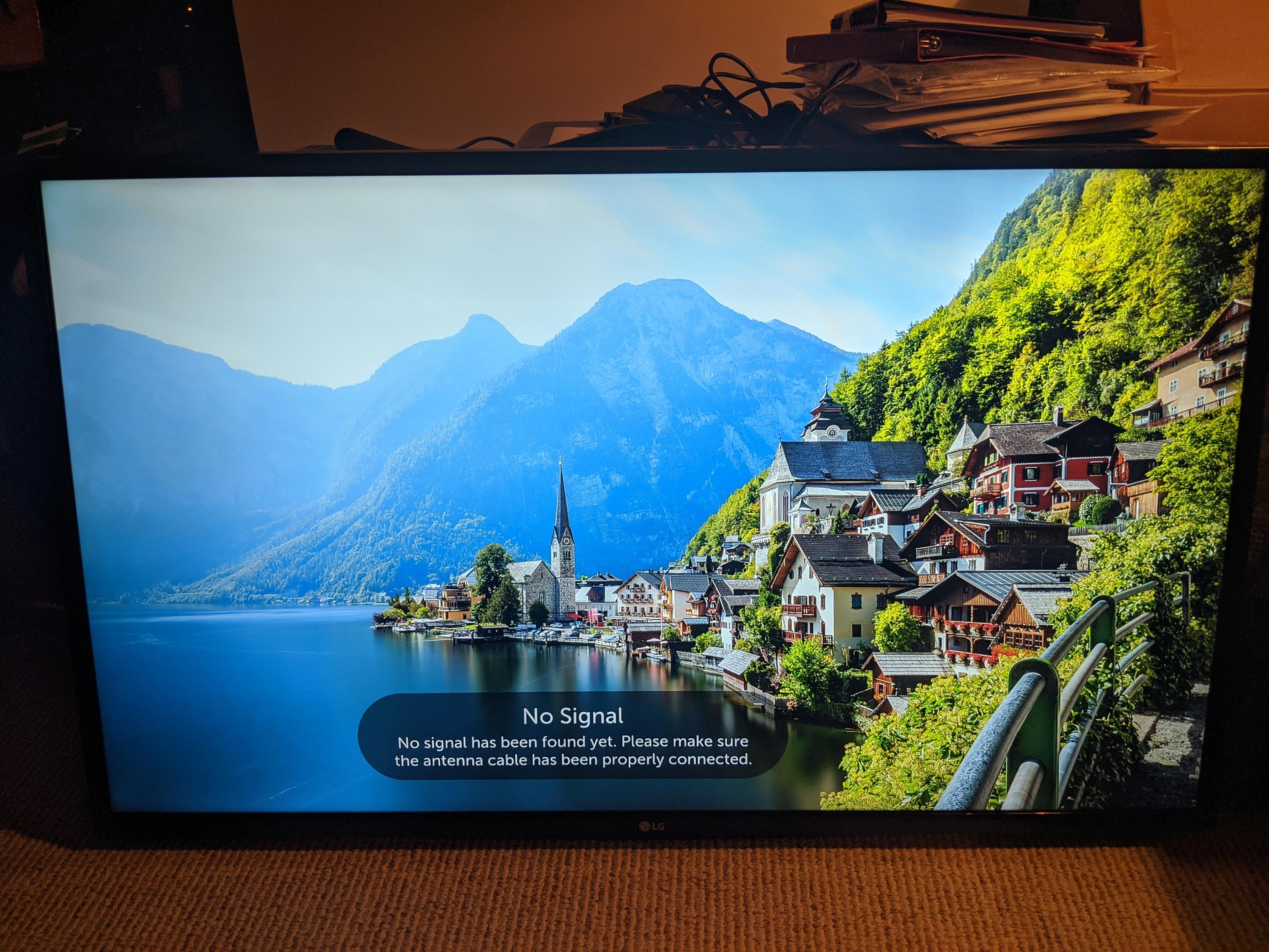

      Thanks for the tip. It worked! I placed a very thin piece of tape on the left cable on the right side over the green stripe.
      I also referenced this video for any one else having the problem:
      https://www.youtube.com/watch?v=kUWapOBtm0Y
      Here is the updated screen.

        Great job, another bad panel with Gate drive issue.
