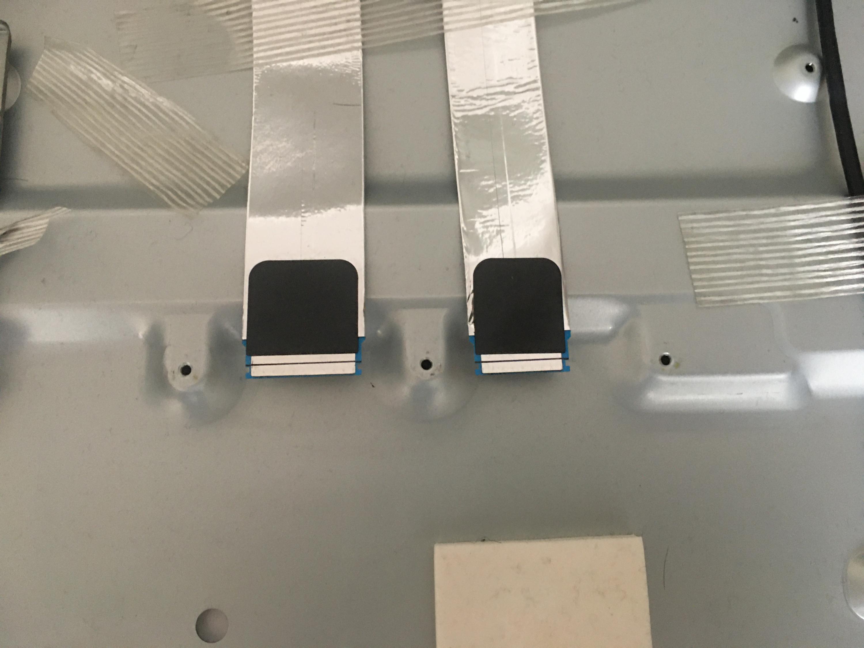

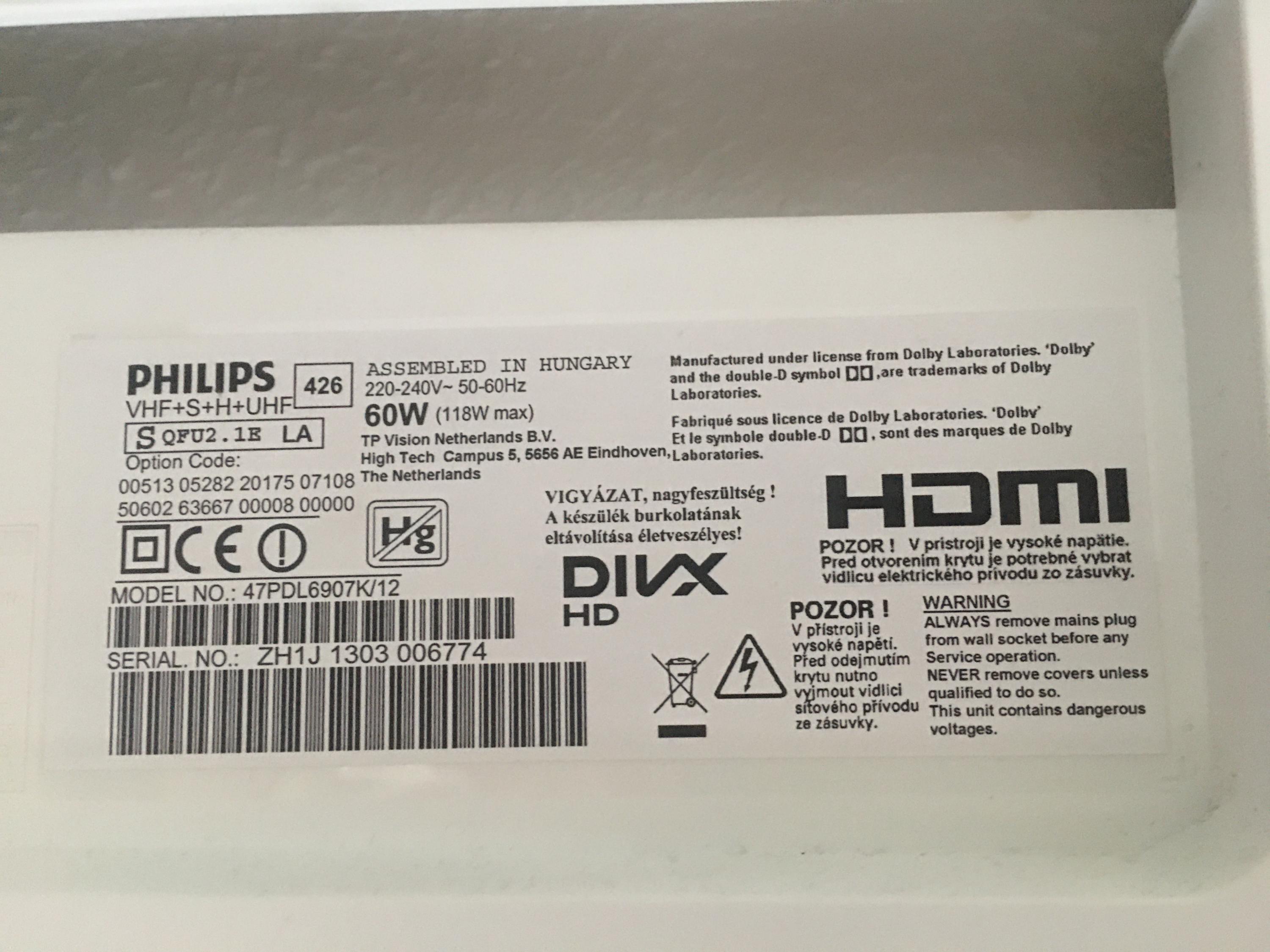

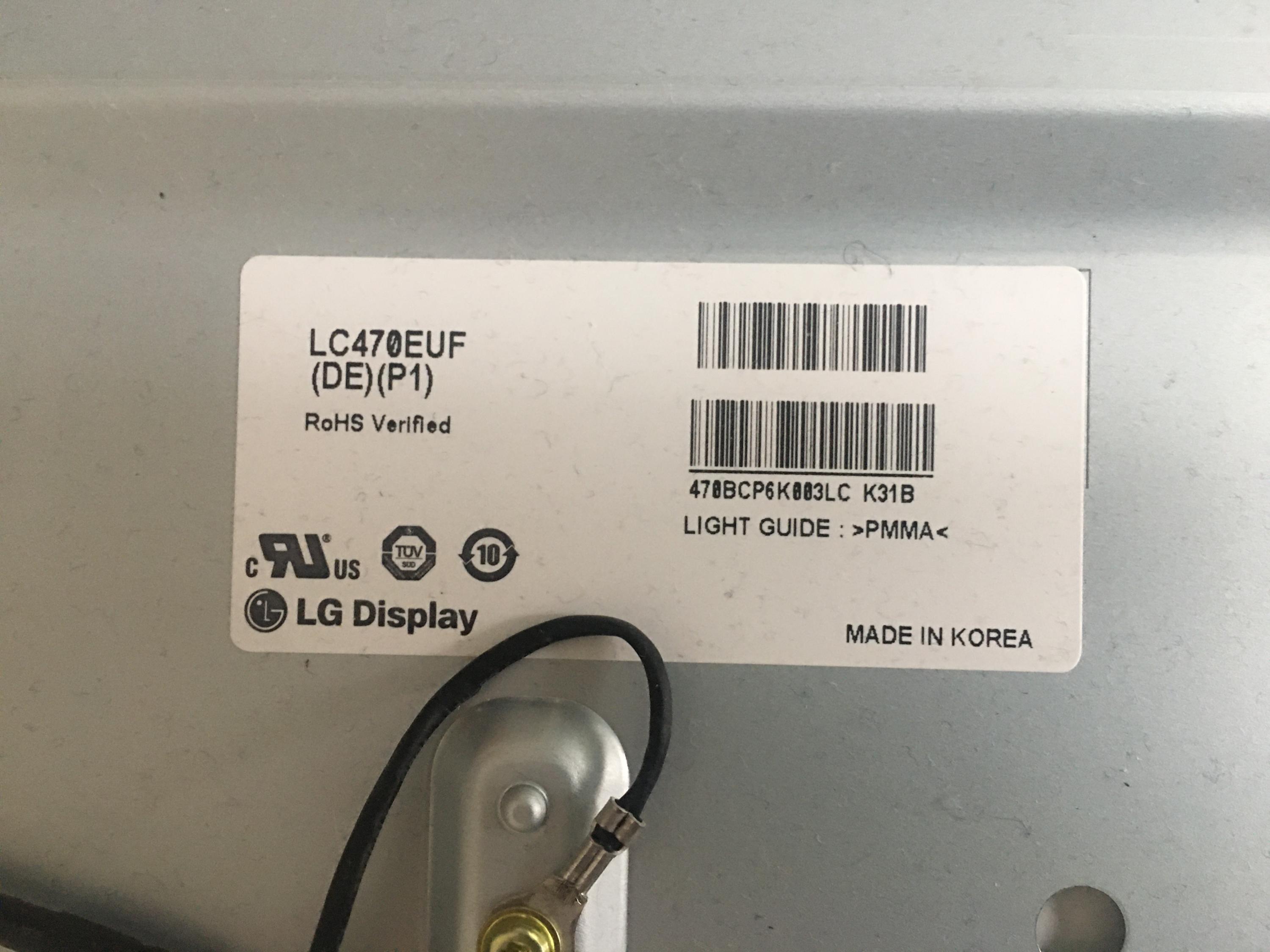

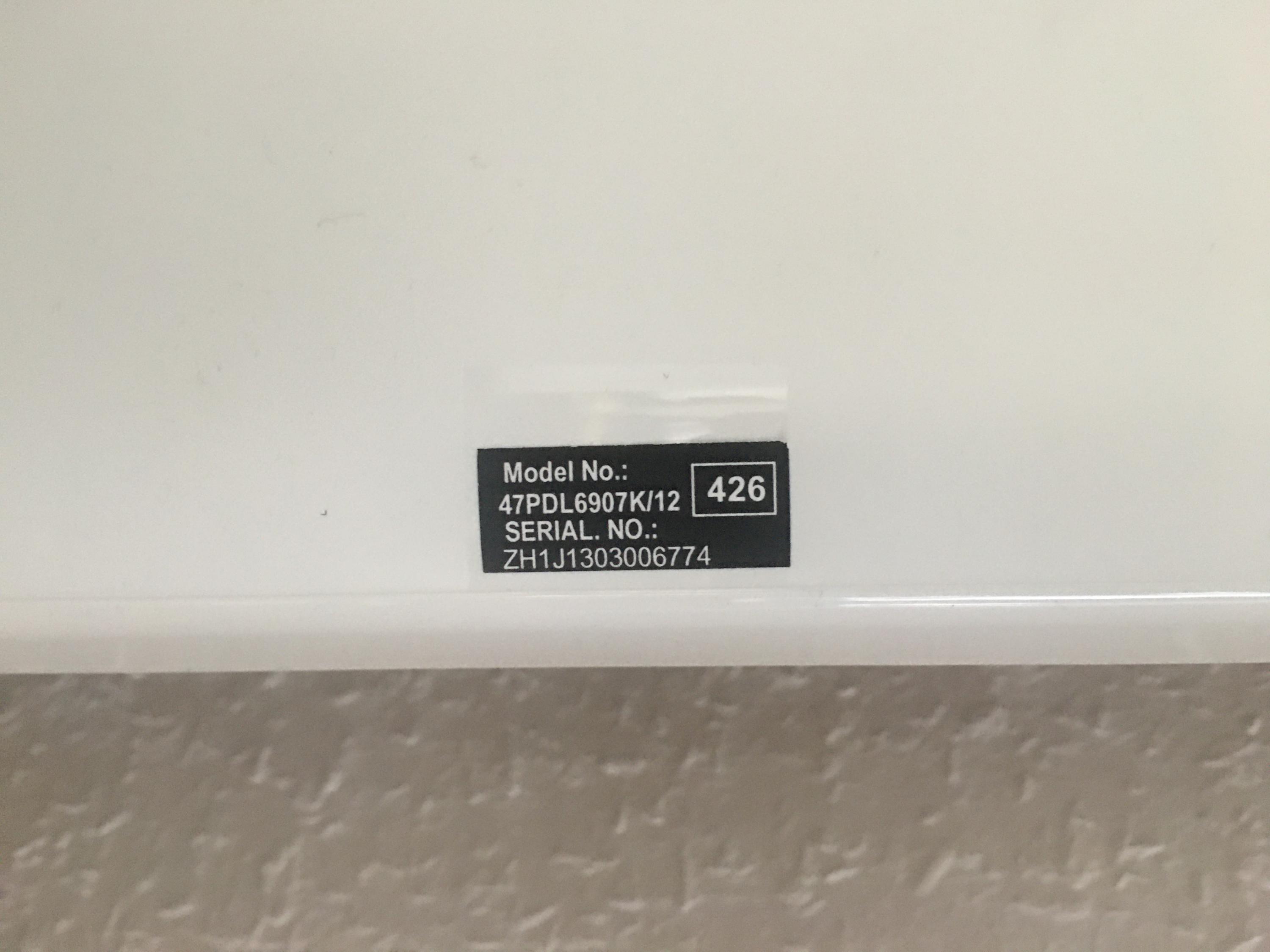

                  Hi Diah
                  We were talking before about the mainboard swap, do you remember? Well the seller tried to scam me so I'm out of options now.
                  Anyways.. I know that the panels are more or less universal and I think it was an LG one. I'll post photos of all stickers.
                  I don't care if the TV ends up with a Sony or LG board. It just has to work.
                  Only sad thing is that I will loose Ambilight. But oh well.. Couldn't care less.
                  Thank you so much for your help!
                  Stickers are attached.
                  As you can see it already collected a ton of dust

                    well from the 2 T-Con socket and the specification of your Original TV its sound to me Toshiba TL series, not sure if they have 47 or just 46 , but sure there are 55 and 40.. (TL868 they used with it 3 brand Panel A C K. ) . ( Vestel can share too .. but need more inspect to know which model support 3D) MB. also the LG LA 47 series had same socket... i will update here when i found more.
