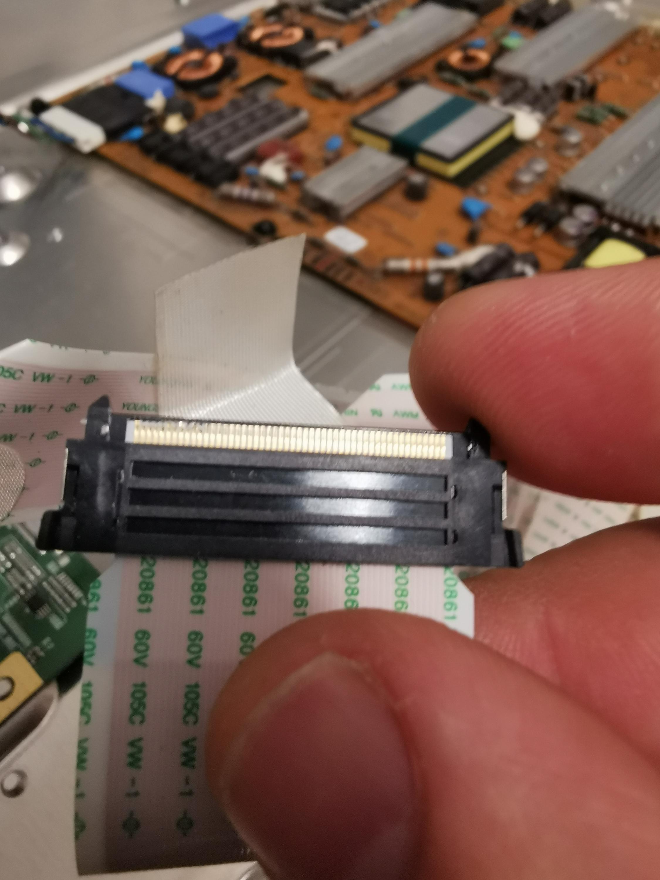

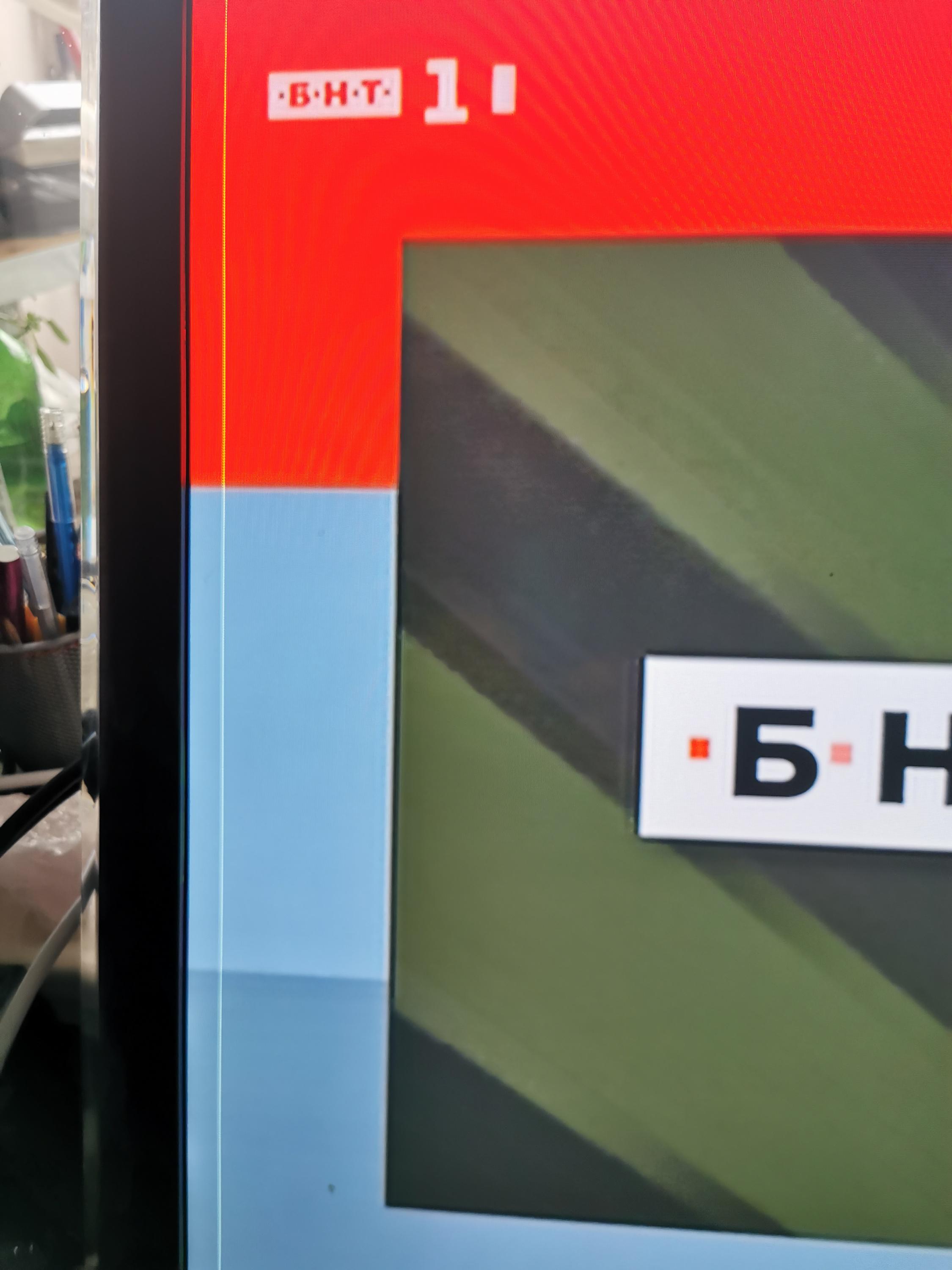

    BUT there is another problem. There is a green horizontal line on the left part on the screen, not visible on black picture. I've cleaned the ribbon cables with a rubber and a brush, but that didn't fix the problem. One of the ends of the ribbon cable has few lines (i don't know if this is the correct term) looking kind of strange but appear to be making contact with the boards.
    I would appreciate your suggestions on how to get rid of the line and If I should order a new CPU and have it rebolted or rely on my fix.

    Can you post a picture of that funky looking ribbon cable end?
      Sure

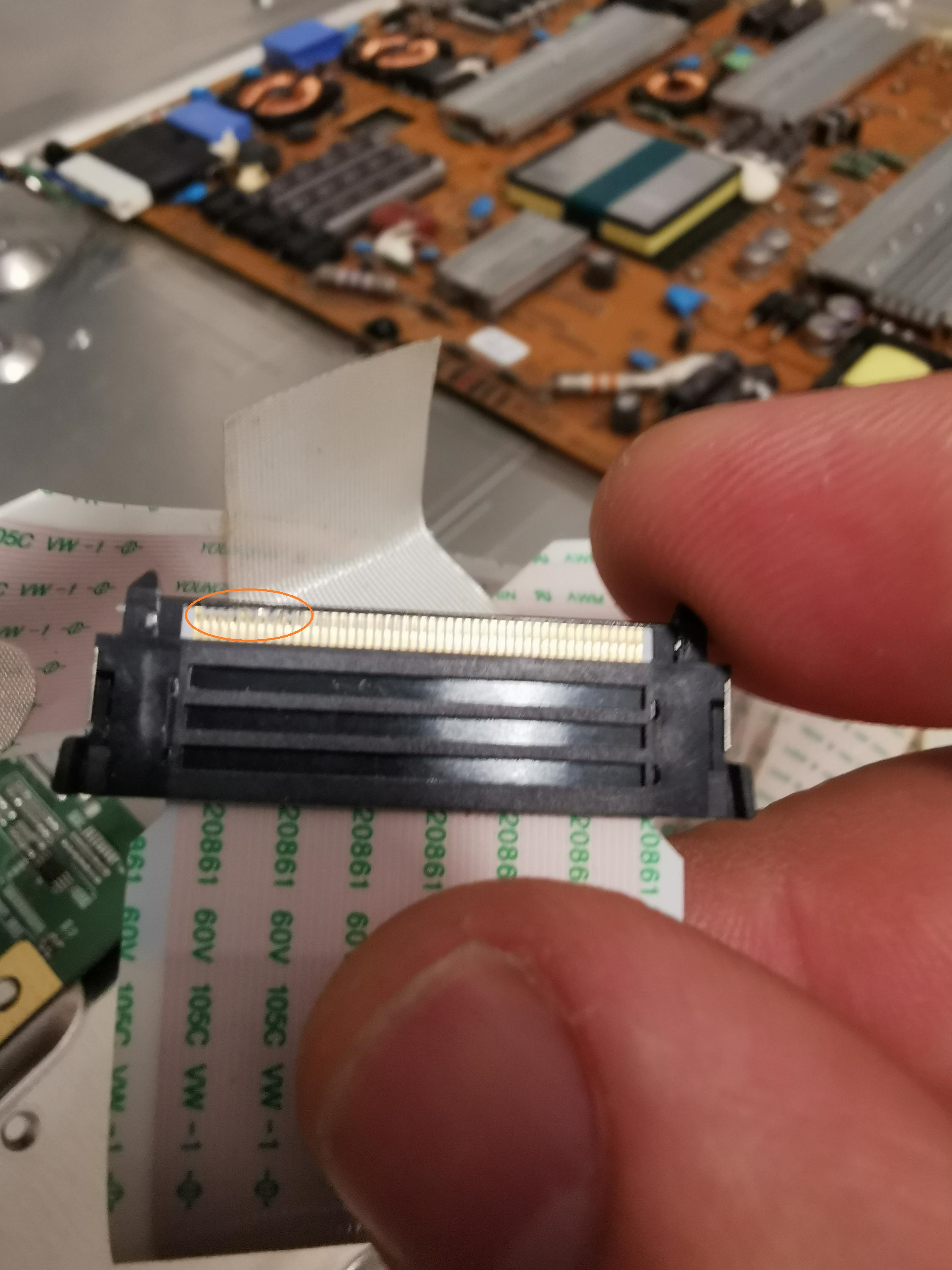

      • yokoono
        • Apr 2010
        • 479
        Re: LG 42LV5500 - horizontal line (got picture and sound after CPU reflow)
        No problems in the red circle?
          Doesn't look too good, I've seen some trim off a little and make it work, never had to try it myself tho.
            Didn't quite get your question
              The tv is working after the reflow, just one horizontal green line
