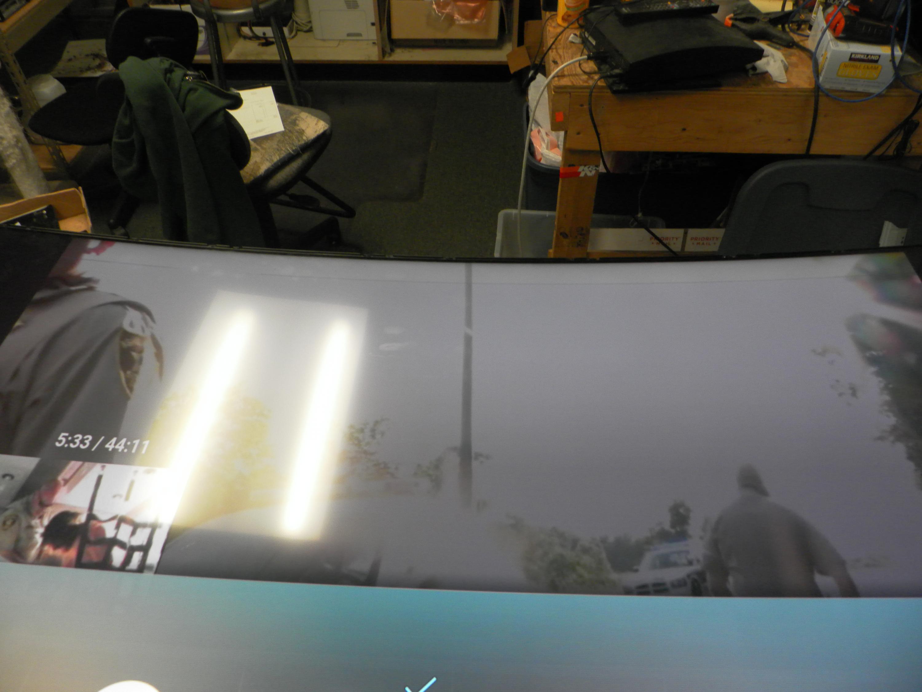

    First let me say I can not get the picture to stay on long enough to take all of the pictures I want but in the one picture you can see a horizontal line in the top of the picture. It will run for about 20 seconds then the whole picture will turn purple and get large horizontal lines in video and reboot. It gets faster at this the longer it is left on. I know it is a panel issue, I am just interested if anyone has had any success repairing the problem. twisting the screen or any pressing on bottom tabs makes no difference.

    have you tried removing the flat panel? if it restarts anyway it may be the motherboard, otherwise it may have some faulty component on the t-con
      Re: Samsung UN65KU6500FXZA horizontal line in top of picture
      Yes I have and still the same issue and there is no tcon. The main goes straight to the panel.

            In response to poweron I finally determined a bad panel. I removed the panel and the problem went away.
              ???? what do you mean "removed the panel and the problem went away"... you threw out the set? :-)
                Sorry, I misspoke. I mean that the panel is the problem. If I remember right (Customer picked it up after I determined it is the panel) and do not quote me I believe there is no tcon so that rules it out.
