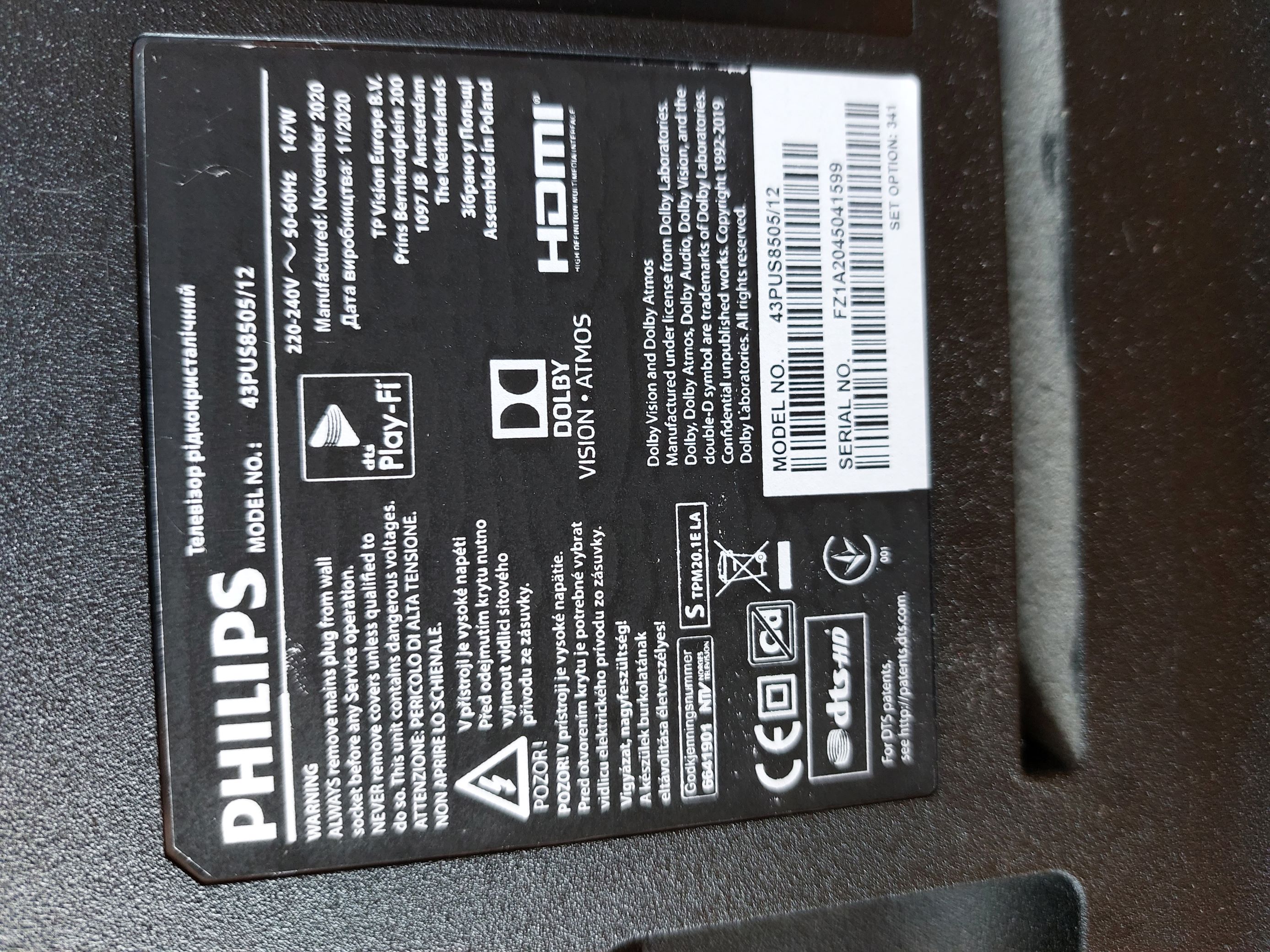

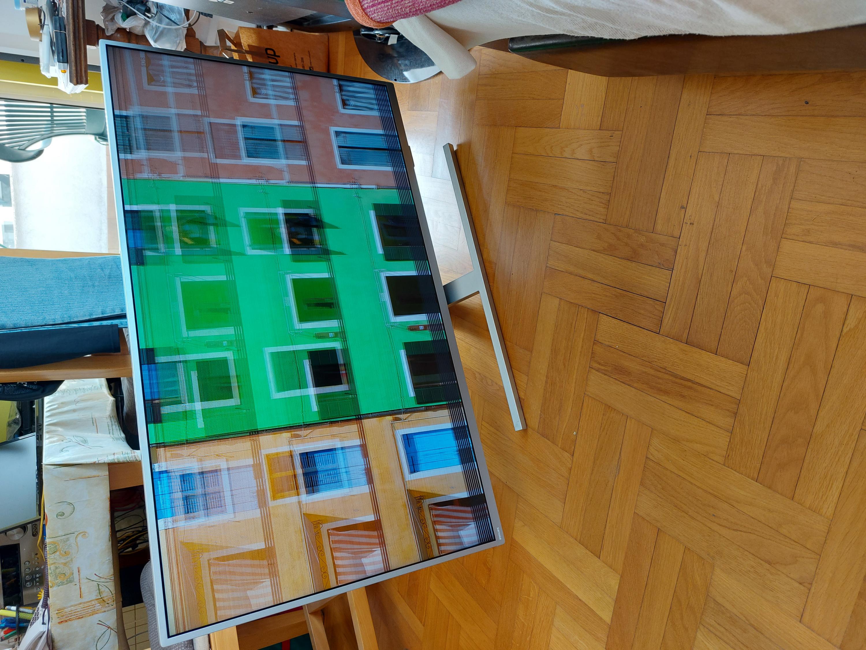

    TV is Philips 43PUS8505/12, bought in 12/2020, so the two-year warranty has expired about 5 mounth ago...
    Problem is that 15 minutes after TV is turned on, the horizontal lines appear and picture start jumping up and down.
    I suspect that T-CON is faulty when wormed up...
    I separated all the cables from the T-CON and cleaned them but there is no change.
    Eco mode is disabled, software is up to date, I make factory reset and reinstal TV from TV menu...no change, problem is stil here.
    Anibody have some thoughts?

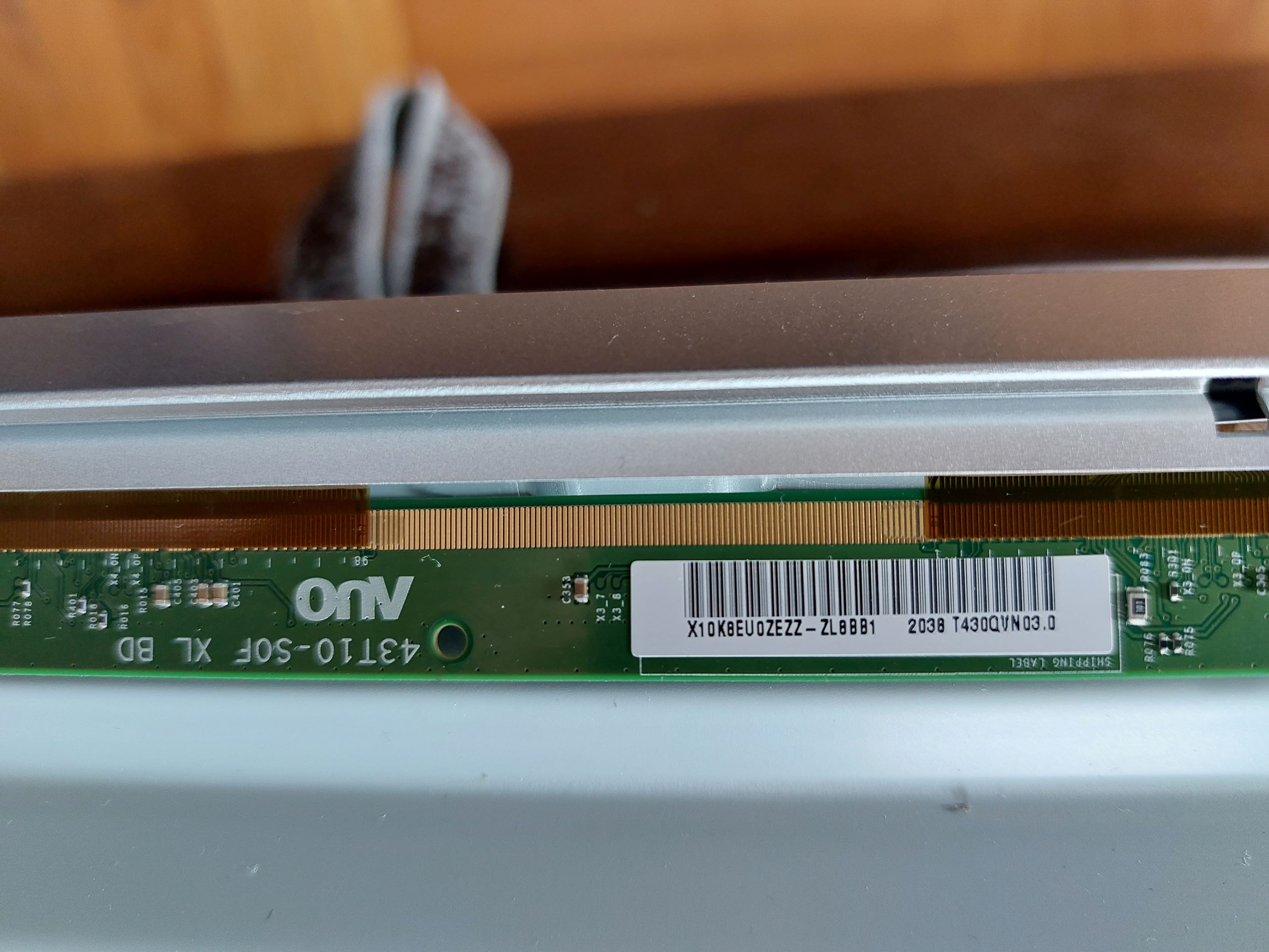

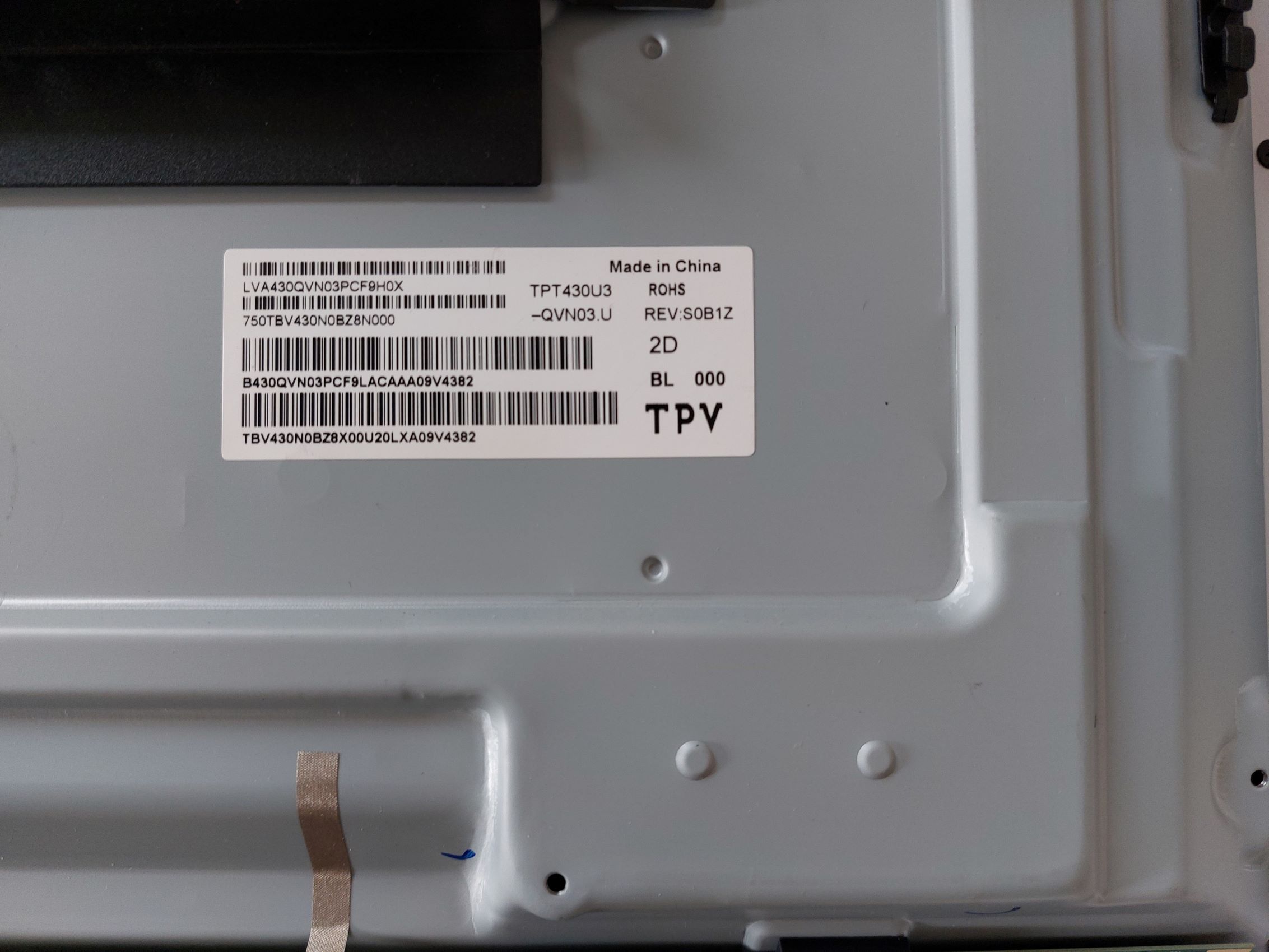

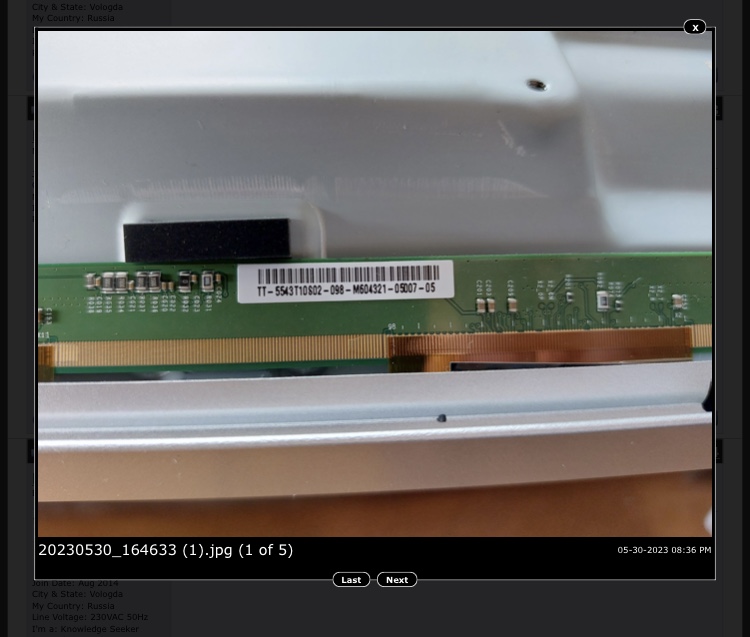

    Re: TV Philips 43PUS8505/12 - horizontal line and picture jumping

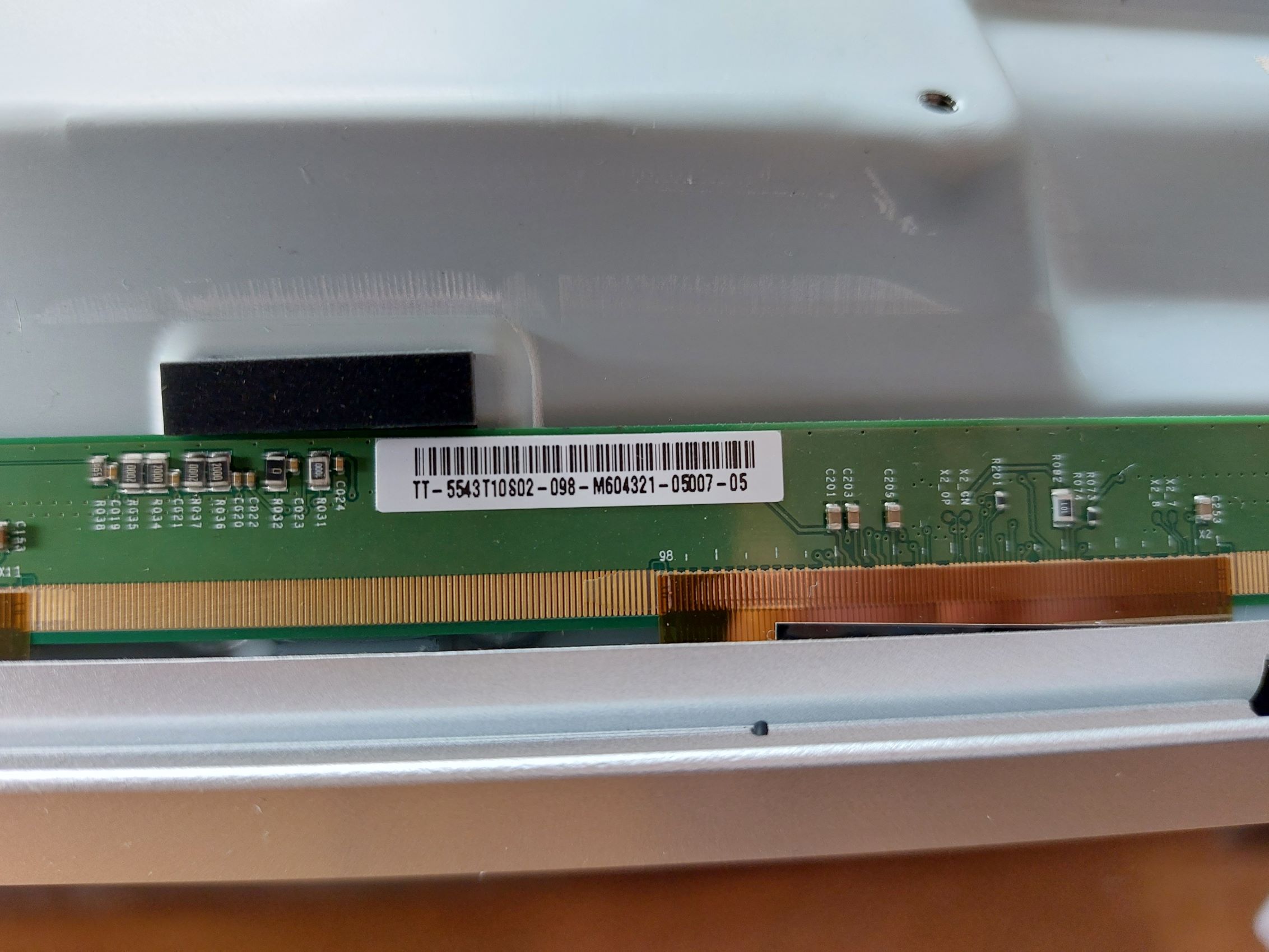

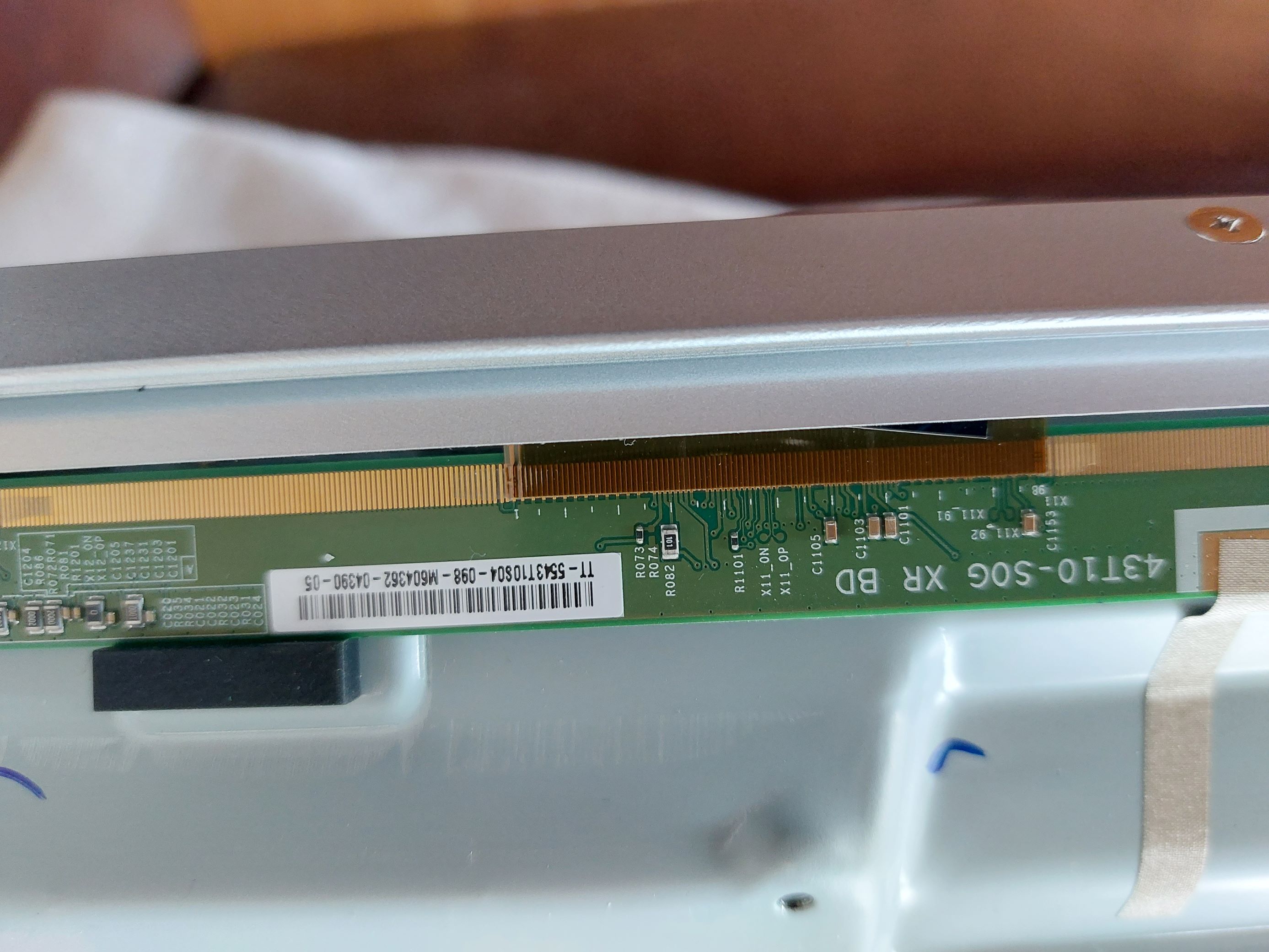

    The name of the display ?
    • betmen
      • May 2019
      • 90
      • Croatia
      Here are the pictures of the stickers...
      • kasfamily
        • Aug 2014
        • 774
        • Russia
        Try to disconnect on one side of the tcon and look at the image

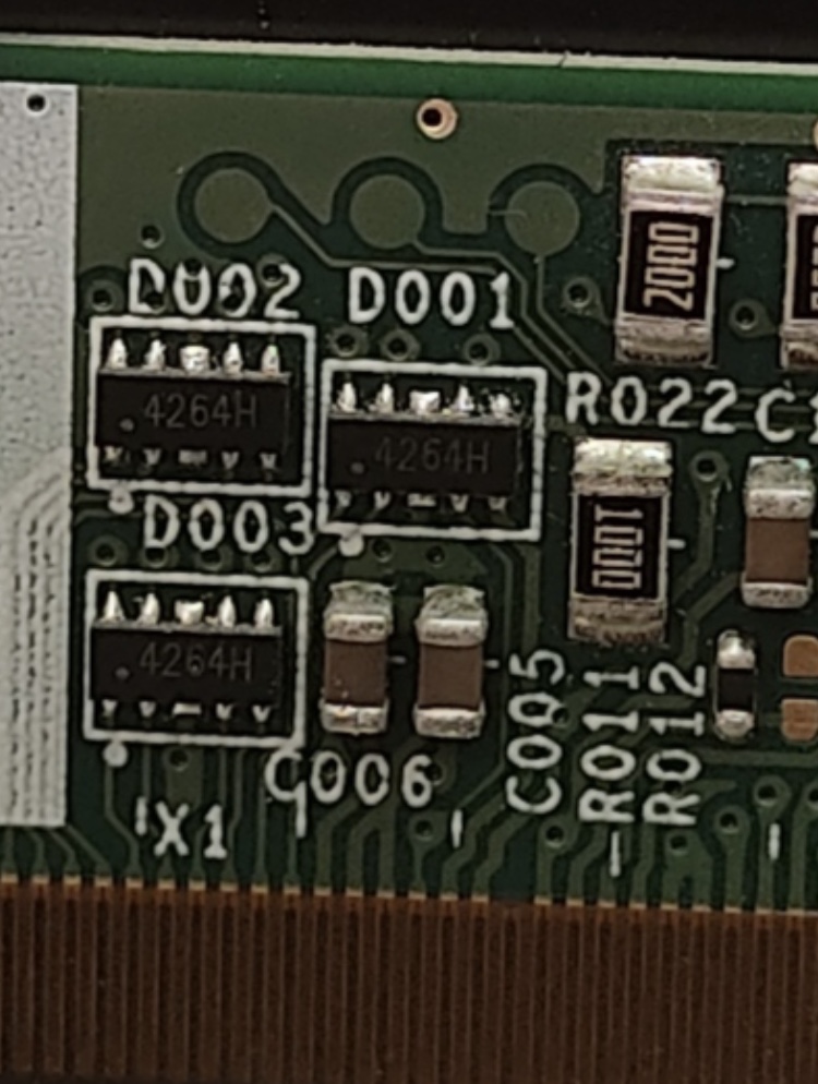

            Check the temperature D001-003
            • betmen
              • May 2019
              • 90
              • Croatia
              can`t find this on my tv...

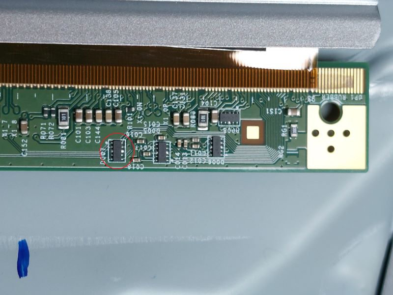

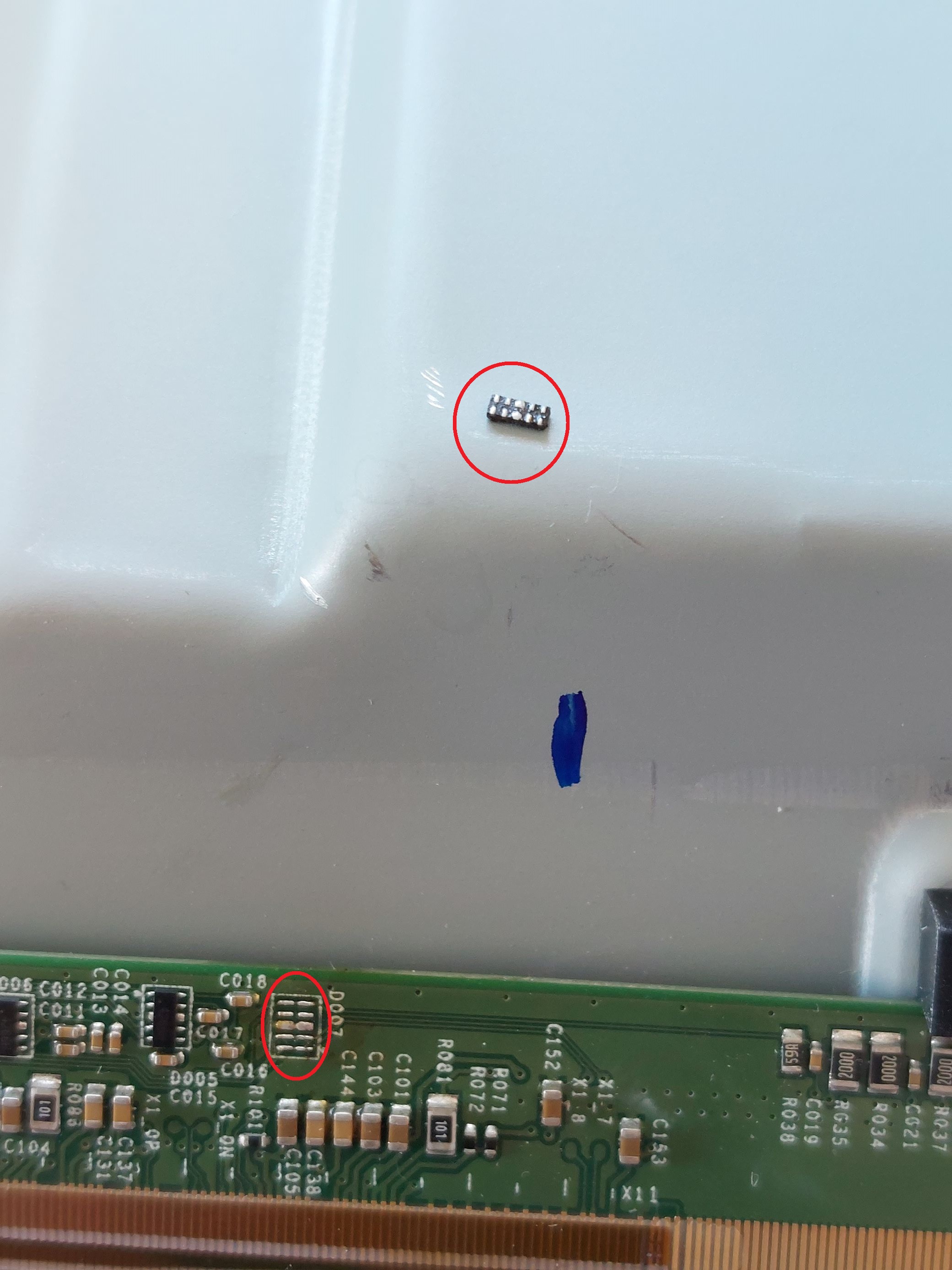

                  I replaced T-CON board and problem is remained.
                  Then I noticed that D007 is very hot when tv is working, so hot that you can`t keep touch it with the finger.
                  When I disconnect cable from T-CON board to the panel board on this side the rest of the picture is ok with no interaptions.
                  When I disconect cable on other side the problem is remaining.
                  So it look like D0007 on panel board on ane side is bad. I can`t find any shorted element with multimeter.
                  Is there any repair possible or not?
                  • lotas
                    • Jan 2016
                    • 4708
                    • Russia
                    You carefully remove it (tvs diodes) and that's it, you can remove all the others, they are more problems than good.

                          • betmen
                            • May 2019
                            • 90
                            • Croatia
                            I removed this diode and tv is working without errors for now, I tested it for 35 minutes...not quite understand it myself what is this diode for and how tv is working without it but I am satisfied for now...
                            thanks for the advice...
                            • petehall347
                              • Jan 2015
                              • 4431
                              • United Kingdom
                              diode is tvs .. transient voltage suppressor its there as protection .
