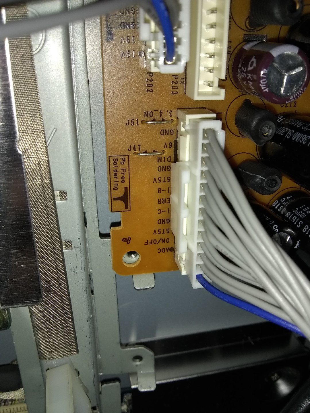

    I repaired this model before with capacitor replacement but this one has a different power supply. I found one bulged 1000uF cap which I replaced.
    TV powers on, flashing front green led goes steady green with no backlight.
    On state skipping GND pins, all DCV
    12V 12.25
    3.4V 3.48
    6V 6.05
    19V 18.4
    3.4_ON 1.52
    6V 6.05
    DIM 3.20
    ST5V 5.09
    I-B 1.72
    ERR 0.03
    I-C 0.07
    ST5V 5.09
    ON/OFF 1.98
    ADC 4.98
    Main filter cap 395V

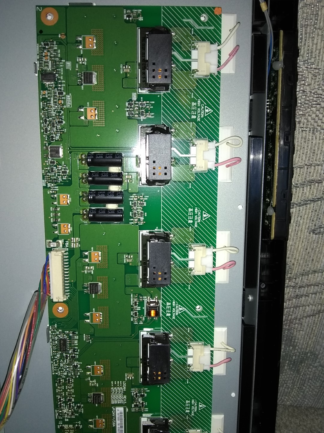

    Inverter board fuse - good, 24VDC on both sides
    Inverter transformers pins 1-2 380-400 ohm, 1-3 780-800 ohms
    Was going to replace all the caps but decided to test after replacing just a few including the bulged one.

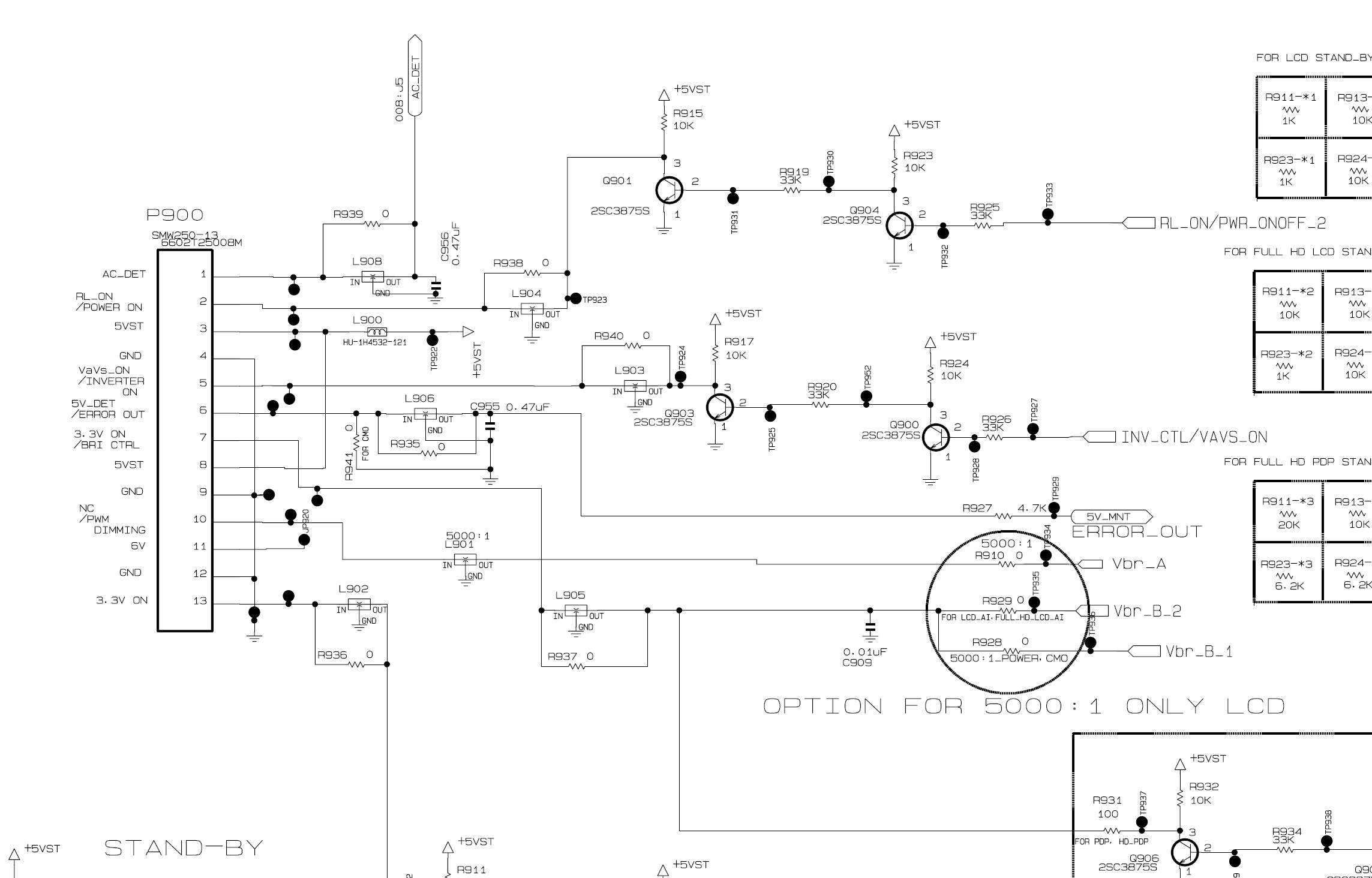

    Edit: found service manual on Elektrokanya. I-C is inverter control and I-B is inverter brightness. Added relevant schematic page.

    sounds like the inverter isn't getting the turn on signal. I-C 0.07
    I_C = Inverter control = BLon
    BLon comes from the main board, goes through the PSU and over to the inverter board. Check and see if BLon is actually dead on the main board too.
    If there is still I-C 0.07V on the main board, while the TV is on, then go through the test points for that Inverter Control on the main board.

      Thanks capleaker. I-C is marked INV ON/OFF on the main board and is probably active high. Most likely bad bga connections on the cpu. TV is only worth $40 and a new main is $20 and it needs $10 worth of new caps. Need to decide I want to break even on it and save it from the landfill.

          Cut the I-C wire and put a 1K resistor from ON/OFF to I-C. Front led flashes green and goes steady as before and backlights come on but no video. At least this confirms the inverter, power supply and backlights are good.
          The schematic isn't an exact match but does show how that pin is driven from the CPU.
