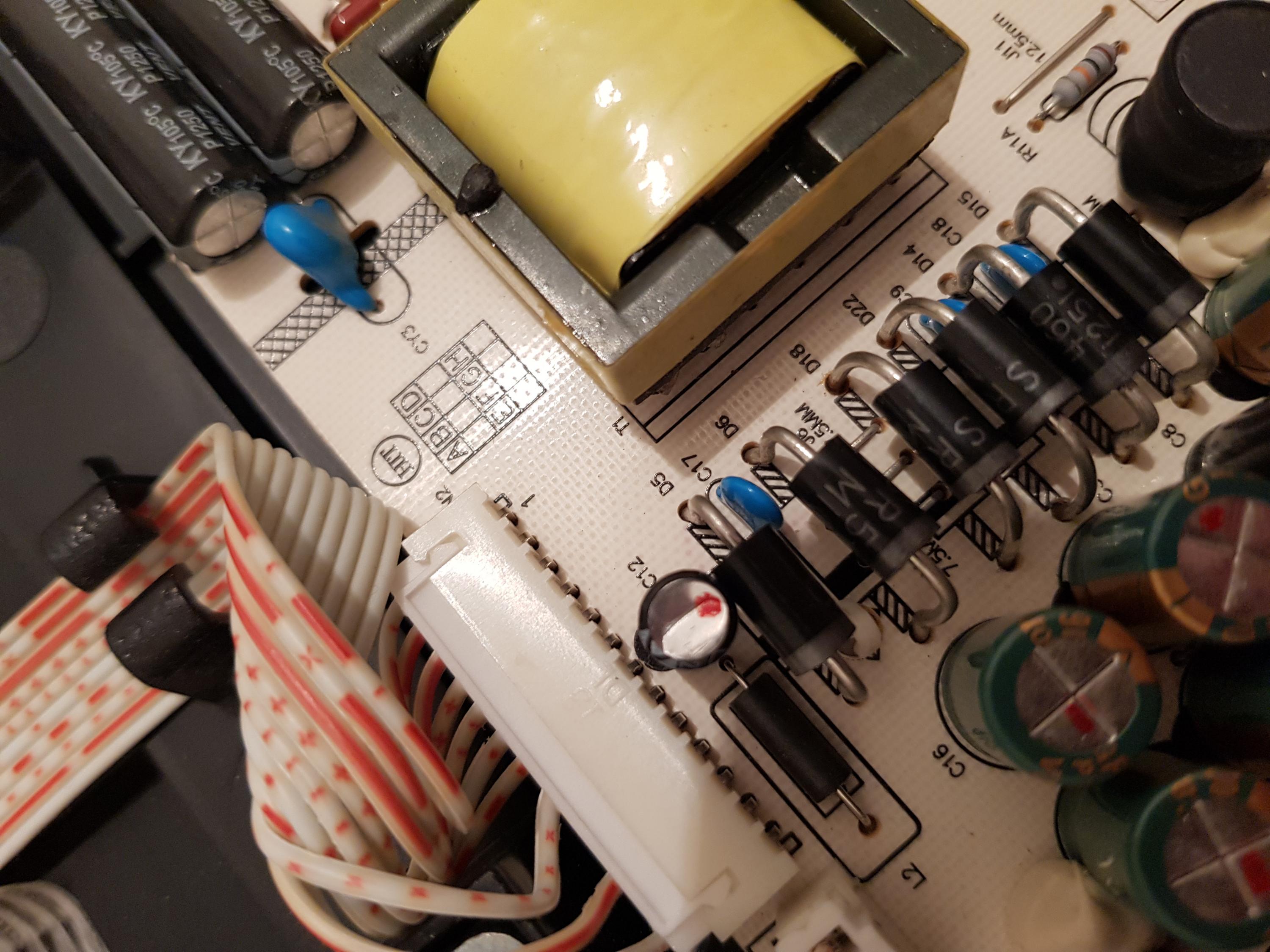

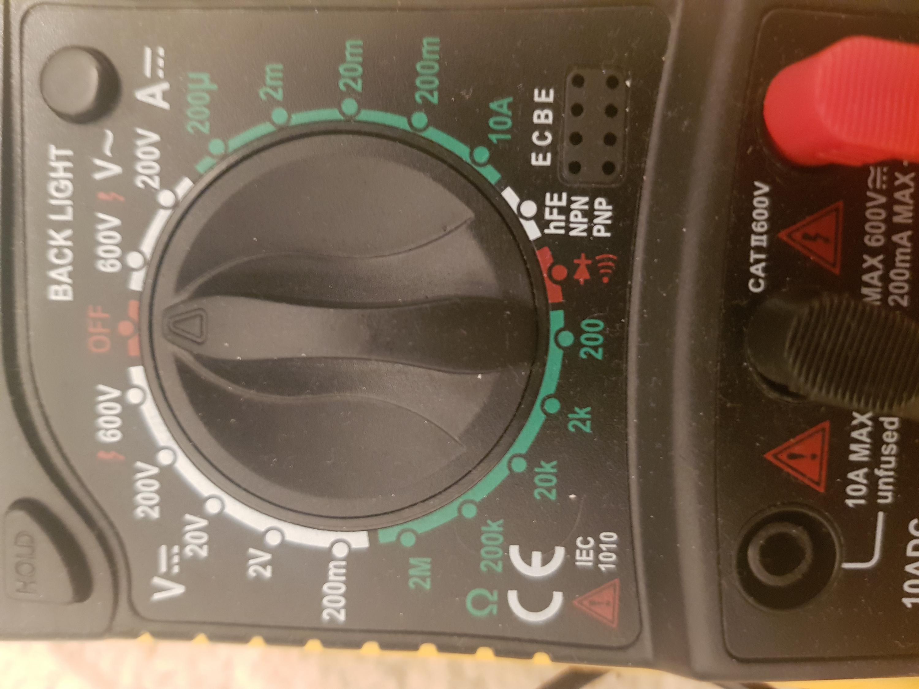

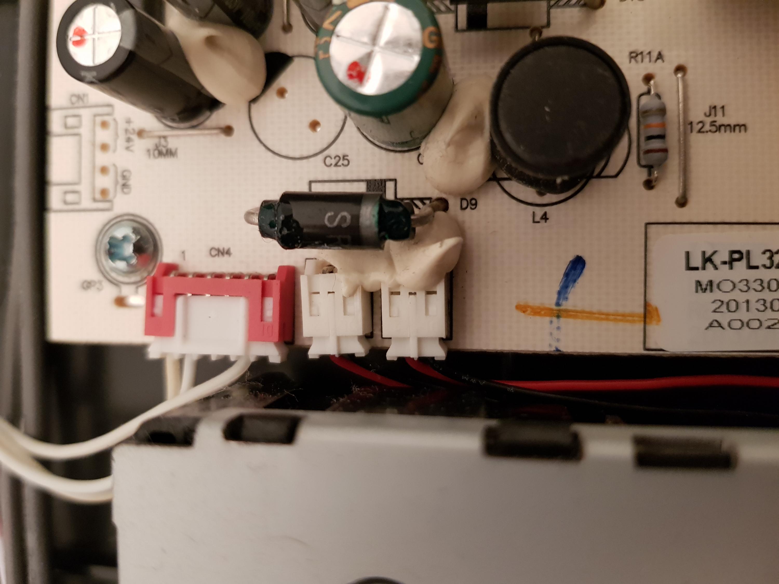

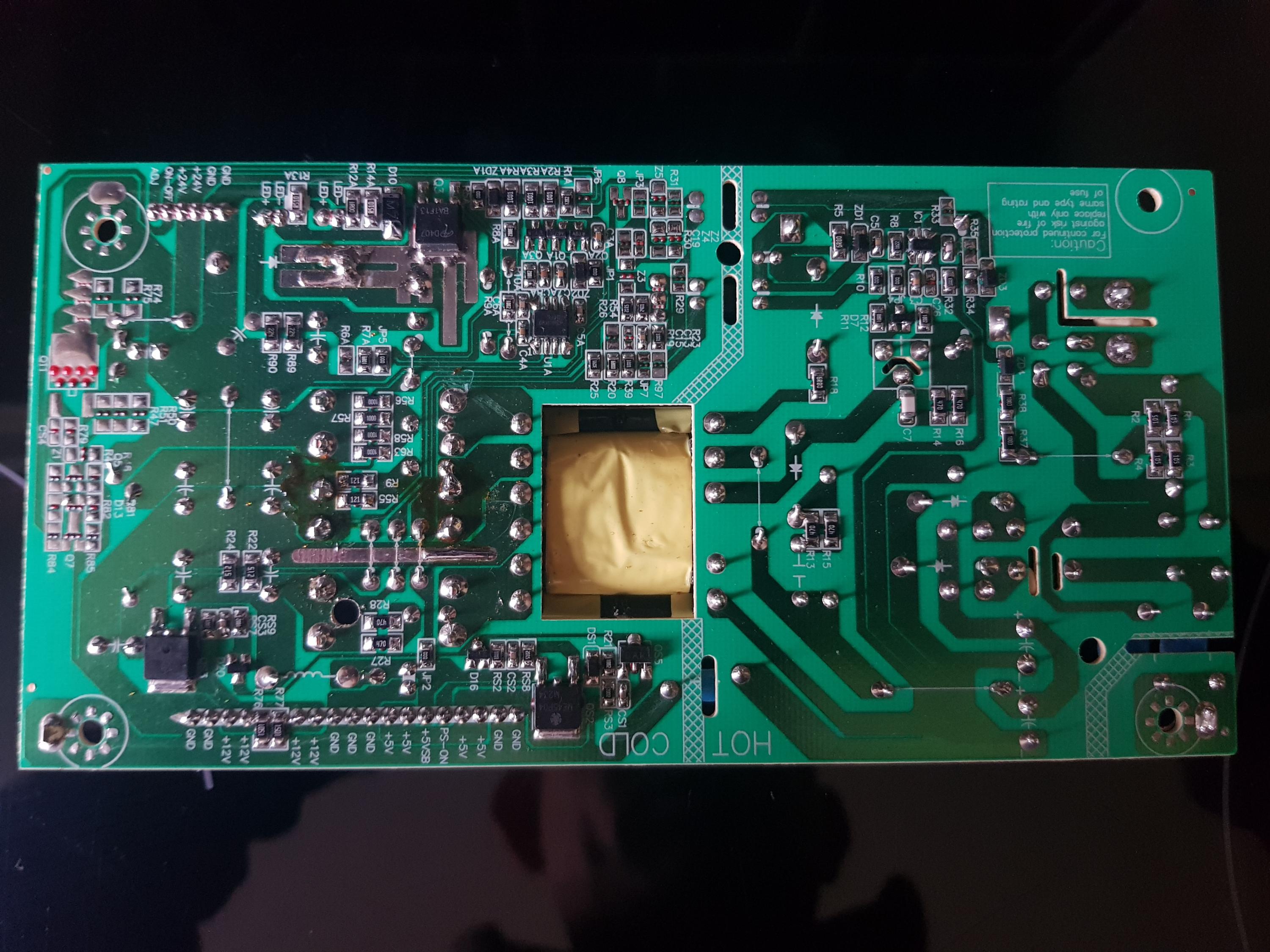

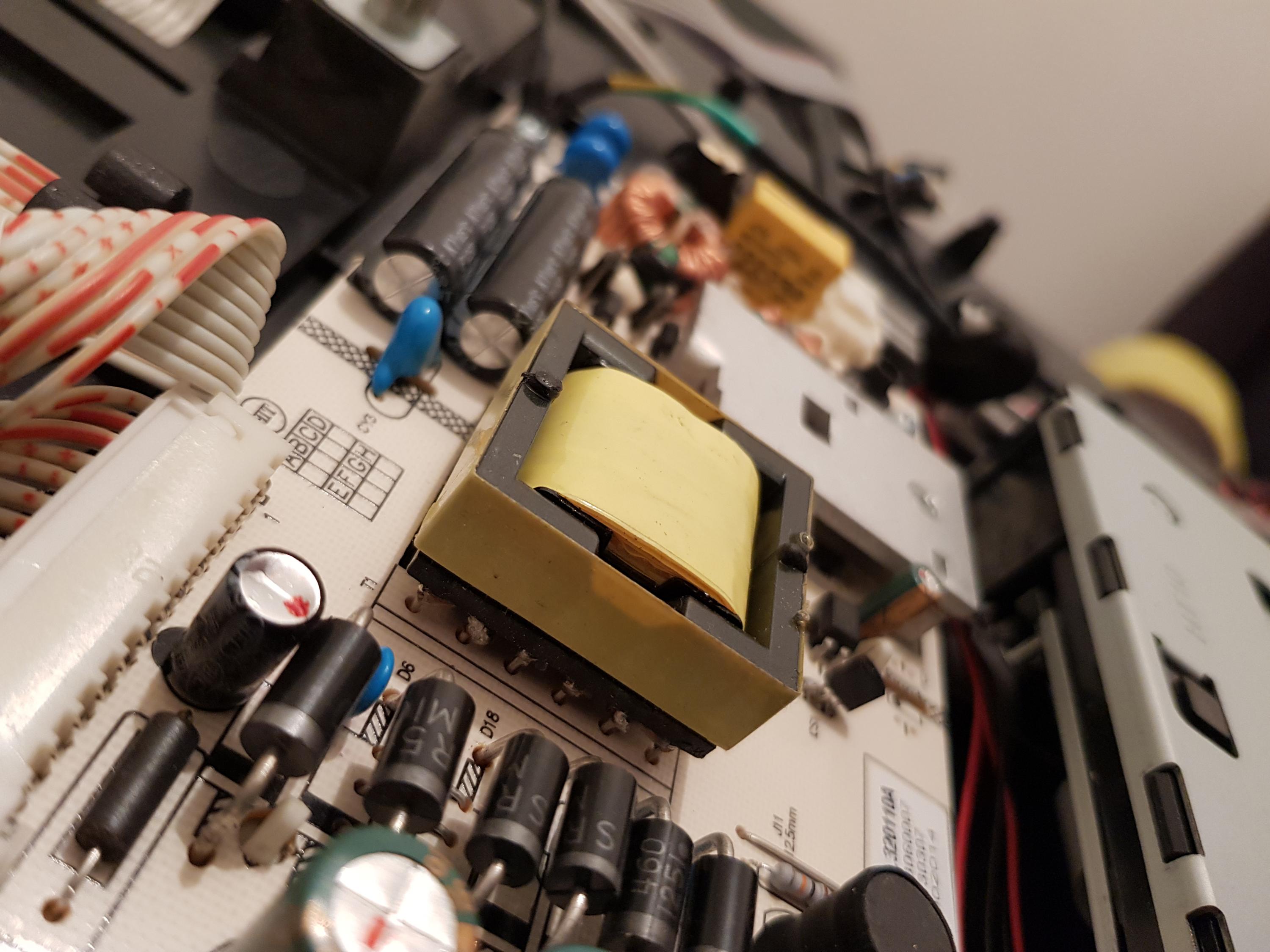

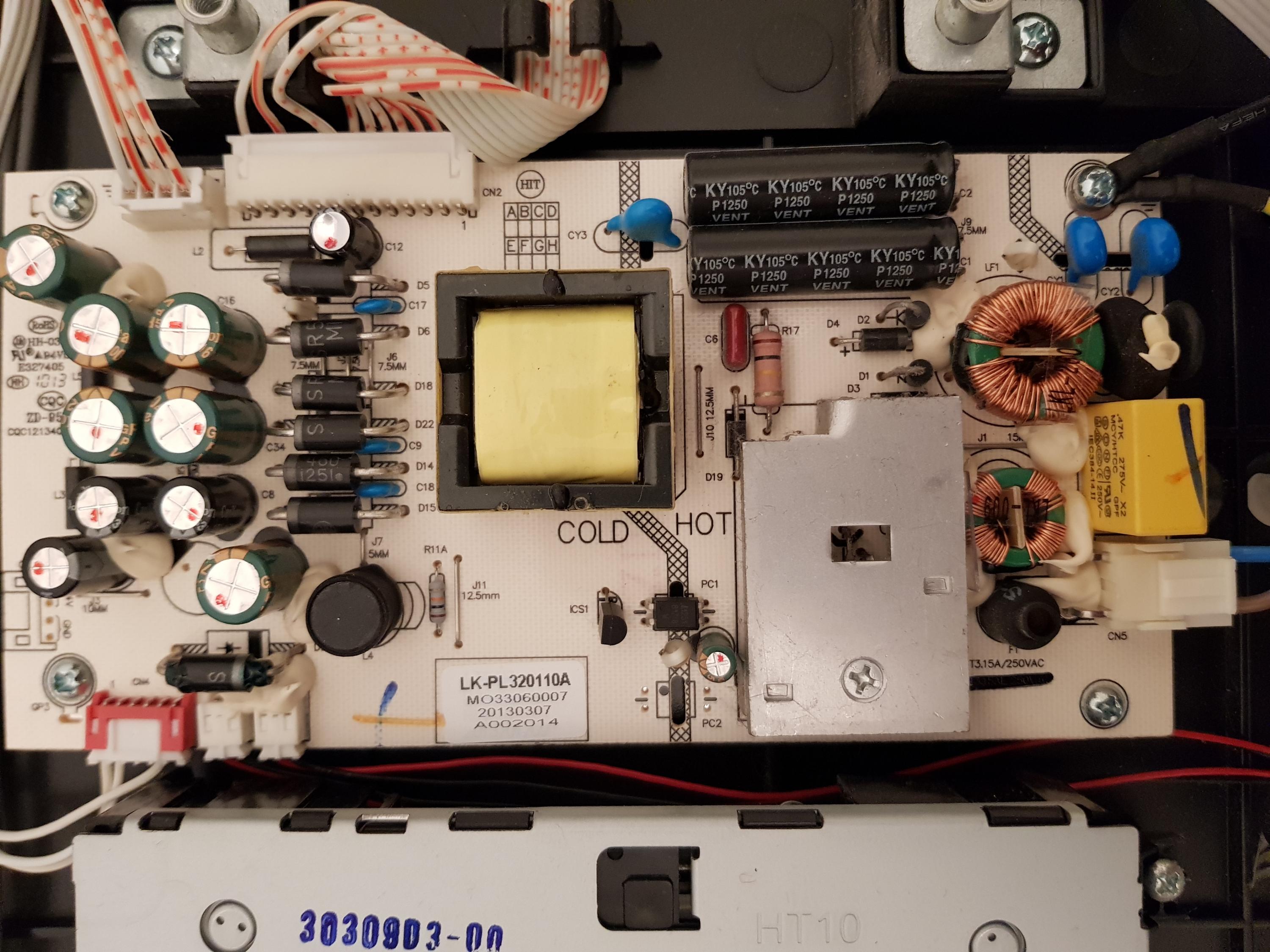

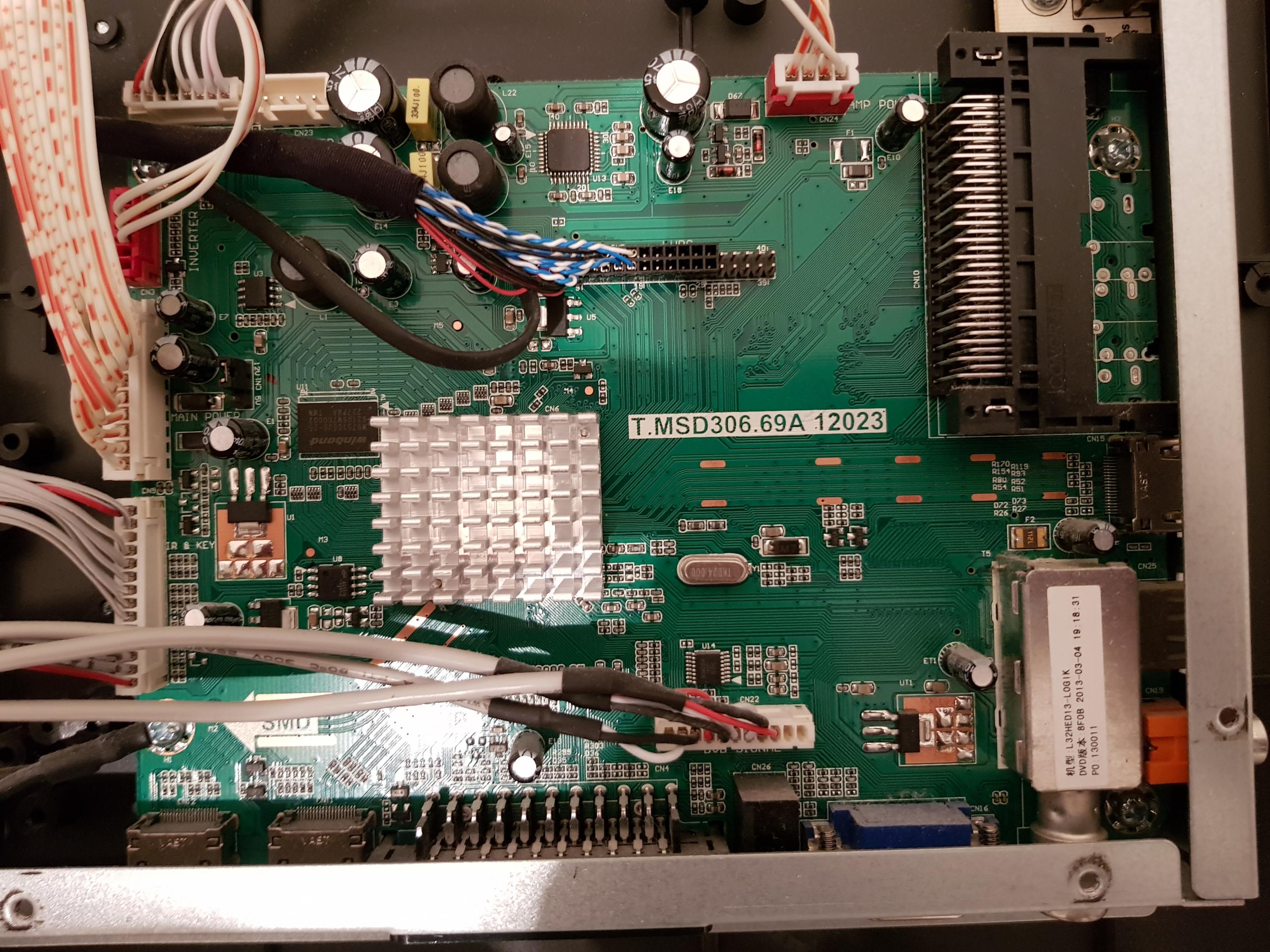

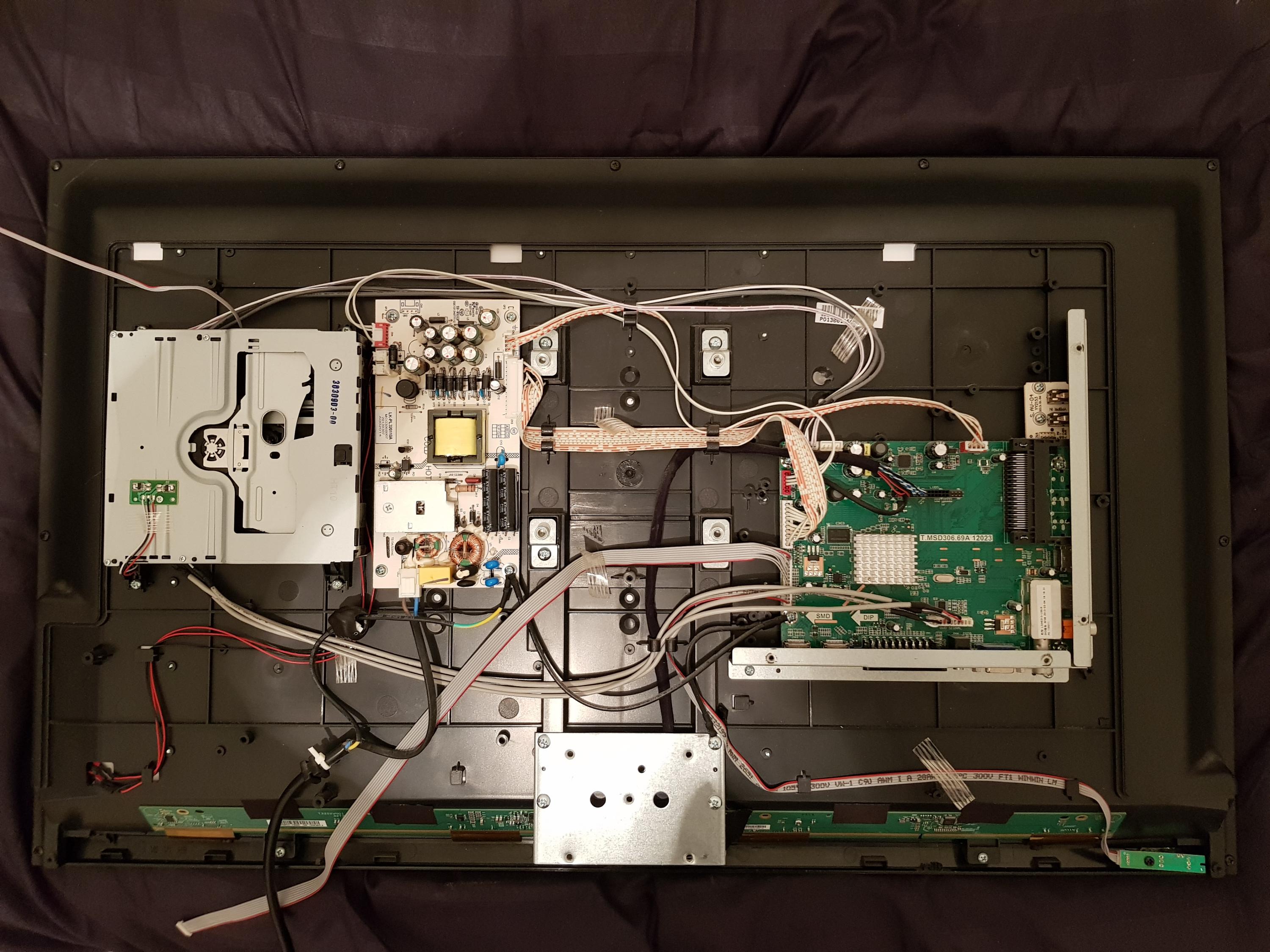

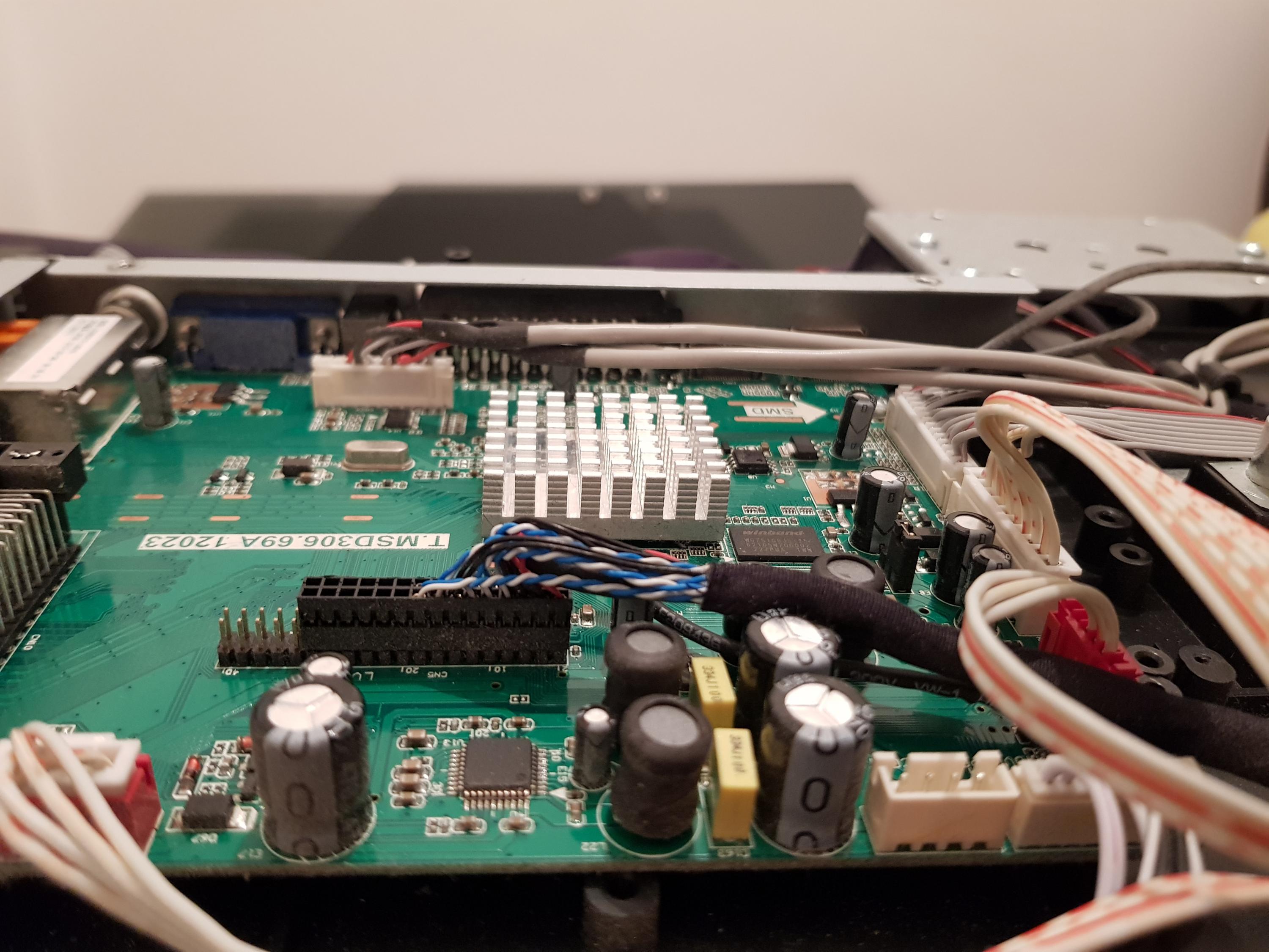

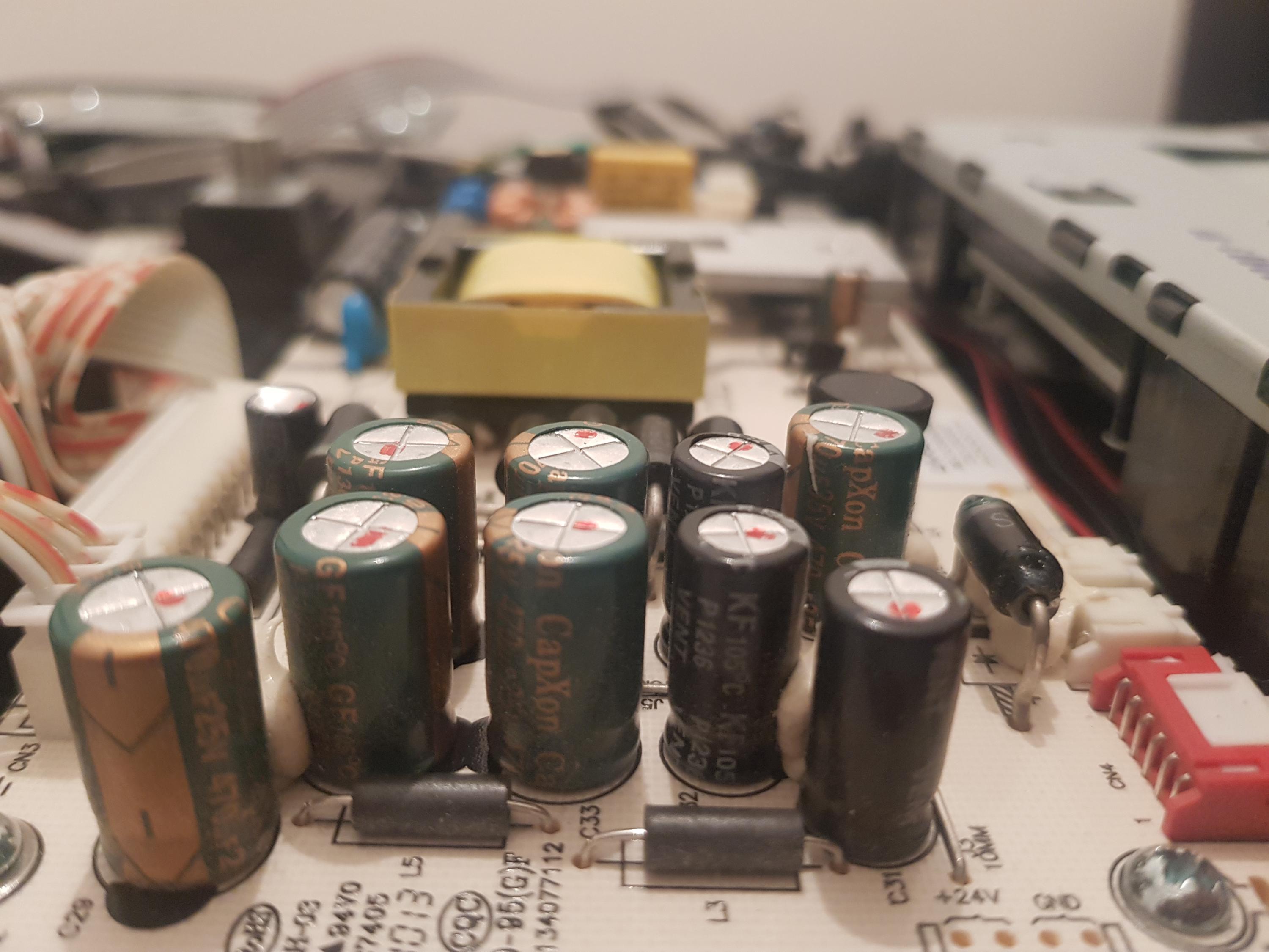

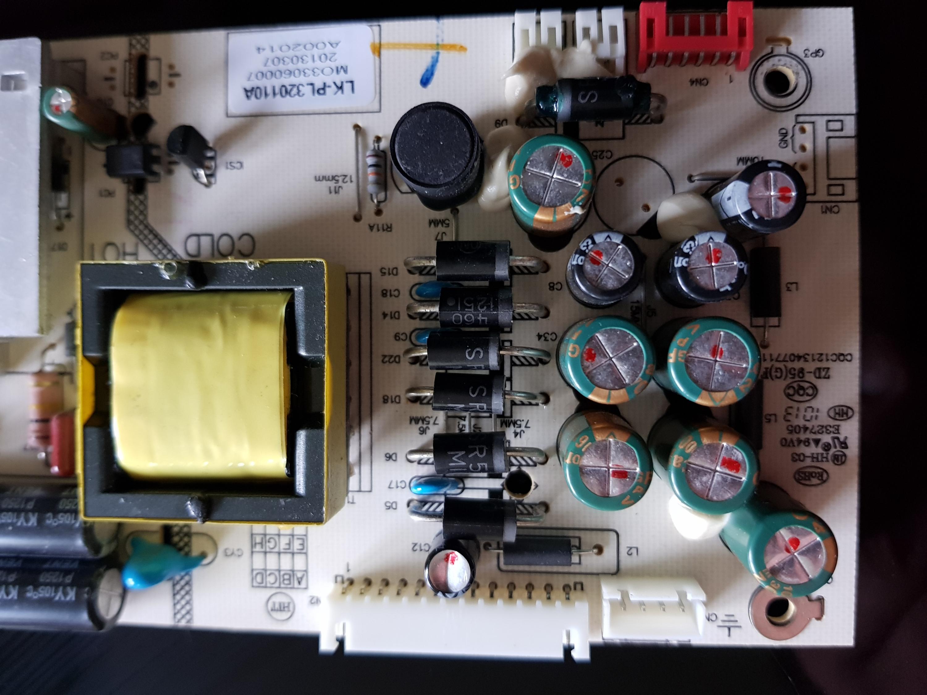

LOGIK L32HED13 LED TV Intermittent wont turn on
  • Bloopeta
    • Jun 2018
    • 526
    • United Kingdom
    LOGIK L32HED13 LED TV Intermittent wont turn on
    LOGIK L32HED13, turns on and works fine most of the time, but im told every now and then, it wont switch on.
    Is C25 on the PCB meant to look like that? Or could that perhaps be the problem?
  • nomoresonys
    • Jan 2013
    • 12212
    • U.S.
    Re: LOGIK L32HED13 LED TV Intermittent wont turn on
    Yes, that seems like the symptom of a marginal/bad/weak capacitor, that cap does look unusual, I haven't seen any that were not flat on top, that were good that is.
    • Bloopeta
      • Jun 2018
      • 526
      • United Kingdom
      Re: LOGIK L32HED13 LED TV Intermittent wont turn on
      C12 looks a bit strange too, but as in the top os indented, is this normal??
      • nomoresonys
        • Jan 2013
        • 12212
        • U.S.
        Re: LOGIK L32HED13 LED TV Intermittent wont turn on
        That one looks pretty strange to me for sure.
        • nomoresonys
          • Jan 2013
          • 12212
          • U.S.
          Re: LOGIK L32HED13 LED TV Intermittent wont turn on
          Wonder if those cheap esr meters are any good on ebay.
          • diif
            • Feb 2014
            • 6978
            • England
            Re: LOGIK L32HED13 LED TV Intermittent wont turn on
            Originally posted by Bloopeta
            LOGIK L32HED13, turns on and works fine most of the time, but im told every now and then, it wont switch on.
            Is C25 on the PCB meant to look like that? Or could that perhaps be the problem?
            C25 is for the missing capacitor above, that's D9 and a diode. What is the value of the small green capacitor in photo 3 at the bottom of the PCB under the word HOT. ?
            Originally posted by Bloopeta
            C12 looks a bit strange too, but as in the top os indented, is this normal??
            It does look a little funky on the top.
            Wonder if those cheap esr meters are any good on ebay.
            Having compared the readings to my Peak ESR70, yes they are. They also have the added bonus of measuring mosfets and resistors and are significantly cheaper.
            • nomoresonys
              • Jan 2013
              • 12212
              • U.S.
              Re: LOGIK L32HED13 LED TV Intermittent wont turn on
              Lots to choose from: https://www.ebay.co.uk/sch/i.html?_f...sacat=0&_sop=2
              • R_J
                • Jun 2012
                • 9579
                Re: LOGIK L32HED13 LED TV Intermittent wont turn on
                I would remove the power supply board and inspect the solder connections espectially on the transformer pins etc.
                • Bloopeta
                  • Jun 2018
                  • 526
                  • United Kingdom
                  Re: LOGIK L32HED13 LED TV Intermittent wont turn on
                  Originally posted by diif
                  C25 is for the missing capacitor above, that's D9 and a diode. What is the value of the small green capacitor in photo 3 at the bottom of the PCB under the word HOT. ?
                  It does look a little funky on the top.
                  Having compared the readings to my Peak ESR70, yes they are. They also have the added bonus of measuring mosfets and resistors and are significantly cheaper.
                  Sorry my bad, eyes arent what they use to be lol, I did mean D9, is it meant to look that messy?? Lol
                  The small green capacitor you mention under the word HOT is number C10, and is a 22uf 50v 105 degrees celcius
                  That C12 is badly dented in on the top, I dont know if its been psysically damaged in the past of TV has been opened up before somehow or what, as I dont understamd how it could look like this?? I thought bad caps domed and bulged, not sank in lol
                  • Bloopeta
                    • Jun 2018
                    • 526
                    • United Kingdom
                    Re: LOGIK L32HED13 LED TV Intermittent wont turn on
                    Originally posted by diif
                    What is the value of the small green capacitor in photo 3 at the bottom of the PCB under the word HOT.
                    Unfortunately I dont have any way of testing capacitors, I only have a basic DMM and dont think I can do anything regarding capacitors with it.
                    I have attached a pic of the one I have
                    • Bloopeta
                      • Jun 2018
                      • 526
                      • United Kingdom
                      Re: LOGIK L32HED13 LED TV Intermittent wont turn on
                      Wonder if those cheap esr meters are any good on ebay.
                      some on there are very cheap, would be worth picking one up of they are any good definately
                      • nomoresonys
                        • Jan 2013
                        • 12212
                        • U.S.
                        Re: LOGIK L32HED13 LED TV Intermittent wont turn on
                        That first one has a good price, maybe some members here have it and can advise, might be some reviews on amazon or someplace.
                        Last edited by nomoresonys; 11-20-2019, 05:18 AM.
                        • Bloopeta
                          • Jun 2018
                          • 526
                          • United Kingdom
                          Re: LOGIK L32HED13 LED TV Intermittent wont turn on
                          That first one has a good price, maybe some members here have it and can advise, might be some reviews on amazon or someplace.
                          Yeah theyre the ones I was looking at, cant go wrong for the price if they are any good
                          • diif
                            • Feb 2014
                            • 6978
                            • England
                            Re: LOGIK L32HED13 LED TV Intermittent wont turn on
                            There are plenty of posts on here about them. Anyone half serious about fixing has some way of measuring ESR. That's ignoring all of the other features of them and the fact if you buy a kit version you get the satisfaction of building your own tool. Follow the calibration instructions and the accuracy is pretty decent when compared with other more expensive meters.
                            • nomoresonys
                              • Jan 2013
                              • 12212
                              • U.S.
                              Re: LOGIK L32HED13 LED TV Intermittent wont turn on
                              Yep, nothing worse than trying to guess if a cap is ok or not.
                              • diif
                                • Feb 2014
                                • 6978
                                • England
                                Re: LOGIK L32HED13 LED TV Intermittent wont turn on
                                Yep, nothing worse than trying to guess if a cap is ok or not.
                                Why guess when meters are so cheap. Those that fix have a way to measure ESR, those that don't either don't fix or don't know about them.
                                • nomoresonys
                                  • Jan 2013
                                  • 12212
                                  • U.S.
                                  Re: LOGIK L32HED13 LED TV Intermittent wont turn on
                                  Indeed, it's cheap enough to have around even if you very seldom need to fix any electronics, plus it's small.
                                  Last edited by nomoresonys; 11-20-2019, 08:01 AM.
                                  • Bloopeta
                                    • Jun 2018
                                    • 526
                                    • United Kingdom
                                    Re: LOGIK L32HED13 LED TV Intermittent wont turn on
                                    Originally posted by diif
                                    Why guess when meters are so cheap. Those that fix have a way to measure ESR, those that don't either don't fix or don't know about them.
                                    Indeed, it's cheap enough to have around even if you very seldom need to fix any electronics, plus it's small.
                                    I have ordered one up, I had no idea they were so cheap until now
                                    Last edited by Bloopeta; 11-20-2019, 09:07 AM.
                                    • Bloopeta
                                      • Jun 2018
                                      • 526
                                      • United Kingdom
                                      Re: LOGIK L32HED13 LED TV Intermittent wont turn on
                                      Originally posted by R_J
                                      I would remove the power supply board and inspect the solder connections espectially on the transformer pins etc.
                                      Have removed and inspected the rear, would appear 2 diodes have been replaced before.
                                      C8 can be wiggled quite a bit, but doesnt show on solder connection on rear of board
                                      • nomoresonys
                                        • Jan 2013
                                        • 12212
                                        • U.S.
                                        Re: LOGIK L32HED13 LED TV Intermittent wont turn on
                                        Looks like you have some bad solder joints, look by R57, can check youtube for how bad/cold solder joints look, sometimes they look good but are not, can also look very closely at the resistors from the bottom, sometimes there just a tiny pinhole in m that's hard to see.
                                        Last edited by nomoresonys; 11-20-2019, 10:03 AM.
                                        • pajdek
                                          Lenovo Y700-17ISK turn on and off
                                          by pajdek
                                          Hello, i have some issues with my laptop Lenovo Y700-17ISK (motherboard BY511 NM-A541), it started when i turn on the laptop, but the lcd wont turn on, i then connected it via hdmi to tv and screen was ok. So i thought maybe lcd stripe is faulty, i removed the bottom cover, disconnected main battery, reset the cmos by disconnecting battery for 1 min, then slighty move the lcd stripe. Conncted power supply and tuned on my laptop, the lcd turn on, it started to load os, then it turn off, after a second it turn on, then after like 3 seconds turn off again, and so on. Removed power supply, waited...
                                          09-20-2023, 02:49 AM
                                        • fixme2024
                                          Intermittent Power Issue with HP DV6 Motherboard Occasional Failure to Turn On
                                          by fixme2024
                                          Hello everyone, I have an HP DV6 DAOLX6MB6F2 REV: F motherboard. The issue I'm facing is that sometimes the motherboard doesn't turn on. I've checked the voltages for the power on button panel, and they seem to be okay. Right now, it's working perfectly fine, so I can't pinpoint the exact problem. I have the HP DV6-DV7 Quanta LX6_7 (Liverpool) DAOLX6MB6F2 Rev 1A.pdf schematics, a multimeter, and a 5A power supply. If anyone could guide me on where to start checking first, I would greatly appreciate it. This is my first experience with this. Thank you.
                                          Here, I have attached a document...
                                          02-14-2024, 09:24 PM
                                        • RdeveLabs
                                          MSI GF63 THIN 11UCX (MS-16R6) LAPTOP WON'T TURN ON AFTER RESTARTING
                                          by RdeveLabs
                                          To all the members here...
                                          Let me tell you a little bit about what happened to my laptop (MSI GF63 THIN 11UCX model: MS-16R6) that “maybe” you know how to solve this problem.
                                          So before this problem happened, my laptop was running smoothly. When I wanted to restart my laptop, it looked fine at first. But after I waited for this restart process to take a long time, until finally I panicked (because the restart process did not finish plus the laptop screen only showed a black screen), I immediately pressed and held the power button to force the laptop to turn off. But...
                                          05-05-2025, 04:59 AM
                                        • robante15
                                          Acer Aspire 4520 won't turn on after reboot
                                          by robante15
                                          Hello, I have an Acer Aspire 4520 from a couple of decades ago and I want to repair it solely for nostalgia.
                                          It happens that when I turn it on after having been disconnected for a long time, it turns on without problems, it tells me that the BIOS has been reset and that it will load the factory settings, if I tell it to continue, the computer turns on and everything works fine.
                                          The moment I turn it off and want to turn it back on a second time, or restart it and try to start it again, it no longer gives an image, and it no longer responds.
                                          If I remove the...
                                          04-06-2024, 06:50 PM
                                        • masoksian
                                          Dell latitude e7470 not turn on .power buton on off and Run Power problem
                                          by masoksian
                                          Hi everyone,
                                          I am dealing with the problem of turning on and off my Dell e7470 notebook.
                                          The battery charge light is solid white, I press the button, the power indicator and the light on the button are solid for 1-2 seconds and immediately turn off.
                                          The system does not turn on, there is no post.
                                          I removed the RAMs and changed them, changed the battery, RTC battery, AC adapter, removed them and waited, tried again, it does not turn on.
                                          The problem continues in the same way.
                                          I tried to turn on the Fn key, nothing came to the screen....
                                          02-15-2025, 12:08 PM
