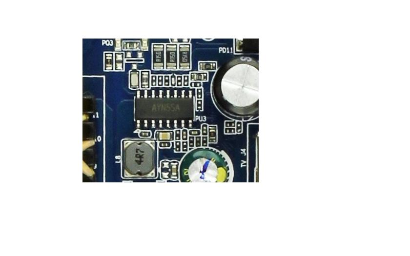

    The tv is completely dead, no standby led nothing,, measured voltage across main caps and found voltage fluctuating around the 160Vdc range..
    located 2 bad parts in the LED drive circuit,, Driver IC AYN6HB and an FET.. i can find a replacement for the FET fine, but not having any luck locating the driver IC.
    I removed both parts and used my led tester to supply voltage to the backlights but the tv will still not turn on..
    voltage on all of the regulators is 0V
    Does anyone know what a replacement driver IC would be for AYN6HB and also can give me some idea where to look for the power on issue,, can't find a schematic for this unit anywhere

    You will get more help if we can see the pictures of the board and the IC in question.

      The best I can come up with is that the Number is AYNxxx where xxx seems to be a date code and is different between ic's
      A common problem on this board is the eeprom, Are you sure the fet and ic are defective?

        So are you getting the Standby Voltage at all?
