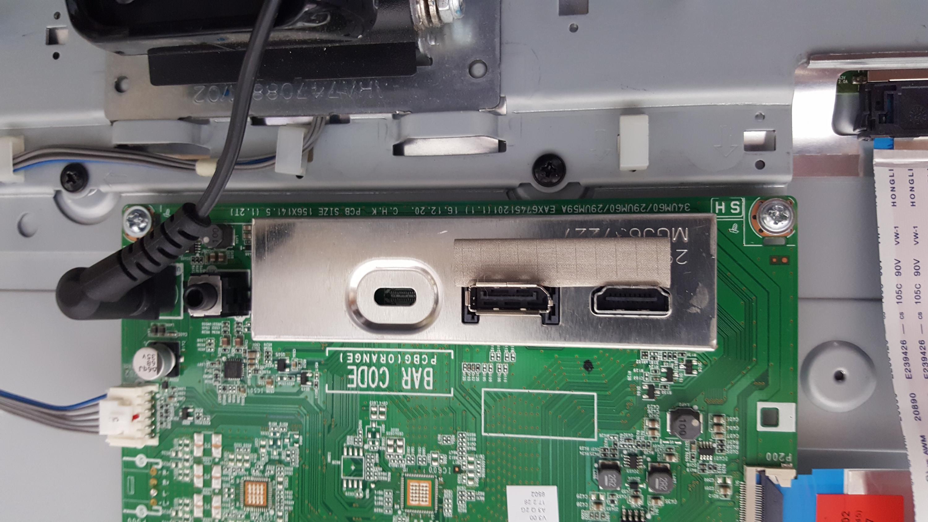

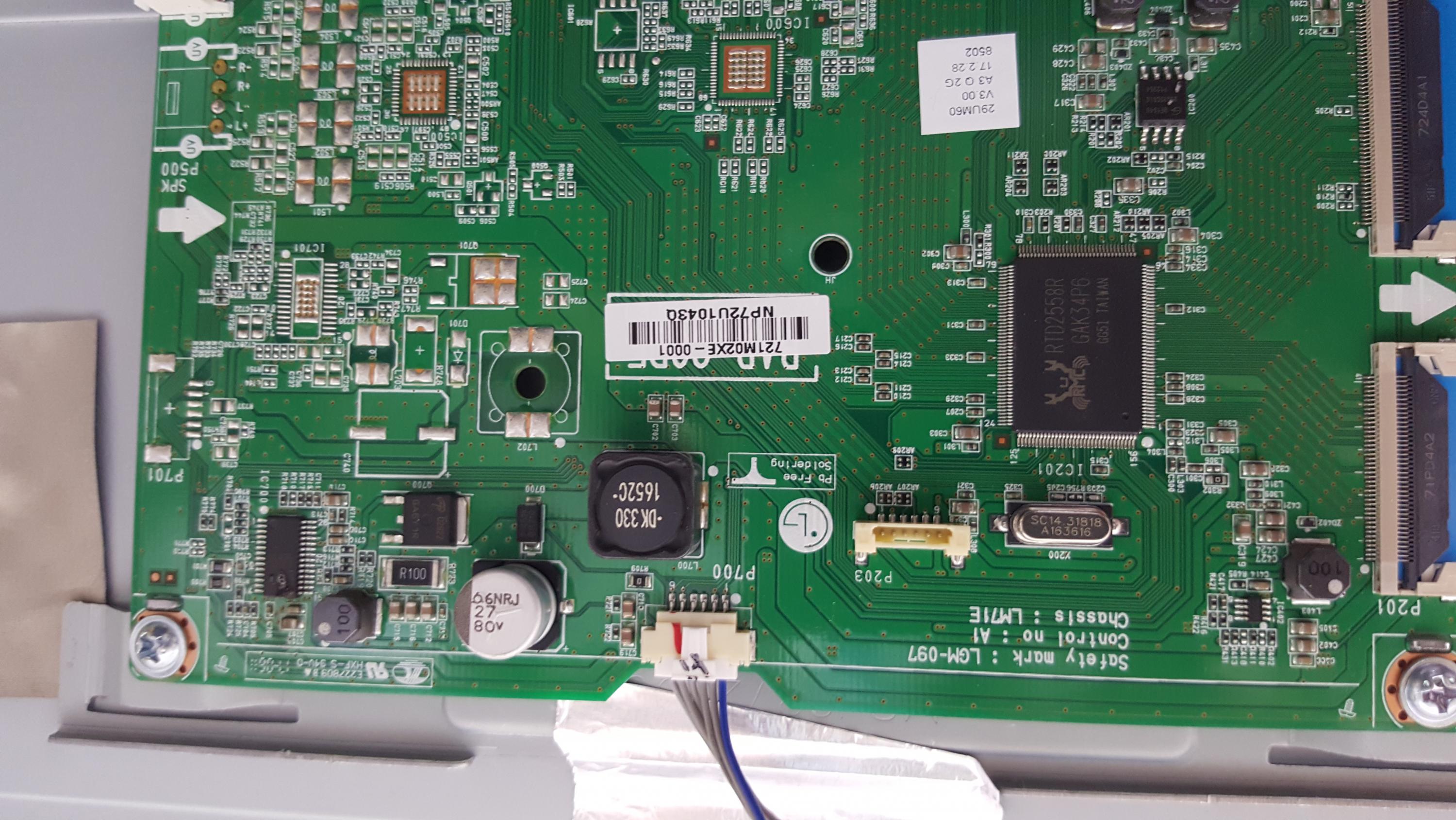

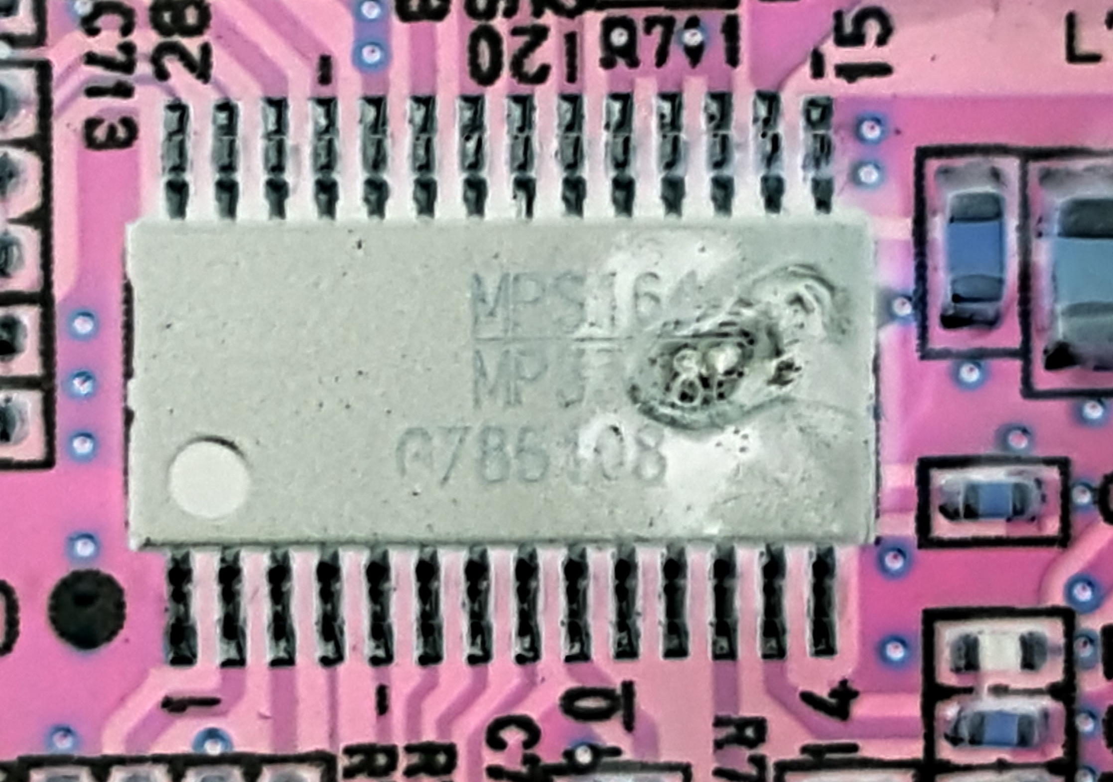

    Trying to find a compatible IC to replace the MPS6142 that is blown on the board.
    34UM60/29UM60/29UM59A EAX67451201 (1.1)
    If anyone has a datasheet for the board or the IC that would be helpful too. I'm not finding anything
    Thanks.

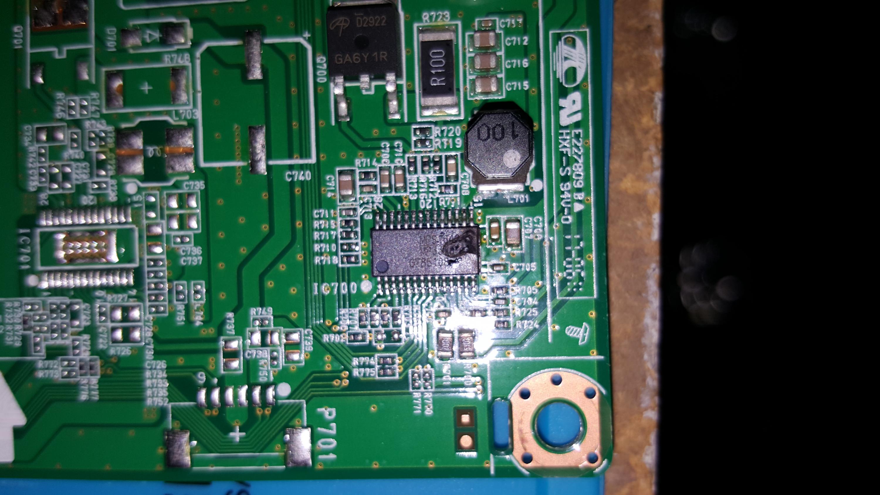

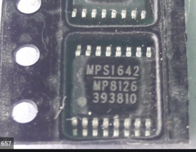

    Re: LG LM290WW2 No Display MPS6142 Blown
    It looks like MPS164?, please verify.
    MPS1642 has less pins.
    • m4a2t0t
      • Mar 2013
      • 276
      Woops it is mps1642 but mine has 14 pins per side
        I do not think your IC is MPS1642.
        Are you sure the last digit is '2'?
        How about the next line, MP33??
        • m4a2t0t
          • Mar 2013
          • 276
          what about
          https://pdf1.alldatasheet.com/datash...S/MP3378E.html
          The second number is MP33, some number, 8, and im pretty sure the last is an E. Unless there are more numbers under the scorched areas.The missing number looks like a 4 in the negative image I added to this post.
          • m4a2t0t
            • Mar 2013
            • 276
            the MP3378E worked

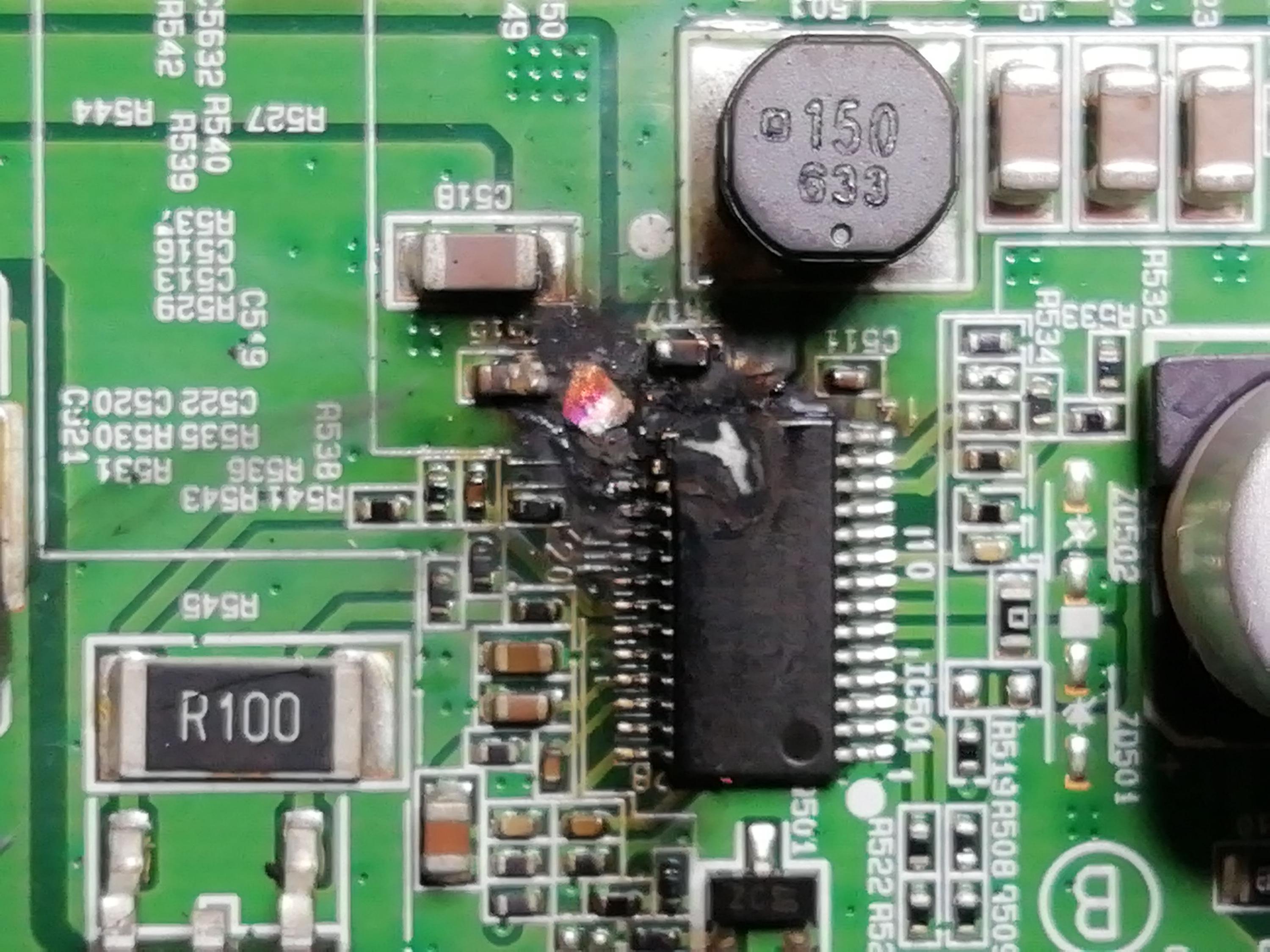

                Originally posted by m4a2t0t
                what about
                I believe that these IC's have a design flaw where they burn up in exactly the same place as in the picture above. Worse still is when they burn the tracks away and carbonise the circuit board.
                  what about
                  The one with "8E" is not compatible with the burned IC parts. Because the "8E" has 12 pins each side, while the burned IC has 14 pins each side. I have the same problem, identical with the model and burned IC. But mine shows the 3rd number which is "7". So it will be MPS337x "where X irepresents "8" or other number or maybe none.
                      Originally posted by jmillado
                      Should be MP337x
                      My Bad..i don't know how to delete my previous posts. But, I confirmed that the above claim to be COMPATIBLE (MP3378E). My apology.
                          My IC which was a 28 pin IC was an MP3378E and I have the spares in front of me.

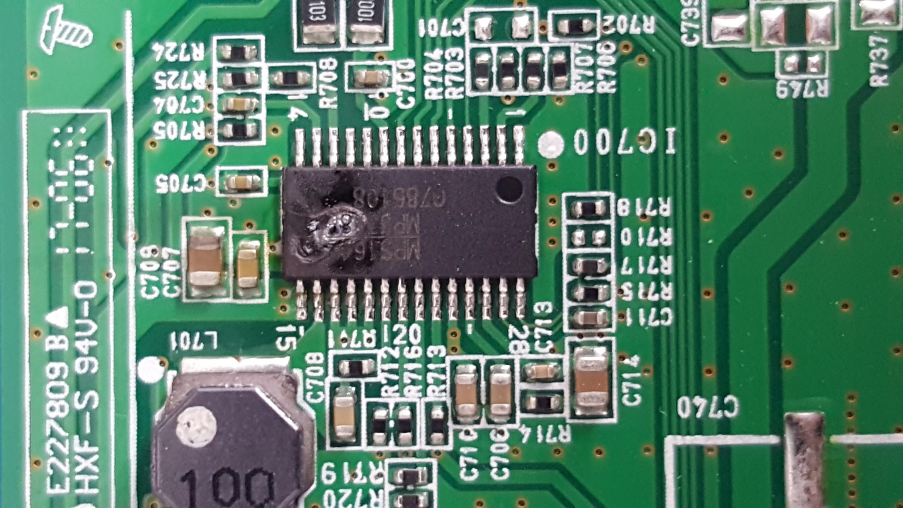

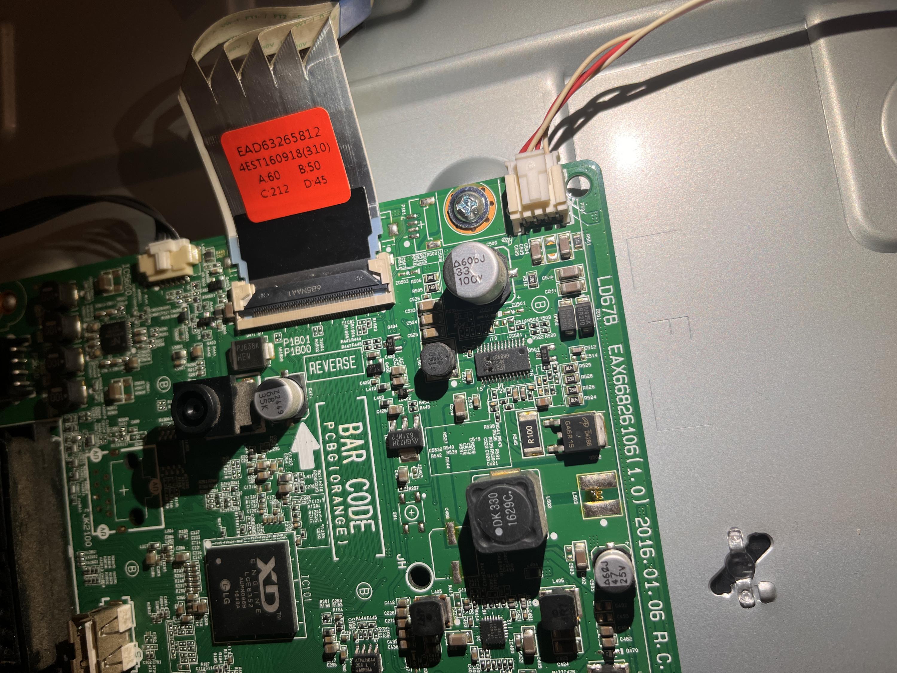

                            Hello guys, here another dealing with a blown IC501 (mps3378e) in a LG TV (49lh5100).
                            I'm attaching a pic of my main board.
                            It seems a typical failure of this chip.
                            If any had replace it, please comment experience. I will try to replace it without replacing nothing more to see if works.
                              the MP3378E worked
                              what was the symptom ? my screen has led light but no image. was your the same ?
