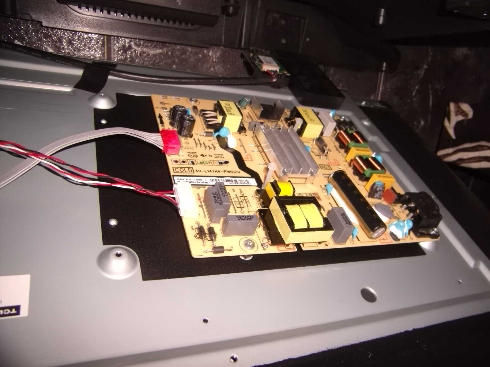

              • shelby5041
                • Feb 2009
                • 1505
                • united states of america usa
                Re: TCL 55S401 LED LCD TV no backlight
                here is stock photo of power supply
                i am trying to confirm that if the led backlight cable is not connected to the ps should i get voltage output from the ps or zero voltage at the led backlight pins?
                im trying to rule out the ps as the issue.

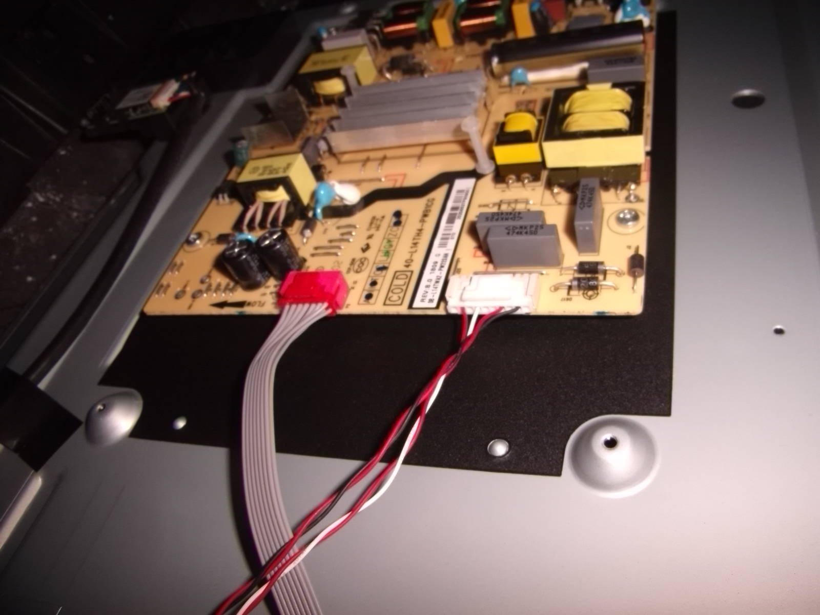

                    I need to see the pictures of the whole back side of the TV showing all the boards.
                    Right now I cannot tell how many wires are actually connected to the LED connector.
                    • shelby5041
                      • Feb 2009
                      • 1505
                      this best i can do..no space to get tv out of storage
                      i have 0voltages coming out from ps at the led backlight pins when led power cable disconnected
                      the stock photo may be wrong they have like 5 ps for this model tv..but my photos i just posted are actual photos
                        Wait a minute here, your board is not the same as the board you show from shopjimmy!
                        What is the P/N as printed on the barcode sticker?
                          sorry for the poor angles but no space here
                          yes my board is diff than the stock photo i posted earlier..i corrected myself in previous post
                            I cannot read the barcode sticker numbers.
