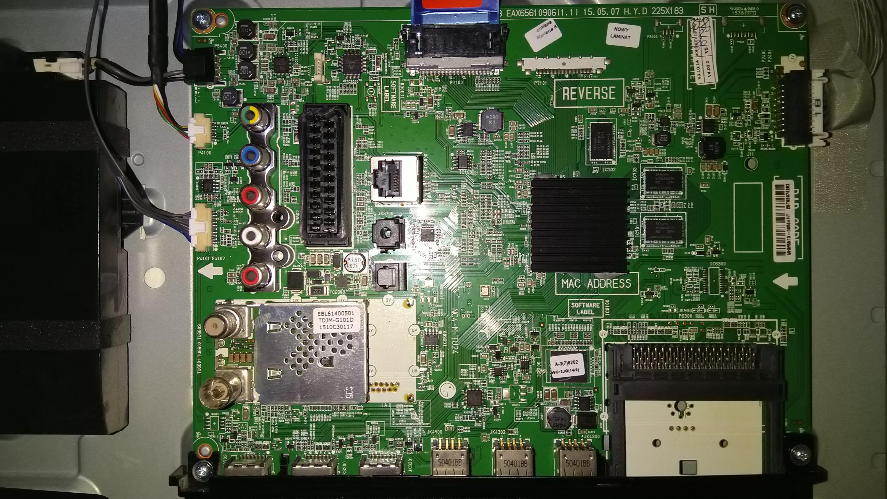

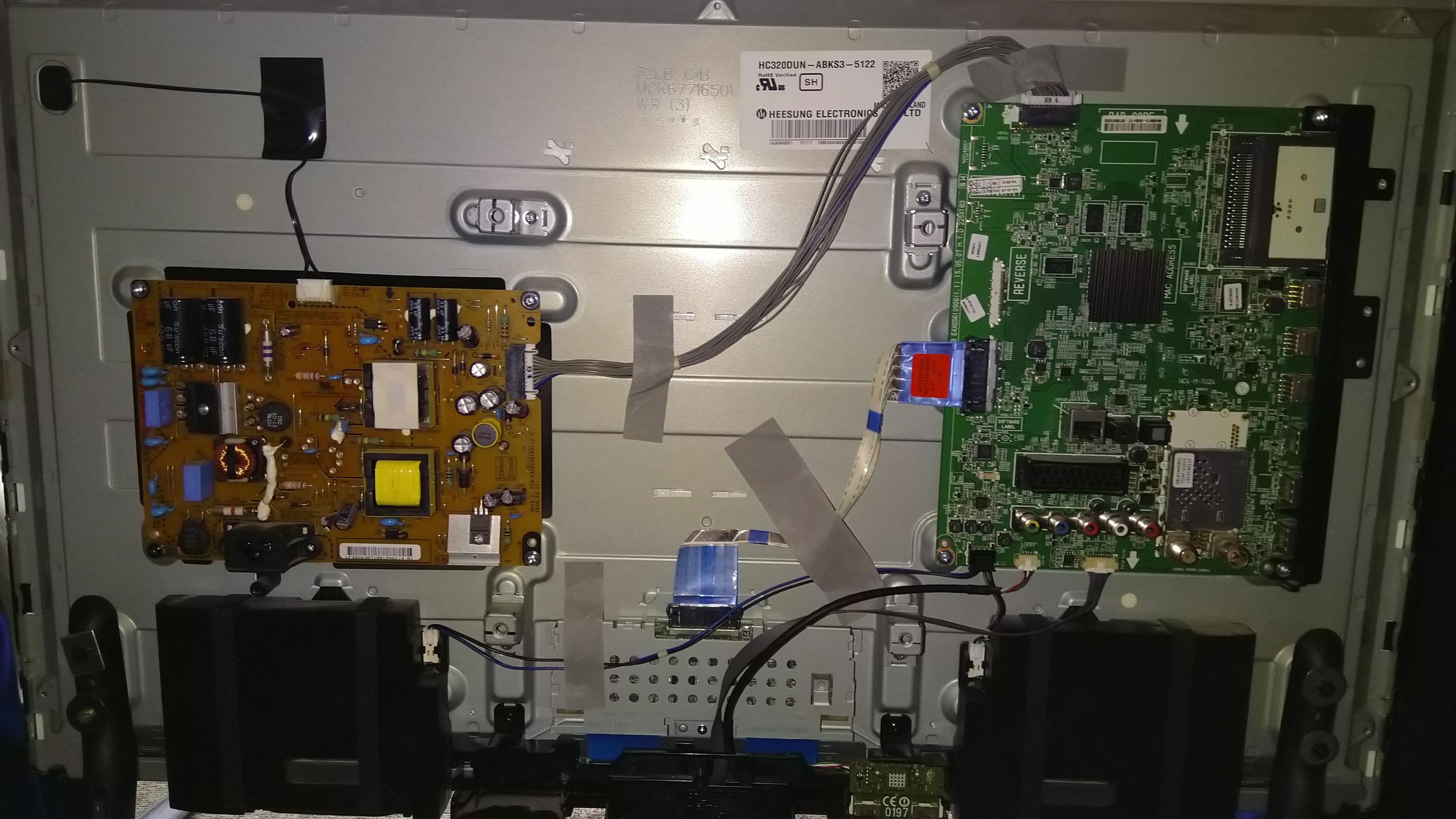

    Hi guys, hoping someone can help me with this problem. I have a LG32LF580V, the tv powers on but has no picture, when holding a torch close to the screen in a dark room the picture is then visible.

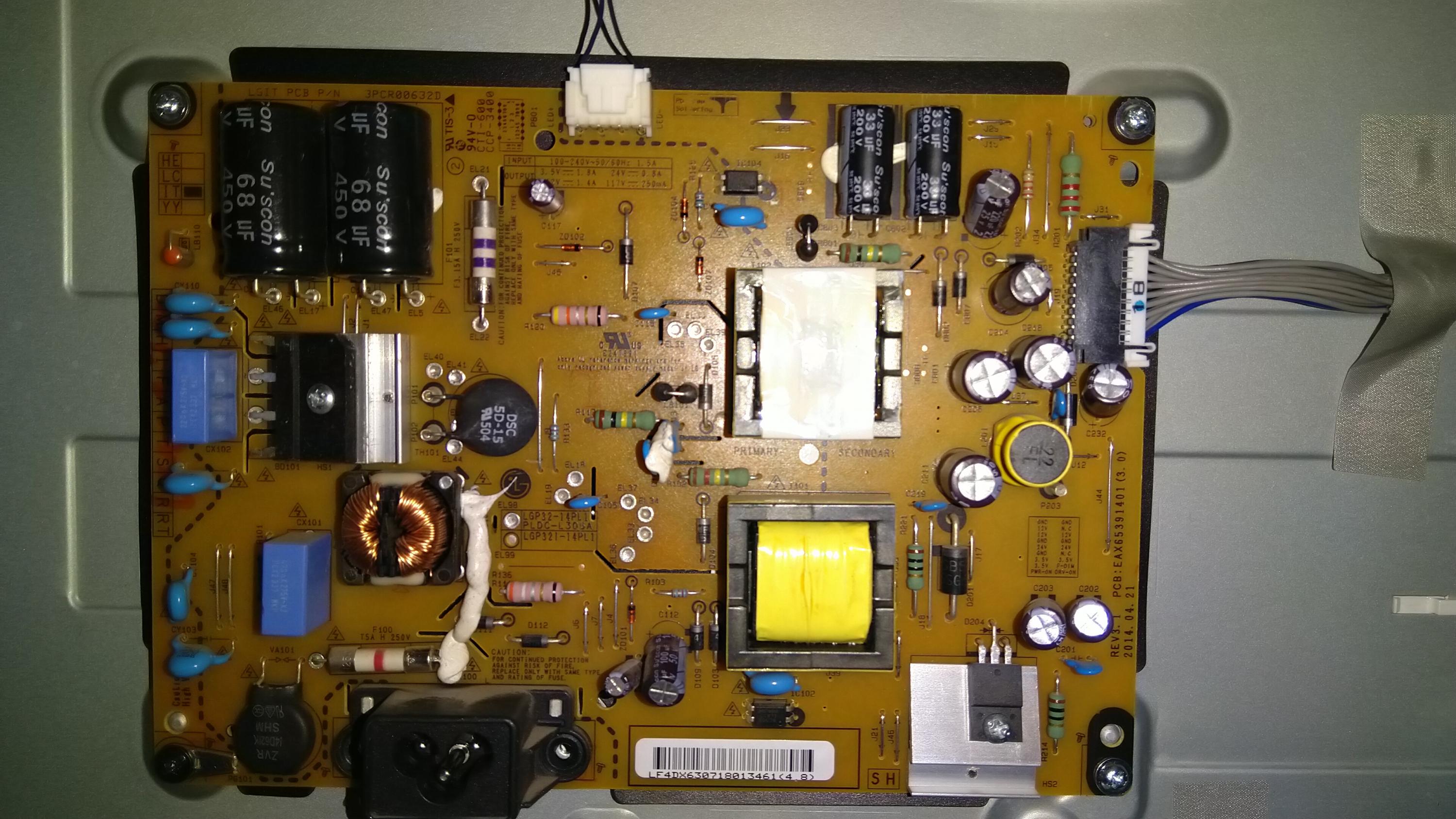

    My initial suspicion was faulty backlights, but as i have no experience replacing LEDs and also knowing that replacing LEDs is a difficult procedure to undertake i decided to blindly buy a new power supply in the hope that this will solve the issue, it did not, i had exactly the same problem with the new power supply. So here i am, looking for help, any ideas on what the issue could be? In this type of situation can it only be the backlight? Or could it be a mainboard or tcon problem?
    Pictures attached.
    All help would be much appreciated, thanks in advance.

    Re: LG 32LF580V - No picture but has sound
    I would suggest the backlights if you can see the image thru the black screen. Tv is working, just no lights. Typical LG

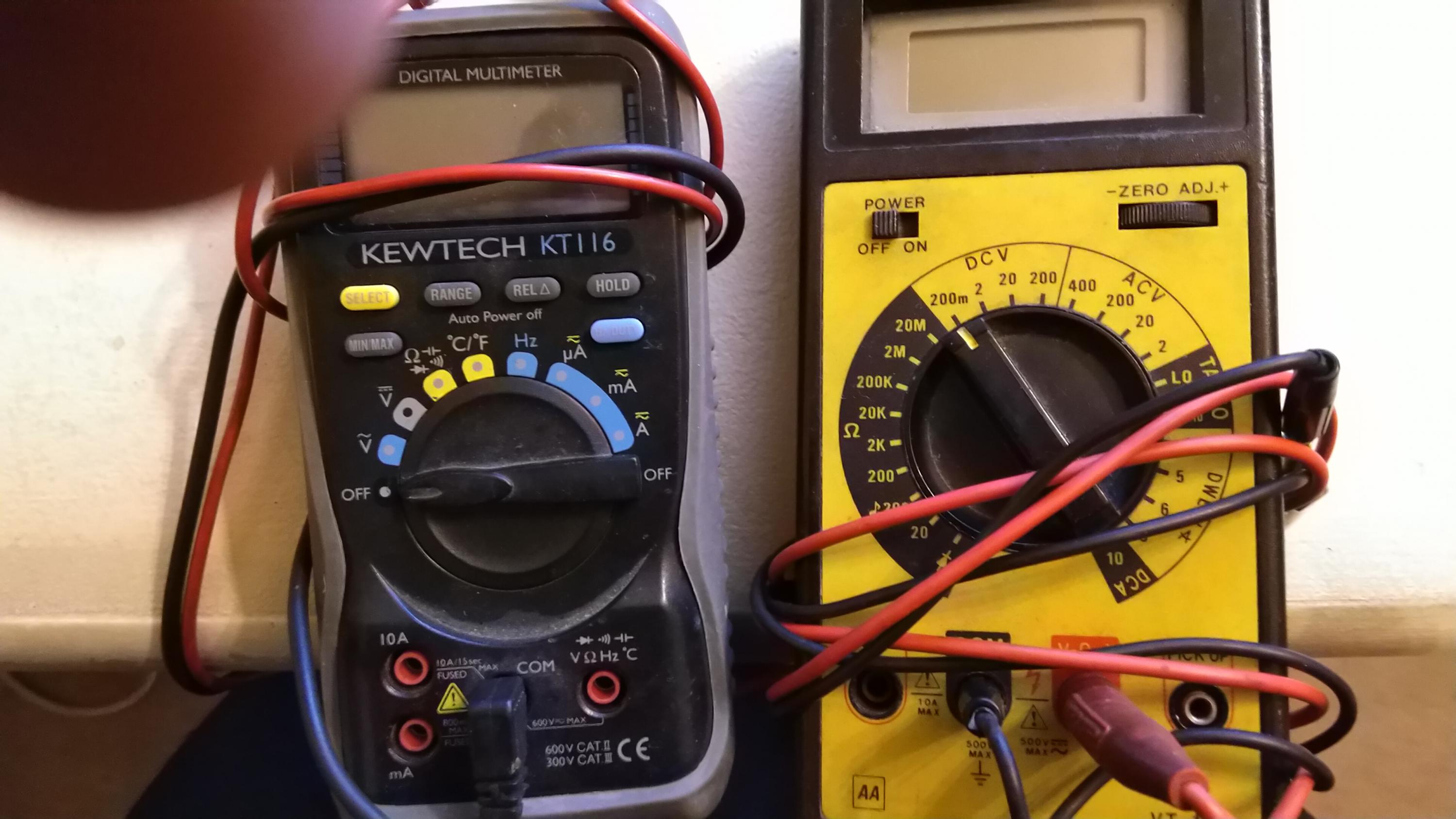

                Do you have a multimeter and do you want to do some basic testing?
                Sure, although please bare in mind i have very little experience with all this. My dad will help out as he used to fix tvs but he is retired now and the tvs he fixed were the old crt tvs, he pretty much has no experience in fixing flat screen tvs either.
                Below are the multimeters that we have available to us, will they do?

                    Edit: One last thing, where should the meter be set? 200m DCV?

                      20 vdc.
                      • donst
                        • Nov 2013
                        • 56
                        • uk
                        With the yellow meter on the right i can't seem to find 'vdc', is vdc the same as dcv?
                        • nomoresonys
                          • Jan 2013
                          • 12113
                          • U.S.
                          Yes.
