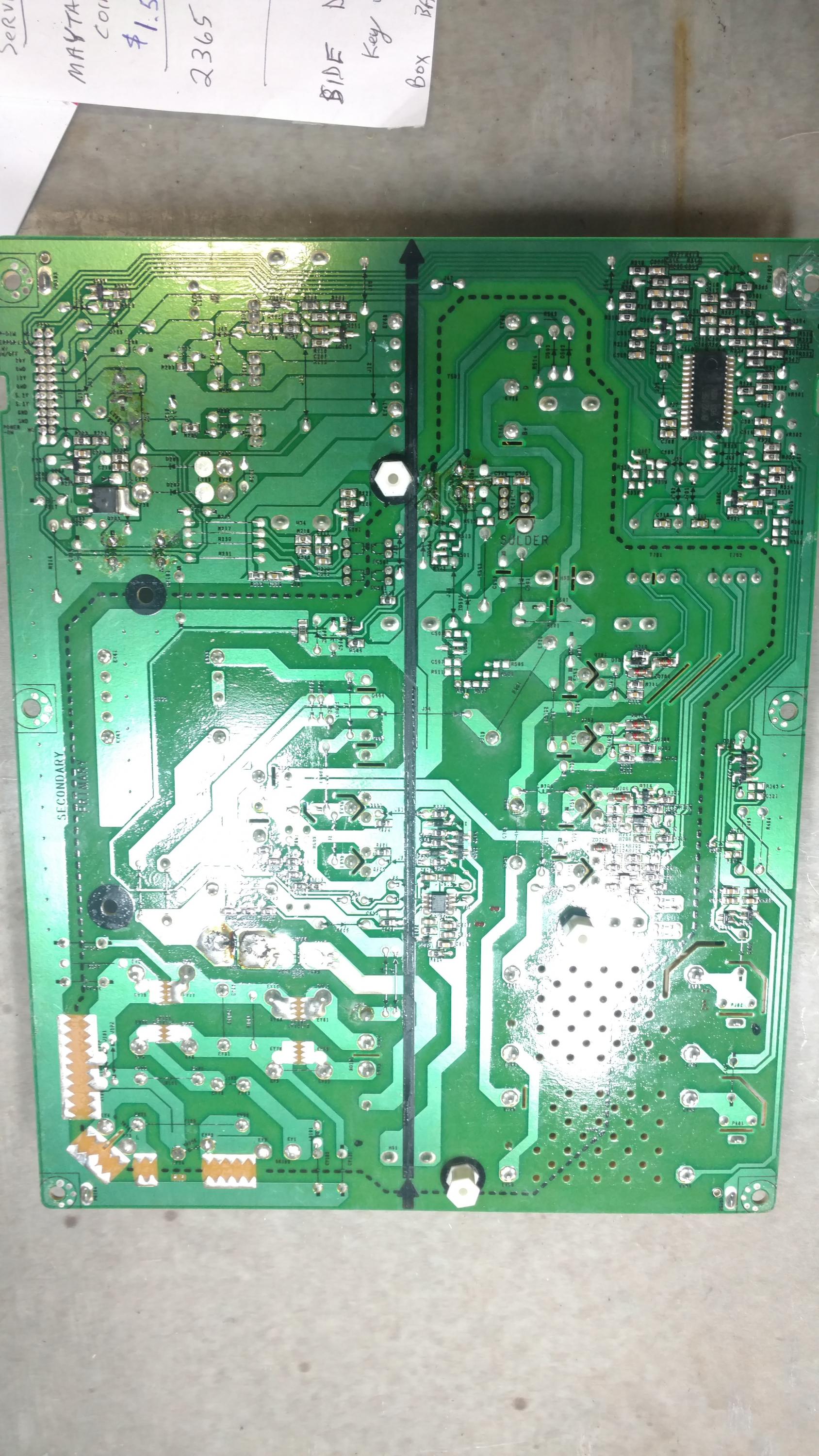

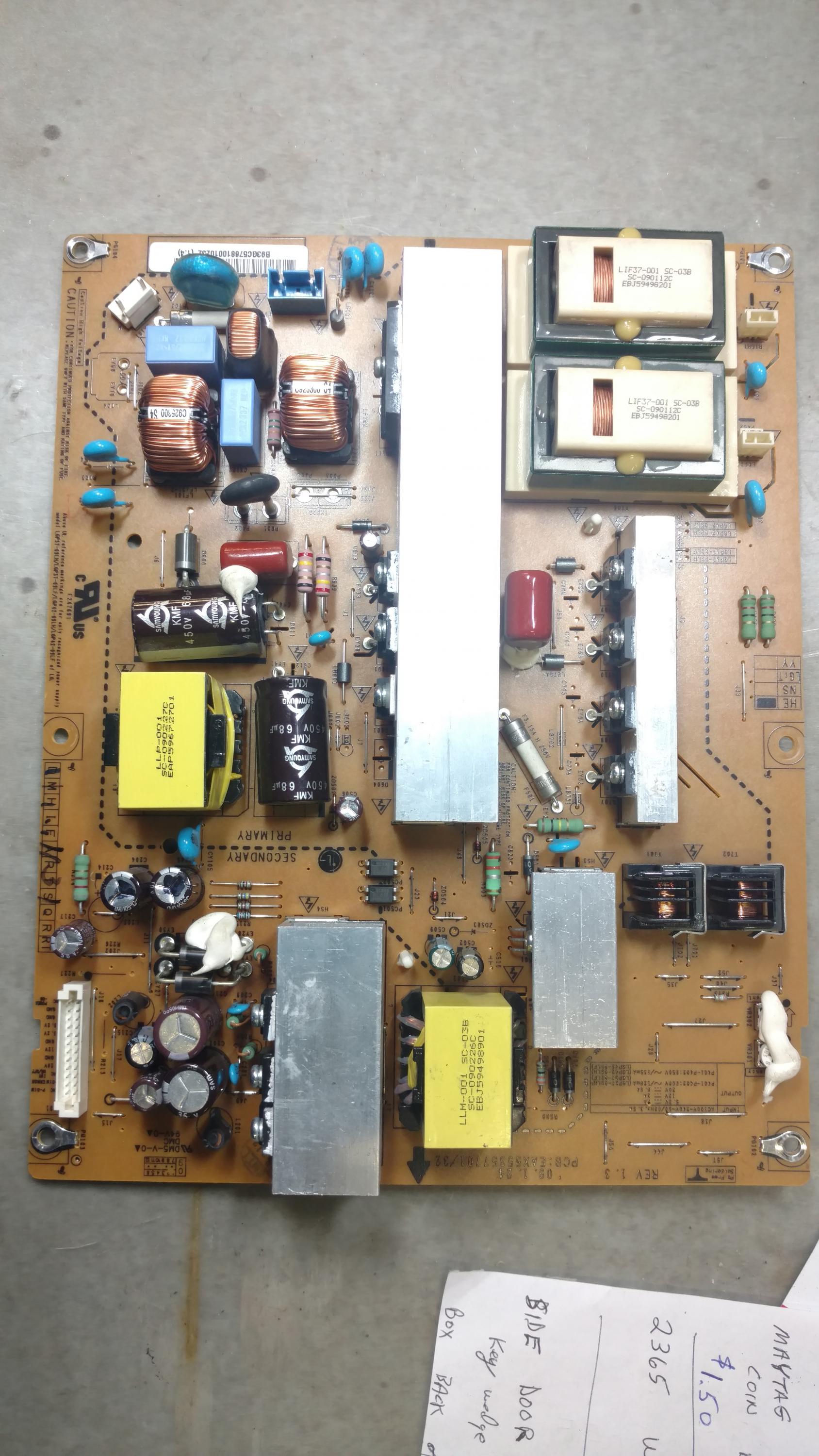

    Have a LG 37lh40 with a bad power supply EAX55357701/32 board. tv tries to light back lights but can't - cycles forever. took power board out and bench tested. has 5V, jumper pwr on to 5v and 12V good, 20V good. Have a second power board - it turns on tv - works perfectly, I have checked all caps (ESR), looked for bad solder, checked all xsistors, and no luck, anybody have any experience with these power supply boards ? thanks

            tested both boards - broken board has 162V across C611 (68UF 450V cap) with plug in. with PWR_ON HI = 385V.
            good board has 162V across C611 (68UF 450V cap) with plug in. with PWR_ON HI = 377V.
            all fuses good. seems like a bad solder joint but don't see any

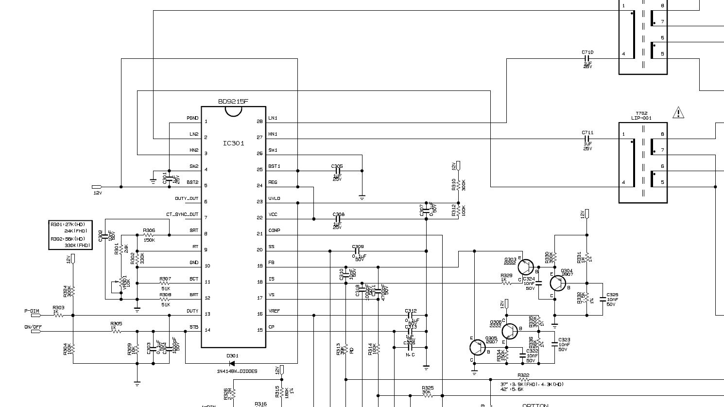

              So one board powers everything OK. The original has all the voltages when tested but doesn't light up the lamps.
              Check the On/Off voltage at pin 14 of IC301 (BD9215F) which should be 3V to enable the lamp driver circuits.

                  put small wire on ic301 pin 14 - never moves off 0 volts. I had a good ground (used GRD on main connector - P201). assume the IC301 turns on inv lights (ON/OFF) ? have bad IC301 ?

                        also - I ohmed the pin 14 to inv on/off - it is good - 1K ohms on both boards

                          The board only has one power transformer (LLM-001) to provide always on 5V Standby and the switched 12V, 20V, so you are indicating that the 12V and the 20V are not stable, so are you sure that the 5V Standby is stable since is generated by the same power transformer LLM-001 when connected back in the TV.

                                  believe I've found problem. IC201 and IC202 (AS431AN - shunt diode) seem bad - going to get new ones.

                                    local electronic store gave me lm431 as a sub. checked the diode out - don't think its compatible with as431an. looks like its configured backwards. anybody know of a acceptable sub ?

                                      installed new lm431 - to92 - made lm431 work. installed board and now have solid 5 volts. 12V and 20V come up but cycles to 0 about every 5 secs.
                                      DC voltage at F501 is 377V but cycles to 250V every 5 seconds. observing IC301 pin14 inv on/off - never goes to 3V
