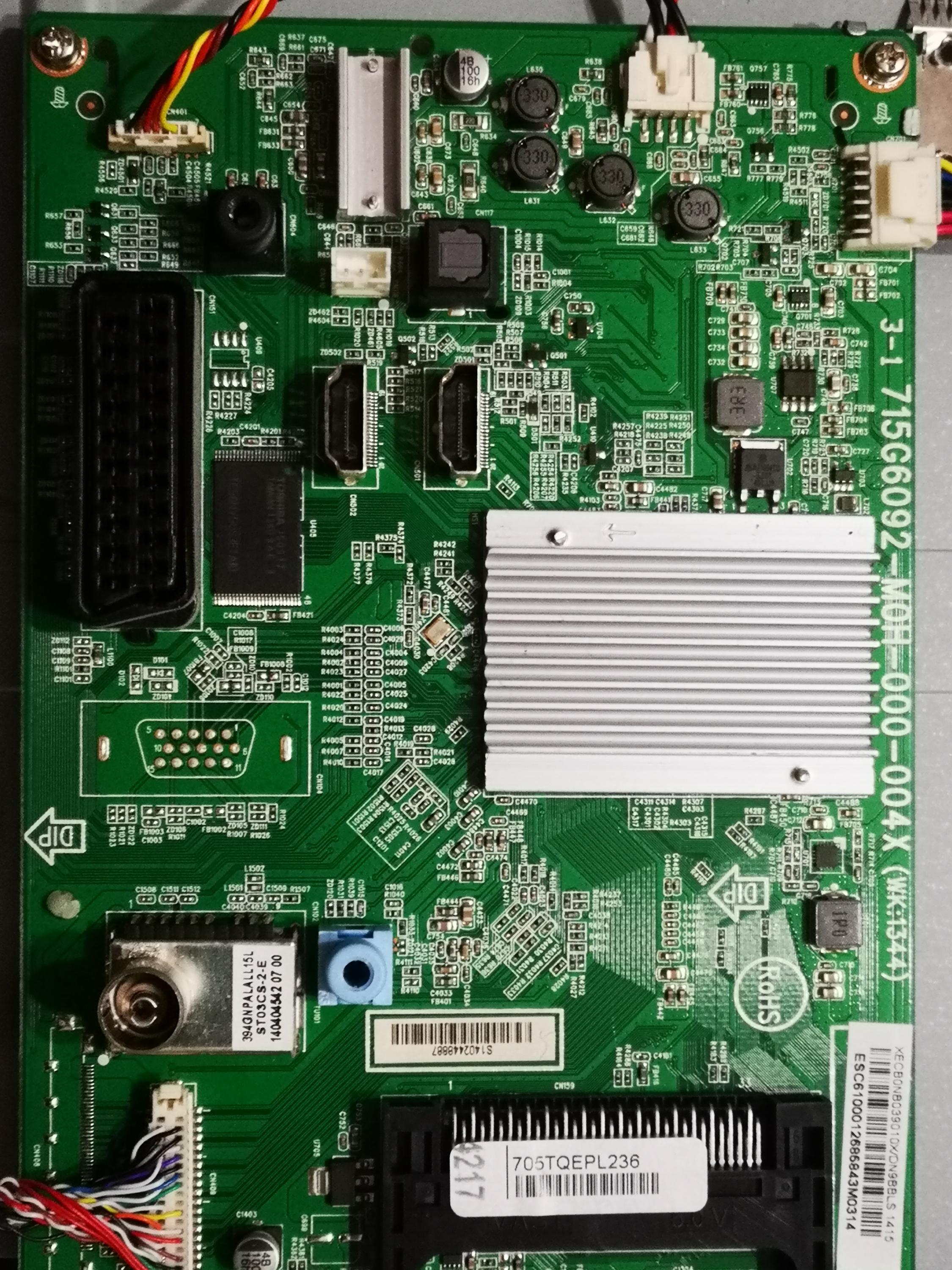

    Hi to everybody, i have a problem with the tv in title.
    The tv reboot it self when i give power to It.
    Sometimes show the Philips logo and restart, sometimes only the backlight on and off.
    There isn't Power led on.
    I opened the tv and i don't see any blow caps or burn PCB.
    I read in other discussion about an upgrade firmware with USB, i just try It without success.the TV restart before start the upgrade.
    I think that in my case Is an hardware problem, what i can check and what are the problems for you?
    Thanks to everybody

    can you post a straight shot, high resolution picture of your main board?
          This Is the main board

            Re: Philips 32pfh4309/88 restart problem
            Aaaah! I see a NAND IC (U405), where the Scart plug is. If you have a programmer like a TL866II or RT809H etc., read the NAND and save the file. Then erase the IC, followed by a blank check. Chances are there are bad blocks on that IC. Copy the content from the old NAND chip to a new NAND chip and reinstall it.
                  Turn on the TV and give it a cooling spray (freeze spray) on the nand memory.
