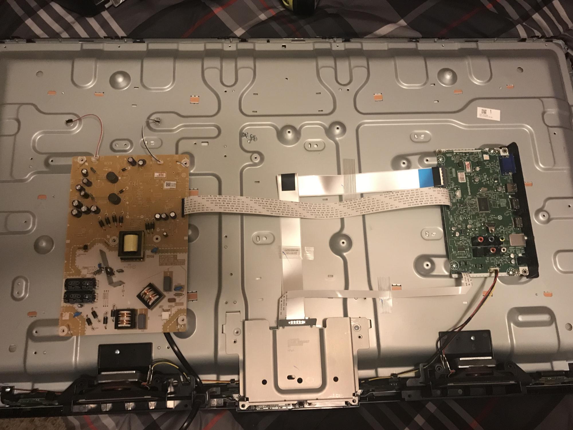

    Trying to help a coworker fix this tv.
    Does not power on, no standby light (which I'm not positive if it even has one). Testing the power coming in to the power board I do get 120v and hear a slight hum/buzz when plugging it in.

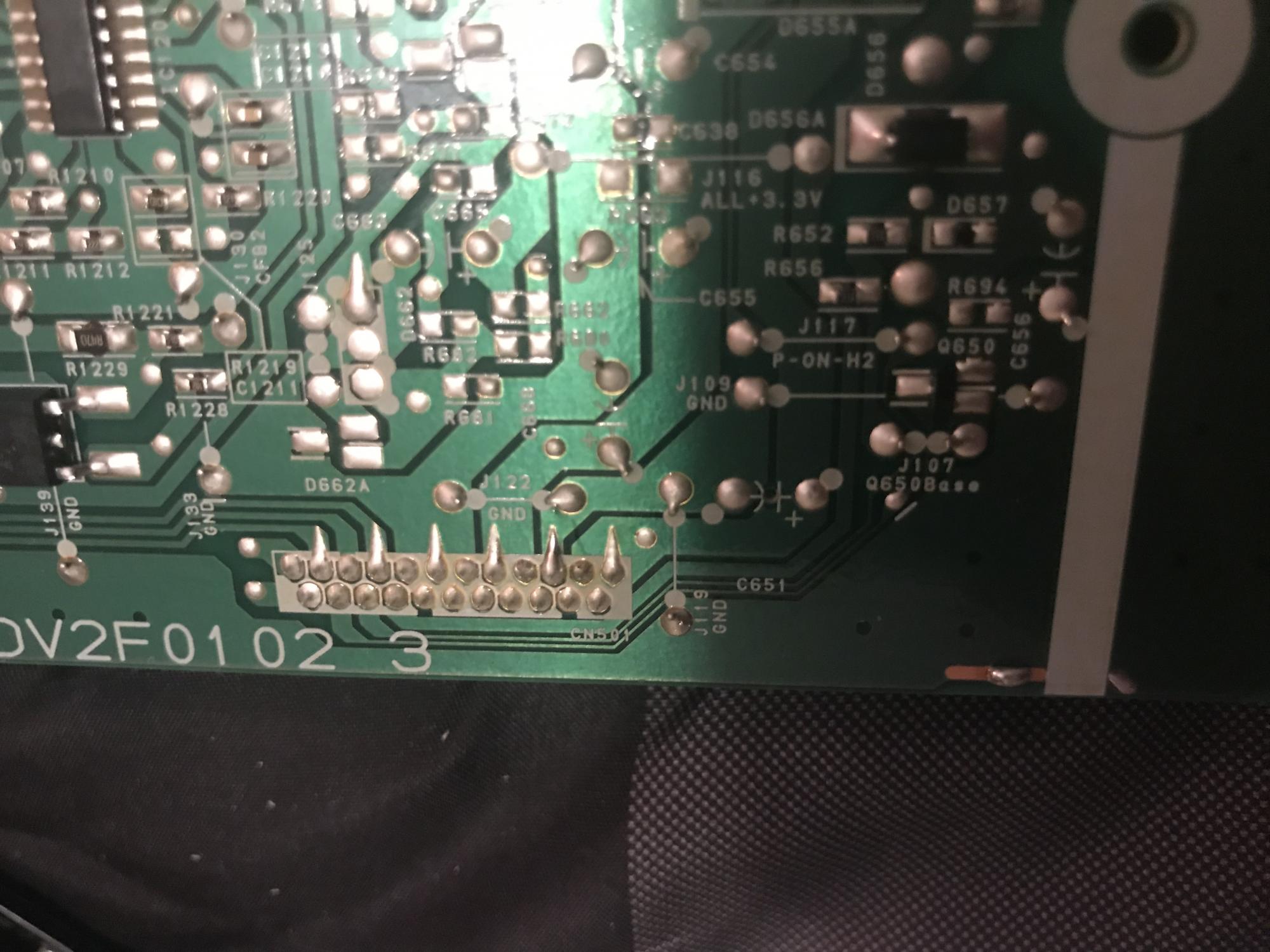

    I couldn't find a legend for the connector that goes to the video board. But when testing the pins I get (from top to bottom in pic):
    1: 0
    2: 0
    3: 0
    4: 0
    5: 0
    6: 0
    7: 0
    8: 18
    9: 18
    10: 0
    11: 0
    12: 0
    Unplugging the video board from power board garners no change.

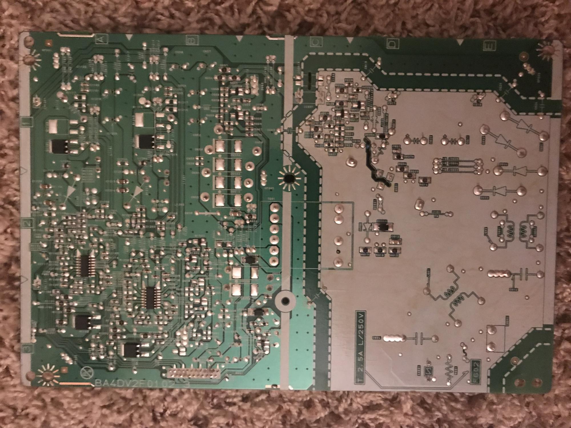

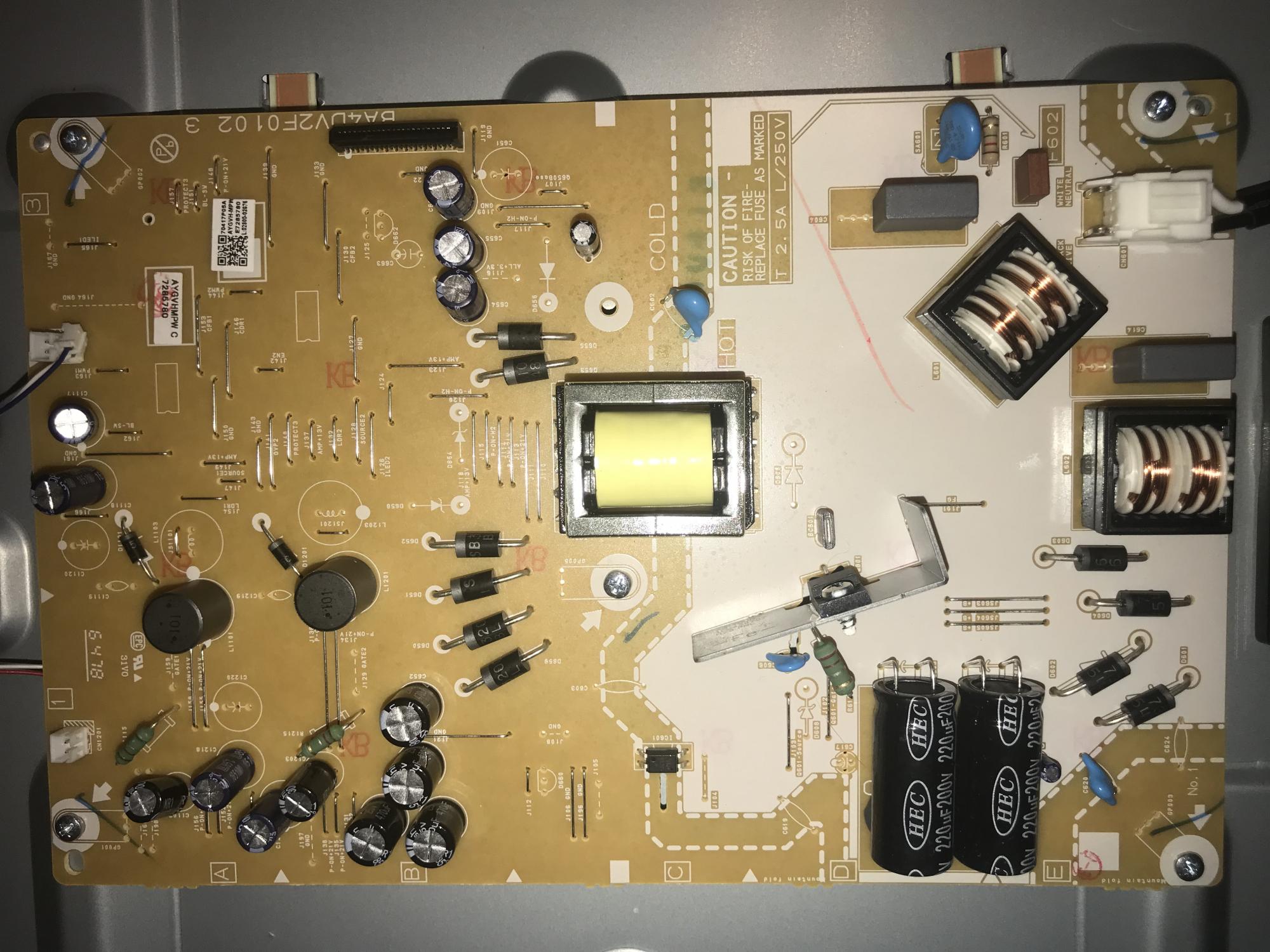

    NOTE: I did take pics of the boards while I had the cables unplugged already.
    I did also test the F602 fuse (not isolated from the board) and it ohms out good. No leaking or bulging capacitors.
    Not sure what else to check before buying a new power board.

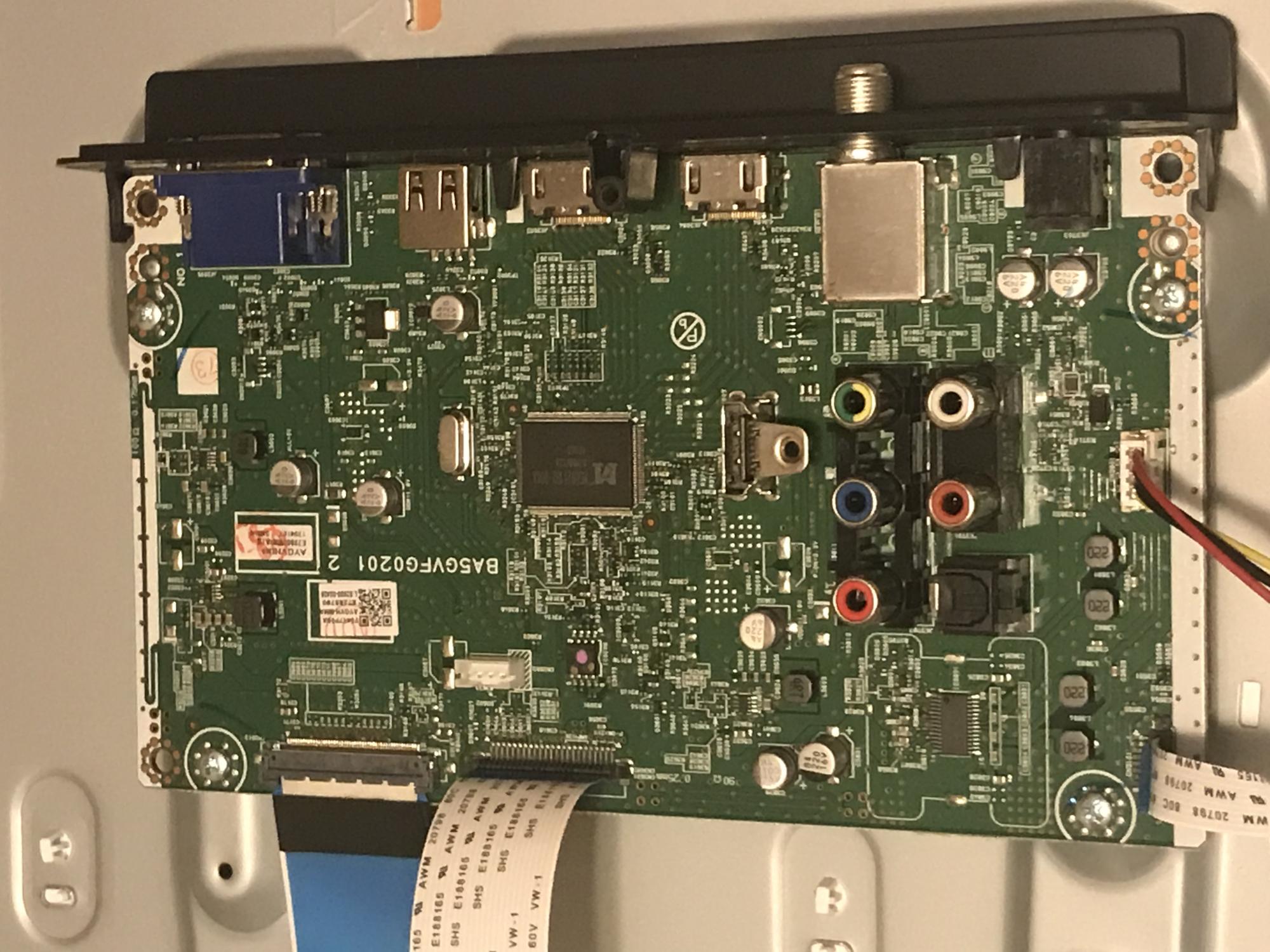

    You only checked half the pins, there are 23 pins on that connector, The fault might be a shorted cap on the main board. see this thread: https://www.badcaps.net/forum/showth...light=FW43D25F

        Check resistance between Gnd and P-ON21V jumper, Gnd and AMP+13V jumper, then check the Voltage between Gnd and P-ON21V jumper, Gnd and AMP+13V jumper. The 3.3V for running the main board is generated on the main board.

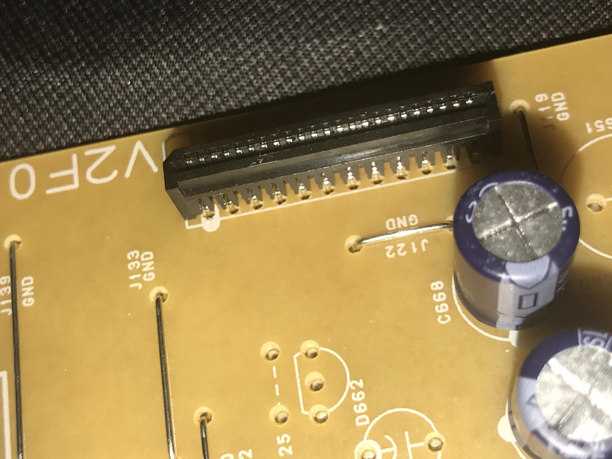

                Also testing of all 23 pins (with cable from power to main disconnected):
                1: 0
                2: 0
                3: 0
                4: 0
                5: 0
                6: 0
                7: 0
                8: 0
                9: 0
                10: 0
                11: 0
                12: 0
                13: 0
                14: 17.7
                15: 17.7
                16: 17.7
                17: 17.7
                18: 0
                19: 27.4
                21: 27.4
                22: 27.4
                23: 27.4

                  1) Your result does not make sense, you trace the board out you will see that jumper P-ON21V and AMP+13V are connected directly the connector so I cannot see how you can the Voltages on the Jumpers not the same as the connector.
                  2) What Voltages do you get on the jumpers (P-ON21V, AMP+13V) if you have all the boards connected?
                  3) D653, 655A are for AMP+13V
                  4) D650, 651, 652, 659 are for P-ON21V.
