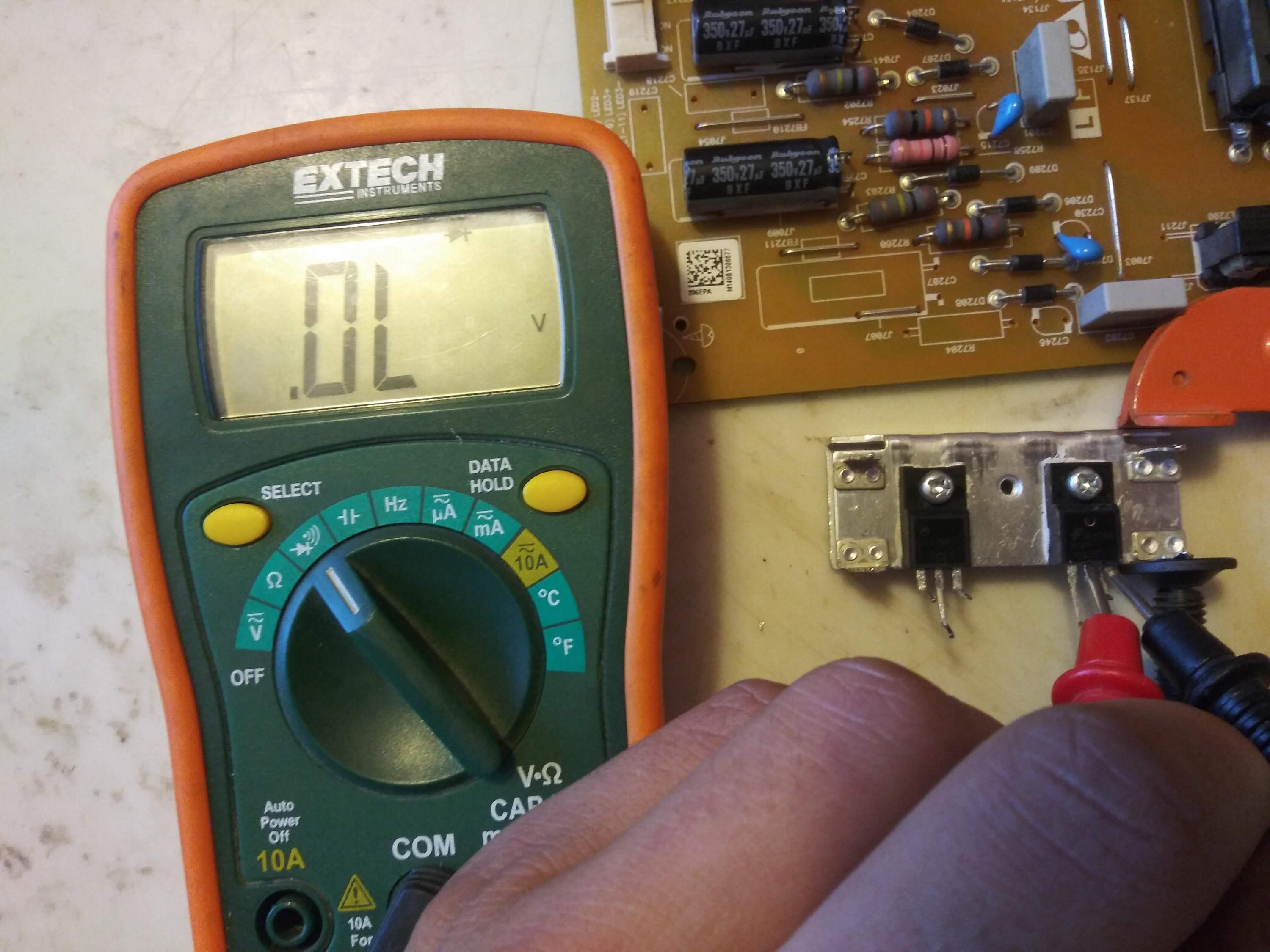

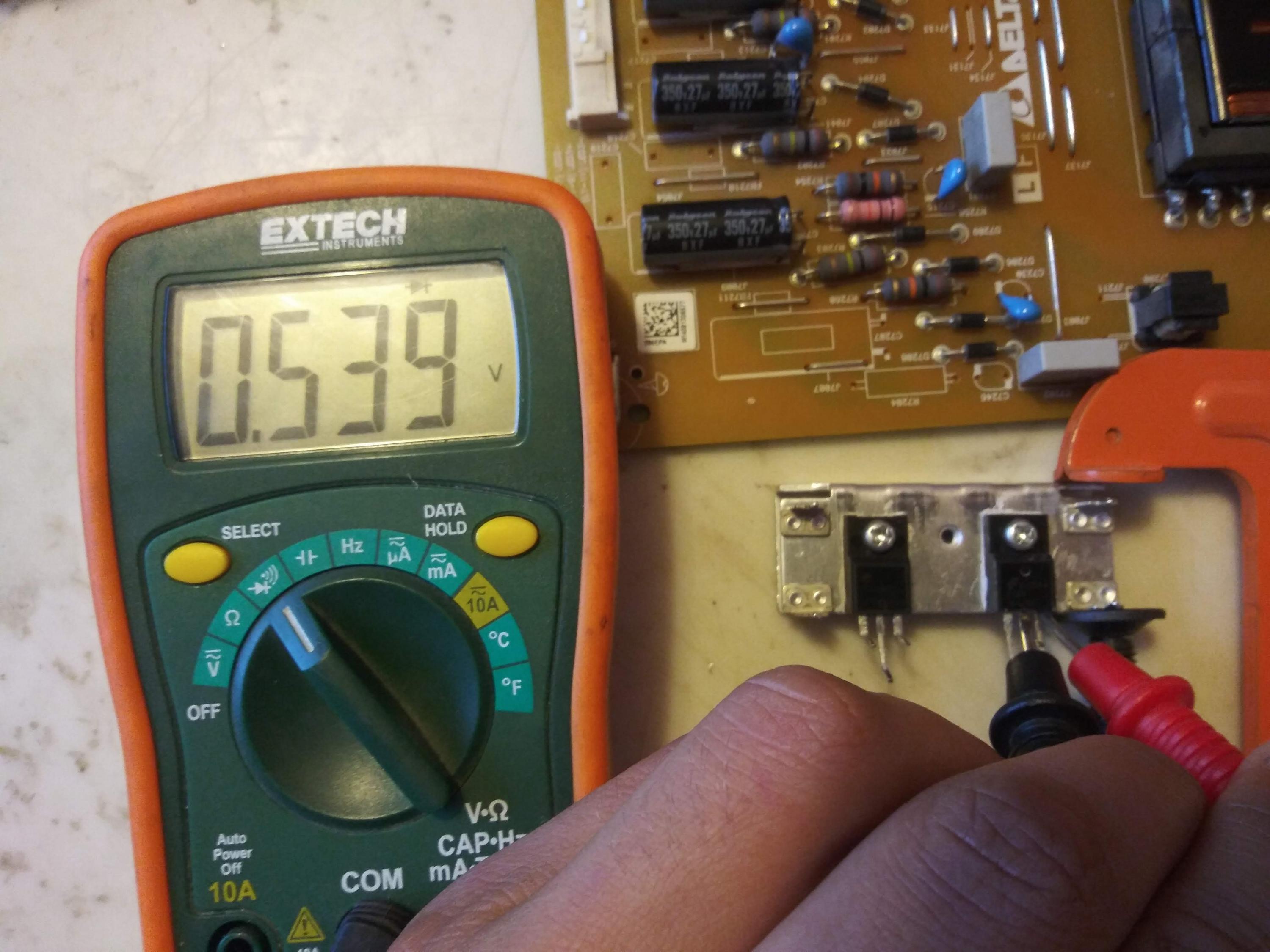

      Between DIMOUT and GND got 12.5k
      The resistor to the gate R7231 labeled as 2.49k seem ok, with 2.47k
      I couldn't find the R7299 I'm assuming you are talking of the jumper resistance R7229, have 0 as labeled
      Some days ago I removed the MOSFET to test it out, and couldn't find any faults, but just to double check I removed it again, I've attached the readings. Also no continuity between gate and S on any direction

        Re: Sharp LC-70SQ15 PWB DPS-206EP problem
        "Also no continuity between gate and S on any direction"
        It is MOSFET, that is why.
        https://www.elprocus.com/mosfet-as-a...free-circuits/
        No Gate drive for the MOSFET may mean the IC is bad or something is locking out the drive output.

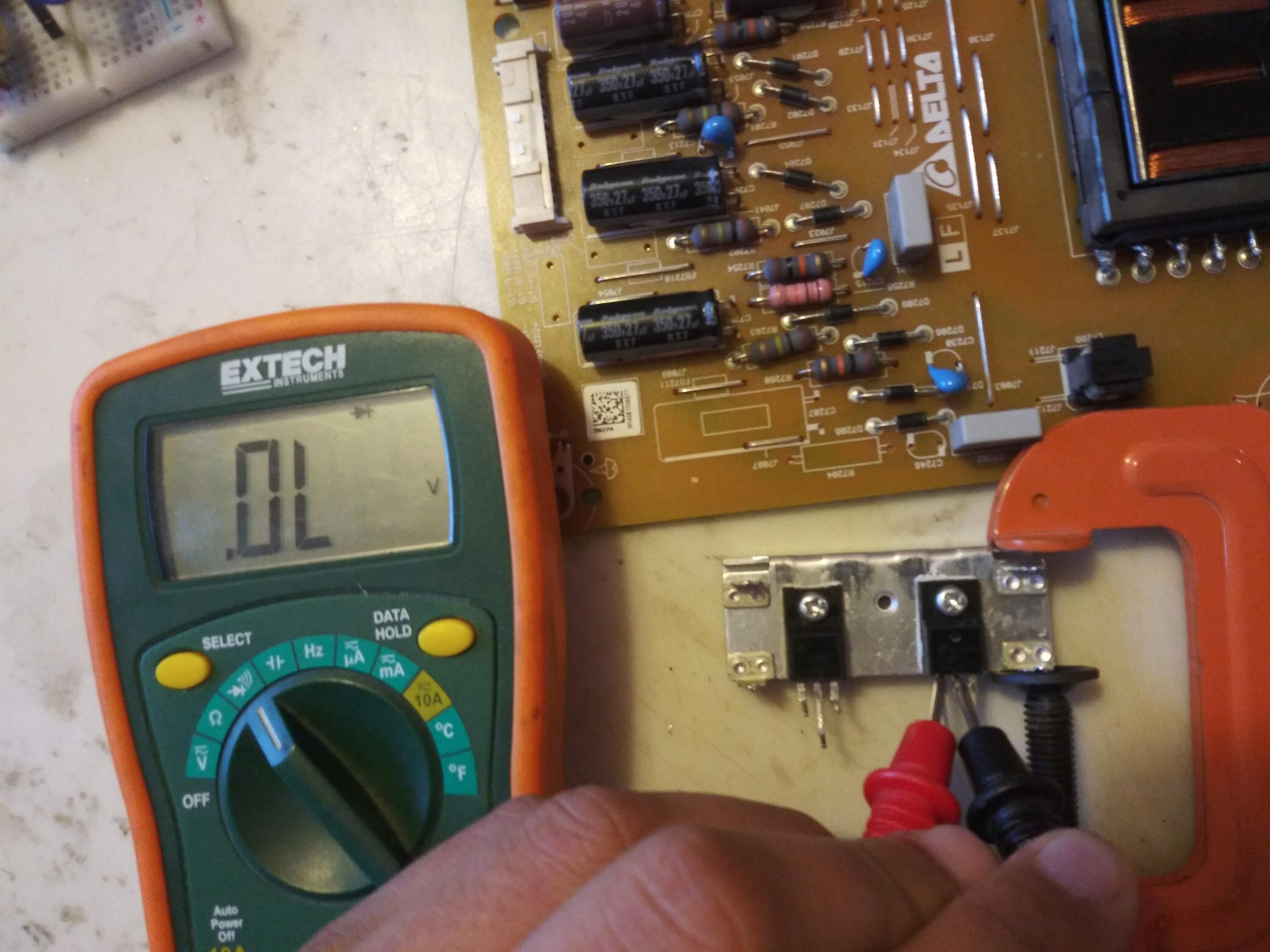

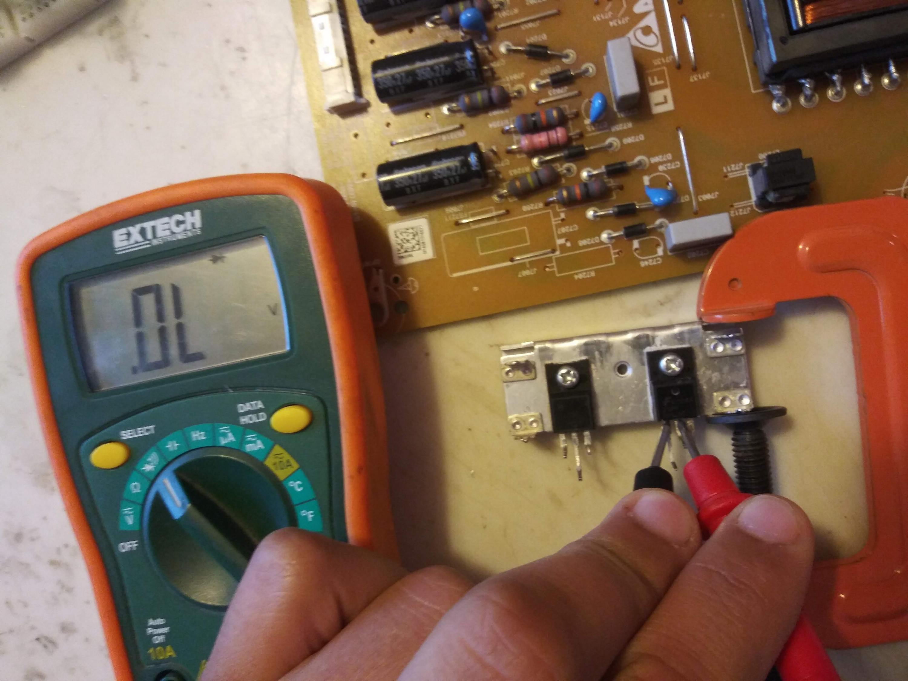

          Yeah!! After trying to test it on ON state, both of the MOSFET was not Closing, so Both MOSFET are OPEN ??
          I will replace them an tell you what happend

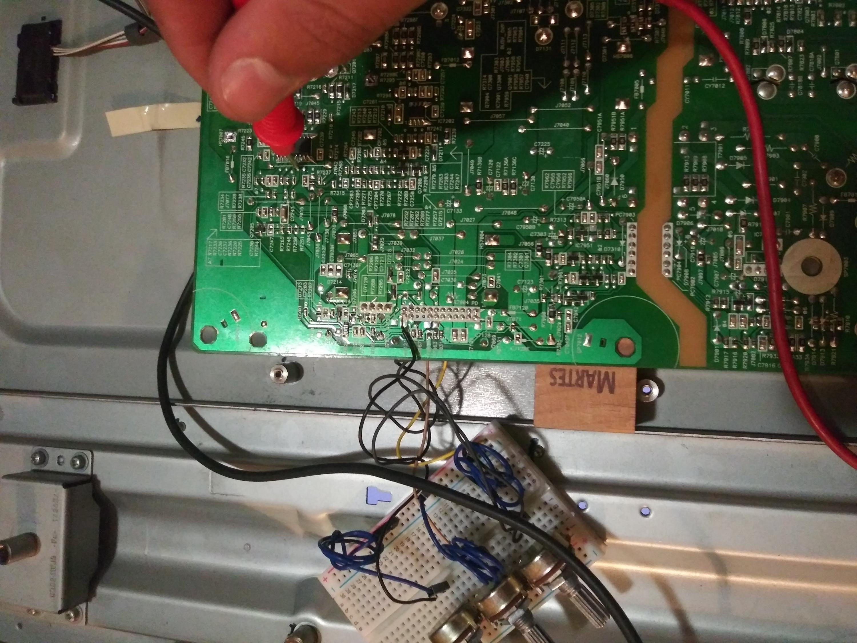

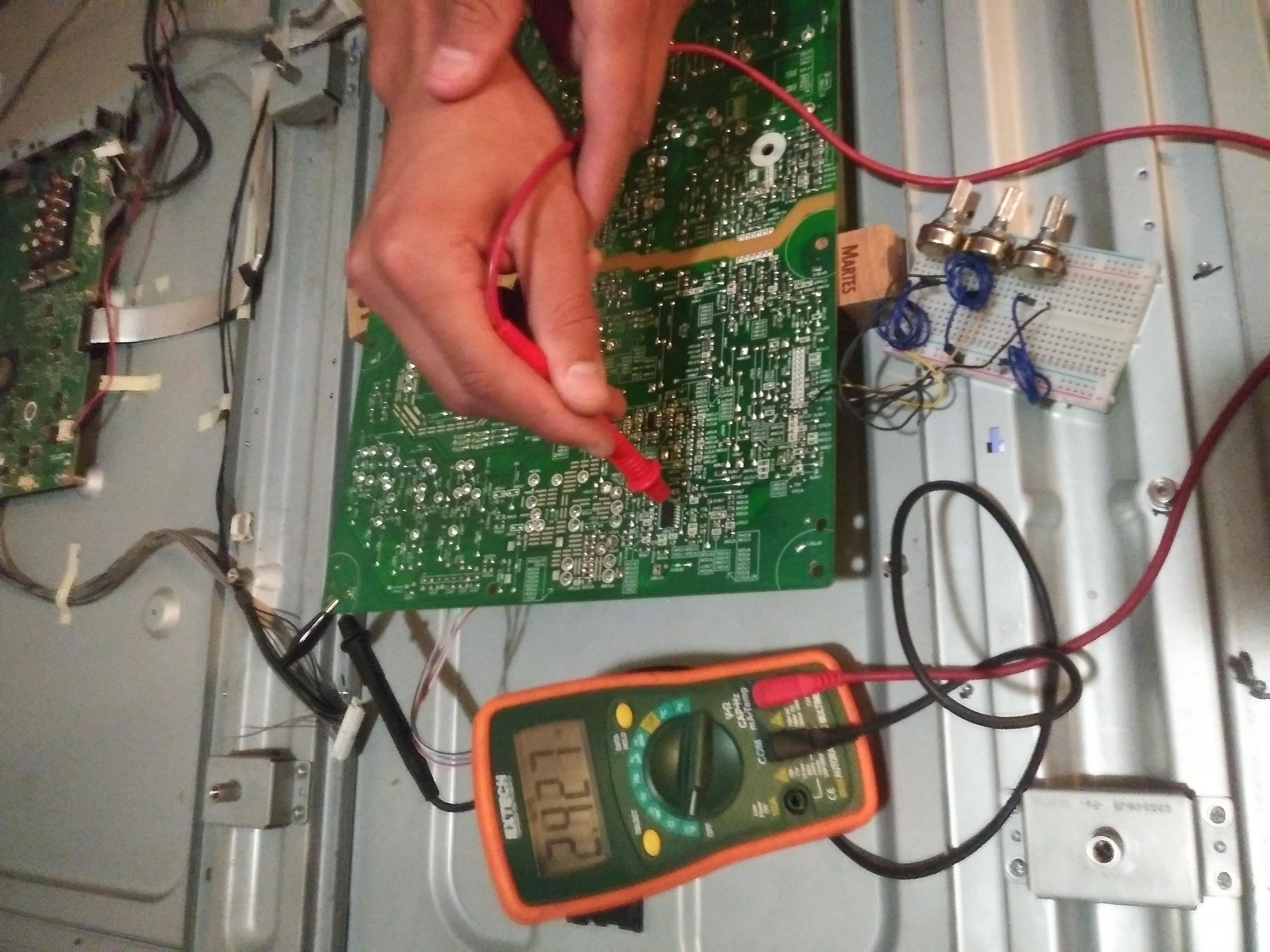

            Well, this is not going good, I did changed the MOSFETs and still is in black.
            Still have 0v on DIMOUT not even a peak when I plug to AC, now I'm really lost.
            Ok but now something weird happened, when I connect my positive probe to
            PWM1 or PWM2 the LED's turned ON, well that's a progress I guess, but I thought that the driver DIMOUT was controlled by ADIMM, and Why is this happening, I've attached some pictures, you can see the backlight through the holes
            Can I hook up everything to test it out?
              The Backligts can be dimmed by ADIM (Analog dimming control by varying the DC level), the PWM1 and 2 are for the Pulse Width Modulation dimming scheme by varying the pulse width, it will be setup for one or the other, not both. Most TV use PWM Dimming control. You board uses the word DIMMER and you do have >3V that DIMMER pin of the PD pin, so this one may be using Analog dimmer setup.
              MOSFET Q7201 is for boost converter circuit as explained before and it is OK otherwise you will not have that Boosted Voltage so I do not understand why you replace that one.

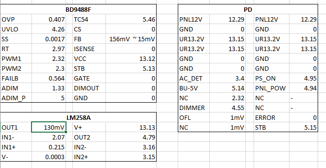

                              I'm thinking to make a video, so I can show you better, because I'm starting to think that I'm misunderstanding some points or maybe or maybe I am misjudging some testings.
                              So some points I'm gonna cover is:
                              Voltage tests on LED pins
                              Voltage peak on LED pins when tv is turned on
                              Returned voltage on each strip
                              PMW effect of multimeter probe when testing pin 5/6 on LED driver

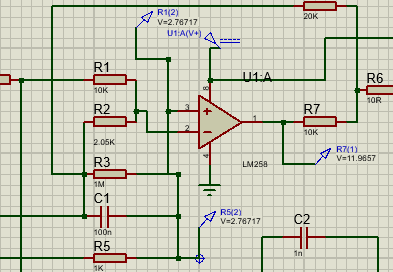

                                After trying to make a small simulation of the OpAmp IC7202, the simulator gave me the same values on pin 3 and 2, but on reality I have very difrent values,
                                PD: I didn't find the TO220
