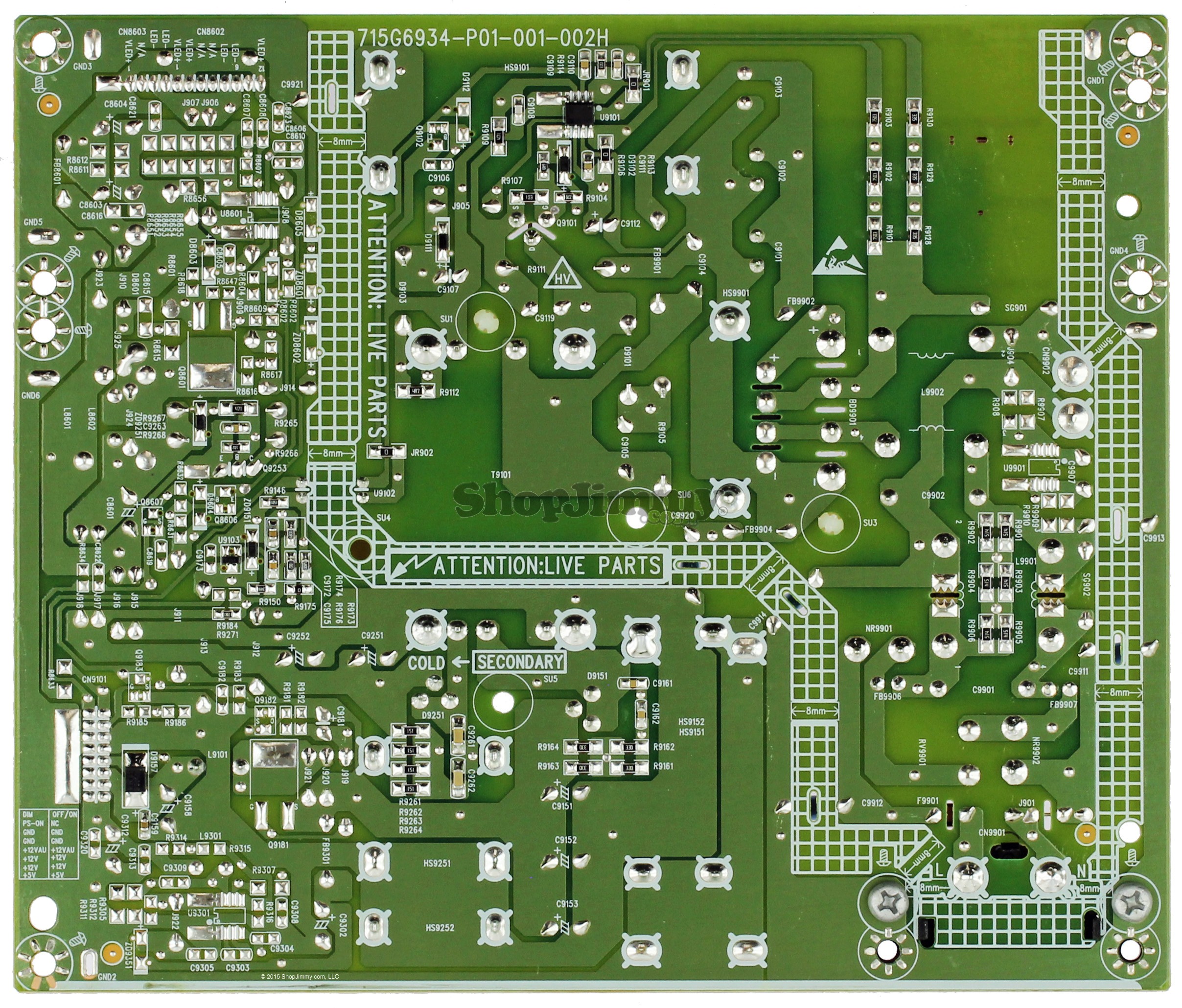

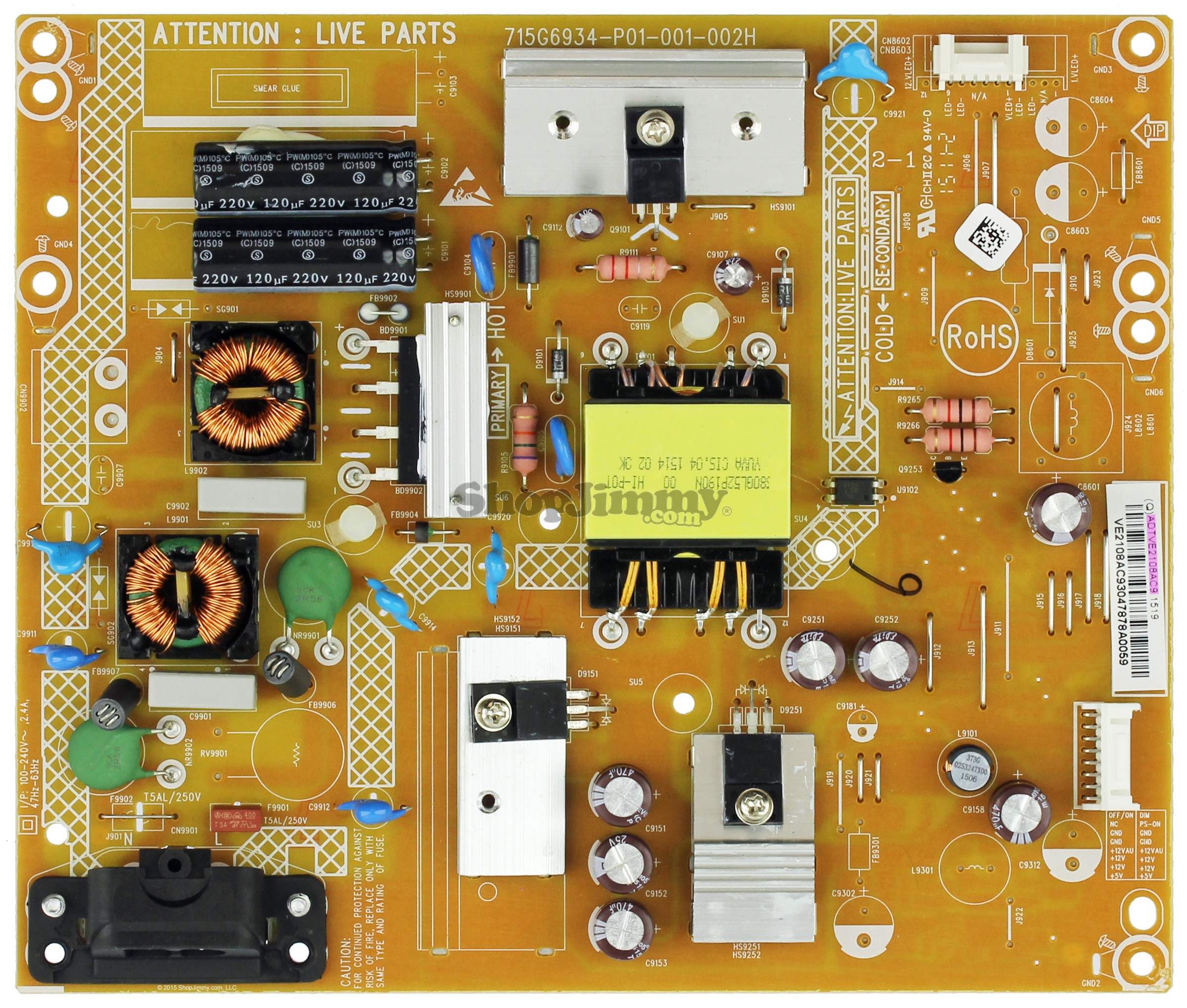

    Hello. I am trying to repair a Vizio E32-C1 dead set. When I plug the set up, I don't get the standby led. So I assumed it was the power supply. Tested it and the standby voltage wasn't present. So I've ordered numerous power supplies (715G6934-P01-001-002H) and all of them have no standby voltage present, even with just the power supply plugged in. Am I getting bad boards or does this particular set generates its standby voltage from a different source. Anyone familiar with this particular set and power supply, your help would be greatly appreciated. Thanks in advance.

    Lets see the pictures of your boards.
    https://www.shopjimmy.com/vizio-adtv...upply-unit.htm
    is this your board?
    So the connector of the power supply that goes to the moan board shows 0V on all the pins?

      Re: Vizio E32-C1 No Standy Voltage
      Hi. Yeah this is the board I have. I don't get any voltage for Ps On or any of the 5V lines. I do get all of the 12 volts for the 12 volt lines though.

          Well, that power supply is running.
          Show us the whole back side of the TV so we can see all the boards.
          This power supply only has 12V output, the 5V section is not used so the parts for the 5V power supply section is not stuffed with parts as you can see.
          PS-ON is not used either.
            If you look at the bottom of the board, you will see the +5v is not used, If you have 12v the power supply is working
