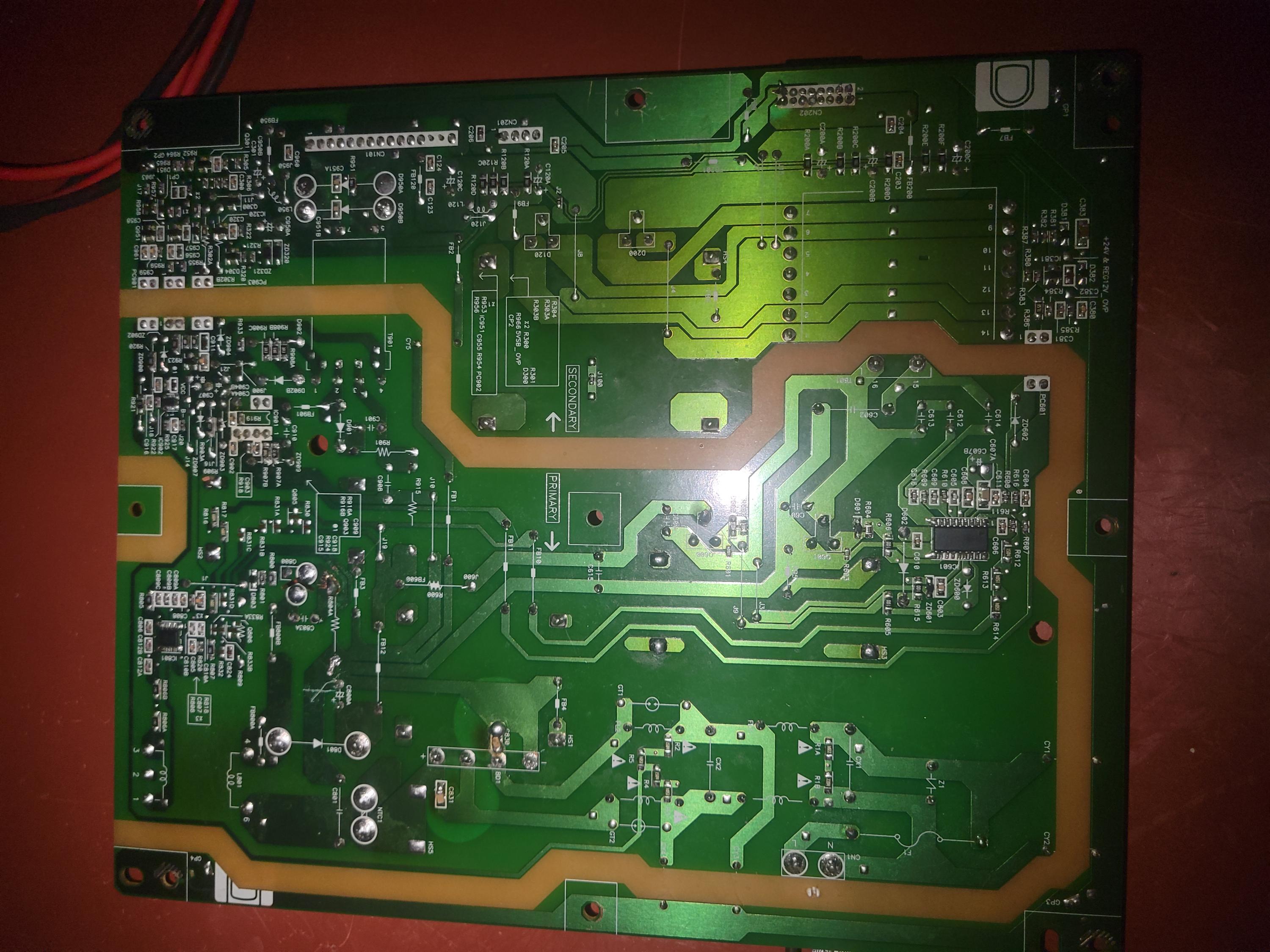

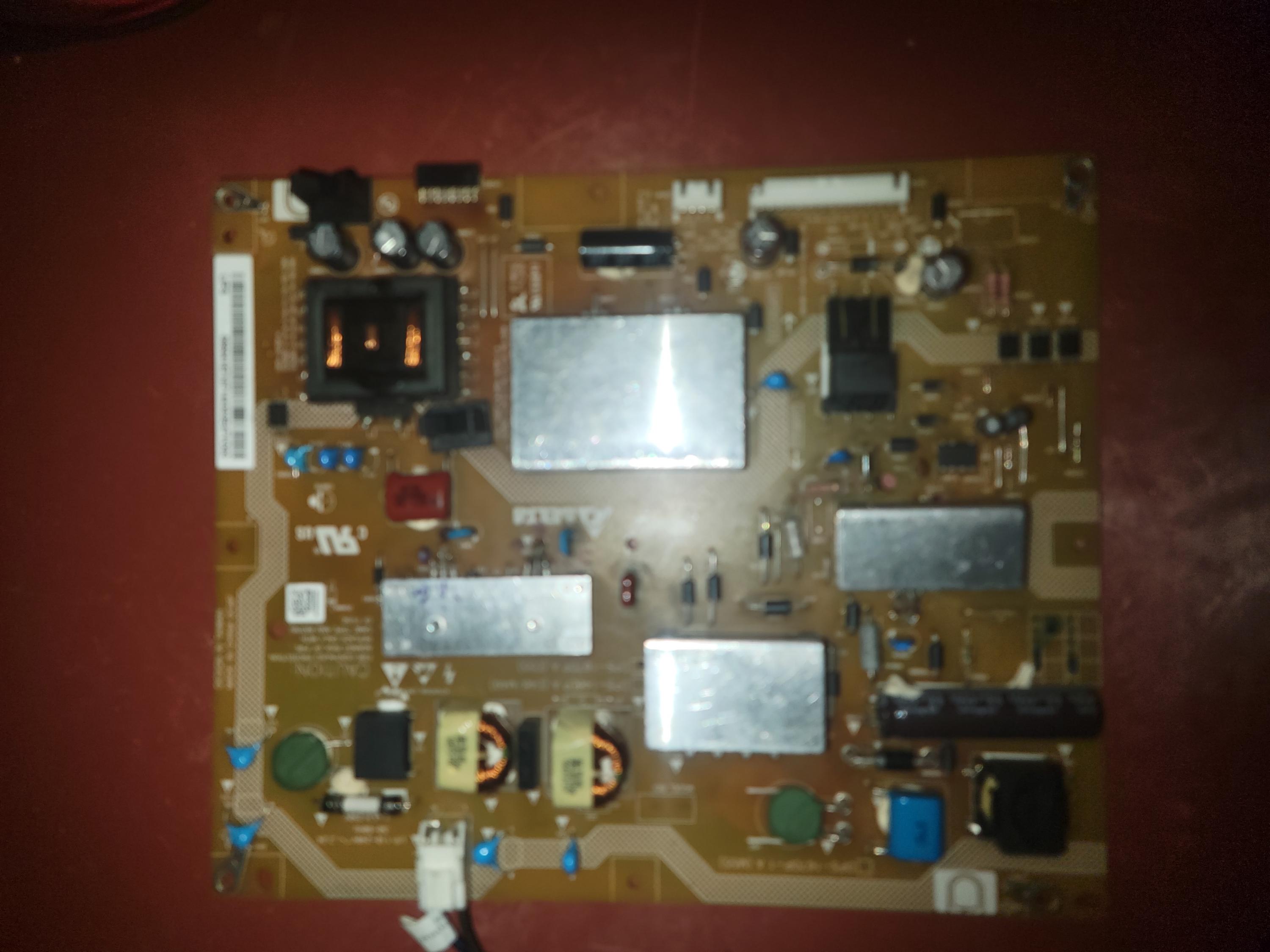

    Vizio E550i-b2e no standby voltage

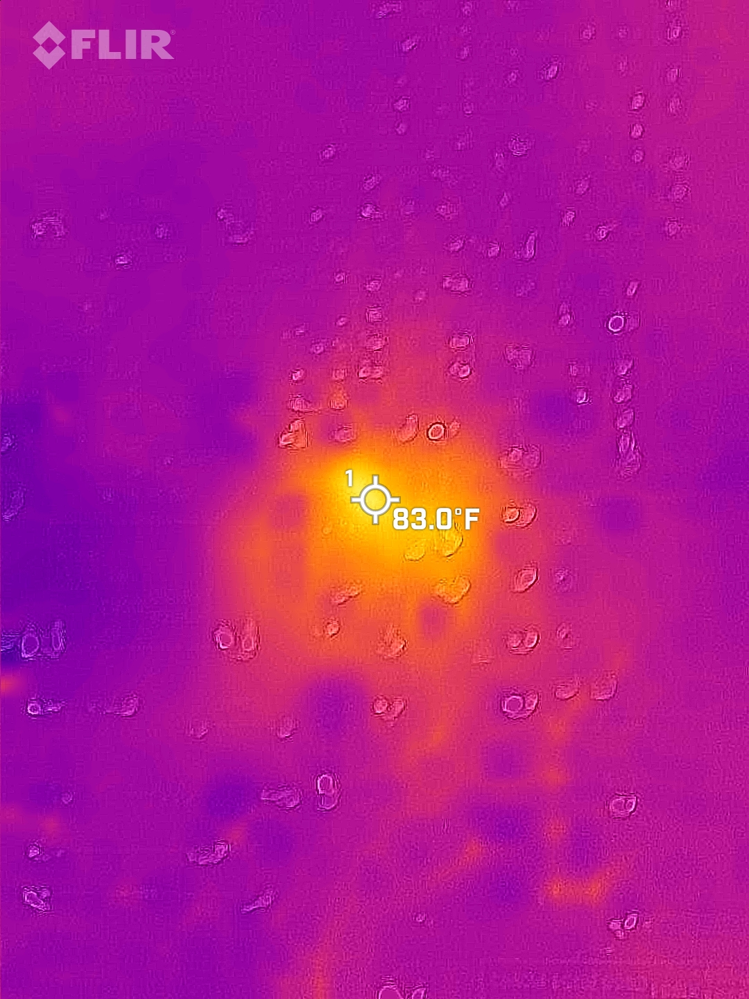

    Hi All, I have a vizio e550i-b2e that has no standby voltage. I am hoping some one can help. I am getting 10-14volts bouncing at pin 5 of ic901 (Vcc). According to the data sheet for that ic I need atleast 16v for it to turn on. I did a thermal scan and the only thing that glowed was d901.

      I have. Everything checked as it should. I was wondering if maybe that d901 is stealing current from ic901? Maybe the diode is a little leaky? Sorry I am a complete newbie.

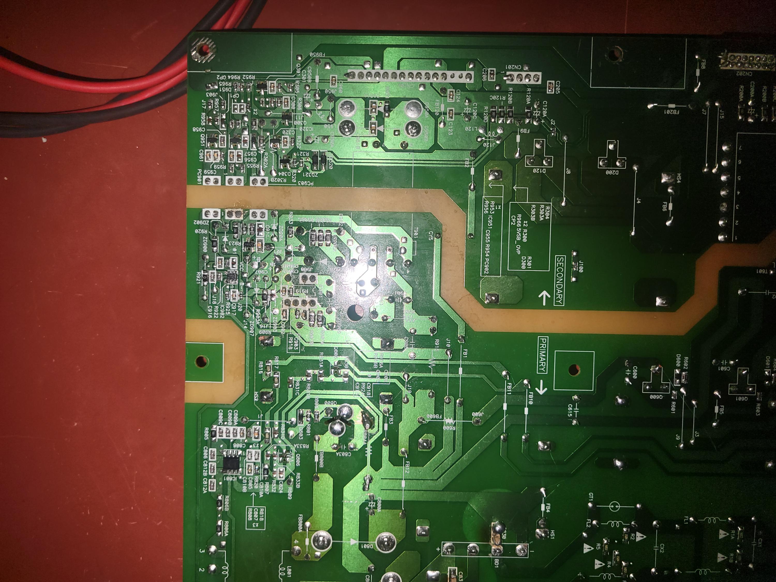

                          You can see everything looks normal except for D901

                                        maybe look all the solder joints over closely, might be just the picture but the joints on BD1 and D120 look a little suspect.
